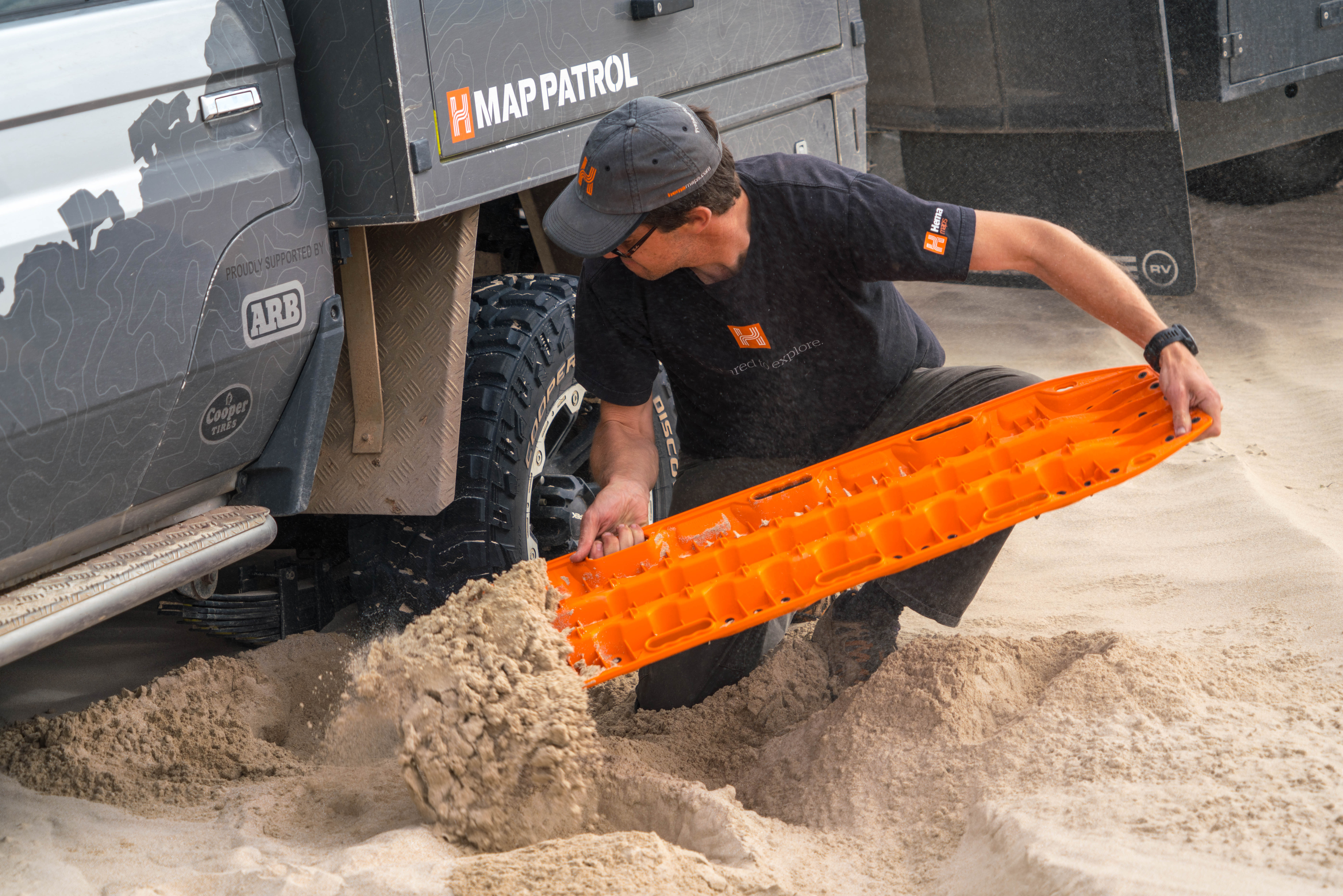

One of the key features of the Maxtrax is that every board also works as a high-volume shovel, helping to clear material from in front of the tire and allow for proper placement of the track for recovery. Also shown is the backside of the board, where the metal teeth are molded into the board, but are still field serviceable with a Torx bit.

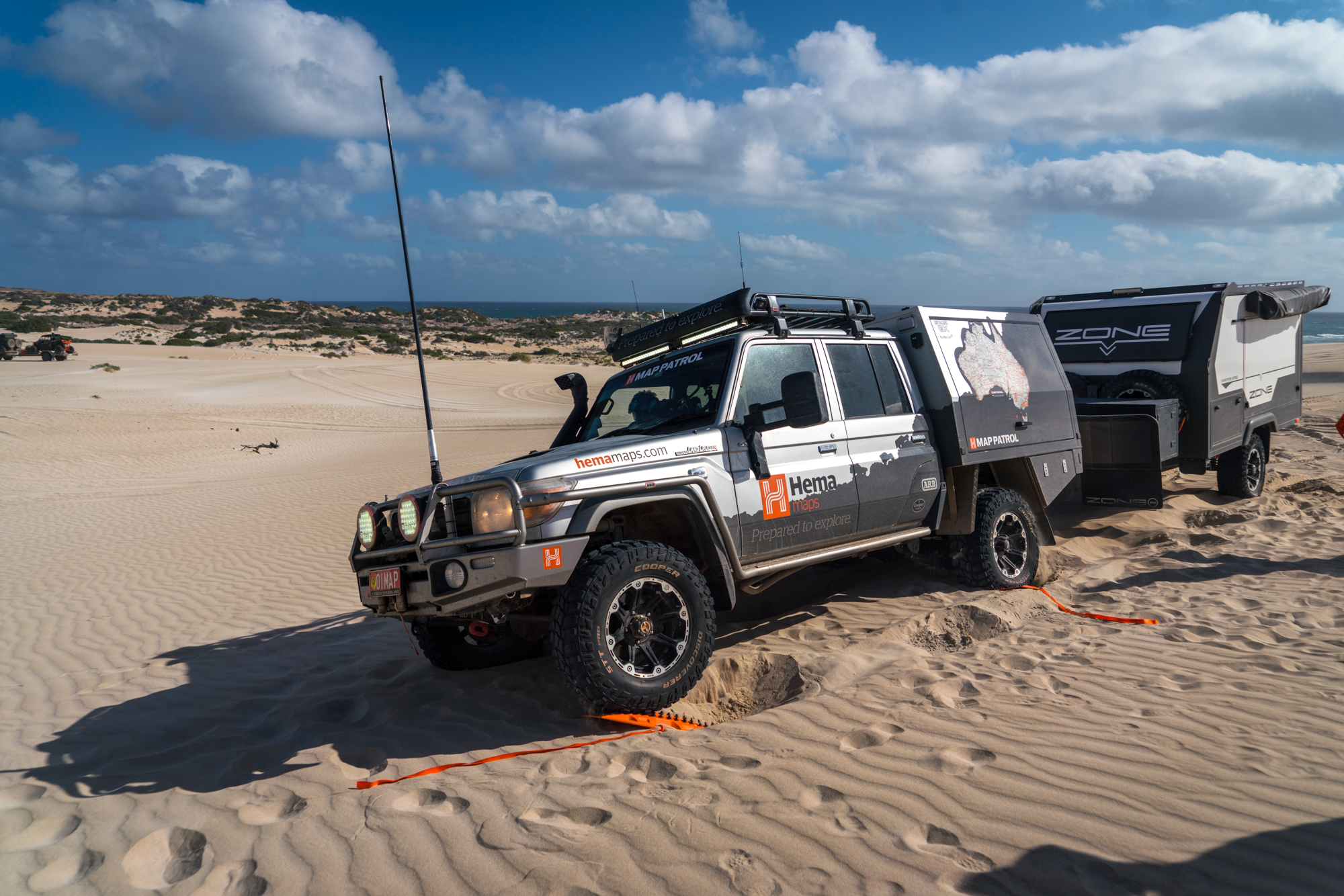

Editor’s Note: To preempt some of the potential comments, we would like to note that with the images of the stuck Land Cruisers, they were all aired down, some to low teens or even single digit PSI.  What may look like an over-inflated tire is actually the slope influencing ground pressures. The second note is regarding the images that show participants on the trip working with recovery gear without gloves.  At Expedition Portal, we recommend gloves, sturdy shoes, proper attire, and eye protection during any recovery operation. I say recommend, because people get to be adults and make their own choices, and each scenario can be different. Best practice is still best practice though—wear PPE.
The heavy VDJ79 (also pulling a heavy trailer) exits from the mire, thanks to the boards.
