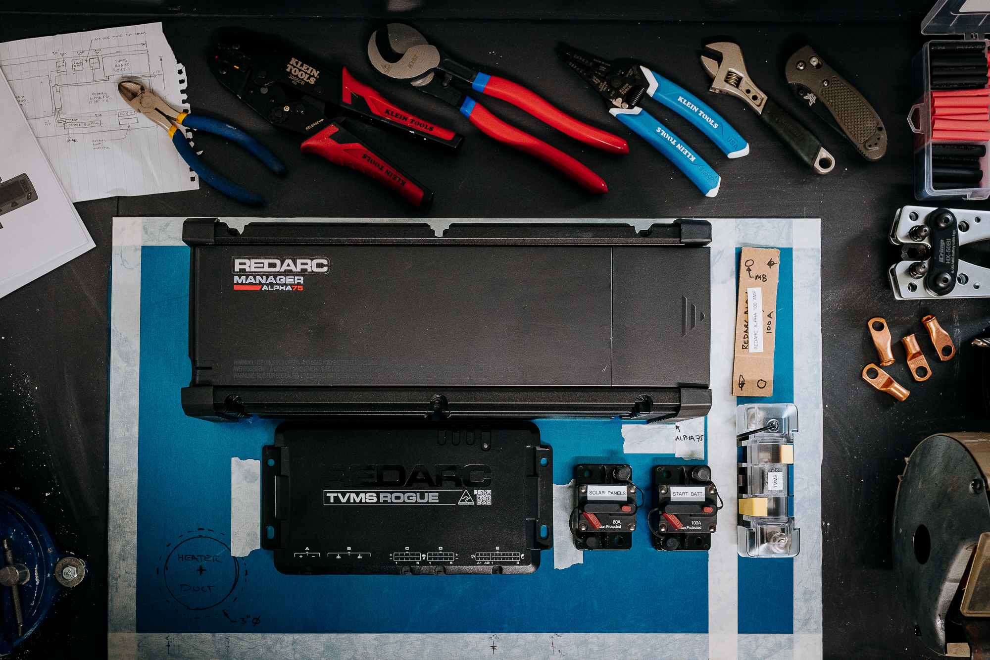

It felt like Christmas morning as I opened the Amazon boxes with a couple hundred dollars worth of appropriately sized fuses, circuit breakers, cable lugs, bus bars, and crimpers. The detailed Redarc instructions made it easy to sketch out a quick schematic and make a parts list of required components well before putting hands on the Manager Alpha packaging.
To coincide with the Alpha75 install, I removed two tired 85 amp-hour AGM batteries and installed an Antigravity DC200-H 200 amp-hour lithium battery. I also installed a Redarc TVMS Rogue for seamless integration into the RedVision system, providing control and fusing of all electrical loads via the color display and the RedVision by Redarc iPhone app.
A 200 amp-hour battery is certainly on the low end of what the Redarc Alpha75 is designed for, but we’re removing our propane tank and stove in exchange for an induction cooktop (a very high-draw appliance) and will use constant-draw loads such as Starlink in the future. The high output of the Alpha75 (and its three methods of charging) should more than make up for that, allowing us to top up our battery charge each day—all while using significantly less space and saving a whopping 44 pounds from our previous setup. Actually, 75 amps is literally too much input for our battery (which has a maximum rated input of 60 amps). With the Alpha75, you can configure input amperage limits for a previously installed battery cable that’s too small, a battery bank that can’t handle the input, or both in our case. For now, we’ll limit the input and have extra capacity for future expansion.

Using the TVMS Rogue for load switching via the monitor or app was seamless and eliminated the need for additional switches or fuses. Although I just scratched the surface of its capabilities, the TVMS Rogue has 8 inputs and 10 outputs and can automate everyday tasks to simplify life on the road (e.g., programming rear flood lights to turn on when you put the truck into reverse or illuminating rock lights when a door is opened.).
