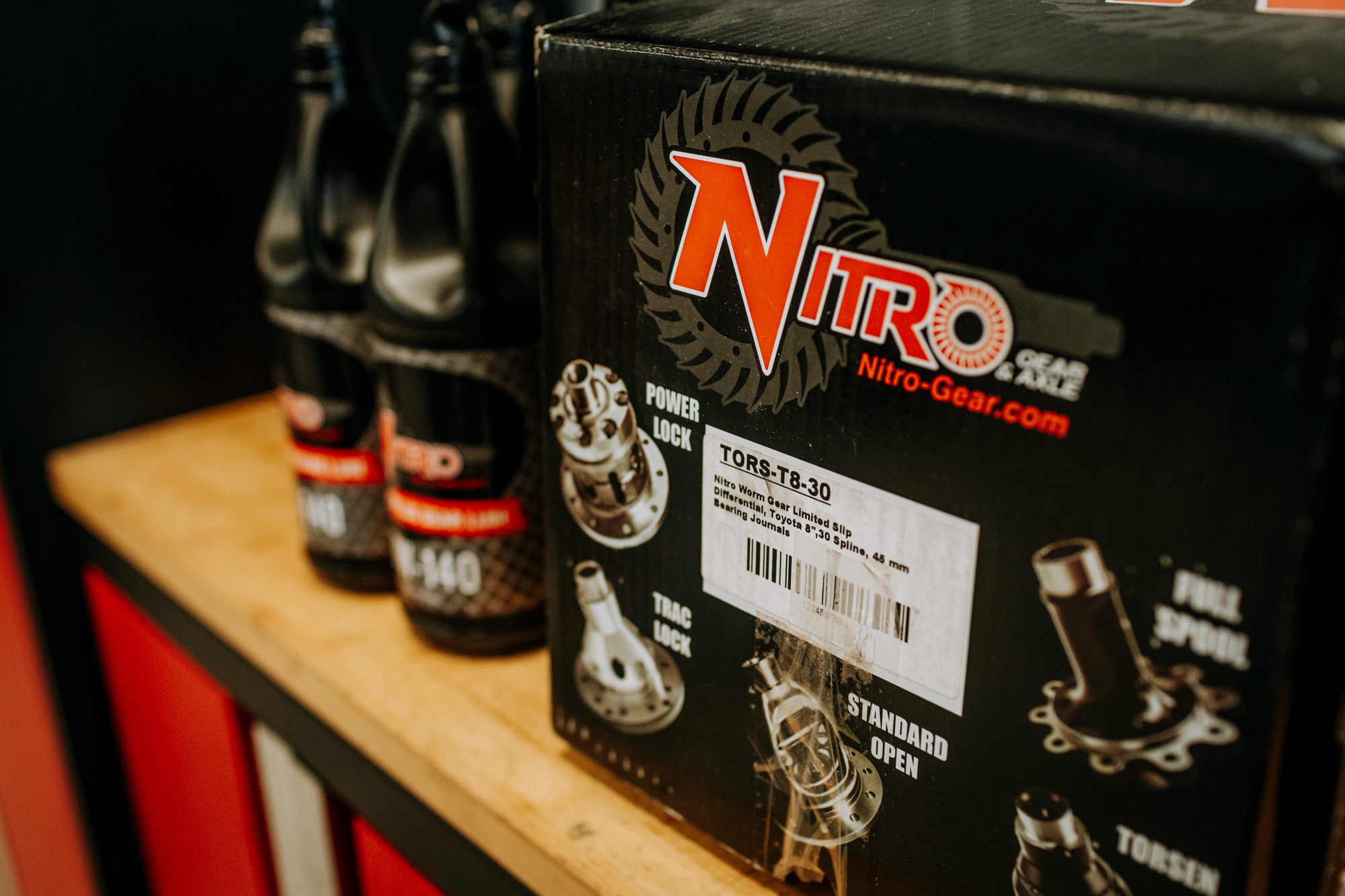

That left us with a limited-slip differential. We ran a Supra LSD in a previous pickup and really liked the performance. But instead of scouring a junkyard we went straight to Nitro Gear & Axle for one of their Helical Worm Gear LSD units. With a savings of $800 versus a selectable locker (that savings only goes up once you start including labour costs, plumbing, and electrical components into the equation), zero maintenance, and predictable manners on the road and off, it’s a great option for us.

The Nitro Helical Worm Gear is a torque-sensitive mechanical limited-slip differential that uses worm gears and spur gears to dispense and distinguish input power between two drive wheels or front and back axles.
Just like any LSD, the Nitro Helical Worm Gear functions as a standard or open differential under normal driving conditions, allowing one wheel to spin faster or slower as necessary. When a wheel experiences a loss of traction, the gear separation forces start to take effect and distributes the torque to the high-traction wheel by increasing the helical-shaped gears mesh force until wheel spin is reduced or entirely stopped. Once the vehicle exits the low traction condition, the differential resumes normal operation.
What’s nice about the operation of a Nitro Helical Worm Gear LSD, is its characteristics; smooth, quiet and automatic. This LSD will engage without any driver awareness or require any action. It also has no wearable components and requires no maintenance, producing less time on the rack and more on the road.

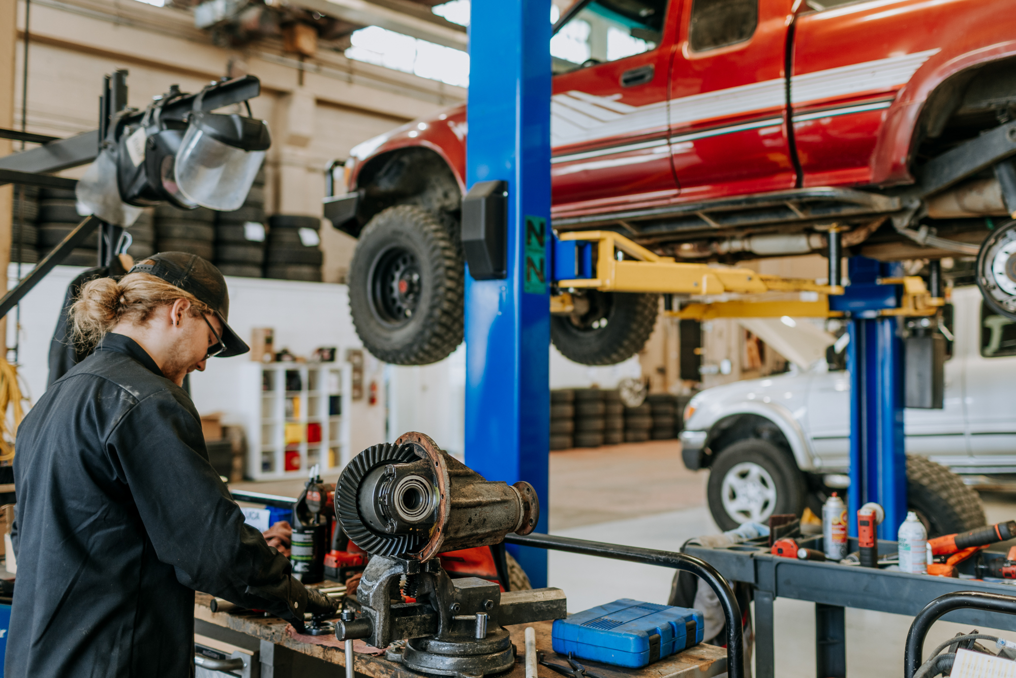

We rolled into The Gear Shop in Calgary, Alberta, to have the LSD installed. Colton bolted the ring gear to the Nitro LSD, checked the gear pattern on the previously installed 4.88 gears, made adjustments where necessary, installed the fresh center section (complete with KOYO bearings, provided by Nitro) in the factory 8-inch housing and slid the Longfield axles back into place.
Since the gear pattern was adjusted and new bearings were installed, we swapped the differential fluid after 1,000 kilometres for some Nitro 80W-140 synthetic. It’s likely you’d be installing this at the same time as re-gearing your differentials, so please don’t forget to follow the gear manufacturers break-in procedure.
After leaving The Gear Shop, we noticed, well, nothing. The truck worked just as well as it did when we pulled it in. Upon rolling onto one of our local trails, however, the difference became immediately evident. The inside tire no longer spins at every hint of body roll, we can approach basic obstacles with less speed and momentum (saving the truck from unnecessary abuse), and the little pickup is way more predictable at speed on loose gravel surfaces. With the current configuration of the truck (no weight in the back), you can actually induce oversteer with the throttle for the first time in the 30-year life of this pickup. It sounds like it’s time for celebratory donuts to me!
