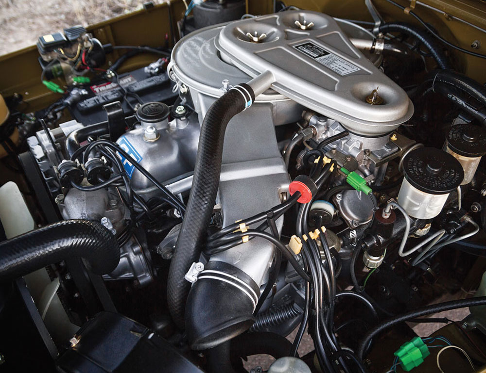

4) Keep the Engine Stock This is the most common mistake we see with vehicle preparation: dozens of little modifications to the engine, including changes to the ECU, headers, cold air intakes, aftermarket turbochargers, etc. These all seem like a great idea until you need to repair one of those items in the middle of the Gobi Desert or find a replacement belt in Uganda. Certainly, there are proven or even mandatory upgrades that address known failure modes of the factory components, but otherwise, leave the engine mods to the tuner crowd. If the environment you are traveling in demands a certain amount of power (like sand) then buy the right truck with the right engine to start with.

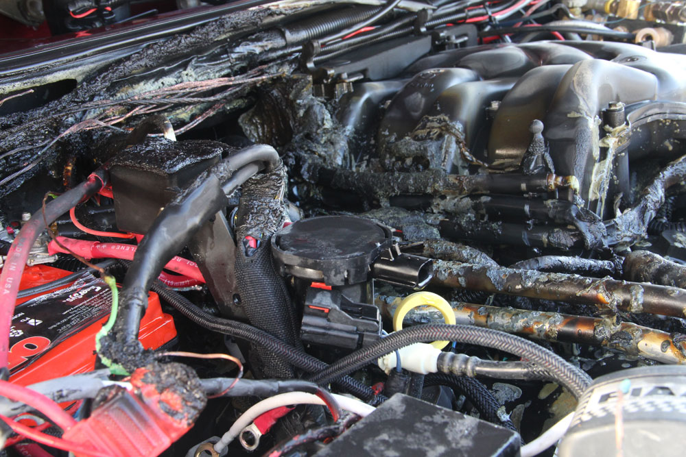

5) Isolate and Minimize All Electrical Modifications Electronics are the bane of all travelers, taking more time and requiring more “fiddling” than any other system. The reality is that most modern overlanders do use and often need electronics to enhance their experience, including digital cameras, GPS units, and tablets to navigate by and record their journey. However, miles of wiring, fuses, and connections are some of the most common failures. As a result, completely isolate all “house” electrical systems from the factory harness and use a dual-battery system and auxiliary battery to protect starting voltage. Spend the time or money necessary to ensure the wiring is 100 percent correct, including quality components, weather-tight connections, and proper fusing. Electronic gadgets are so appealing that they often waste volumes of time and create major distractions to the driver.

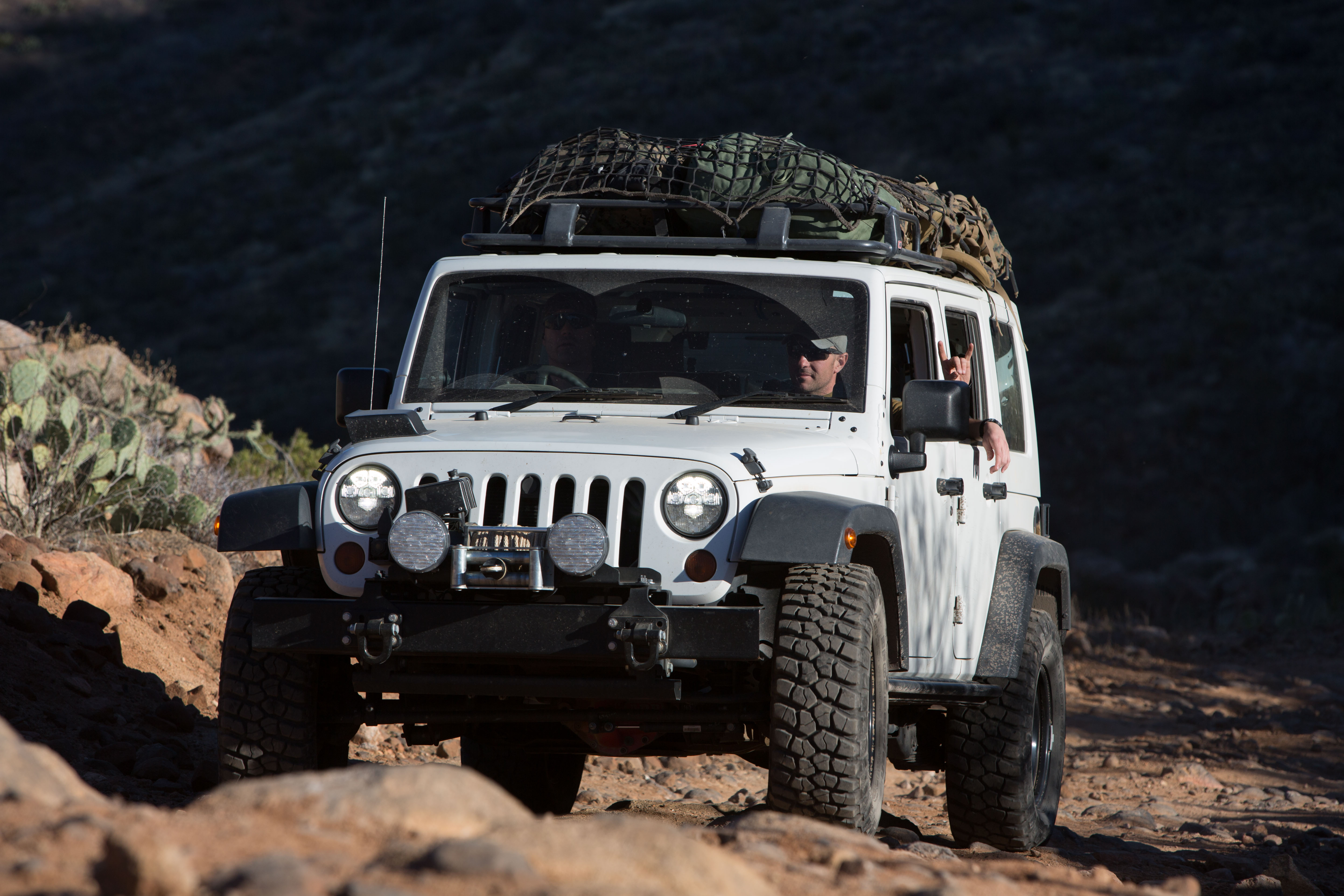

7) Avoid Roof Loads This is the most common mistake of the new overlander: packing everything and the kitchen sink on the roof. There is nothing wrong with a lightweight roof rack, but having a roof tent, spare tire, and six jerry cans is extremely dangerous. Even a basic understanding of physics will prove why that is such a terrible idea, and those types of loads create a litany of problems, including dangerous handling due to the raised center of gravity (COG), poor technical terrain performance, reduced fuel economy, and potential roof damage. Loads must be as low as possible and as close to the centerline of the vehicle (fore/aft) as possible. If all that gear needs to be on the roof, you probably bought the wrong vehicle. For most vehicles, the maximum roof load should be less than 120 pounds—I prefer less than 70, or ideally, a completely empty roof rack.
During Expeditions 7, we took the same Land Cruiser to all seven continents, and we never needed a permanent roof load. We packed minimally and slept inside the vehicles or in ground tents.

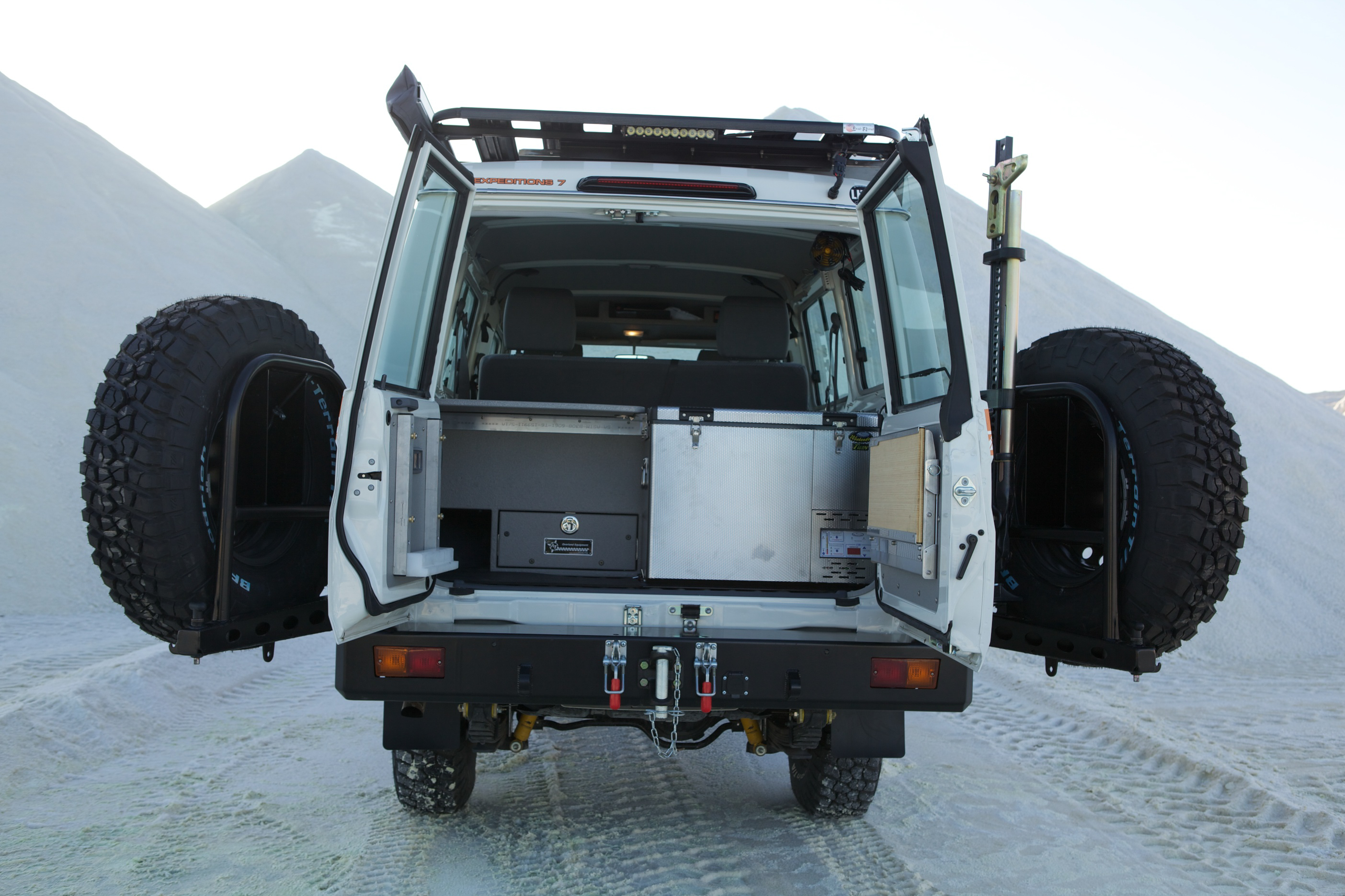

9) Secure the Load  Take the time to secure all loose items in the cab, ensuring that proper lashing points are installed throughout the vehicle. This includes securing all soft luggage and in particular, all hard/heavy items. Even a big bump or ledge on the trail can cause items to shift forward in the cab, impacting passengers, or worse, the driver as they are attempting to clear an obstacle. In the case of a roll-over, those items can kill or seriously injure occupants. Install load mats and ratchet straps to keep items from sliding and bouncing. Watch items that can roll forward along the floor into the driver’s footwell and secure small items with a properly sized center console. Drawer systems can be quite convenient and also improve loading and lashing, but be careful with their weight.
This Jeep J8 military-spec Wrangler is designed for a full metric ton of payload. We kept it at stock height and only added a winch and rack from the stock specification. It served for years as our training platform with the US Special Forces.

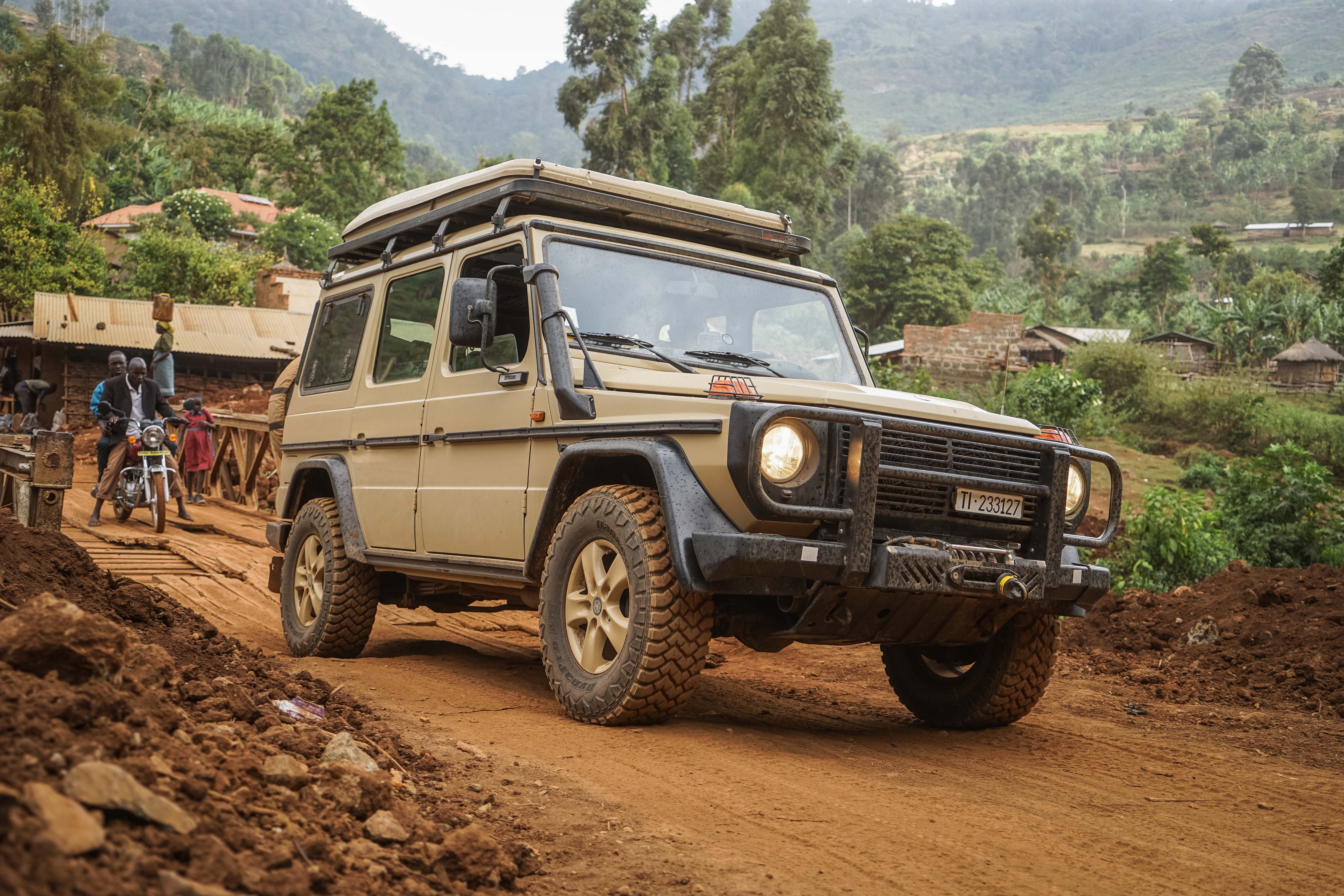

10) Quality and Design Over Quantity Contrary to what we see on the web, it is not the truck that defines you, but your experiences. Experiences can be enhanced by thoughtful design and a quality product, but also easily end a trip with a broken aftermarket spring that saved you a few dollars over the proven brand. If price is a factor, then just leave the vehicle stock. We are far better off modifying our vehicle with slow and deliberate purpose than just checking off the list of things we think we “need.” A stock, properly maintained Land Cruiser can easily drive around the world and take on some seriously remote and rugged terrain along the way. So, make modifications only as absolutely necessary, and save all that money for gas, a good camera, and that 20-foot container shipment to Cape Town.
The Entdecker G-Wagen is one of the most exceptional vehicle builds ever produced, a partnership between Unicat and Front Runner using the G-Class Professional model. The roof tent is carbon fiber and the rack aluminum, keeping the roof load below factory limits. The vehicle is stock height and uses modest tires. We have driven this SUV in several African countries, including Kenya and Uganda, and never suffered a failure with the modifications.

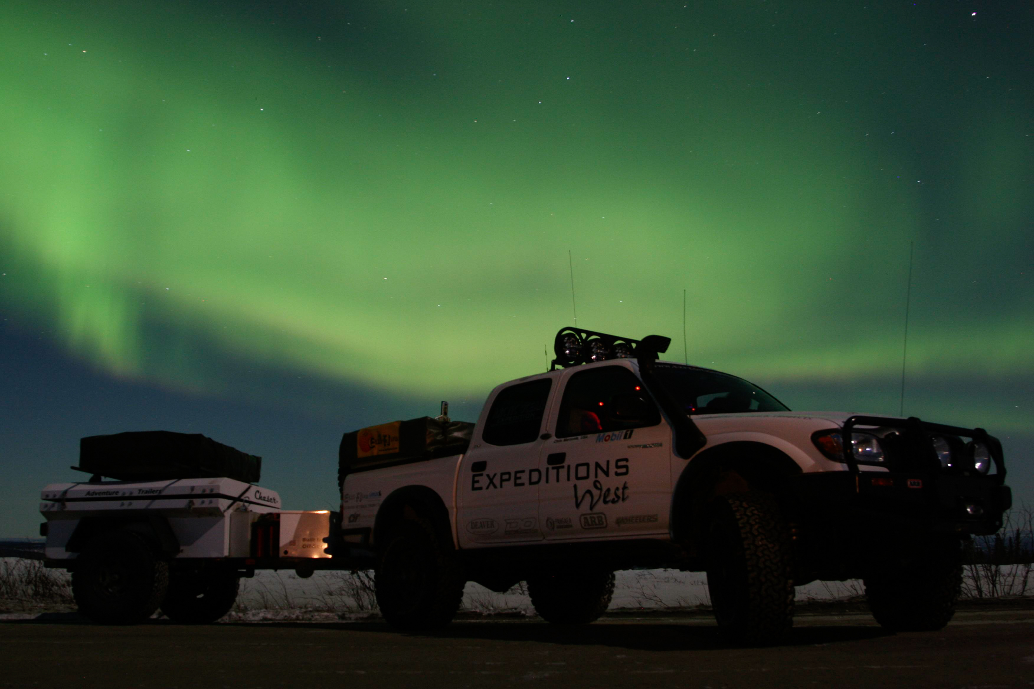

We have learned many of these lessons the hard way, including one of our first project vehicles, a 2004 Toyota Tacoma, which was so overloaded and complex that it resulted in constant issues and repairs. As we gained experience, the modifications slowly reduced to our current mantra.
