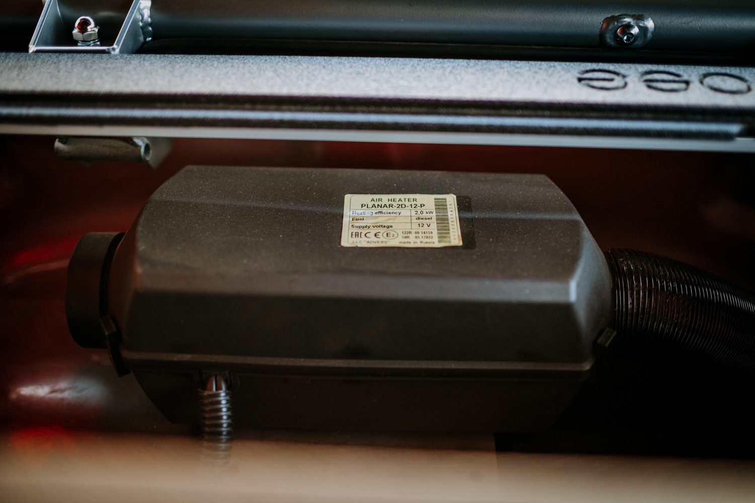

installing a diesel heater in your campervan, trailer, or overland vehicle
Photo: Matt Swartz
But with so many different vehicle heaters on the market, the important question remains: what type of heater is best for your overland rig? Let’s start by digging into the two main types of forced-air heating systems: diesel and gasoline.
Diesel Forced-air Heaters
Diesel air heaters help maintain a comfortable temperature in your van or truck with high levels of safety and minimal maintenance.
In general, diesel forced-air heaters use a modest amount of fuel: approximately 1-2 gallons for 24 hours of operation, depending on heat output. They can be plumbed into your vehicle’s fuel tank, or if your vehicle runs on gasoline, they can be set up with their own independent fuel tanks.
Photos: Richard Giordano
Diesel air heaters require a 12- or 24-volt electrical source to power their fuel pumps and fans, so you’ll want a dual-battery system if you plan to run them for extended periods of time, like overnight.

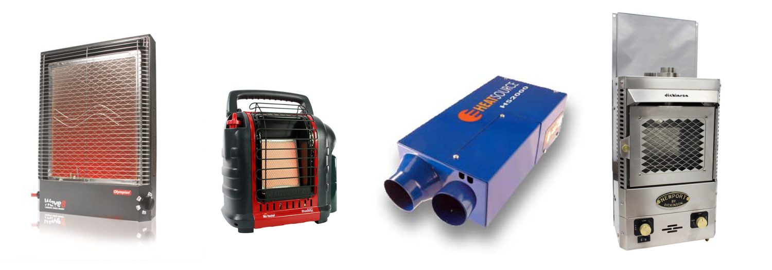

What about propane heaters?
Yes, propane heaters are an option, and some are superior to others.
Catalytic and ceramic blue-flame heaters are widely available and inexpensive, but they have some downsides. They have a hot surface (fire hazard), and they also consume oxygen in the space where they are being used, requiring you to have ventilation, which partially defeats their purpose of heating your enclosed area. Finally, water vapor is a byproduct of the propane combustion process, and this water condenses on the inside of your vehicle walls which can lead to rust and mold.
propane forced air heaters
Left to right: Camco Olympian Wave (catalytic), Mr.Buddy (ceramic blue flame), Propex (forced air), Dickinson Marine (radiant)
The only two propane heaters that we would recommend as alternatives to diesel or gasoline forced-air heaters are from Propex and Dickinson Marine. We’ll cover those two heaters in a future propane heater buyer’s guide.
