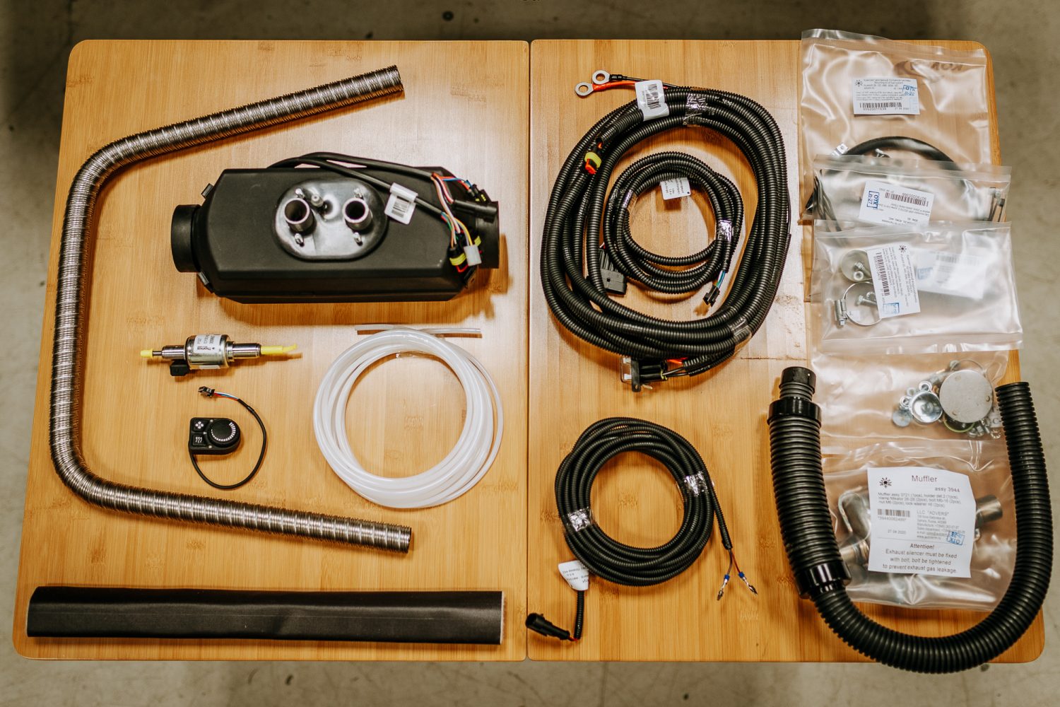

Powered by propane, gasoline, or diesel, there are a wide variety of heaters on the market. Originally designed for boats and long-haul trucks, these safe, compact, and fuel-efficient air heaters have become popular in the overlanding community. Many of our fellow travelers warned against propane heaters due to their tendency to build up condensation indoors, along with the potential struggle of regularly finding propane in foreign countries. Diesel or gasoline options seemed like the best fit for us.
A gasoline air heater seemed promising as we could easily tap into the existing vehicle gas tank. We discussed our quandary with a Webasto sales representative, who recommended against the gasoline air heater. Although installation would be straightforward, gasoline air heaters have a tendency to leave carbon deposits on the interior walls of the heater’s combustion chamber, potentially leading to ignition issues and additional maintenance over time. That may be satisfactory for someone using their vehicle locally or seasonally (since they always have a service center or warm garage close by), but on a long-term trip far from home, we don’t want to be disassembling a gasoline air heater for routine maintenance.
planar
This information (along with our budget) led us to the Planar Diesel Air Heater. The Russian-built unit is designed to run on any pump diesel or hardware store kerosene fuel. At $898, it’s a good value that comes with a 2-year warranty and local support. Plus, the installation instructions gave me an opportunity to brush up on my Cyrillic script.

The basic PU-5 controller requires a mere click of the on/off button and a turn of the heater control knob to set the heat output temperature. But how well does this 2-kilowatt diesel air heater work in 150 cubic feet of uninsulated camper? Keep in mind that the sides of the camper are aluminum and fabric, whereas the sides of the truck box are thin 1990’s Japanese steel. There is very little keeping the heat from escaping this living space.
