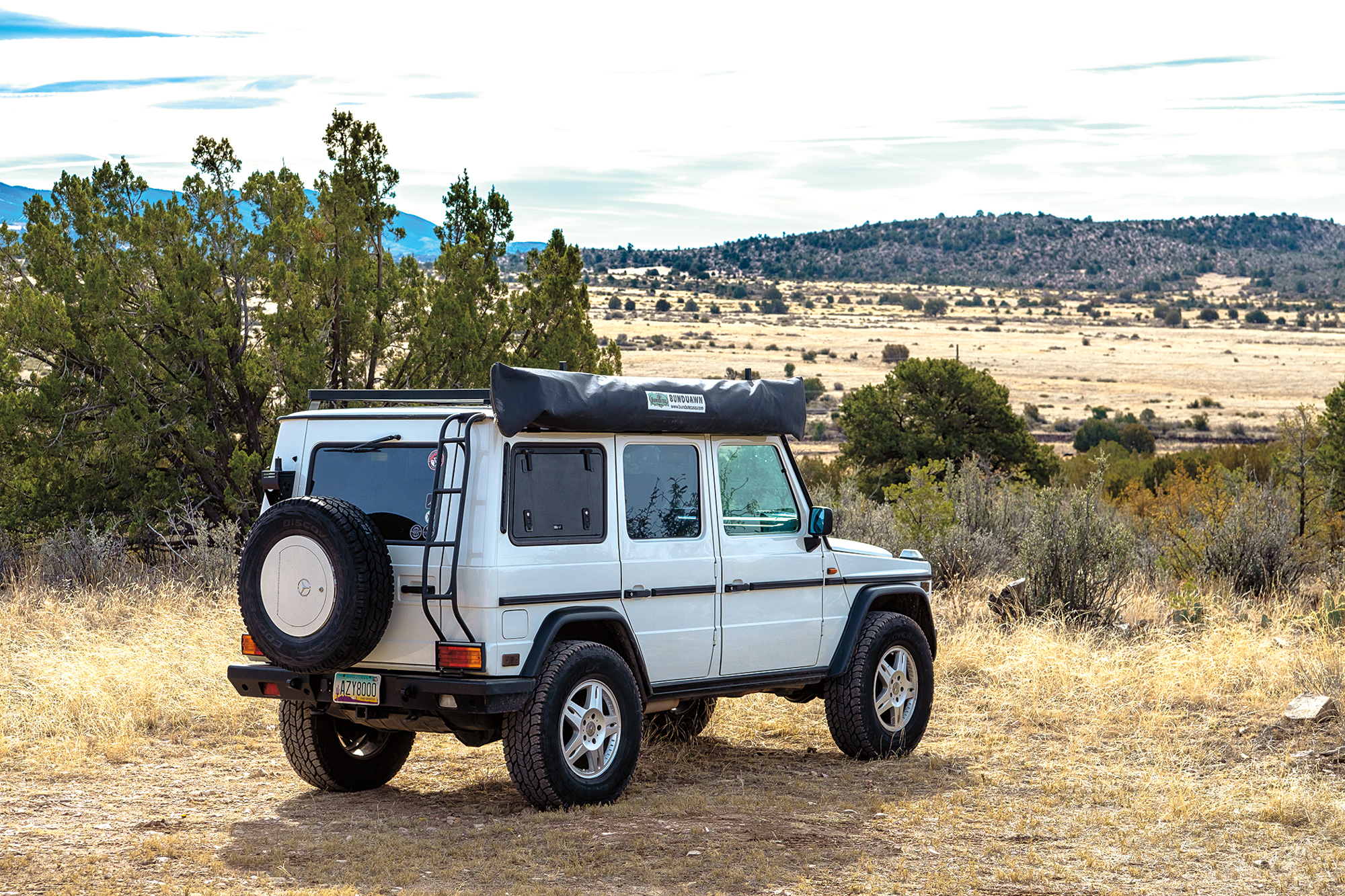

For standardization, the awnings were all installed on the same Front Runner roof rack on top of Overland Journal’s Mercedes G-Class. We chose a Front Runner rack for its abundant mounting options, but also due to the company’s lack of a 270 awning in their product line, thus eliminating any possible bias. Mounting brackets and hardware were either supplied by the manufacturer, or by Front Runner when recommended as best practice.

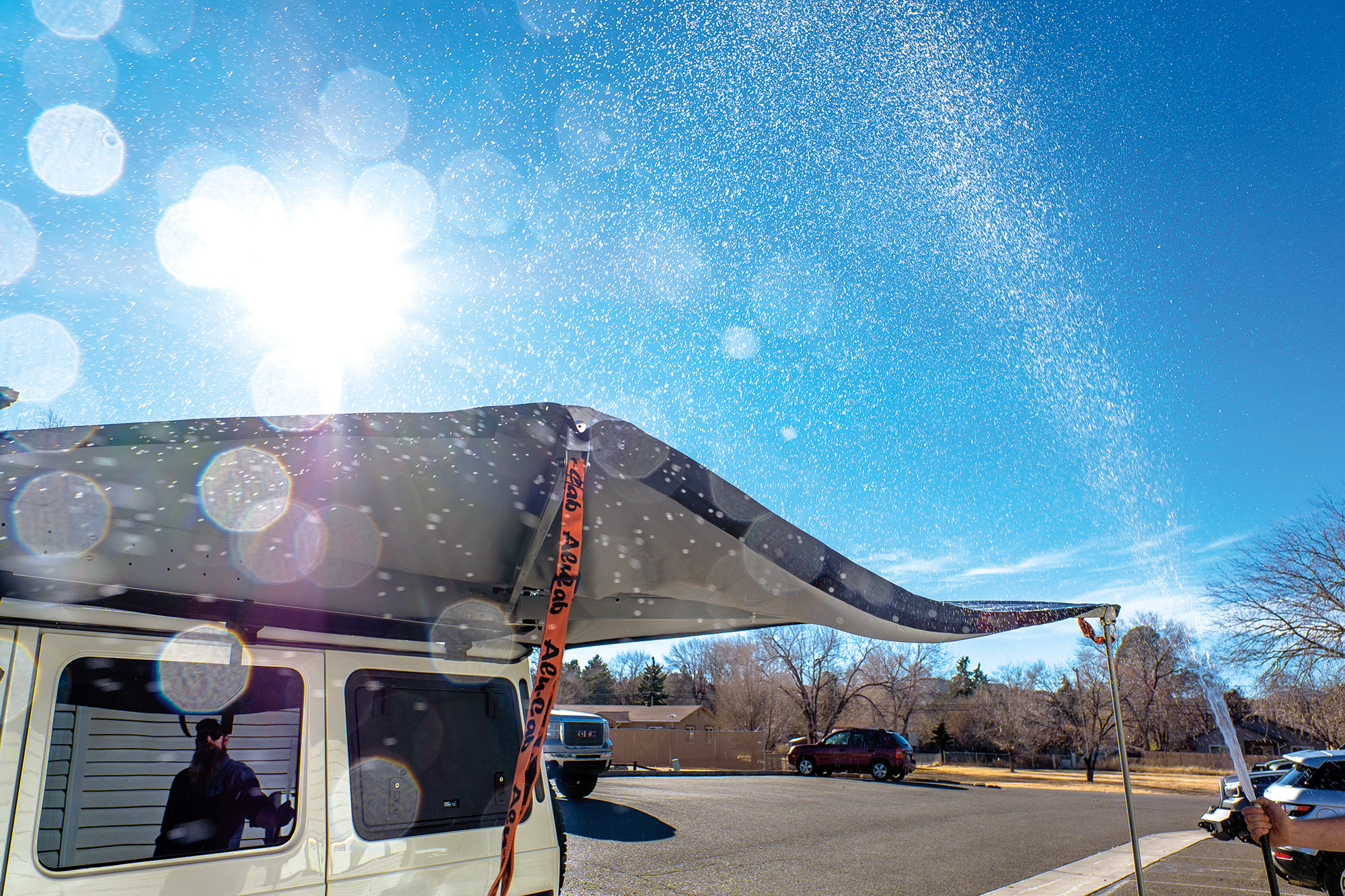

Our analysis was comprised of multiple stages, starting with an initial inspection of components and features. Once completed, we set the awnings up and sprayed them with water to examine their ability to handle rain. The fabric and seams were inspected for signs of leaks, and any areas prone to pooling were filled to their greatest capacity to see if there was a risk of collapse.

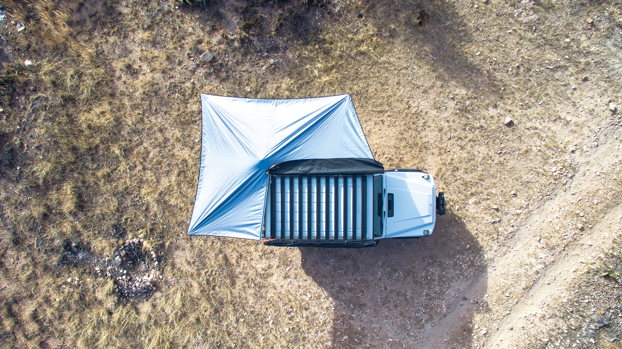

It can sometimes be difficult to appreciate the nuances in coverage between various awnings, but when viewed from above the differences become clear. The Alu-Cab, Eezi-Awn, and Rhino-Rack share a common folding pattern that utilizes a single set of armatures making them quick to stow and deploy, but also providing less protection from the sun or rain. The Darche and Bundutec, on the other hand, gain a considerable increase in square footage by using a second armature which folds forward toward the hood. The cost is that they require an additional step during setup and breakdown, adding complexity.
Following the water evaluation, we took the awnings out on city roads and highways to determine how much noise they produced during daily driving. Flapping fabric, jangling zippers, clanking internal components, and whistling due to size or shape were all considerations. Noise evaluations were expanded further by driving down a series of heavily corrugated dirt roads to our shooting location.

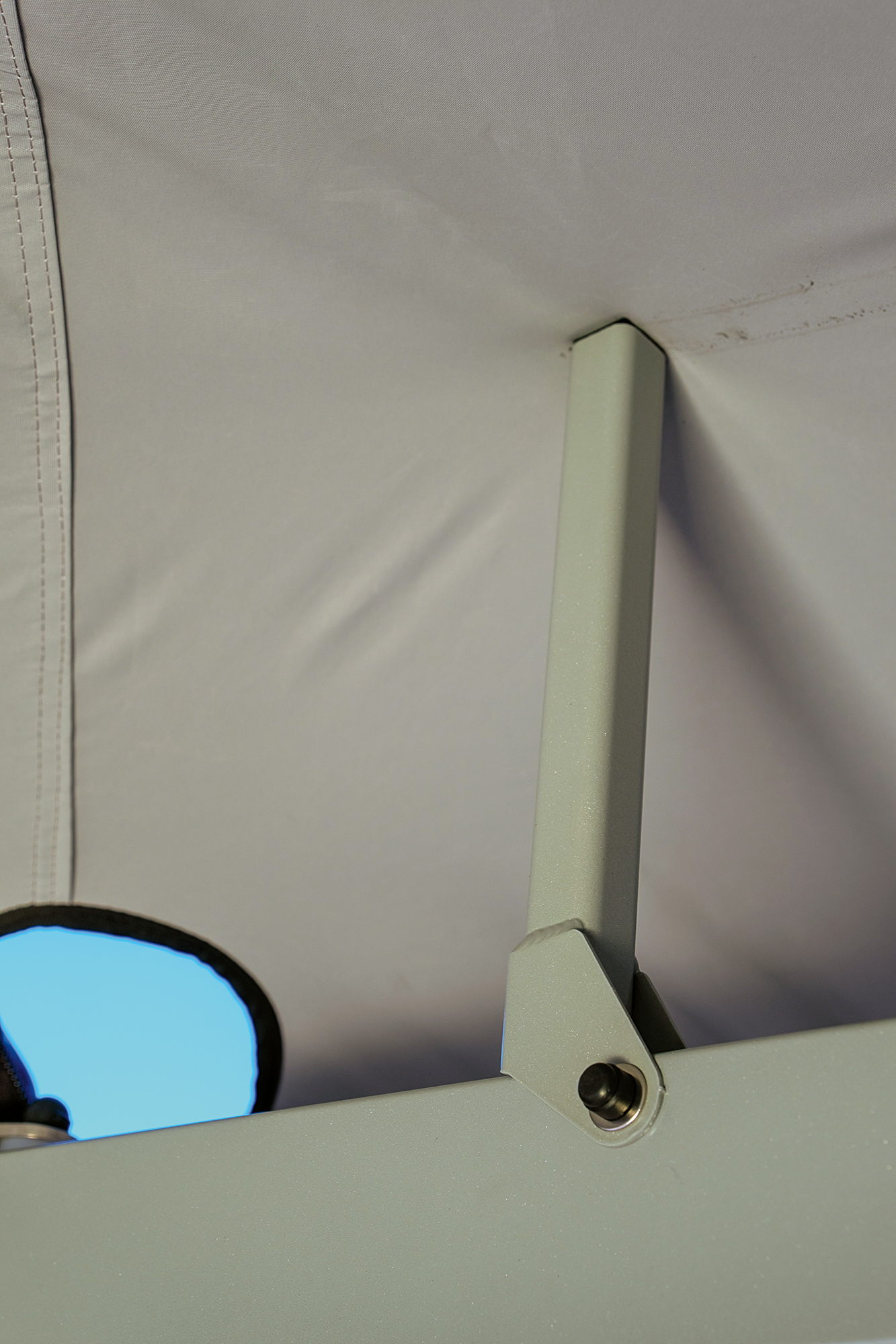

Alu-Cab founded their business on building custom trucks and specialty products for overlanders in South Africa. Their “if you dream it, we can build it” business concept led to projects ranging from simple drawer systems to stunning Unimog builds, but as the overland market grew they wanted to expand their business with it. To reach the masses, they unveiled a series of standardized products that could be shipped all over the world, one of which was the Shadow Awn. Installation of this model split the pack on time and difficulty. Although mounting points are pre-drilled, it requires you to punch two holes in the back of the bag to match the brackets. They also recommend riveting the strap to the vehicle’s roof rack, hardshell tent, or body which we decided to forgo for this test.
The UV-stabilized cover is ideally sized, just big enough for an easy breakdown but not so big as to flap in the wind. Its heavy-duty YKK zippers are amply sized for the task at hand and feel stout yet smooth during operation. This small detail is a big win, as undersized zippers are usually the first failure point on soft goods. South African manufacturers have long carried a reputation for good design with poor execution, yet this wasn’t even remotely the case with the Alu-Cab. The armatures, hinges, and supporting components are not only well thought out but produced with exquisite attention to detail. There were no unfinished edges or loose metal shavings, the welds and paint were flawless, and everything felt durable. It may be a mass-produced product, but it reflects the quality you’d expect from Alu-Cab’s custom pieces.
The Shadow Awn is also packed with small additions that make a big difference in usability and convenience, like a mesh stake bag riveted into the aluminum casing, so you never lose it, and guylines that store inside the armatures for quick access. One of our favorite features is the folding leg that deploys to form a high point in the fabric, preventing rain from accumulating during a storm. Even the fabric itself is innovative, a 270 GSM Tencate aluminized acrylic canvas which reflects the sun’s rays and reduces temperatures beneath the awning.
Deploying and stowing the Shadow Awn was a breeze, producing the second quickest setup time in the test, as well as the fastest breakdown time by a wide margin. Coverage was adequate, but at 107 square feet, it was the second smallest in the test. That being said, it was the most stable of any awning in the evaluation thanks to its robust arms and heavy-duty joints. Even in its freestanding mode, the Shadow Awn showed little deflection in the wind, which means you’ll be able to deploy it unsupported more often. Should conditions necessitate it, a single integrated support leg can be dropped down in a matter of seconds to brace the awning against the wind.
Noise was minimal on the road, thanks to the tidy profile of the bag, and the shakedown test revealed no notable rattles or annoying sounds in camp. During our rain evaluation, the high point we mentioned earlier helped the Shadow Awn to shed water quickly, preventing any accumulation on the fabric.

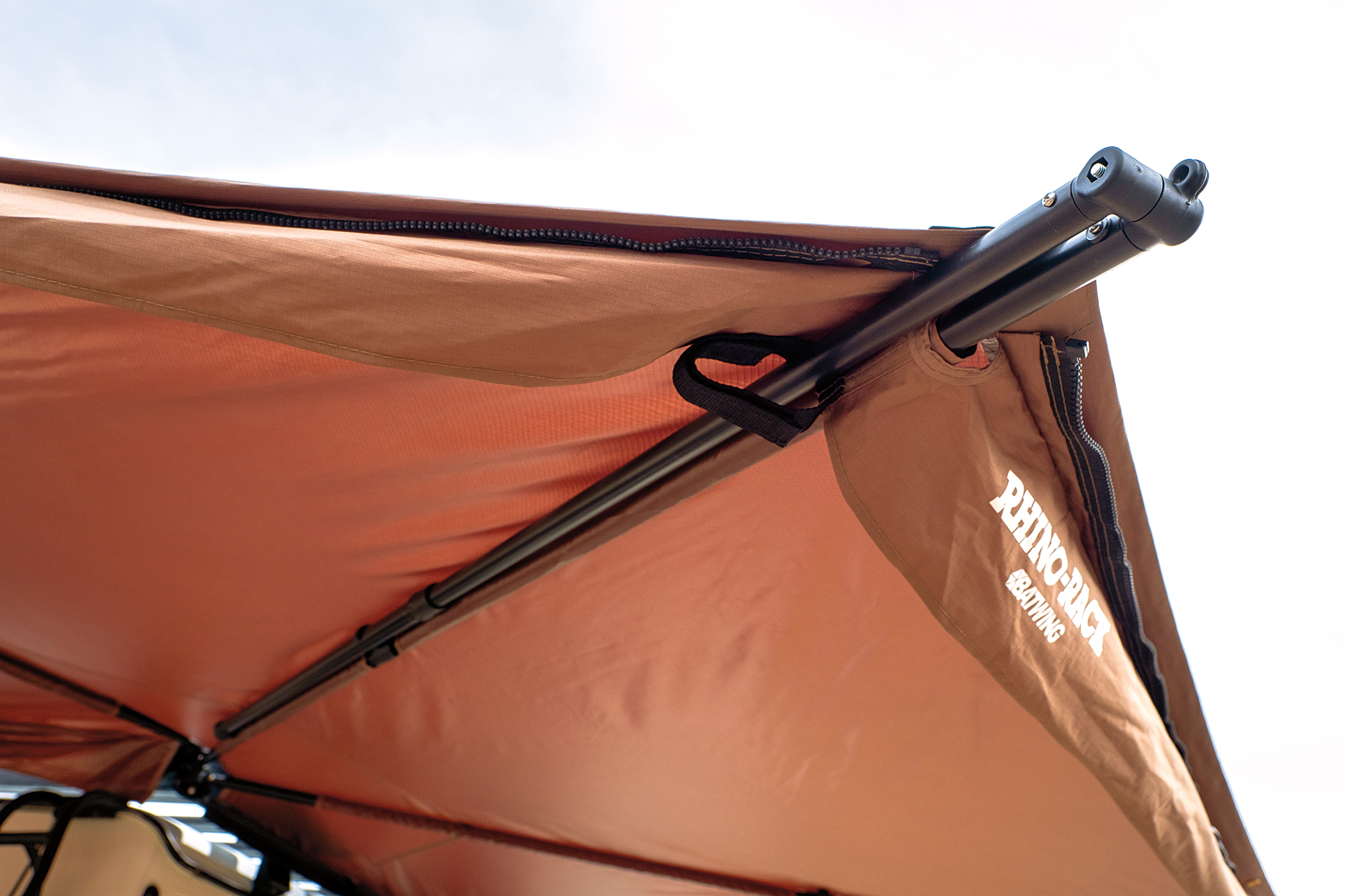

On the home page of Rhino-Rack’s website, you’ll find a brief paragraph introducing you to their company, where they use only two terms to describe their products: durable, and easy to use. This seems only fitting as those are traits that embody their Batwing awning.
Let me start by saying the Batwing is the most affordable awning in the test, and not by a narrow margin either. At $749, it is half the price of the Alu-Cab and Bundutec, and 35 percent cheaper than its nearest competitor, the Darche. Despite this enormous price gap, it managed to impress us from the very beginning.
Installation was one of the easiest in the test; it took only a matter of minutes to attach the brackets and tighten the bolts through the integrated track. The awning’s heavy-duty PVC bag was sized perfectly to the product while the generously sized zipper operated smoothly, leaving no question of whether it was up to the task of closing the cover. The combination made the product one of the easiest awnings to store overall, and one of the more enjoyable to use.
Fit and finish were top-notch, with no signs of metal shavings or wear and tear from shipping or production. The design was creative and thoughtful, with small features you didn’t even know you wanted until you saw them. For example, when stowing the awning, a small array of magnets hold the arms against the rear of the awning body. This allows you to use both hands to fold the fabric up and connect the straps, instead of fighting to keep everything together with one hand and folding with the other. The zipper at the front of the awning is also covered by a secondary flap of PVC, which prevents it from accumulating dust, bugs, and mud on the road. Then there are the support poles, which use a twist grip to tighten and loosen, but on the top half of the pole instead of the bottom, so you don’t have to bend down to adjust height. These support legs can also be folded away at full length, so you don’t have to make big adjustments each time you set up and break down the awning. This feature helped make the Batwing one of the easiest products to use, and the quickest to deploy with supports. It’s two seconds faster even than the Alu-Cab, which only uses a single support pole to the Rhino-Rack’s four. It makes sense that they put so much effort into making the legs quick to deploy, as the Batwing is the only awning in the test that cannot be used unsupported.
Noise levels on the road were minimal, thanks to a slim profile, and there were no discernible rattles during wind testing or the shakedown. Weight is the second lowest in the test, just a pound heavier than Eezi-Awn’s Bat at 47 pounds.
Performance in the rain was very good, as the Batwing’s ability to droop allowed water to run off the fabric easily. Even when the water was forced to accumulate, the 210D ripstop canvas showed no signs of leaking. In fact, it was the only awning in the test that couldn’t be made to leak through either the seams or fabric. The canvas is also mold resistant, tested to a UV50+ rating, and endorsed by Cancer Council Australia with a portion of each sale going toward cancer research.
