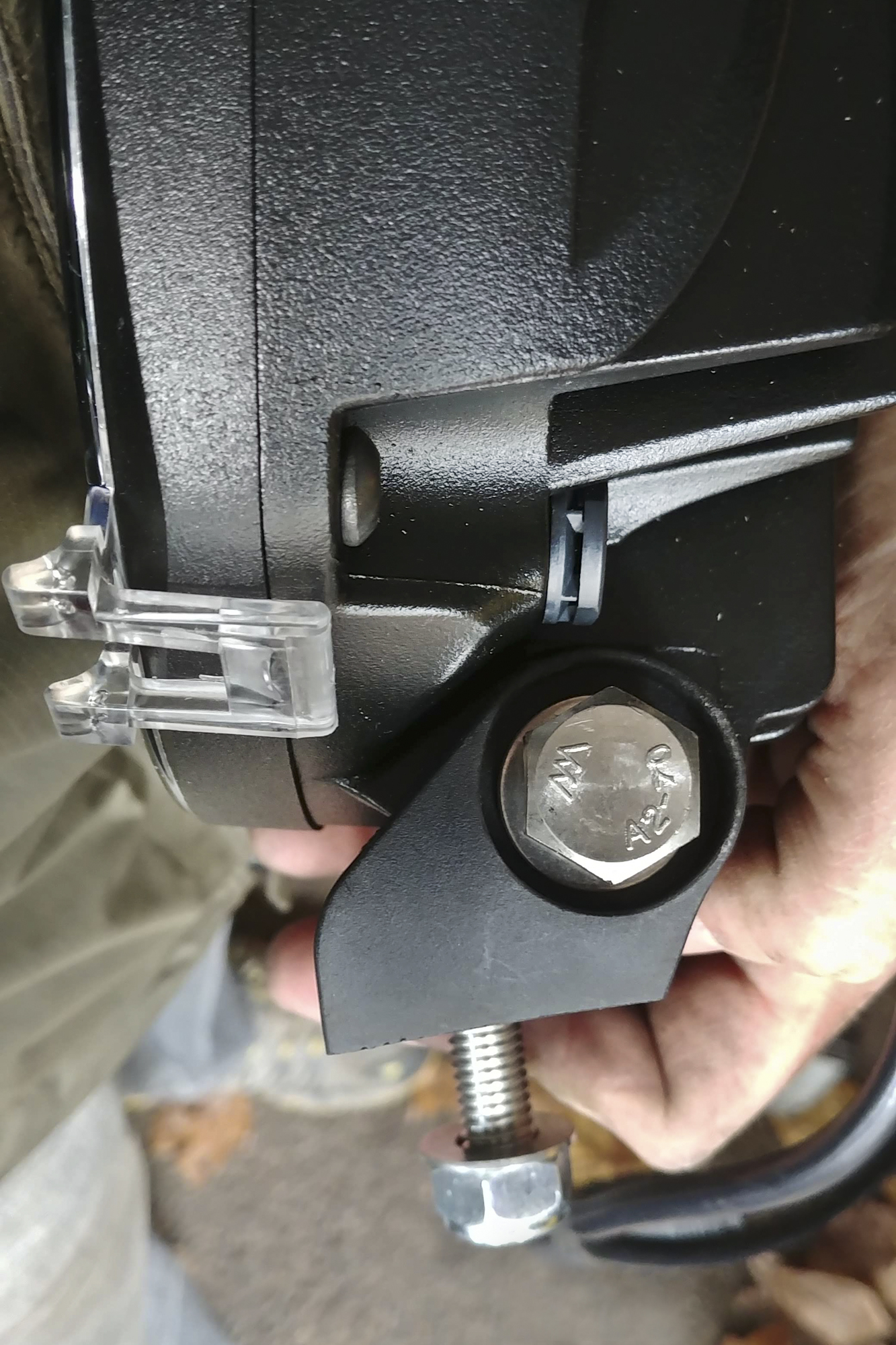

Genesis lights embellish both sides of our 1992 right-hand-drive Mitsubishi Pajero’s ARB front bumper, which has wiring allowances that made installation easier than projected. After installing the first light with a 17-millimeter socket wrench, we noticed an issue. The top of the powder-coated aluminum light housing was touching the bottom of the upper bull bar—that wouldn’t work. Luckily, Lightforce designed the Genesis LED lights with reversible brackets and after a few quick minutes, the bottom bracket was reversed and the problem solved. Everything else installed seamlessly.

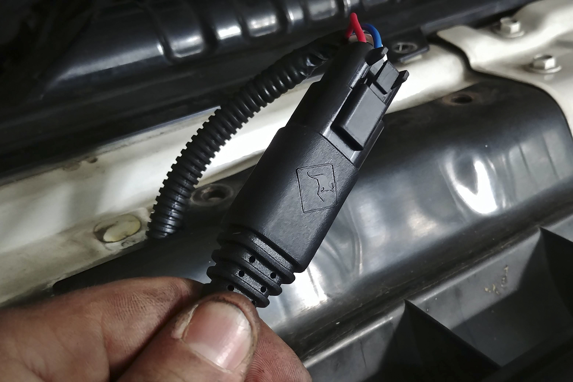

Lightforce Genesis lights come with two switches: the first switch is an on/off, and the second changes the lights to a dim mode (similar to a daytime running light or DRL). The switches are solidly made, are an adequate size, and have a bright red LED light that turns on in the switch when the lights are on.
These oversized LED lights boast a projection of 1 lux output at up to 3,455 feet—which is more than half a mile. They illuminate the surroundings fabulously and have a very long beam spread to light pathways with intensity. The Genesis lights include 13,850 raw lumens (7,336 effective lumens) and are fully sealed with an IP69K waterproof rating (the best available), which provides protection against dust and high-temperature intrusion, as well as high temperature spray downs, grime, and mud.
The Genesis model is sold individually and comes with a reversible mounting bracket, clear spot filter, waterproof harness adaptor, and stainless steel mounting hardware. Our installation included the Genesis and Venom LED wiring harness kit, which is sold separately at $79. These lights come with clear spot filters, but light blue or yellow filters are options as well. Black covers (with the same signature Lightforce logo) are also available. Non-clear filters/covers are sold separately.
