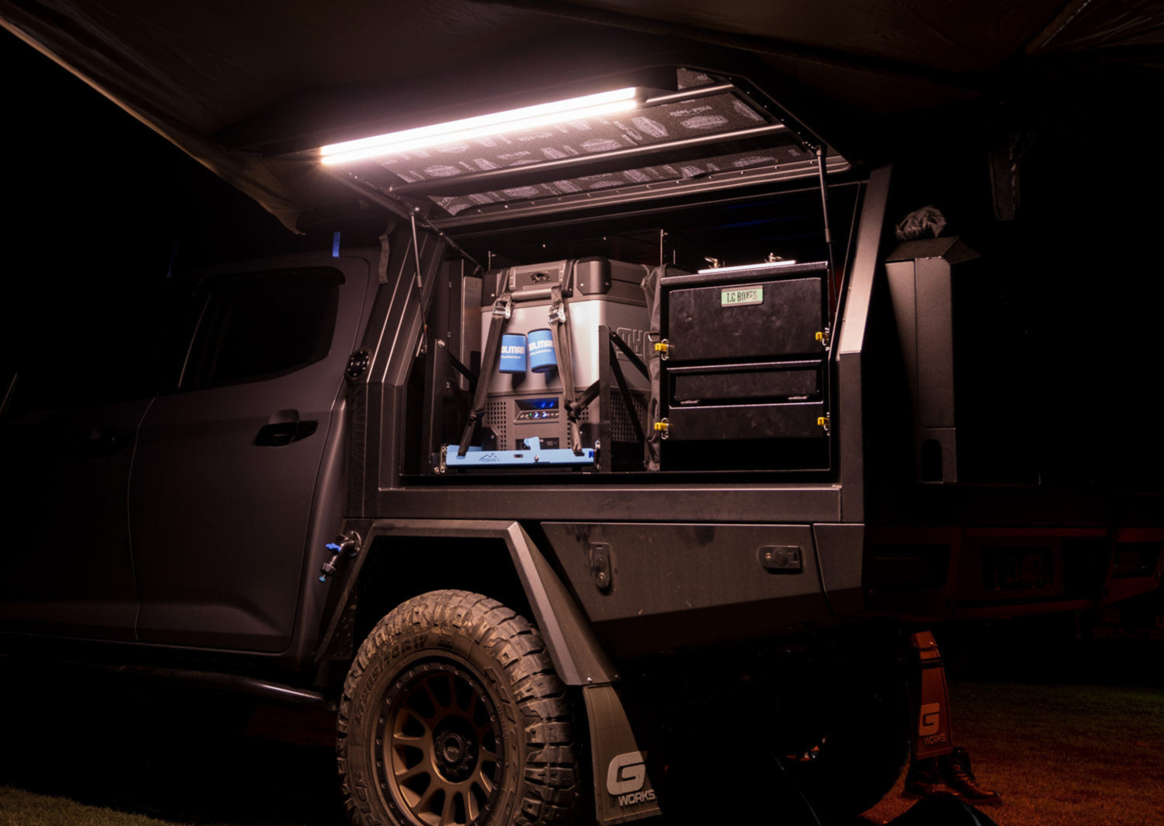

Prepared communities emphasize redundancy: multiple light types for multiple scenarios. Our kit includes road flare lights for breakdowns, head torches for everyday use, a magnetic light bar for vehicle mounting (our Land Rover’s aluminum body panels make that an interesting exercise), under-vehicle “pool lights,” fairy lights for ambience, and blue light use in desert environments to avoid stepping on something unpleasant. We maintain a dedicated storage area in the vehicle for lighting solutions covering every contingency. Now to get a flare gun.
