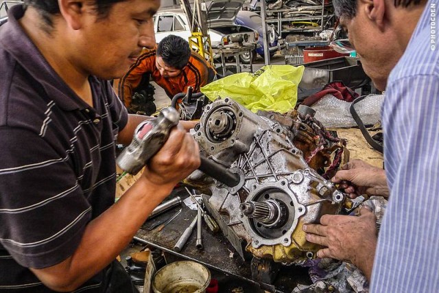

Dismantling the Gearbox
problem_2
I cleared the gearbox from nuts, bolts, covers, levers and wires. It just hung in rubber mounts on the bridge. When we commenced operation “drop the box”, I counted five of us, two hydraulic jacks, a crowbar and a piece of rope. I was sitting inside the Land Cruiser holding the rope from the top through the hole where the three levers normally stick out. I heard the guys arguing, cursing and cajoling in order to collectively lower the gearbox on the floor. I took the gearbox with a crane to the car wash station, which is part of the workshop, where a degreaser and a high-pressure gun worked miracles. Although years of Asian and Amazonian mud flew off the aluminum sides, the more stubborn red clay stayed put in the nooks of the reinforcement walls. I needed a toothbrush to clean most of it, but still some of it simply didn’t budge.
problem_3
We left the gearbox for what it was and concentrated on the seal between the gearbox and the transfer case. It was hard and dried out, without any flexibility left in it whatsoever, so that was a no brainer: it would have to be replaced, together with a few other gizmos we encountered. A big round shiny metal rod, which is called the idler shaft, had some wear markings on it, which is quite normal I later discovered, also needed to be replaced. It had to be seen whether we would be able to locally source one.

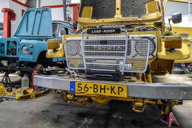

The Chassis and Fun Time
One Saturday morning, mechanic Washington arrived a few hours late because it was his birthday. He cleaned the chassis, welded the crack and put a reinforcement over it. The whole process took no more than an hour and we took the rest of the day to visit La Mitad del Mundo and other sites with the Santiagos – a father and son working on the son’s future car in the workshop, who had suggested to do some sightseeing with us.

  On the way back to Pedro’s workshop we picked up a couple of o-rings and the gaskets, so we were good to put the transfer case back on the gearbox. We also needed to address problems we found inside the transfer. Fixing a damaged thrust washer, fabricating a new locking shim that got damaged beyond use, and finding an o-ring to replace the burned o-ring [3 years ago in La Paz, Bolivia] on the overdrive rod.
problem_10
Remarkably we got all the pieces of the puzzle together and had the transfer case bolted to the gearbox in a jiffy. Time for the heavy work. You may think that lowering a heavy-duty gearbox is difficult, but I tell me you I envy you guys driving around in vehicles of which you can lower of lift the gearbox all by yourself. Luckily I was in good hand with Pedro’s crew. The same arguing, cursing and cajoling went on under the Land Cruiser as I held the rope again, meanwhile holding the LedLenser [read about it here] so that the guys below could see where to put the shaft. When the bridge was positioned under the gearbox, Freddy informed me that I was on my own from now on since he was quitting the shop and left me to it to fixate the box and reattach all the levers and cover.
