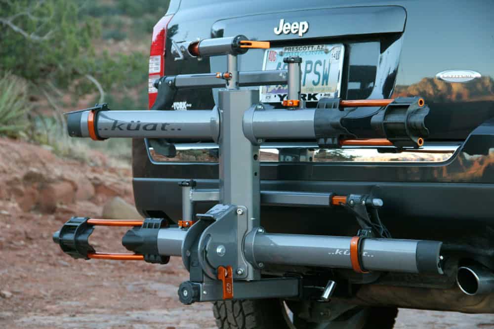

Kuat NV $550
DSCF5165 - Version 3
When it was launched just a few years ago, the Missouri based Kuat brand immediately won loyal fans with their handsome and refined racks. The anodized orange accents and soft edges of their NV rack caught my eye and prompted me to add one to my Jeep. With a design similar to the Thule T2, the rack does not contact the bike frame, accepts a wide range of wheel diameters and widths, and is easy to load and unload. The quill-style hitch retention system keeps the rack tight within the receiver and affords a tool-less installation, although it does require an additional pin with locking end-cap. A large lever allows the NV to be raised or lowered quickly with minimal effort.
The only rack I’ve ever tested to include a built-in repair stand, the NV is a great trailhead transporter. I often pop my bike on the repair stand to complete my pre-ride lube, air, and tweak. A built-in cable lock system keeps would-be thieves honest.
kuat_tiltkuat_detail
kuat_repairkuat_departure
kuat_clamp
Upshots
The repair rack is the standout feature but many people are drawn to the NV for its attractive design. These racks look fantastic hanging on a sporty SUV or wagon. Although it isn’t as easy to reach and use as the T2 Pro’s pivot release, the large lever on the NV holds securely and requires minimal force to actuate. The quill-insert in the hitch holds the rack snug, eliminating any unwanted side to side play.  The retention arms hold the bikes firmly in place, and the cable lock is beefy enough, I suspect it will give most passing crooks a reason to move on to easier prey. It is a very nice looking rack, which I think might be why most people, myself included, are drawn to it.
Missteps
After 10,000 miles of use, none of it on particularly rough terrain, my NV test rack has become prone to minor rattles, squeaks, and has developed some noticeable slop in the main pivot. None of that affects the performance. The ratcheting mechanism in one of the retention arms had to be replaced and there are some cosmetic issues developing, but again, nothing serious. I do want to put this in context. The Yakima also suffered a few minor issues as did the Thule. The last grouse with the NV is the inability to slide the bike trays side to side. Some pairs of bikes will have interference with each other which is hard to remedy with the NV.
kuat_folded
Conclusion
The Kuat NV is an ideal system for those users who want a sharp looking rack to compliment the sleek lines of their vehicle. The repair stand is a winner and helps justify the $550 asking price. Although my NV did suffer one minor warranty issue, the Kuat customer service team was exceptional and the fix was quickly implemented at no cost or inconvenience.
UPDATED NV: It is important to note that Kuat has recently updated the NV with the release of the NV 2.0. I am currently testing that rack and must say it is a significant improvement from tip to tail. It also gained an additional $80 and now fetches $630 making it one of the more expensive systems on the market. Read about that rack [HERE].

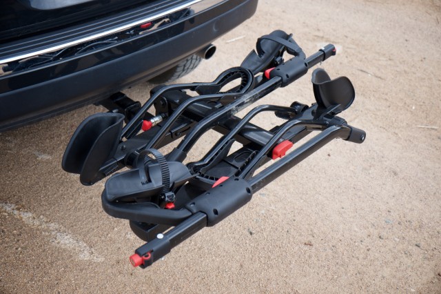

 Yakima HoldUp 2 $450
DSCF6505
The HoldUp is in many ways a hybrid of the Thule T2 and the Kuat NV. Nice looking and easy to use, it has a similar retention arm system and identical tilting features which place the rack in upright, level, and downward positions. Like the Thule, the HoldUp has retractable cable locks hidden in each support arm. Instead of a quill-style hitch insert, the HoldUp uses a threaded hitch pin to securely tighten the rack within the receiver.
Loading bikes is easy and the large front wheel trays accommodate all wheel sizes with some limitations, which I will address in the pros/cons. The support arms have been designed to clear wider fork blades and like the Thule, the bike trays can be adjusted side to side to eliminate any bike-to-bike interference, but again, the adjustment range seldom eliminates the problem. A feature unique to the HoldUp, the wheel trays can be folded inward when the rack is empty which reduces the size of the rack considerably. It makes for a nice, compact bundle.
DSCF6462
The tilt feature is not as useful as I’ had hoped as it doesn’t tilt far enough to clear most hatches.
DSCF6483DSCF6491
Upshots
One of the challenges with using this style of rack in rough terrain is the tendency for the front wheel to hop out of the wheel cradle. This plagued the T2 and Kuat NV on many of our test runs. The deep wheel supports of the Yakima never failed to hold the front wheel securely in place. The HoldUp is also slightly narrower than the other racks at only 64-inches wide. At $450 including locks, it is a good value and on par with Thule’s non-Pro T2 rack. The rack has a built-in bottle opener, so…yea.
Missteps
While the front wheel supports are deep, they are so wide that road bike wheels tend to feel loose in the cradle while fatbike tires simply will not fit. The rear wheel trays need additional straps to secure even plus-size tires, although that seems to be a common problem with all racks. The cable locks in each support arm are also quite short and rather thin. I don’t know if they would deter a would-be thief. My biggest complaint is with the release pin on the main pivot. It is difficult to reach and requires some fiddling to actuate. It has also pinched many fingers although now I’m getting a bit nit-picky.
My other hesitation with the HoldUp is with the somewhat uncertain build quality. With so many pivots and moving parts, the other HoldUp racks I inspected on friend’s vehicles felt a little knackered and developed a noticeable degree of slop and play at critical points. I don’t know how much rough usage they had endured, but there is a lot of complexity with the HoldUp, and that could be its weakness. The necessity to use a tool to tighten the threaded hitch pin is something I presume Yakima will address with the updated HoldUp, scheduled to arrive early next year.
DSCF6467
Conclusion
As racks get more expensive, the HoldUp’s MSRP makes it a good value, although it is similar in feature to Thule’s T2 Classic at the same price once you factor in the cost of the addition of bike mount locks. I think the Yakima is a nicer looking rack than most and the compact size is attractive. When not hauling bikes, and folded and stowed upright, it looks really slick. Although it isn’t the best solution for fatbike use, it is nonetheless a nice rack and I enjoyed using it. www.yakima.com
