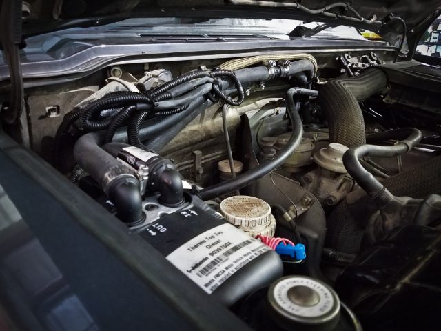

The Webasto Thermo Top Evo programmable coolant heater works on a vehicle’s battery and fuel—no AC electricity needed. While gasoline-sipping variants are also offered up, we had a diesel-powered unit installed by the licensed Webasto experts at Bend, Oregon’s EarthCruiser.
A low draw from our Optima batteries powers the dash-mounted programmable timer as well as the fuel and coolant pumps. The main unit (which is the size of a small shoebox in the engine bay) ignites fuel from our Long Range Automotive diesel tank to heat and circulate the coolant to keep the engine warm.

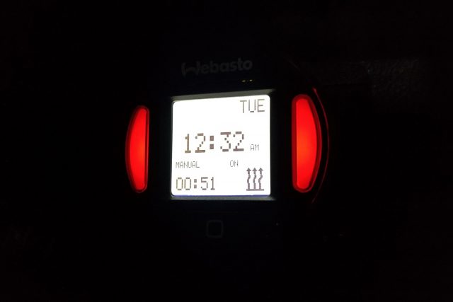

The programmable SmarTemp FX 2.0 timer sits dark until we push a button or move the dial on the outside of the LED face. Managing the timer takes a bit of getting used to, and the dial’s reaction time is slow; however, programming features can adequately be completed. The Webasto can turn on at any point in the morning and run as long we want—this was critical to starting our Pajero.
Other features include 12- or 24-hour time preference, the opportunity to lower or raise your low-voltage disconnects setting (LVD), and engaging the system in automatic or manual modes. Also offered up are troubleshooting sections and more.
Once the system turns on, bright red lights illuminate each side of the timer, and the countdown begins. Three up arrows signify the system is working to warm the engine. Additionally, the timer shows the day of the week, the time of day, and on the lower-left corner, how much time is left for the system to run.

The Thermo Top Evo system is designed to cycle on and off; its frequency is dependent on how cold it is outside. The exhaust pipe is routed under the vehicle and dispels exhaust. Some days, we saw no steam, but in Fairbanks during -40° temps, oversized billows of exhaust wafted out of the Pajero’s underbody. Alarmed, I rushed to our rig, just to learn all was running smoothly—it was severely frigid that morning—everybody’s tailpipe exhaust displayed huge cotton- candy-looking clouds.
