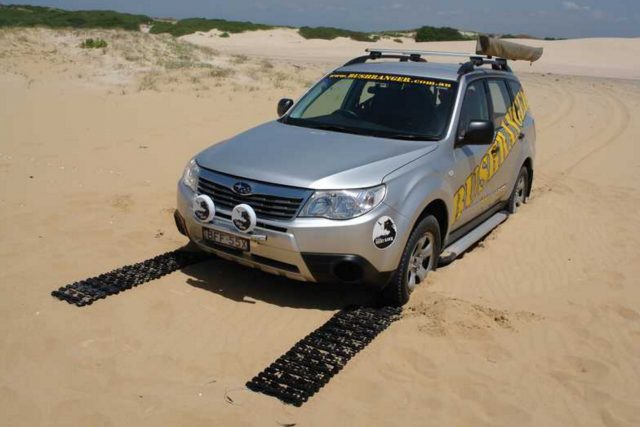

Bushranger
Bushranger’s mats are pliable tracks made of sections of heavy-duty rubber joined with lengths of reinforced cable. Each track can be rolled for easy portage and is designed to work with the natural contours of the surface below the tire for maximum grip.
X-Trax II
Screen Shot 2017-01-03 at 3.45.40 PM
Price: $249.00
Material: Rubber and steel cable
Dimensions: 55″ long, 11.8″ wide
Max weight capacity: N/A
Weight: 36 pounds/pair
www.bushranger.com.au

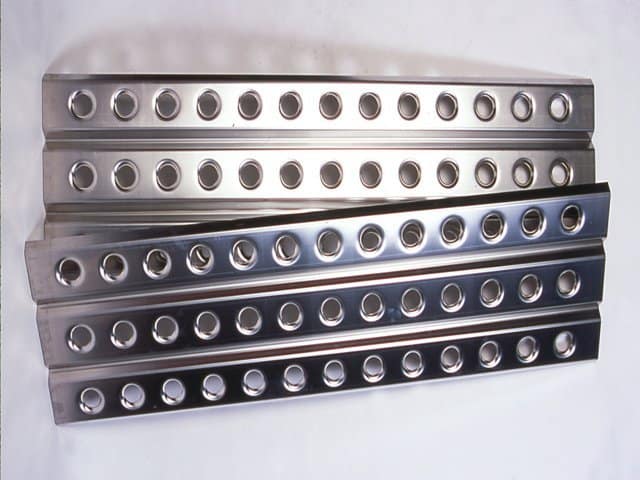

Alloy Bridging Ladders
Screen Shot 2017-01-03 at 4.25.54 PM
Price: $650
Material: Aluminum
Dimensions: 49″ long, 15” wide
Max weight capacity: undisclosed
Weight: 42 pounds
www.roversnorth.com

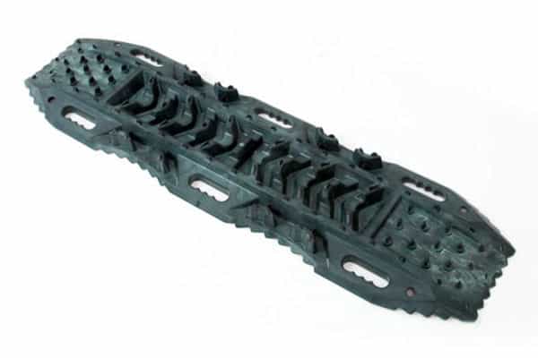

TRED
New to the market as of 2012, TRED has become widely accepted and distributed throughout North America and within their native Australia. Their most recent product uses an innovative dual-compound construction that reinforces the lugs to prevent them from damage in a recovery scenario. Computer aided lug designs also allow the sides of the mat to better connect with the water purging channels on most tires.
TRED Pro
9f617c6bcf404d3af894876126dc85e8_original
Price: $299
Material: dual compound-composite
Dimensions: 46″ long, 12” wide
Weight: 17 pounds/pair
www.tred4x4.com
