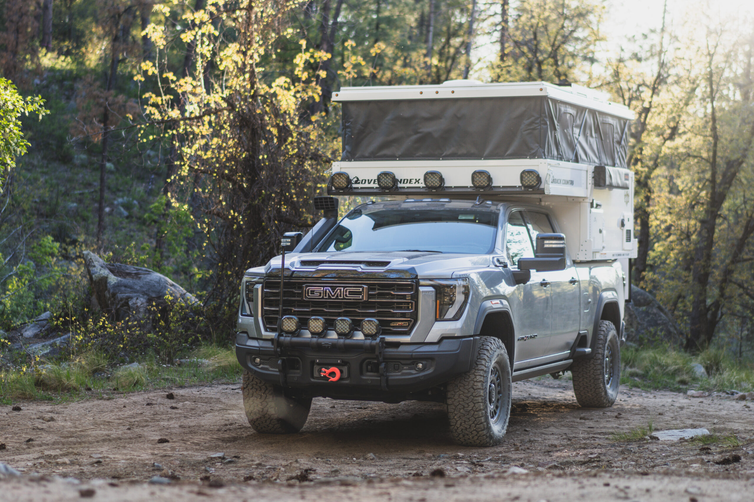

AT Overland Aterra ASI Hardside
1,157 pounds | $47,399 (as tested)
Engineered to outlive the owner
AT Overland has been around since the earliest days of the overland industry, manufacturing some of the most capable and durable campers on the market. Their Aterra tray camper is renowned for being constructed for around-the-world travel in four seasons. Mario and his team have now added to the lineup with their new slide-in camper called the Aterra ASI. The camper stands out for its fair pricing and extremely lightweight design, coming in at under 757 pounds as the base shell.
From a durability perspective, the Aterra ASI is built with angled roof sides, reinforced metal corners, and a seamless spray-on coating. The entire assembly is pinned and bonded in a jig to ensure repeatability and the strongest possible structure; it looks more utilitarian than most, lacking the gel or automotive finish that some buyers prefer. The engineering and construction process produces one of the lightest campers in the test, even with a full complement of house systems. The durability extends to the mounting system, which is unique in the industry and utilizes bolt-in centering brackets specific to each truck model. The plates center the camper forward and aft, as well as side to side, while preventing it from contacting the forward bed bulkhead (most half-ton trucks cannot support a camper against the bulkhead).
The Aterra ASI is modular in its configuration, allowing the buyer to choose from an empty shell all the way up to a complete home on wheels. Each module can be specified or added at a later date, all with an emphasis on store capacity. The Aterra ASI has the best storage configuration of the test, utilizing lightweight and removable Step22 bags, all of which feature Velcro label tags. The cabinets are constructed from premium plywood with a hexagon pattern and mold- and moisture-resistant coatings. The countertops are bamboo with a smooth, oiled finish. While the layout is somewhat unconventional, the table can be used as a standing desk, and it eschews the typical dinette for more storage, standing room, and counterspace. The sink sits in the passenger rear corner and utilizes the Dometic USB chargeable pump/faucet, a simple and easy-to-replace solution.
The bed is configured for either a north-south (N-S) or east-west (E-W) layout, with the N-S resulting in a king-sized sleeping area. A panel pulls out from the camper bulkhead and extends on slides to several stopping positions. For most users, it will be best to sleep E-W as the extended bed covers the porta-potty and much of the counterspace. The E-W is comfortable for two adults, even those of above-average height. The mattress is comfortable, and the slatted panel serves to control moisture and mold under the bed. The Truma heater is thoughtfully installed at ceiling height with the vent facing the bunk to keep you cozy in any weather, and the cushioned floor feels luxurious on bare feet.

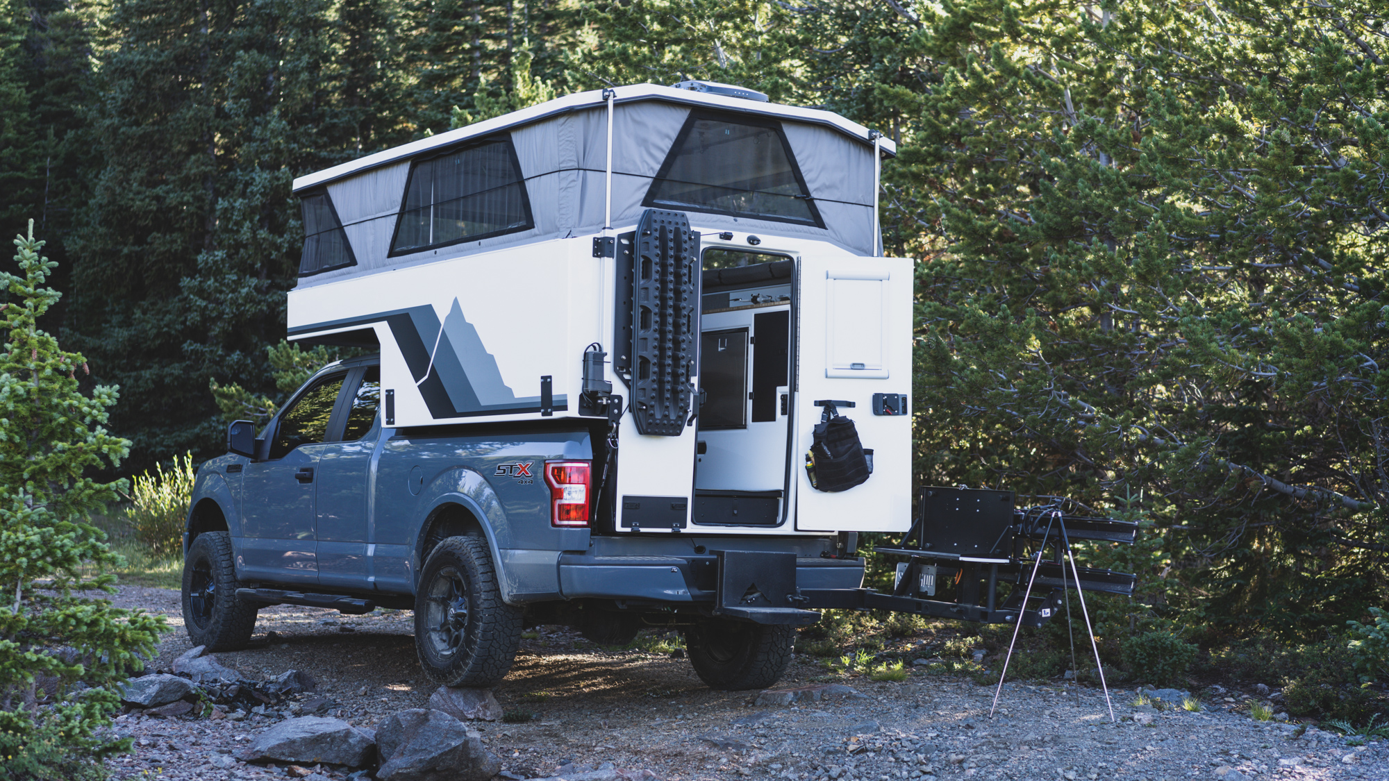

Four Wheel Campers CampOut | VALUE AWARD WINNER
1,270 pounds | $36,000 (as tested)
The OG is still one of the best
The Four Wheel Campers CampOut represents a fresh approach from this longstanding and respected manufacturer. The newest model aims to merge durability and affordability, with a starting price of approximately $25,000. The update offers a modern, smooth-sided aesthetic with functionality that appeals to new buyers and seasoned travelers alike. Fabricated to fit a half-ton pickup, the CampOut boasts a lightweight composite skin over a robust welded aluminum frame, ensuring long-term durability while presenting a more modern appearance.
One of the most notable features of the CampOut is its modular design, which includes separate power, a galley, heating, and storage modules to build out the interior based on needs and budget. The base model comes equipped with two cabinets (additional ones can easily be added), dinettes, power modules, fridges, and bed extenders to meet their needs. The camper includes a queen-sized bed, and the height of the lifting-roof sides is notable, adding to headroom and contributing to a feeling of openness.
The CampOut is equipped with numerous access points for 120-volt, 12-volt, and USB power, including a shore power RV plug, an onboard inverter, and a Starlink mini connector. The attention to detail is consistent with previous 4WC models, with features like a premium Alu-Cab awning for shade, aircraft tie-down channels for securing gear, and a thoughtful layout that includes an outside shower and storage options. The Truma heater is a quality option, but the vent placement directs the heat at the fridge instead of the bunk. There isn’t a provision for an inside shower.
I like the dinette for working, but the lack of backrests is a damper on more relaxed activities such as reading. The driver’s side dinette backrest is also a window, which makes for a cold place to lean back on.
The Four Wheel Campers CampOut is an innovative new option from a well-respected and high-quality company. The modular design enables buyers to tailor the camper to their whims and budget, while helping to future-proof the unit as new features are introduced. It’s an ideal camper for two occupants who plan on taking the road less traveled.

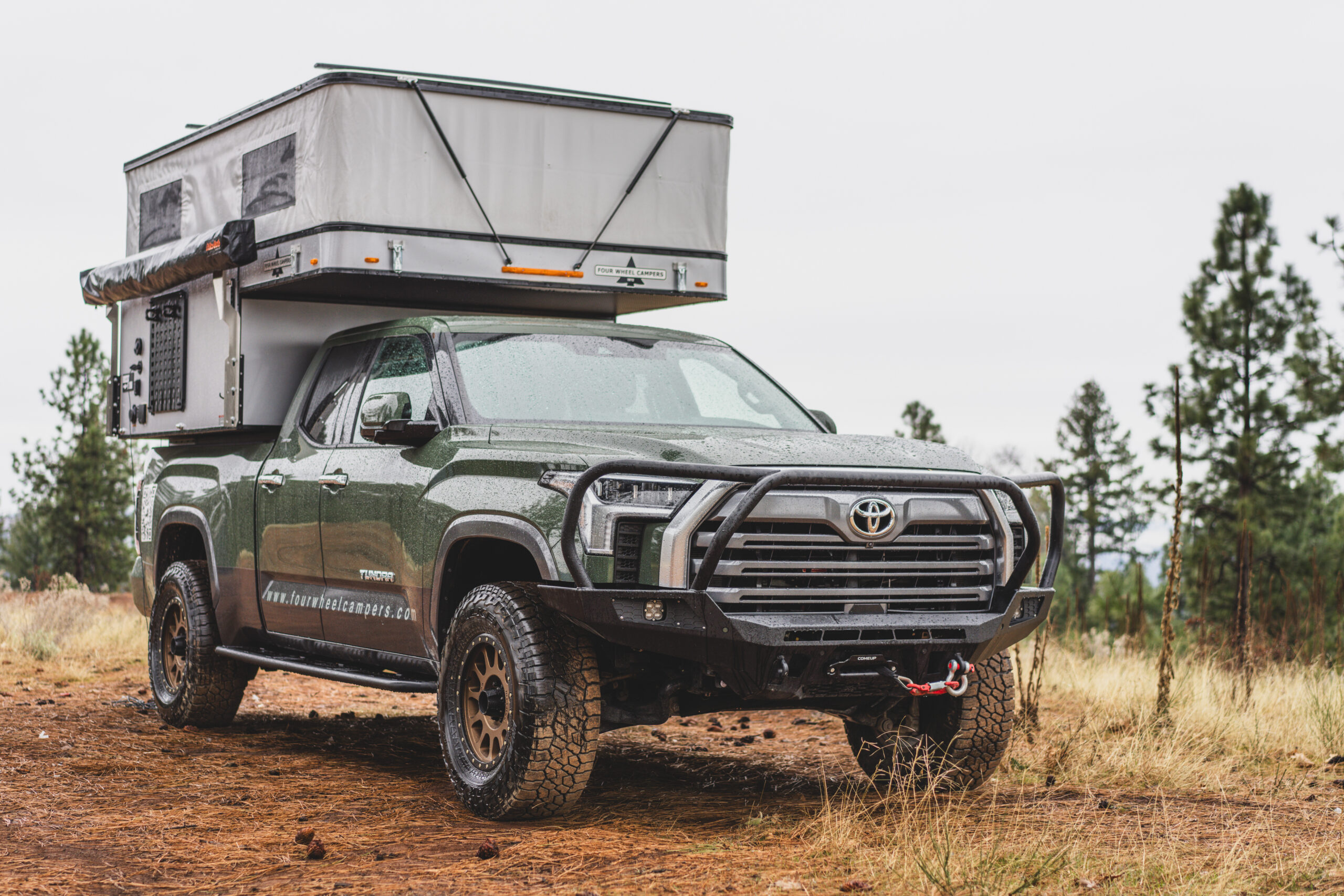

Overland Explorer Vehicles (OEV) Backcountry 6.85
1,500 pounds (without jacks) | $52,000 (as tested)
Durability and four-season capability in a pop-up
Overland Explorer Vehicles (OEV) is unique in the industry for offering true four-season capability out of a pop-top camper. Units feature robust construction, extensive standard features, premium components, and high-wear materials. In discussing these campers with owners (such as Senior Editor Ashley Giordano), they are intended for long-term travel in harsh conditions.
The Backcountry uses composite panels bonded to heavy-duty metal corners, providing good insulation (R8). The heavy-duty extruded aluminum corners and joints enhance structural integrity and impact resistance. Thermal bridging is addressed by affixing padded and insulated strips to the aluminum frame (we did not experience any condensation buildup at the frame). This combination ensures that the camper can withstand the challenges of overland travel, including potential damage from branches and other obstacles.
The camper’s four-season design is a significant advantage for those planning to travel across continents, featuring a four-layer soft-wall insulation system with a value of R4, helping to control condensation while improving heater efficiency. OEV’s campers are engineered and produced in Canada, so rain, snow loads, and extreme cold are all factored into play. It’s one of the few campers in this test with an integrated air heater (Truma VarioHeat) and an on-demand hot water heater (Truma VarioHeat). Unfortunately, the camper does not include an inside shower configuration, which belies its cold-weather intentions. The heater vent is not in an ideal position, with the airflow directed toward the dinette instead of the bunk.
Weight is a consideration in the backcountry, as factory options, exterior storage lockers, and battery capacity can quickly place the unit outside of gross vehicle weight (GVW) for most half-ton trucks. This unit will be most at home on 3/4- and 1-ton platforms, such as the GMC AT4x AEV diesel we tested it with.
The camper is a comfortable home away from home, with generous storage, a large sink, and 20 gallons of freshwater storage. There are tall storage cabinets that will easily swallow overland gear and clothing for two travelers. An integrated two-burner stove features both induction and propane options, and there is a Dometic sink with a high-pressure pump, hot water, and a fold-down cover to extend counter space. The dinette is roomy with an adjustable table and offers the option of sleeping on the cushions in extreme weather (with the top down). It is worth noting that the cushions are both thick and yet undersupportive, with the added discomfort of not compressing quickly when first seated (the air does not escape properly during compression).
The Backcountry is a premium expedition-grade camper that comes with the expected additional weight and higher initial cost. It is perfect for a heavy-duty pickup and can be specified as a tray model for custom applications. My criticisms of the model are few, and these units have already served our team well on three continents.

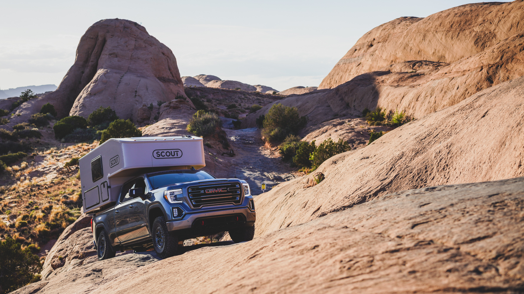

Scout Kenai Hardside
1,247 pounds | $33,520 as tested
Impressive confluence of light weight and spacious living
Scout has entered the scene with momentum, launching one new product after another out of its Washington factory. The goal of producing affordable, durable, and lightweight campers at scale has resulted in a nationwide dealership network and seven models in less than five years. The minimalist design and spartan interior are ideal for most overlanders, combining durable materials with reliability through simplicity. I purchased this camper for personal use and tested it for many years on my GMC 1500 AT4.
For many travelers, the most critical consideration is weight, as many are running half-ton pickups or heavily modified heavy-duty models. The Scout features a 1,100-pound dry weight in its most basic configuration, although most customers will order units closer to 1,300 pounds. With the camper jacks removed and a few other items (like the bed extension pads and support) taken out, you can get an even lighter Kenai. The camper is constructed from reinforced, multi-layer composite panels supported by aluminum extrusions to protect the corners. There is no plumbing (other than a 7-inch sink drain hose) and no 120-volt wiring. The cabinetry is made from durable plywood, finished in dark gray, and is devoid of drawers or doors, resulting in nothing to fail and that ever-important weight savings. Simple soft-sided organizers from Dometic and Red Oxx kept everything in its place for me. For 12- and 120-volt power, I used a Goal Zero Yeti 1500x lithium power station, which includes USB-C, 12-volt, and 120-volt inverter capabilities, along with a solar charge controller. The Scout has a 180-watt solar panel on the nose cone, which has met all the camper’s modest power needs. The Goal Zero does have an optional 50-amp charger to run off a 7-pin connection, but it failed after about six months of use. Scout has since upgraded their power systems to incorporate proven components from Xantrec.
Beyond its low weight, the Kenai has one of the most generous living spaces in the test, with a shower pan and toilet cubby in the rear. The unit can be specified with a cassette toilet or (in my case) fitted with a composting unit. It was possible to fit a Dickinson fireplace, which was admittedly one of the reasons I bought the camper. As of this printing, you can fit a diesel heater, or the owner will need to install the Dickinson after delivery. The bed is roomy for two and can be used comfortably without the bed extension in an E-W configuration. The Kenai can be installed on 6.5-foot or 8-foot beds and is now available in a pop-top model as well. I spent over two months living in the Kenai, and it became my home on wheels.

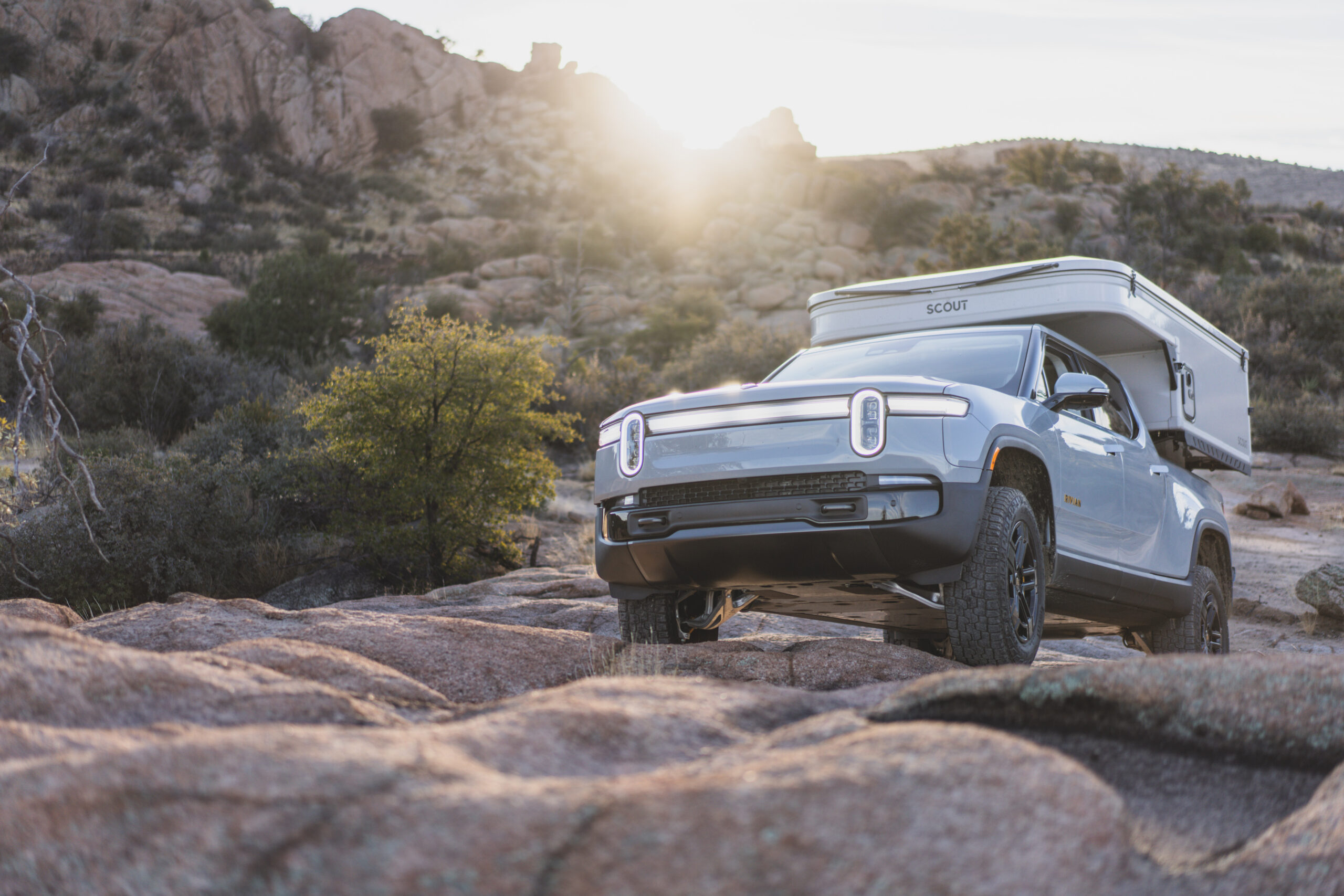

Scout Yoho Pop-up | EDITOR’S CHOICE
937 pounds | $30,885 as tested
The around-the-world camper for all roads
The Scout Yoho Pop-up proved popular immediately upon its release due to its modern, minimalist design and light weight. At 937 pounds in base trim, the Yoho is one of the lightest campers available, allowing for excellent performance in backcountry conditions and the possibility of working with the low payload ratings of mid-size pickups. The lifting roof with its sloped sides and rounded corners reduces wind noise and increases fuel economy while simultaneously improving trail clearance and allowing the vehicle to fit in a container for international shipping.
The exterior features durable composite panels bonded to metal corners, and is finished in a durable tan color to complement most trucks. The lifting roof is equipped with 100 watts of solar.
One of the Scout Yoho’s key advantages is its compactness, which lowers the center of gravity and overall height of the vehicle. It’s capable of fitting into tight spaces, navigating narrow trails, and even parking in garages. Additionally, the camper can be stored in high cube containers for shipping, enhancing its versatility for international travel. The well-thought-out external features include accessory rails for mounting gear, as well as removable lifting jacks that save weight and improve maneuverability on challenging terrains.
Despite being designed for a 5- or 6-foot mid-size truck bed, the interior feels open and uncluttered, thanks to large windows and the lack of overhead cabinetry. It maximizes usable space and retains a dinette for working or sleeping (a great spot to read, too). The interior is free from 120-volt wiring and leak-prone plumbing. There is a single 7-inch length of drain tubing that comes from the bottom of the sink and empties onto the ground or into a bucket. Their system uses a LifeSaver jerrycan, which is nicely made, but I have not tested one that didn’t leak, particularly from the spray hose. There is a small porta-potty cubby, in which I stored the new Trelino compact composting toilet.
The camper features an upgraded power system with Victron components, providing 120 amp hours of 12-volt power. I supplemented that with an EcoFlow portable power pack and a 2,000-watt inverter. The combination of those two batteries can run my induction cooktop and the electric air heater/AC unit I am testing. Scout offers an optional diesel heater that mounts to the back camper wall. My one criticism is the lack of a shower pan in the entry door opening (the Kenai has one). There were also some finish issues with the wood countertops and table; all were resolved under warranty (the wood has already been changed for future units).
