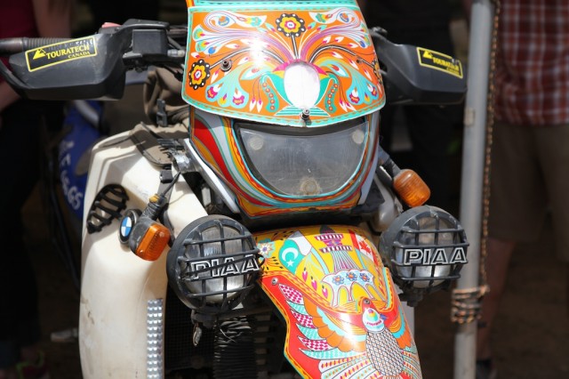

 Farkles
Although it’s not unique to two-wheeled vehicles, motorcycle owners love to personalize their machines with a menagerie of hand selected accessories. These functional sparkles, otherwise known as farkles, can at times take a turn for the worse. If your cockpit is adorned with GPS units, drink holders, stereo speakers, phone mounts, and other gadgets, you may have gone a farkle too far. Simplicity is at the core of motorcycle travel and the more stuff that is bolted to a motorcycle, the greater chance of a failure. Many riders take this to new lows with garage-made farkles of questionable design and fabrication. In other words, hanging that homemade reserve tank off a frame member may not be a great idea. It’s best to inoculate yourself against Farkle Fever.
