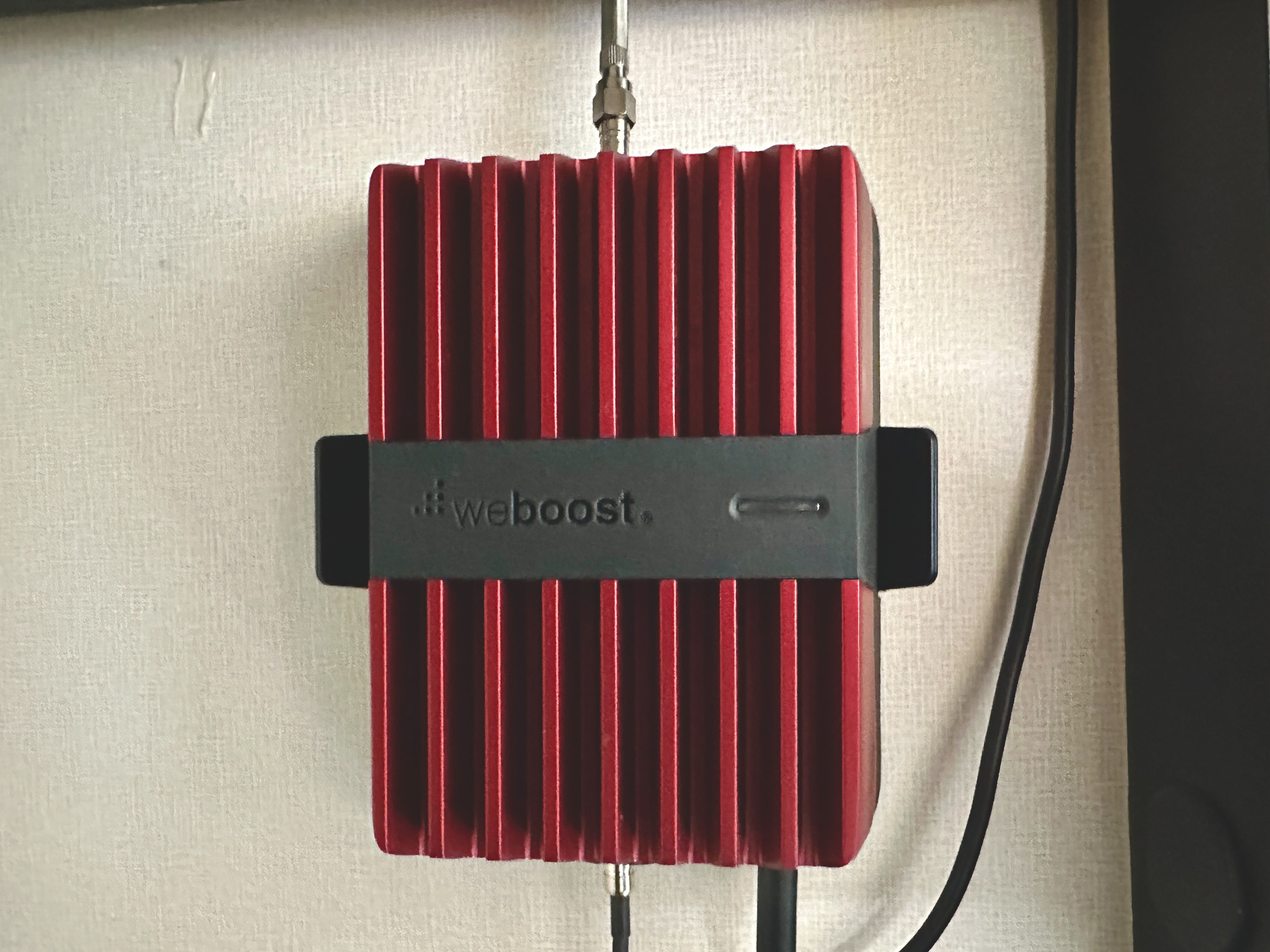

weBoost Drive Reach Overland (Value Award)
A classic American success story, weBoost was started by Jim Wilson in 1997 when he struggled to maintain cellular connectivity while traveling. Wilson should also ring a bell for earlier products, as they are the same company that brought Wilson antennas and CB products to the market in the late 1960s. The company is located in St. George, Utah, and has been a regular advocate and participant in the overland community. Their products have evolved considerably from the early booster iterations, now providing overland-specific models like the Drive Reach Overland we are testing here.
The most important thing to understand about cellular boosters is that they work as advertised but cannot create a signal where one does not exist. Products like weBoost improve cellular performance in multiple ways, resulting in better call quality and faster download/upload speeds. The most important feature is the antenna, which should be mounted high on the vehicle and above the tallest solid object mounted to the roof or rack. The Drive Over the Road (OTR) antenna has numerous mounting options and extension rod heights. It can be mounted on a spring or on a hinged base, which allows the traveler to either leave the antenna up all the time or fold it down to limit tree or overhang damage. It draws 1.5-2 amps at 12 volts, which is manageable by most house electrical systems or smaller power stations.
In general, systems like weBoost are the best first step toward remote communications, as they solve the needs of most travelers and work across all of the mobile phones and hot spots in the travel party. They are best paired with a hot spot device or a mobile phone that can be left on the interior antenna. Most complaints with the solution stem from a need for more understanding about how the amplification works, expecting the boosting to work in a large area or the entire interior of the vehicle or camper. I like to use a mobile hotspot set directly next to or on top of the interior antenna and then have Wi-Fi broadcast to the broader network of devices, phones, tablets, and laptops. During my several months traveling the Western United States, this was the primary data solution for my needs and even worked well in motion. The added benefit is the lower long-term cost, as there are no monthly fees for its use. Only the most remote locations demand a satellite connection.

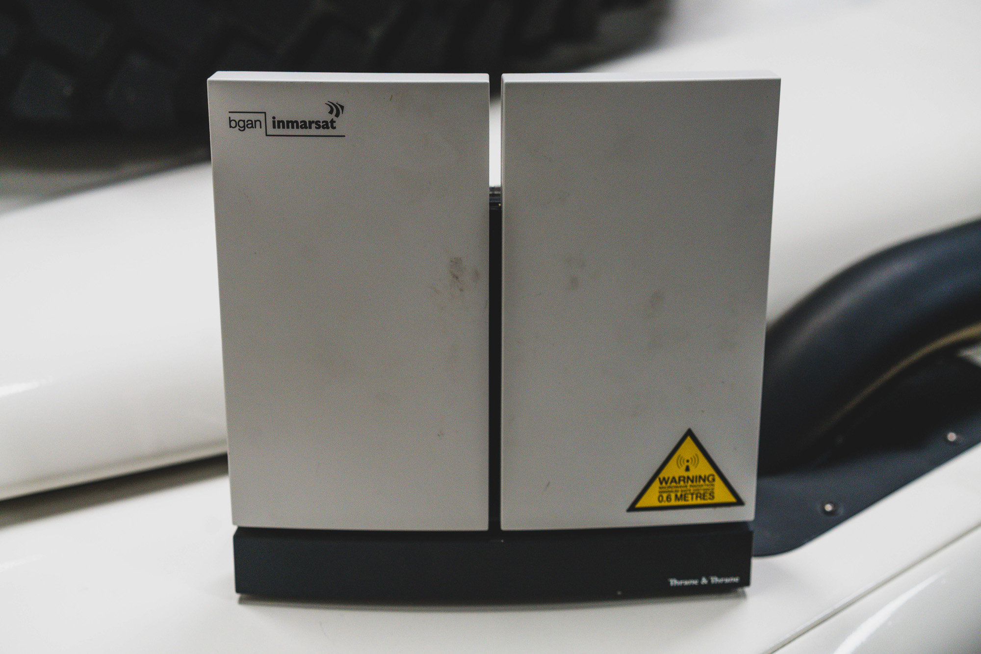

Editor’s Note: BGAN
An article on remote communications would only be complete with the inclusion of BGAN, currently the only compact, portable, low-power broadband technology with global coverage (excluding the highest latitudes). While governments and industry most commonly use BGAN, it is appropriate for some overland travelers who require a data connection for their style of travel or professional needs. The BGAN may be the only way a prominent CEO can escape into the backcountry, and she has the budget to support the connectivity expense.
The BGAN terminal is typically the size of a laptop and combines the antenna, battery, and Wi-Fi router into a single unit. The terminals cost between $2,000 and 8,000; data rates come in at about $7 per megabyte. Voice call fees vary on the data package but should be budgeted at $1 per minute. Download speeds vary based on the connection, with the HDR providing rates up to 800 Kbps or even 1 Mbps with terminal bonding.

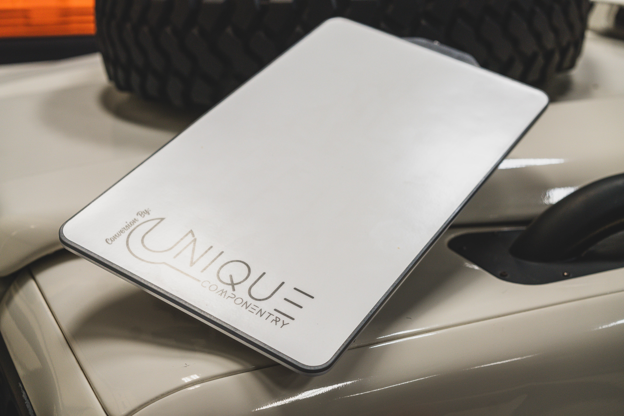

Unique Componentry Starlink 12-volt Conversion
While Starlink functions fine in stock form, it has several limitations for overlanders. The first challenge is setting up and breaking down the Starlink with each camp, and the mounting solutions could be better, adapting mounting arms or (like I did) running the antenna on the top of the camper when parked. The second issue is power draw, requiring at least 2 amps to operate—but the kicker is that it is 2 amps at 120 volts, which is calculated to be 22 amps at the 12-volt batteries! Our testing demonstrated a much lower number than that on average, with our 24-hour shunt data showing 5.7 amps at 12 volts. But this is still high and nearly twice the amps of a typical fridge. The last limitation is portability, with even the most compact Starlink RV taking the size of a 40-liter AluBox to store. Enter the Unique Componentry conversion.
Unique Componentry is a small, overlander-owned business that found a need and filled it, converting a standard residential Starlink antenna into a 12-volt, flat-mount unit that is only 1 inch thick after machining. The conversion to 12-15 volts results in a more efficient Starlink, drawing only 2-3 amps, which is less than half the stock draw. The unit can be hard-mounted flat using the four 1/4-20 inserts, magnetic articulating round feet (our choice), or 3M adhesive feet. The conversion is weather-sealed and dust/vibration resistant, using a fully potted fill and finish machining. The power supply and router are fully incorporated into the unit. Like magic, it fits in a carry-on-sized nylon case for fly-and-drive opportunities. This conversion takes the best mobile satellite data solution and makes it the best for overlanders.
$1,000 | uniquecomponentry.com
