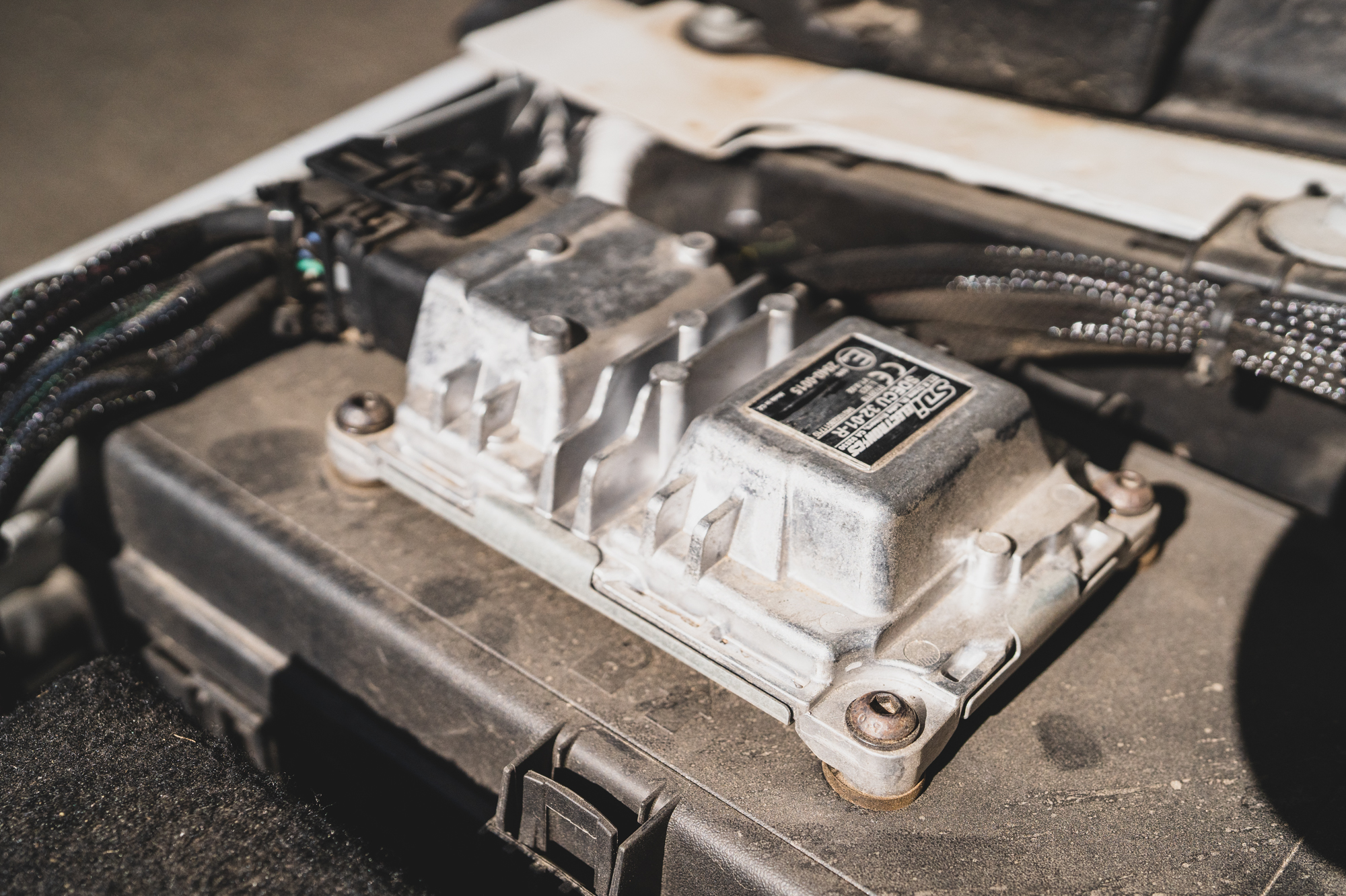

e-click ECU

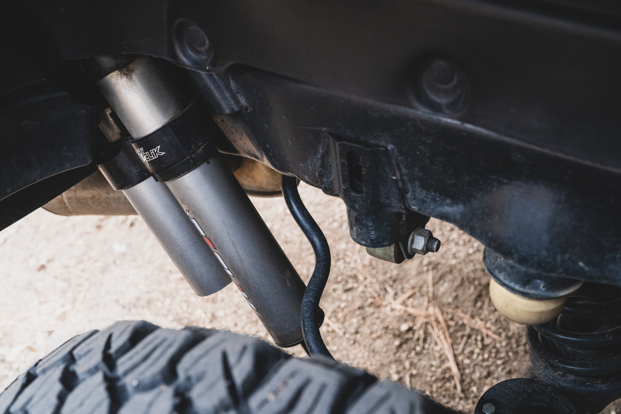

The ECU installs on top of the factory fuse block and uses a factory fuse position to access switched power.
For a vehicle like a Wrangler, it is easy to find springs and geometry correction solutions from quality companies like AEV, OME, Icon, and others. Finding a quality shock is also possible, but most of these dampers are set to a compromise of compression and rebound that meets the needs for the middle of the bell curve. There are driver-adjustable systems as well, but only the E-Clik makes active valving adjustments within 1/250th of a second. That statement may come across as overly complimentary, but being first to market with something that really works is rarified air.

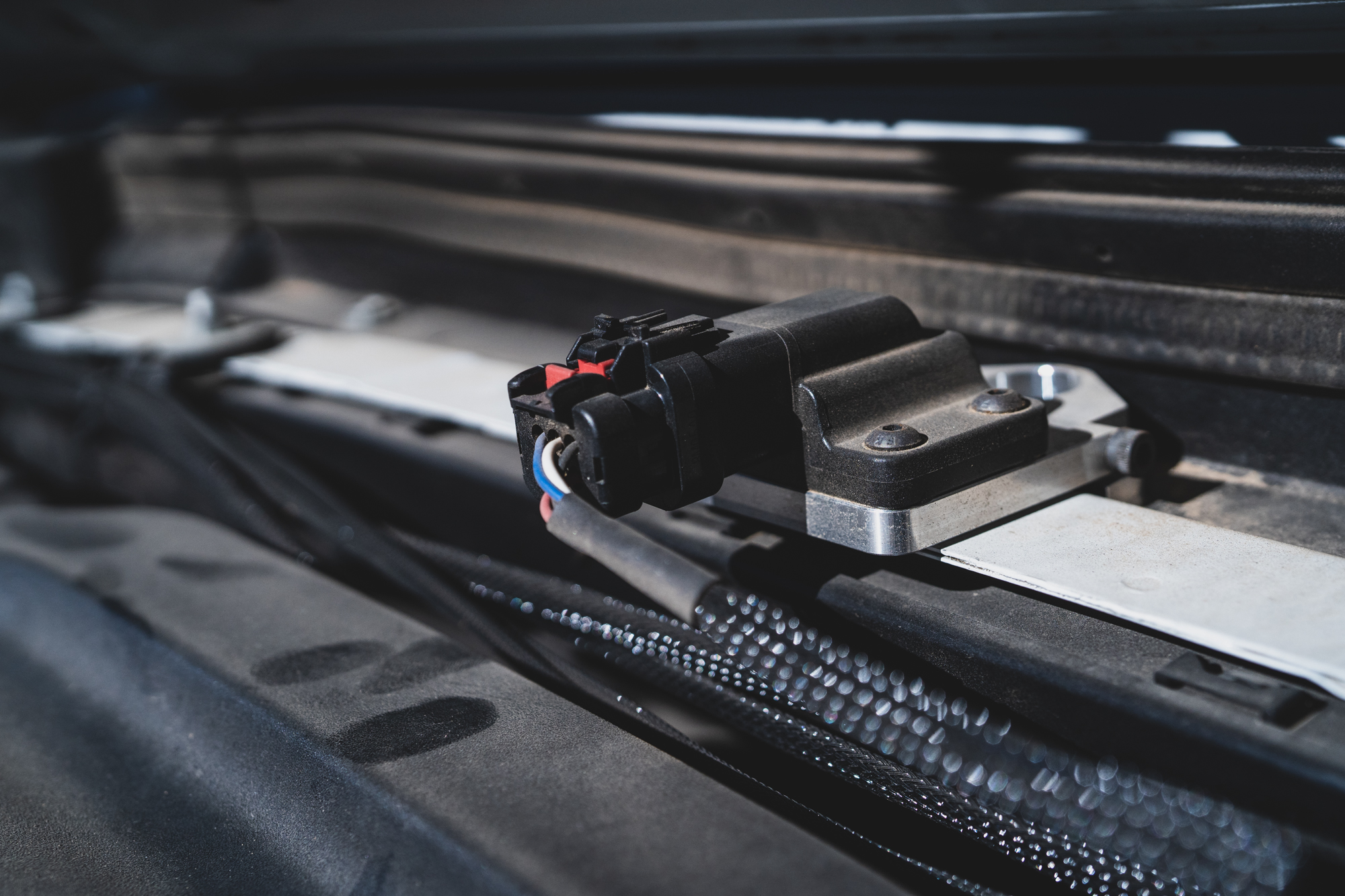

SDi E-Click IMU
The Inertial Measurement Unit installs inside the engine compartment, at the top of the firewall.

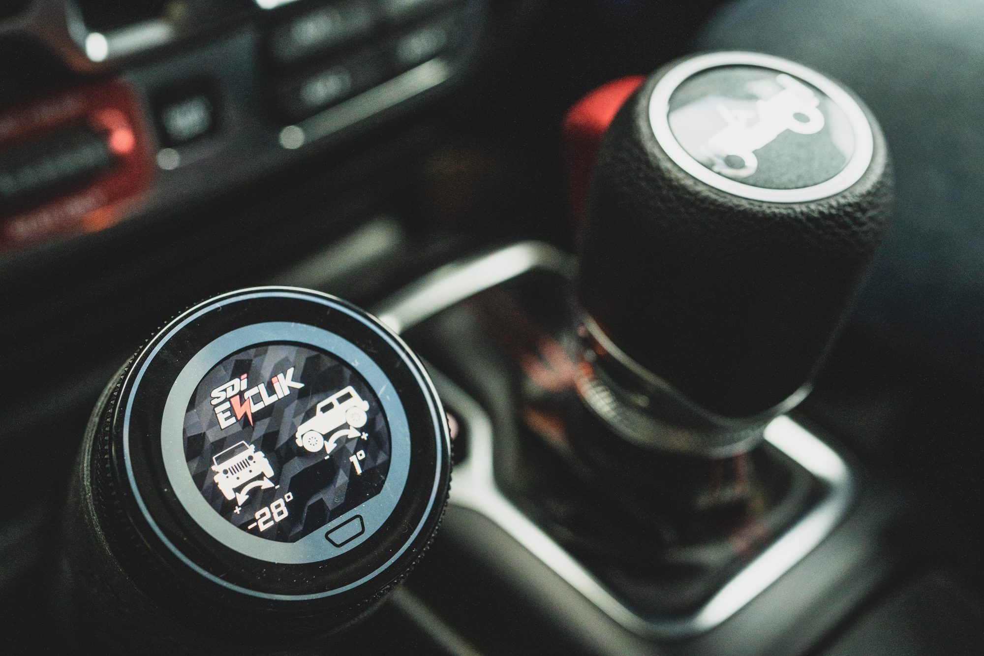

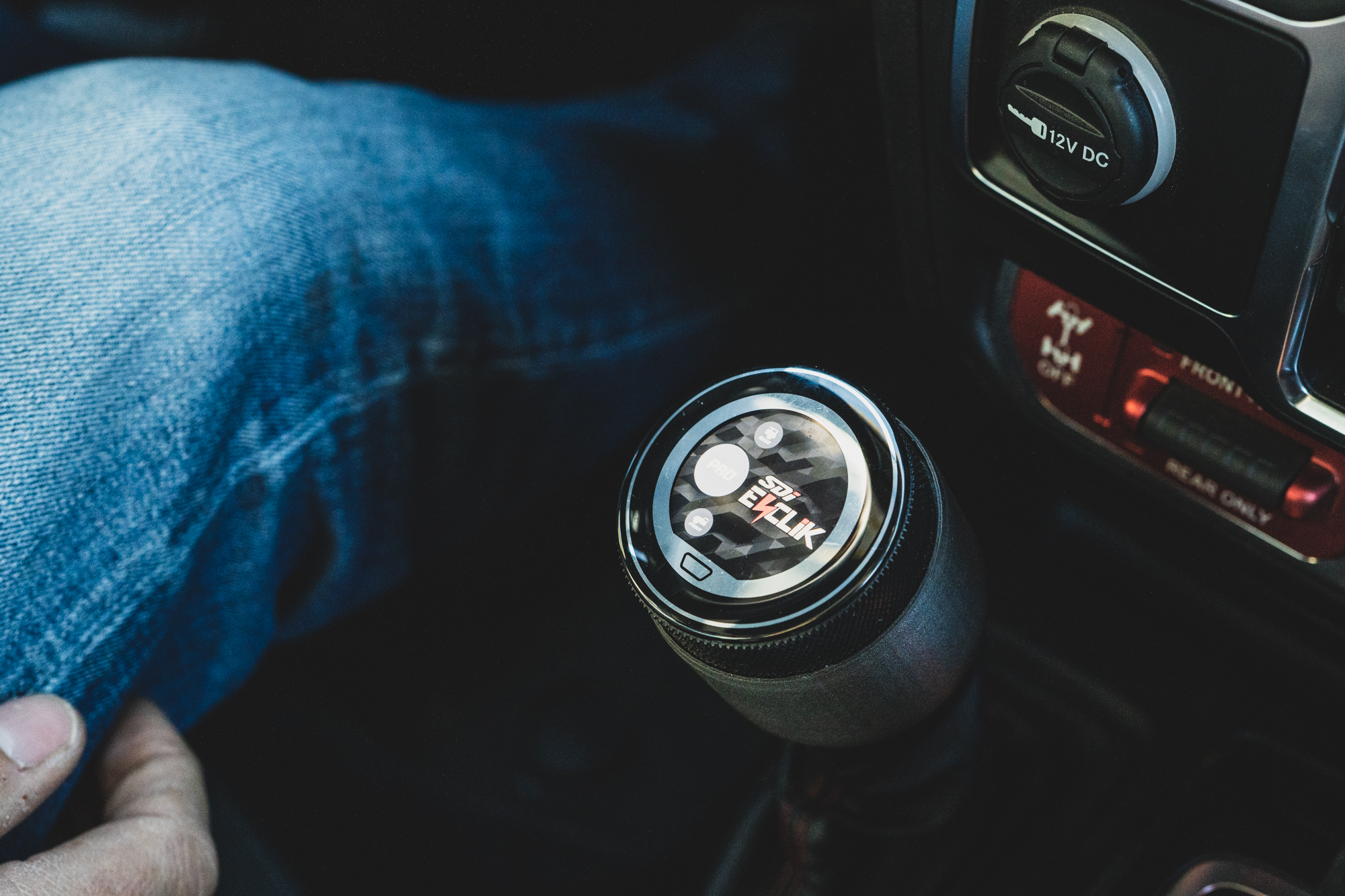

It would be easy to write a few thousand words of technical copy on the features of this system, but I want to focus on the use cases. To summarize the features, it starts with a Made-in-USA shock, manufactured and assembled by SDi using a combination of in-house (and locally machined) parts, and adapted electronic components. Next is the proprietary touch-screen controller that replaces the transfer case shifter on the Jeep JL, incorporating a touch screen and dial configuration to review and change settings. The system is controlled by an ECU that gathers data from 12 different inputs, including the supplied 8-axis inertial measurement unit (IMU). The system adjusts the damping of all four shocks in real time, autonomously and transparently, with no input needed from the user.  Additionally there is a user selectable Road Mode and Trail Mode. For advanced users the system allows extensive manual (via the touch screen) adjustability and sensitivity biasing.

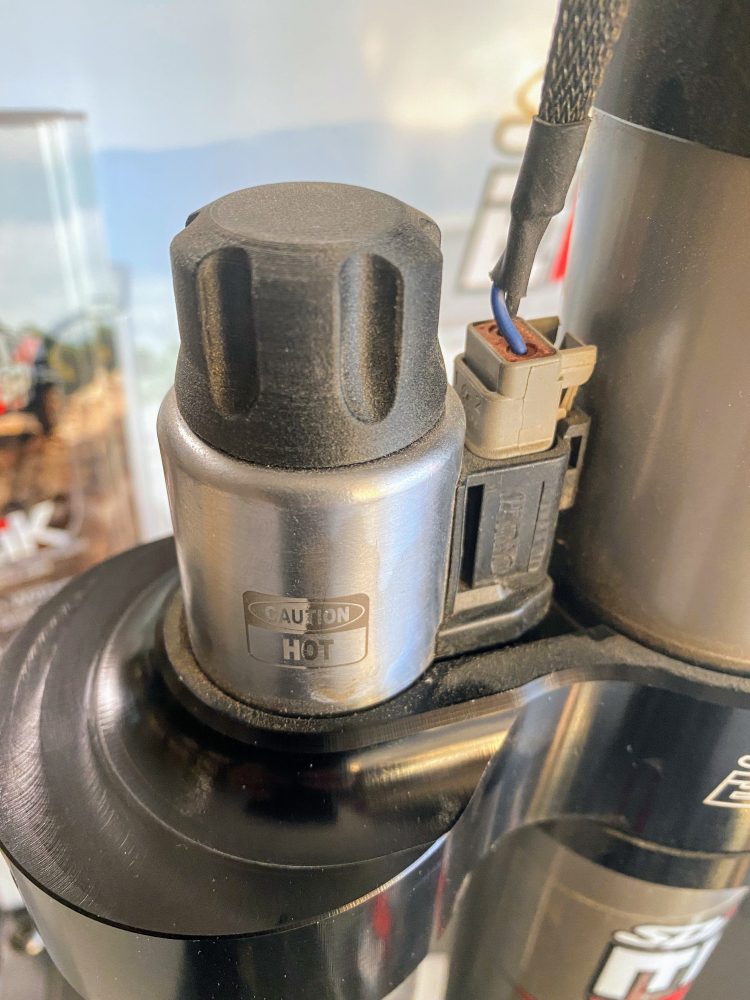

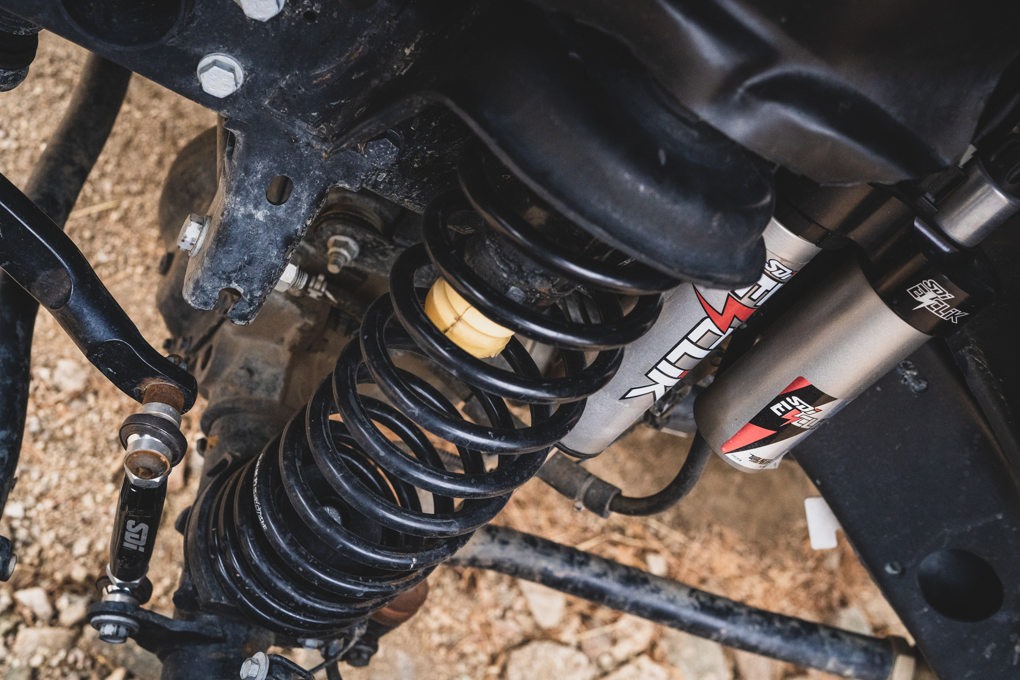

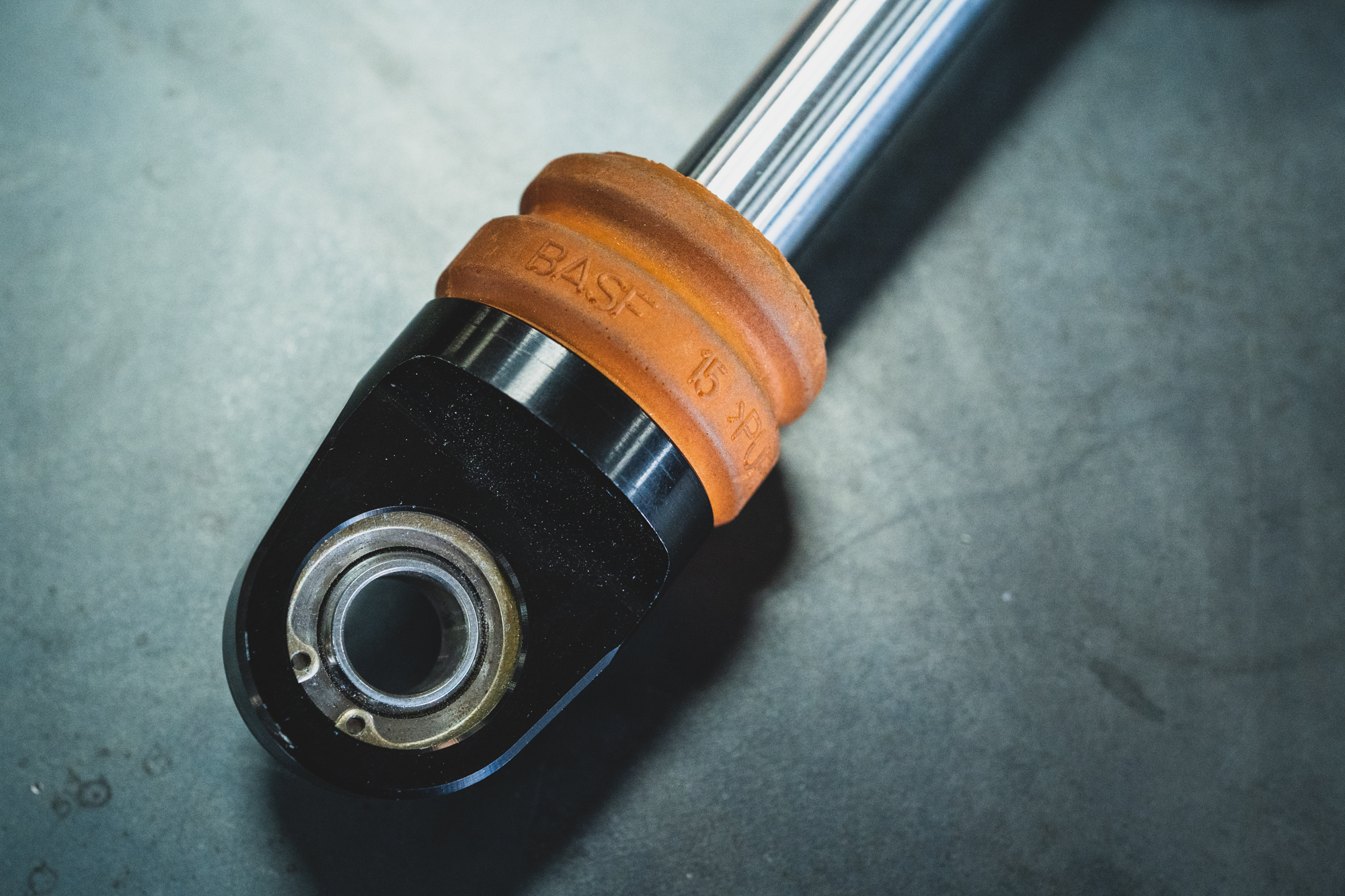

The system installs easily, with additional time required to install the ECU, IMU, and run the harness to each of the dampers. Each shock has an integrated electromechanical valve that controls the rate of fluid flow between the main shock body and the reservoir. This valve has full proportional control, which permits variable control throughout the entire valve range.

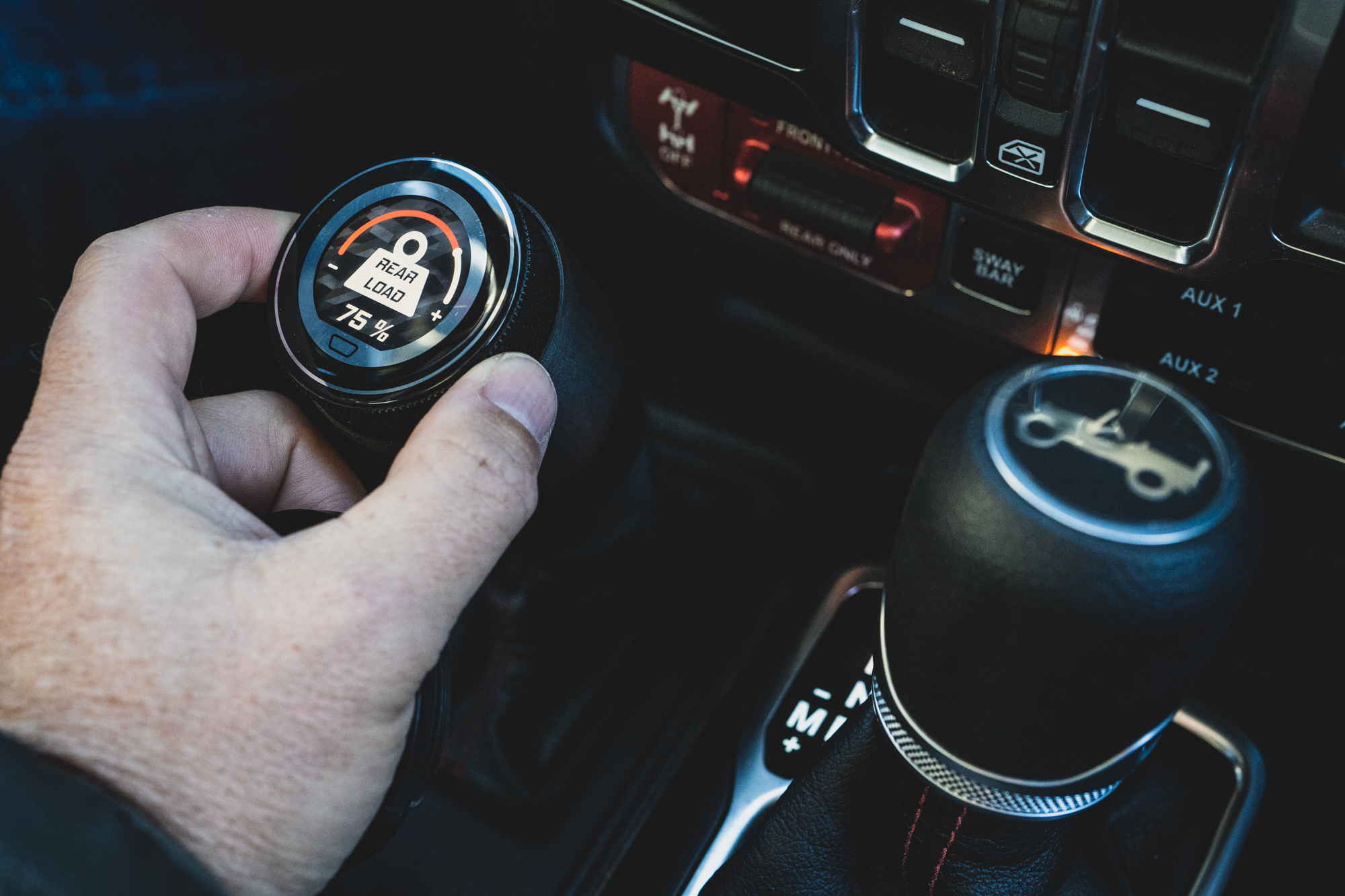

Many travelers are not overlanding; they are overloading (grin). Payload just comes with the territory as we stock our vehicles with camping gear, recovery equipment, and tools/spares, resulting in a vehicle like the Jeep Wrangler being at or near GVWR. To accommodate for this, the E-CLIK has a provision to adjust the rear valving based upon a percentage of available payload. It’s a significant advantage for backcountry travel as the Jeep can run daily driver duties with little gear onboard and then be adjusted for a travel load.

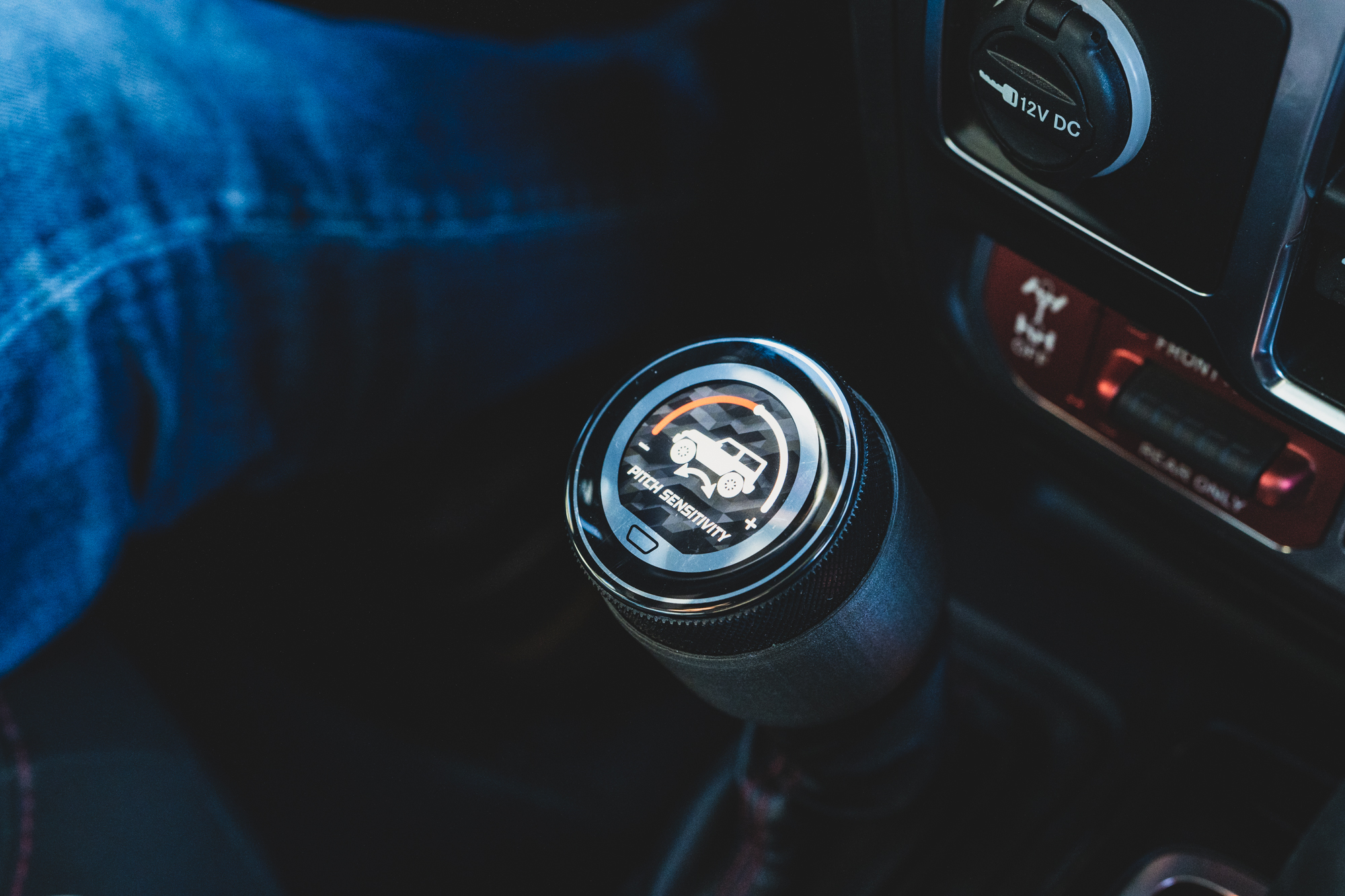

Another use case that immediately came to mind is a dynamic roof load. During my testing of the E-Clik, I conducted a series of tests to help simulate dynamic handling scenarios and body control conditions. This included higher speeds on the dirt with the sway bar disconnected. With a loaded roof rack or a roof tent (hopefully never both), the E-Clik is able to adjust the dampers automatically to limit sway and help keep the hood flat through transitions at speed. It is particularly noticeable with the rear suspension, as most roof loads will have a rear bias. I was able to adjust the system by increasing the pitch sensitivity and upping the rear load percentage.

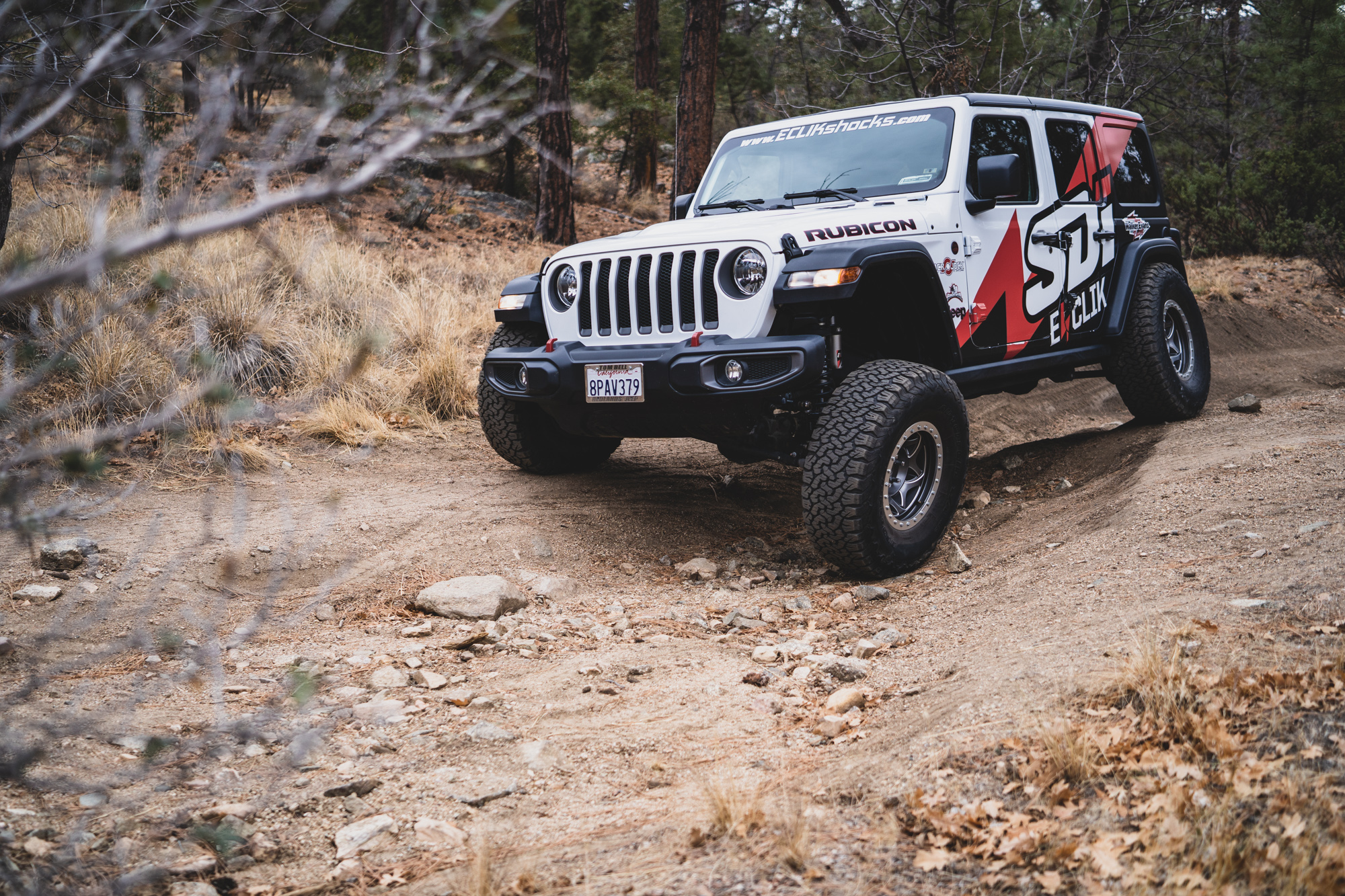

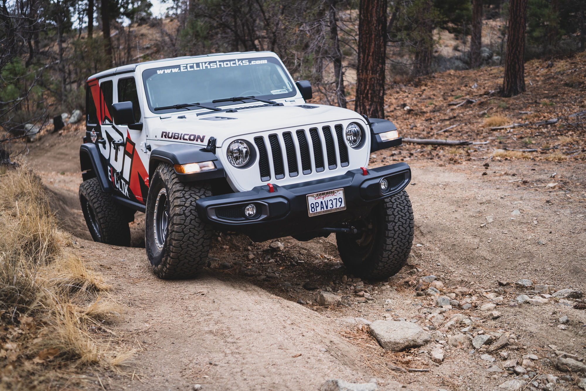

In cross-axle terrain with the sway bar disconnected, it was impressive to watch the system actively adjust throughout an articulation event, firming a corner as it dropped into a hole and loosening a lightly loaded corner. This was also evident during side slopes, where the system would firm the downslope dampers to minimize compression of the loaded (downslope) springs. We pushed right up to a 30-degree side slope at various speeds to gauge effectiveness, and it was confidence-inspiring.
