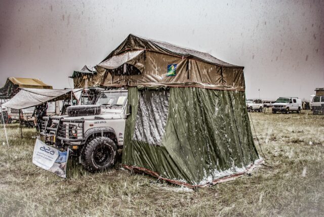

Three elements render an RTT impractical. Have a look in your closet and garage. Do you see a ton of winter gear: skis, snowboards, snowshoes, thermal base layers, and wolf-fur mittens? If yes, the rooftop tent may not be the best option for you if you like to travel to winter wonderlands, as the vast majority of RTTs are designed for fair-weather use. Yes, you can pipe hot air into the RTT and bundle up in thermals and down duvets (been there, done that), but the reality is that canvas and transparent plastic do not fare well in extreme cold. Another nemesis of the RTT is high wind and gusts, which can tear canvas, bend poles, and make an awful racket all night long. There are few worse experiences on an overland journey than a night spent with your head wrapped in a pillow, trying to sleep while the rain cover flaps and the base of the 50/50 split RTT lifts, ladder(s) clanging, and crashing. No thanks. The third Achilles heel of the RTT is rain, and more than once, we have been caught in a deluge which has either damaged the tent as water collects in canvas reservoirs or has kept us up all night as the fabric finds the limit of its water-resistant properties and leaks appear which soak the mattress and the occupants. Back in 2012, our Defender arrived in Uruguay, and a hurricane marred our first weekend on the road; we spent three long, wet, and windy days in our roof tent (with annex) and eventually decided to find refuge when the trees in the forest beside us began to tumble. Drying and repairing the RTT took nearly a week, and we learned some valuable lessons. In summary, the RTT can be used in almost any climate but is best suited to a dry, warm, not too windy environment. Later in this article, we will share more tips and tricks for getting the most out of your RTT, but first, let’s buy a tent.

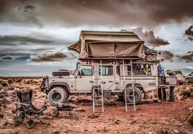

Now that you have installed your new RTT, you will want to get out there and enjoy the views and breeze that come with having a nest 6 feet off the ground. Out on the road, you may notice increased body roll, fuel consumption, and some wind noise from the tent (soft-shell tents tend to be noisier and less aerodynamic than hard-shell tents). On the trail, you will likely experience the dreaded body roll and should remember that you have a large and expensive piece of gear on the roof, which you probably want to avoid scraping against rock walls and tree branches. Keep this in mind when entering parking garages or your garage at home, too. Installing an “aerial” cut to the maximum height of the vehicle on the bush bar allowed me to enter low areas confidently.
That first night sleeping in the tent will likely be fantastic. Don’t forget to take up a Nalgene-style pee bottle and a wee john for the missus; the walk of shame to relieve yourself at 3:00 a.m. is never fun. And don’t fall off the ladder. Watching the sunrise from your nest has to be one of the greatest joys of overland travel. When packing up, arrange your bedding so it can be left in the tent, and do not forget to take out your phone, power cables, wallet, and keys. Unfortunately, not all compact RTTs offer additional space for bedding. Once you are done closing the tent, walk around and ensure all the latches are secure and no fabric is left out and exposed. If you are using a hard-shell tent, packing up should take a few minutes; if you are using a soft-shell tent, the packing-up process could take much of the morning, resulting in some cussing and an argument.
Remember, moisture is your roof tent’s number one enemy. It is advisable not to pack the tent if wet, even if you will be opening it again in a few hours. Damp is okay for short periods; wet is not. If you have to, use your spouse’s towel to wipe the excess moisture and condensation from the walls and ceiling of the tent. If you have to leave camp with a damp tent, be sure to open it up entirely as soon as possible to make sure that it is fully dry before storage. To combat condensation within our roof tent, we permanently installed an alpaca wool sheet (from Peru) across the internal aluminum support beams; the wool sheet absorbed all the moisture (four humans breathing in unison all night in a tropical environment), preventing drips of cold condensation on our sleeping faces and providing a pattern to consider while lying awake, needing to pee but fighting the inevitable.
Once you have returned home, you must give the RTT (and the vehicle) some TLC; this small effort will ensure that your valuable RTT will last many years. The longer and more arduous the journey, the more intense the maintenance should be. Start by opening the tent up to air, removing sheets and bedding to be washed, and ensuring that no moisture is accumulated beneath the mattress, which may need to be removed and aired. Give the ladder and metal parts a rinse and treatment with WD40 or similar, and keep the tent zips well-lubricated. If there were any issues with the tent while traveling, such as leaks, now is the time to address them. With time, the fabric of the RTT may lose some of its UV and moisture resistance as the factory treatment begins to wear off. Scotch Guard and a few other chemical suppliers sell good moisture and UV treatments for canvas and fabric, and the occasional retreatment of your tent will ensure that the material stays in excellent condition. The manufacturer of your RTT will likely have good recommendations for treating and maintaining your tent; heed their advice; they are professionals.
A loved, well-chosen, and well-maintained tent will help you travel to the ends of the earth and back in relative comfort. Our large, family-size Howling Moon tent served us very well over the years as we toured Africa, circumnavigated South America, and traveled from Argentina to Alaska and across the USA. Thanks to regular cleaning and maintenance, we only had a torn rain fly (it lasted four years of frequent heavy wind, sun, and rain) and a broken cover zip. When we converted the Land Rover into a hard-side camper in Florida, we sold the tent to a Canadian family for $1,000 (including annex), and they are still enjoying that tent to this day. We miss that tent, but we don’t miss that tent.
