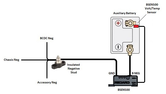

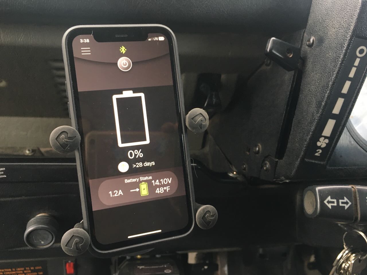

In a surprise twist, I struggled with the installation of the BSEN500. The three-wire design is dead simple, and the tiny form factor (1.8 x 2 x 4.7 inches) made it easy to find a nook to mount it. However, after configuring the device with the Redarc Configurator app, and linking up to the RedVision app to start monitoring the battery, I couldn’t get the charge status tool to read anything other than zero. The voltage and current readings, both under charge and under load, were highly accurate (as confirmed with my multimeter), but the charge status graphic remained stubbornly empty. With some help from Redarc’s excellent customer support, I discovered that for the BSEN500 to work correctly, it needs to be the only component connected to the auxiliary battery’s negative terminal. In my case, I had two other circuits wired to that post: the portable solar panel negative lead from its solar charge controller and the negative side of the Blue Sea fuse block that sends power to my accessories.
To get the Redarc smart monitor firing on all cylinders, I needed to rewire significant parts of my auxiliary battery system. This meant ordering more components, like an insulated negative stud for the ground connections, and more wire, connectors, and terminals. Was it worth it? In the short run, I think so. Having the RedVision app’s ability to predict the battery’s charge-remaining status is likely far better for the health of my battery and the sake of the perishables in my fridge than the dumb (and not terribly accurate) eBay-special digital in-line voltage meter I was using previously.
