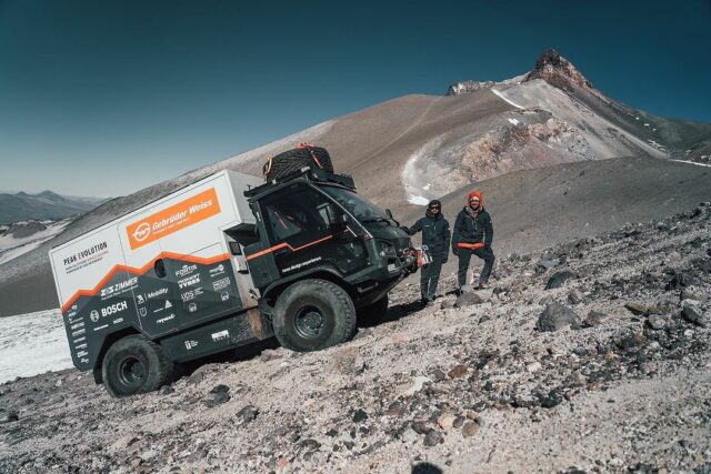

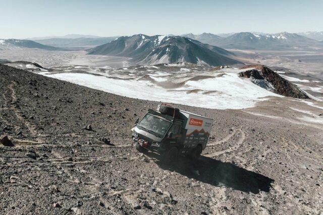

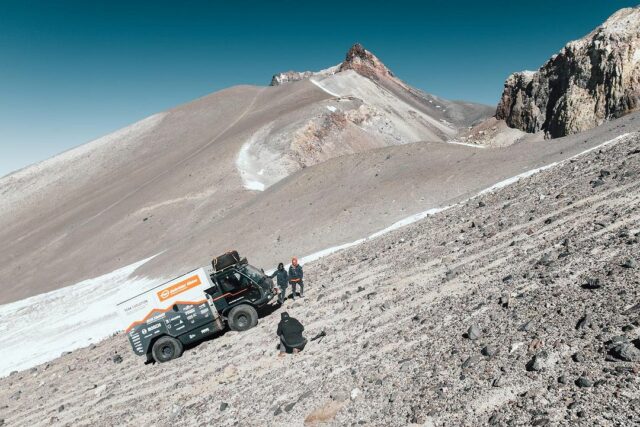

A David vs Goliath battle was afoot early in December 2023 as both teams set out to conquer Ojos del Salado, the world’s highest volcano, perched at an awe-inspiring altitude of 22,614 feet (6,893 meters) and located on the Argentina-Chile border. The Peak Evolution team had to settle for the EV altitude record as they could not match the elevation achieved by the well-funded Porsche team. We reached out to Peak Evolution and asked why the climb ended where it did and if a loss of traction was the deciding factor.

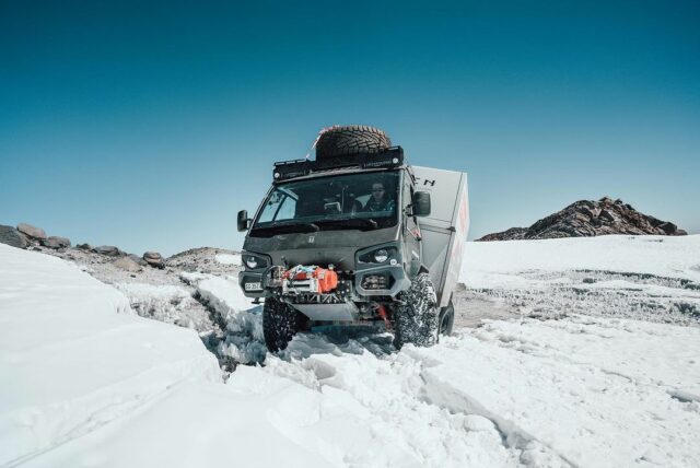

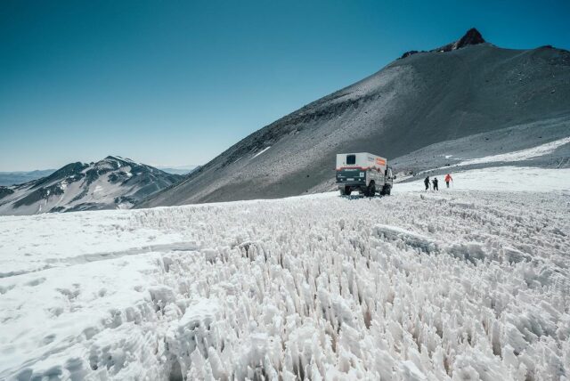

“We couldn’t keep going because it was too steep and sandy. We had really good tires, 44-inch Nokian Hakkapeliittas, that allowed us to get further than most vehicles, but there was just no way to advance without winch(ing). We had all the equipment to winch our truck up, but in the end, we decided against it. Other expeditions like the Porsche team or the Unimogs (the previous record holders) that tried it a few years ago had big teams, backup vehicles, and nearly unlimited funds. For us, everything was on the line. We worked for three years on this prototype, and our company relies on it. Also, we would have been stuck up there with -20°C [temperatures] and 60 mph winds with no one to get us down. But we’re confident that no campervan with a fully equipped kitchen and running water has ever made it that far and probably won’t for a while.”

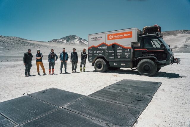

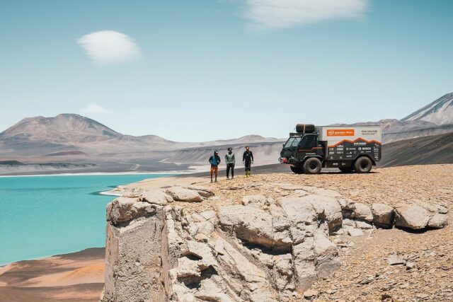

How did David Pröschel, David Koller, and Patrick Koller gear up for the formidable high-altitude challenge? Their journey began with acquiring and transforming a 4WD Aebi VT450 turbo-diesel transporter from the Swiss company Aebi Schmidt Group. The team skillfully reengineered the VT450 to be powered by two electric motors and charged by solar energy, ensuring it could endure the rigors of extreme elevations and frigid temperatures while keeping its environmental impact low.

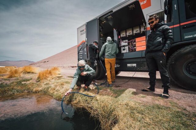

DDP Innovations (an acronym for David, David, and Patrick) utilized advanced electrical components from leading companies like Bosch and Eco-Volta. The Terren electric drive system powers the vehicle, typically used for municipal and agricultural functions. It is propelled by two motors, each delivering 120 kilowatts, roughly 161 horsepower.
The team added a composite panel structure to the frame, serving as the mobile camper and transporting supplies and tools. It weighs 8,157 pounds when empty and can support a maximum load of approximately 20,944 pounds. The entire vehicle is slightly shorter but wider than a standard full-sized pickup truckmeasuring 16 feet 5 inches in length and 7 feet 3 inches in width.
One notable drawback of the record-breaking Terren is its top speed, electronically limited to 28mph, as the vehicle is registered as a tractor in Switzerland. While this speed might be adequate for trail and off-road travel, it’s useless for highway driving. However, the DDF team has assured us the top speed will, in the future, be limited to an almost respectable 56 mph.
An essential aspect of the Terren is its battery quick-change system. The system splits the battery into two modules, allowing for swift replacements. One module can be charged to 80 percent in just one hour under ideal conditions. The Terren is equipped with external power connections that allow the vehicle to perform tasks typically reliant on a generator, with a continuous output of 15 kilowatts.
