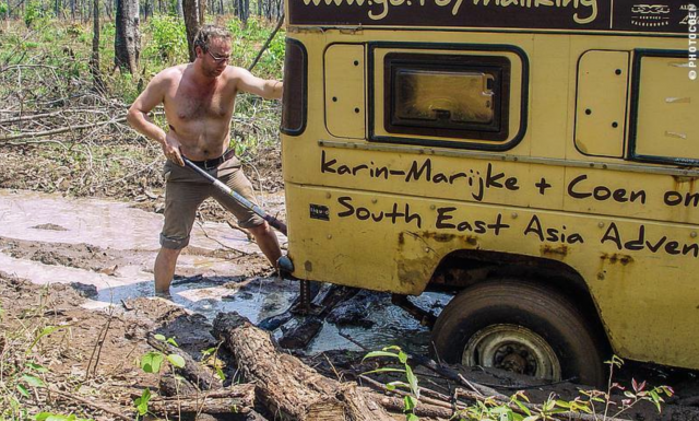

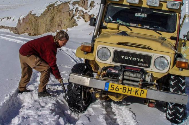

However, that changed when we got in some serious trouble and got stuck in deep mud in South East Asia. I lifted the Land Cruiser in the rear with the hi-lift while Karin-Marijke used the shovel to free the wheels so we could get some wood under them.
No matter the effort, the mud holes kept filling up with muddy water until a local showed us how to dig a narrow gutter to channel out the water. Hey, we all have to learn, don’t we? Simple but brilliant.

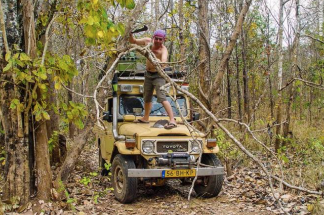

Experience has shown that the above-mentioned items will generally get us out of precarious situations. However, both are useful when getting stuck in soil. Sometimes the challenge lies somewhere else: a fallen tree across the trail, or low-hanging branches that are too thick and heavy to be pushed over the Land Cruiser’s roof.
6

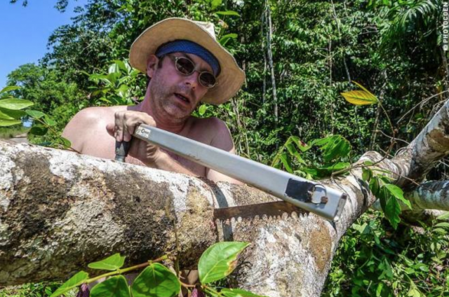

We left the Netherlands with a cheap axe. It was practical to make kindle wood with but not so much to cut thick branches, let alone a trunk. Already in Greece the axe got replaced by a curved machete that served us well for a long time. However, I was limited when building campfires and wanting a saw to cut thicker pieces of wood. But then, where do you pack away a saw?
In Salta, Argentina we met Dominic and Diane from Canada who traveled with a T3 Westy. Dom showed me a neat, folding saw and I was sold. Of course, I still needed to battle Karin-Marijke objections in her role financial director and inventory keeper, but I succeeded and she has often admitted that this has been a good investment.
7
This saw packs nifty and small. You can unfold into a full-size, triangular-shaped bucksaw in a trice, and you can easily operate it by one hand. It is made of aluminium and so it weighs almost nothing yet feels extremely robust. The blade does not warp as easily as other, similar bow-saws.

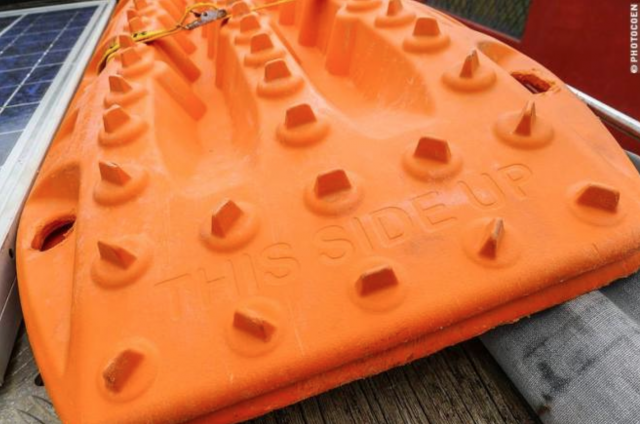

Because we planned to drive to Asia, we took a 4×4 training focused on traversing mud rather than dunes and deserts [read about it here]. I didn’t feel the need to buy expensive aluminium sand-ladders or the less-expensive but heavy, military-steel sand-ladders.
10

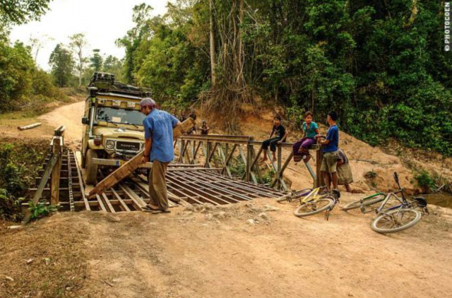

We started missing sand-ladders even though we stayed away from sandy areas: rickety bridges. In Asia as well as in the Amazon we have regularly wished for sand-ladders to guarantee a safe crossing of heavily damaged bridges.
11
Over the years there have been many developments in the 4×4 sector with an increase in lightweight products that mimic the characteristics of the original sand-ladder. One stands out in particular: the Maxtrax. Thank you, Benjamin for donating a set.

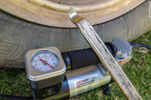

While the terrain hasn’t been rough enough to test the winch, we have extended our boundaries of unpaved, sandy roads thanks to a simple purchase: a compressor.
For years we didn’t bother, not realizing that in fact it was holding us back in some areas. Sometimes we wanted to air down the tires but didn’t because we had no clue to as when we’d be able to inflate them again even though terrain might demand it.
12
We changed our mind when at one time, in Brazil, we couldn’t drive up a seemingly easy but sandy slope. We were terribly annoyed and actually felt defeated. “That’s it,” we both concluded, and on the first possible occasion I bought a compressor in a local hardware store. It is a bit slow but does the job.
Note that you don’t need a compressor to get you out of a tight spot. We use it to get the tires back on pressure after the off-roading, so we can drive on the asphalt again without overheating the tires.
