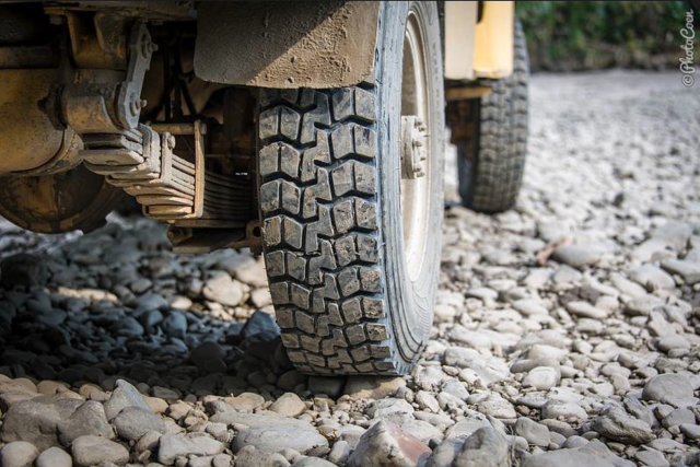

1. Security TM 718 Off-road Tires 8PR
Screen Shot 2015-04-07 at 1.45.49 PM
At the beginning of our trip I bought Chinese, aggressive, nylon off-road tires. They looked tough and many off-roaders asked me where to get them. But they were noisy as hell, gave us bad mileage, were bumpy and uncomfortable although they were only 8 PR.
Screen Shot 2015-04-07 at 1.46.08 PM
On the plus side, these tires were regroovable so we brought them to a shop in Rawalpindi, Pakistan. We could select a different pattern if we wanted to, but stuck with the existing pattern in order not to destroy the underlying fortifications.
You may not be familiar with regrooving tires or retreading but in Asia and South America it is not uncommon. It is a viable option to keep your tires going for just a little longer.

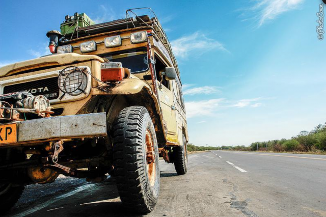

2. JKTire Steelking Radials 14PR
Screen Shot 2015-04-07 at 1.46.22 PM
In India the thread started to show so we had to replace the tires. There wasn’t much choice so after a day’s search we bought lovely JKTire radials with a road pattern. Those tires gave us the most bang for our buck and, in fact, we were so content with them that I tried to get another set in Iquique (Chile) a couple of years ago.
Good mileage, no noise and very comfortable. They brought us to the finish of the Rainforest Challenge and got us rock-climbing on the Ho Chi Minh Trail in Laos (find the story here).

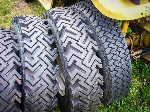

3. Pirelli AS22 12PR
Screen Shot 2015-04-07 at 1.46.40 PM
We obtained our third set of tires in Paraguay, tax-free haven of South America. We made a strange but good choice buying Brazilian-made Nylon Pirellis, as we knew we were in for two years of rípio in Patagonia, and no matter what tires we would buy, they was going to be discarded after those two years.
Salient detail is that these tires were 50% cheaper in Paraguay than in their production country of Brazil. Thanks to a 14-ply rate we had no sidewall punctures. They were a bit noisy on asphalt and affected a little on the mileage. For a nylon tire this one had a pretty good comfort. But we decided that from then on we would stick to radials.

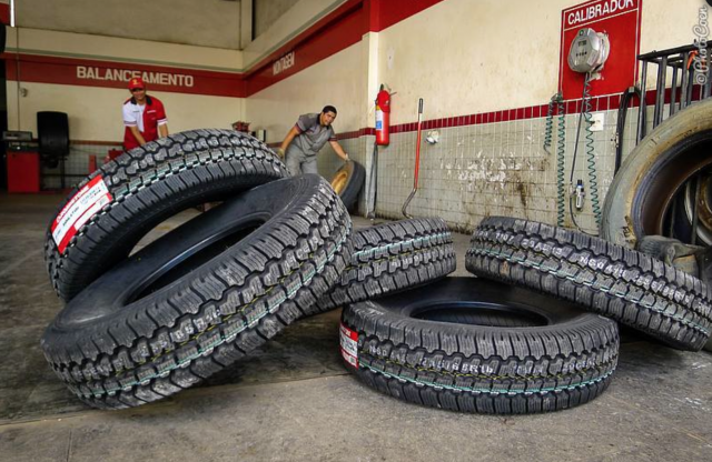

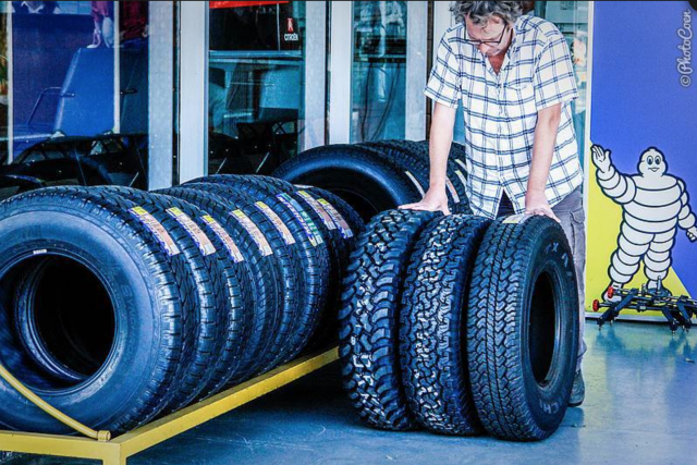

Shopping for Car Tires

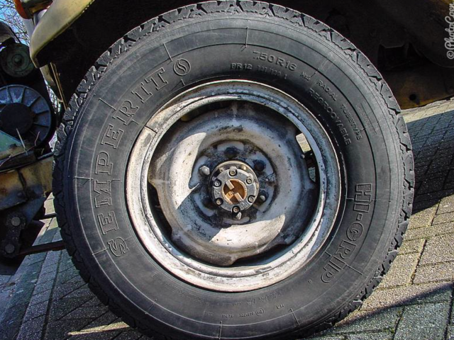

Once you know where the tire shops are, be prepared to bargain and look beyond the obvious. My criteria, after 12 years, has boiled down to the following:
  • Size 7.50R16 [note the R and not a -] so not 7.50-16 [that would be nylon].
  • Radial.
  • Ply rating of 12 and above [due to the weight of the car]. 14 ply is indestructible.
  • Pattern [everything a bit more blocked than straight highway lines].
  • Cheapest.
This gave me the choice between the excellent Japanese Sumitomo highway pattern or a Chinese B brand with a bit more Mud + Snow pattern. Prices were almost the same with the Chinese being a bit cheaper. Time will tell if I made the right choice. For now we are super happy!
