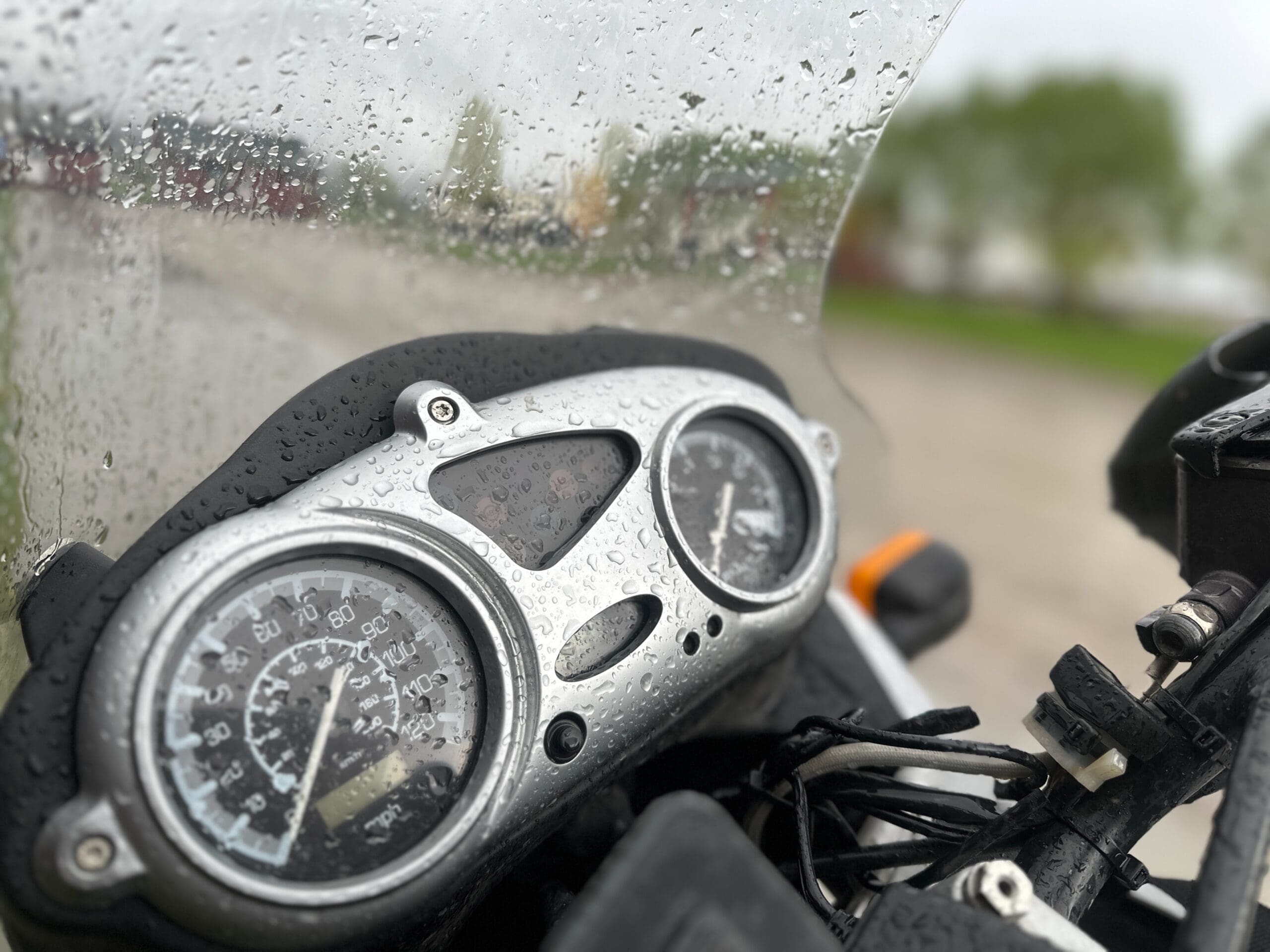

My failure to troubleshoot the heated grips came back to haunt me four months later as I saddled up for my long adventure north. The morning I left Albuquerque was soaking wet, and I rode through rainstorms the entire day that turned to snow as I crossed into Colorado. Cursing my inattentiveness, I toughed it out until I got to Utah, where my frozen mitts were reprieved by balmier weather. But my luck ran short again a couple of weeks later when I rode headlong into another snowstorm in western Wyoming on my way through Jackson Hole and Yellowstone National Park.

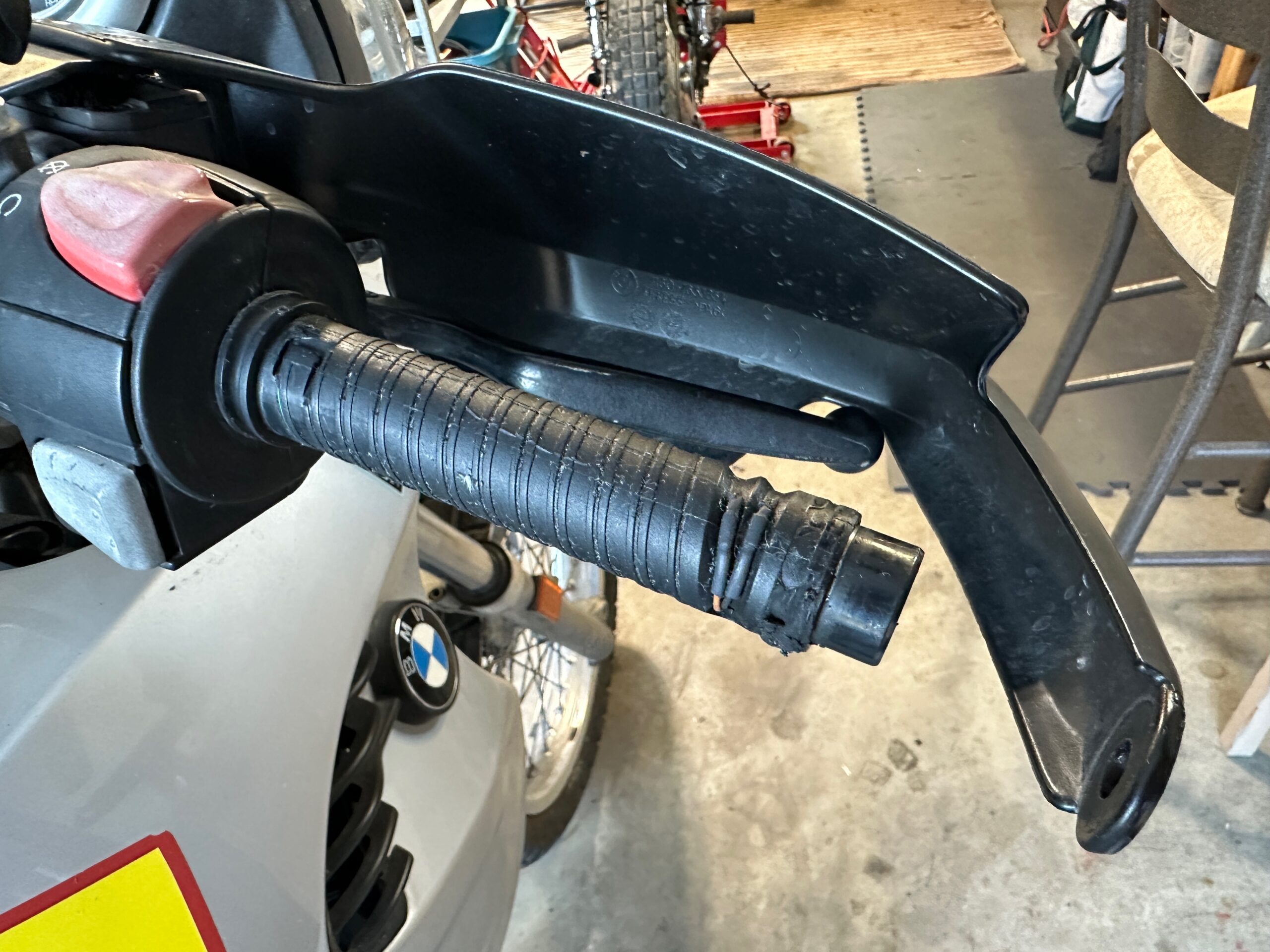

2.) Removing your old grips using compressed air, lubricants, or simply slicing them off your handlebars with a sharp blade is the first step. Use caution with razor blades, both for the sake of your own flesh and for any wiring or paintwork on the motorcycle. Clean the exposed handlebar surfaces with alcohol or another solvent, scraping away any old grip glue or other residue.

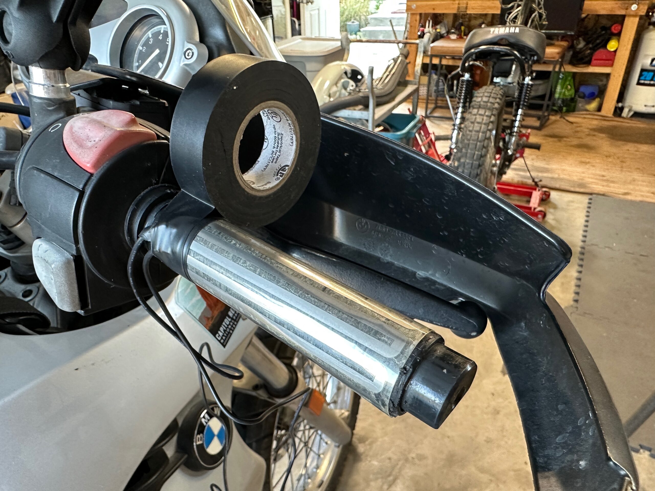

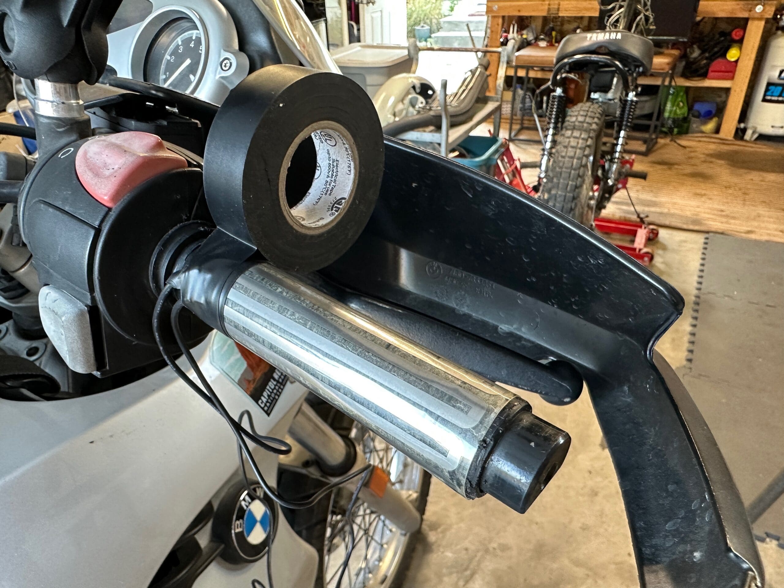

3.) Unwind the wiring from each of the heating elements to gauge its length and mock up the elements on the handlebar—this is an important step to make sure you have enough wire to reach both your switch location and your power source, as well as routing wires away from hot and moving parts.

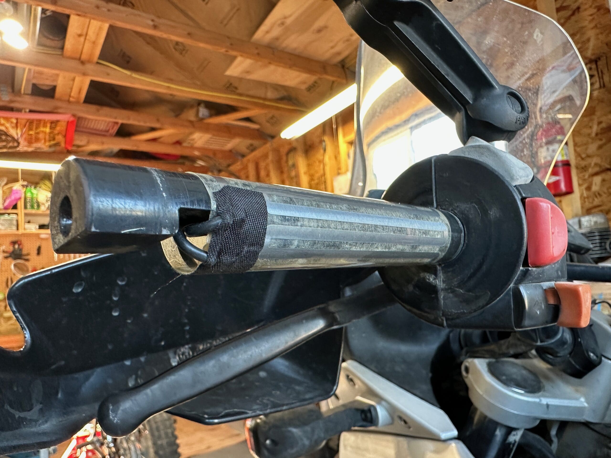

Getting the position of the heating element on the throttle side of the handlebar is key. You need enough slack in the wiring to allow free movement of the throttle, but without placing strain on the solder holding the wires in place.
Allow enough slack in the heating element wires for full movement of the throttle.

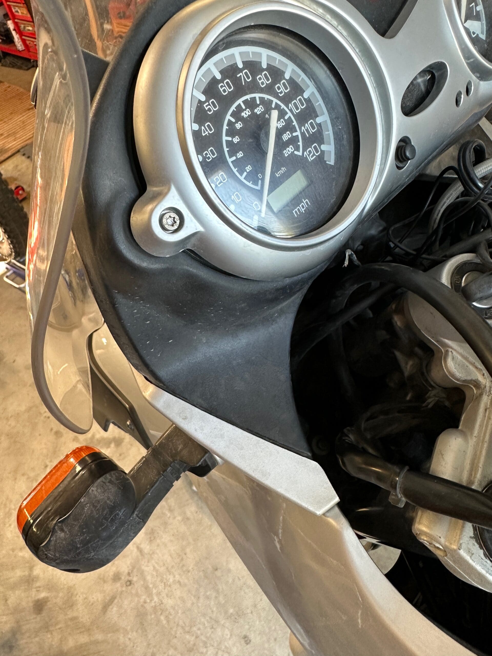

4.) This is a good time to identify your power source, a clean and secure place to attach the ground wire, and a location to mount the control switch for the grip heaters. Resist the temptation to wire the kit directly into the battery (sometimes the easiest solution), and find an ignition-on power source. By splicing into ignition-dependent power, you reduce the risk of accidentally leaving your heated grips on when the bike is not running and draining your battery. I used the OEM power wire from my old heated grip system—the test light or multimeter (along with a factory wiring diagram) will help you identify an ignition-switched power source.

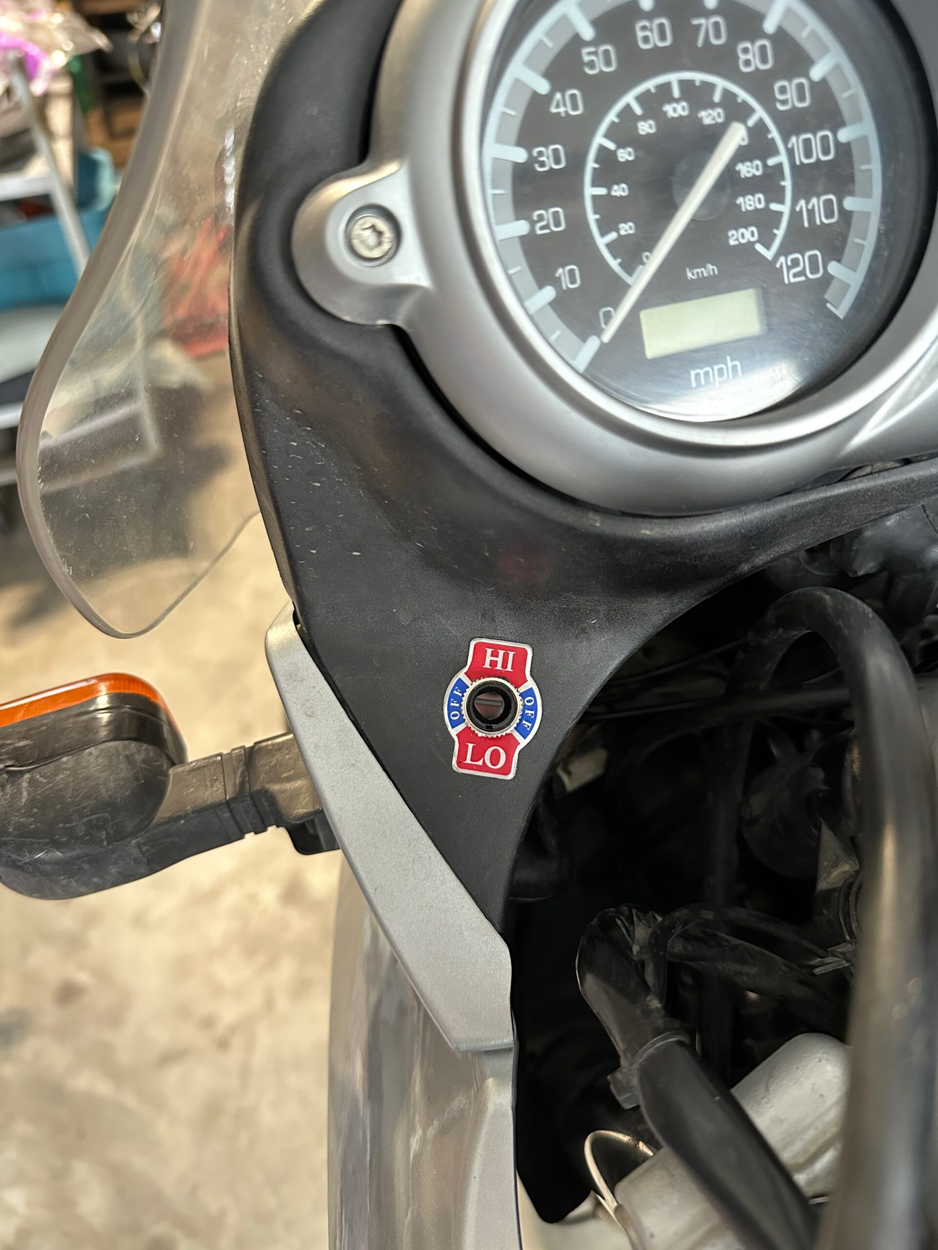

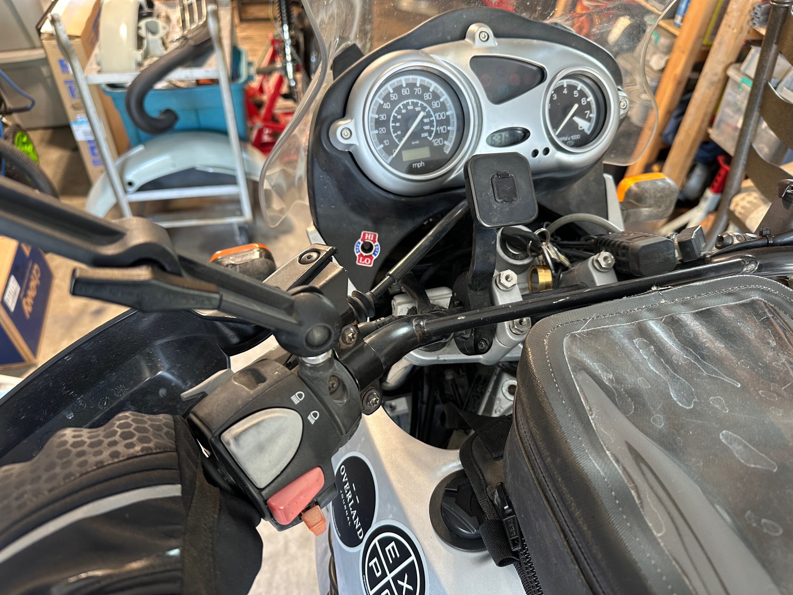

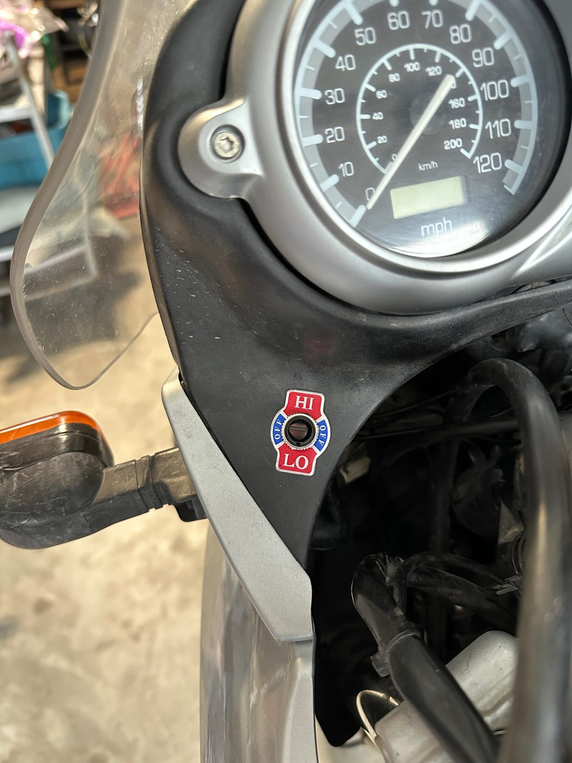

Regarding the grip heater switch, you’ll need to drill a 1/2-inch hole in a panel somewhere within easy reach. Pay special attention to the space behind the hole, as there needs to be enough room to accommodate the switch body and the wires connected to the back of it. You’ll need 2 inches of depth at the very minimum.

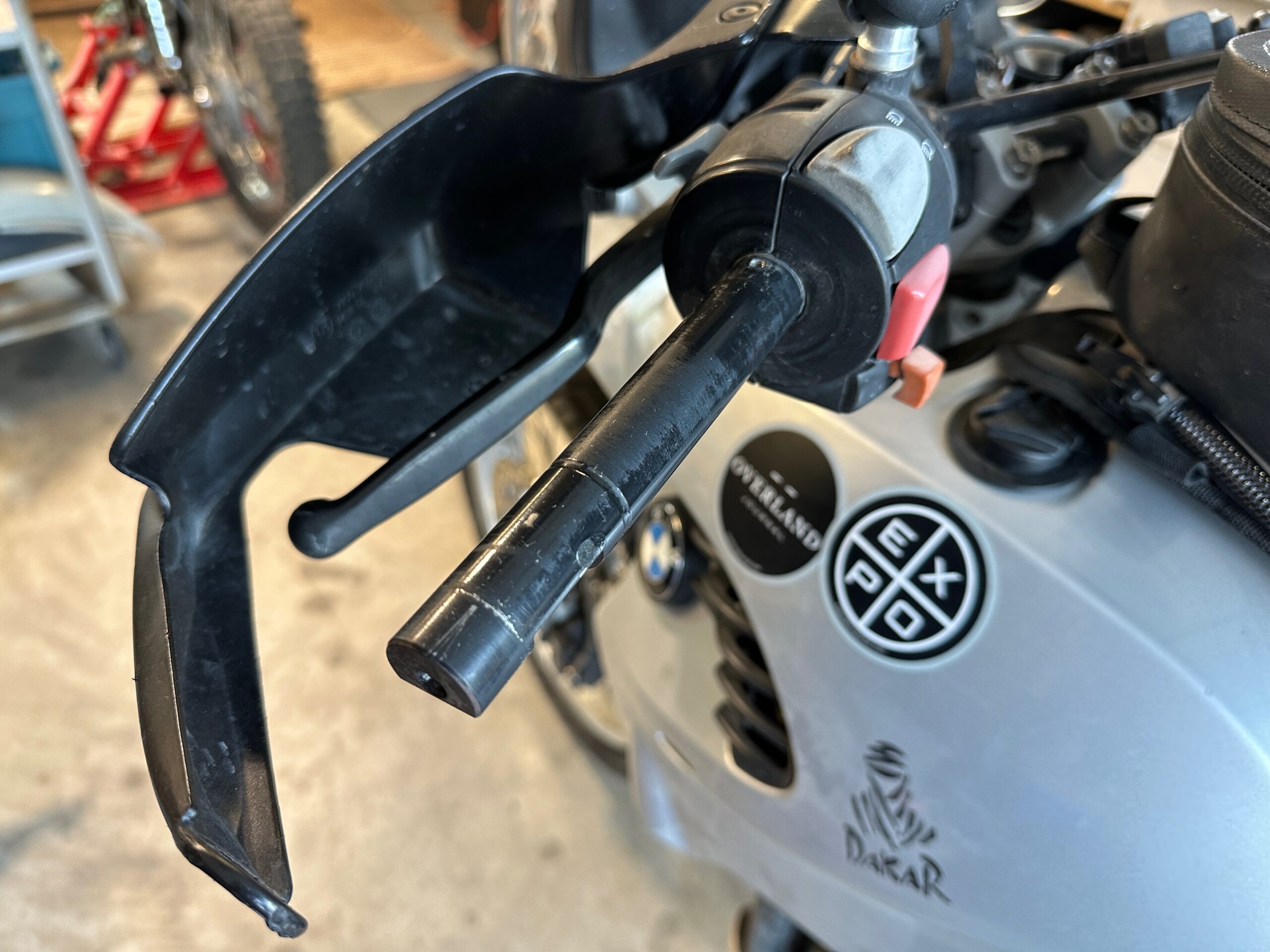

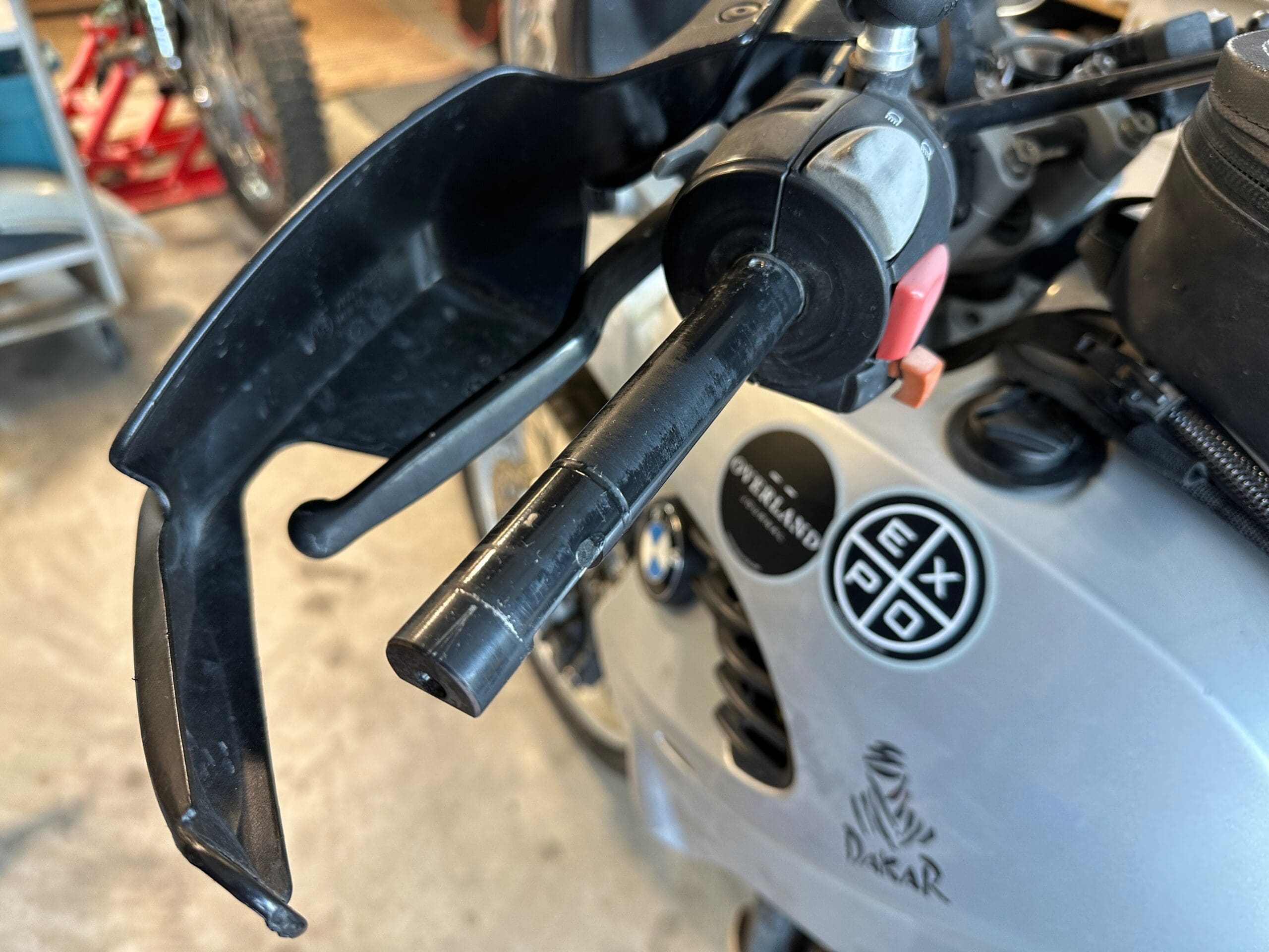

5.) Peel the backing off the elements, and stick them to the handlebars. Take your time getting the position right, as the adhesive is quite strong, and adjusting them once stuck is nearly impossible.
6.) Run the wiring the length of your handlebars toward the center of the bike, securing with cable ties or pre-existing wire management fasteners along the way. My handlebars happened to have a convenient hole to run my wires inside the bar itself on the clutch side. You can, at this point, install your new grips, or the old ones if you were able to preserve them. A fast wrap of electrical tape protects the soldered connections on the elements.

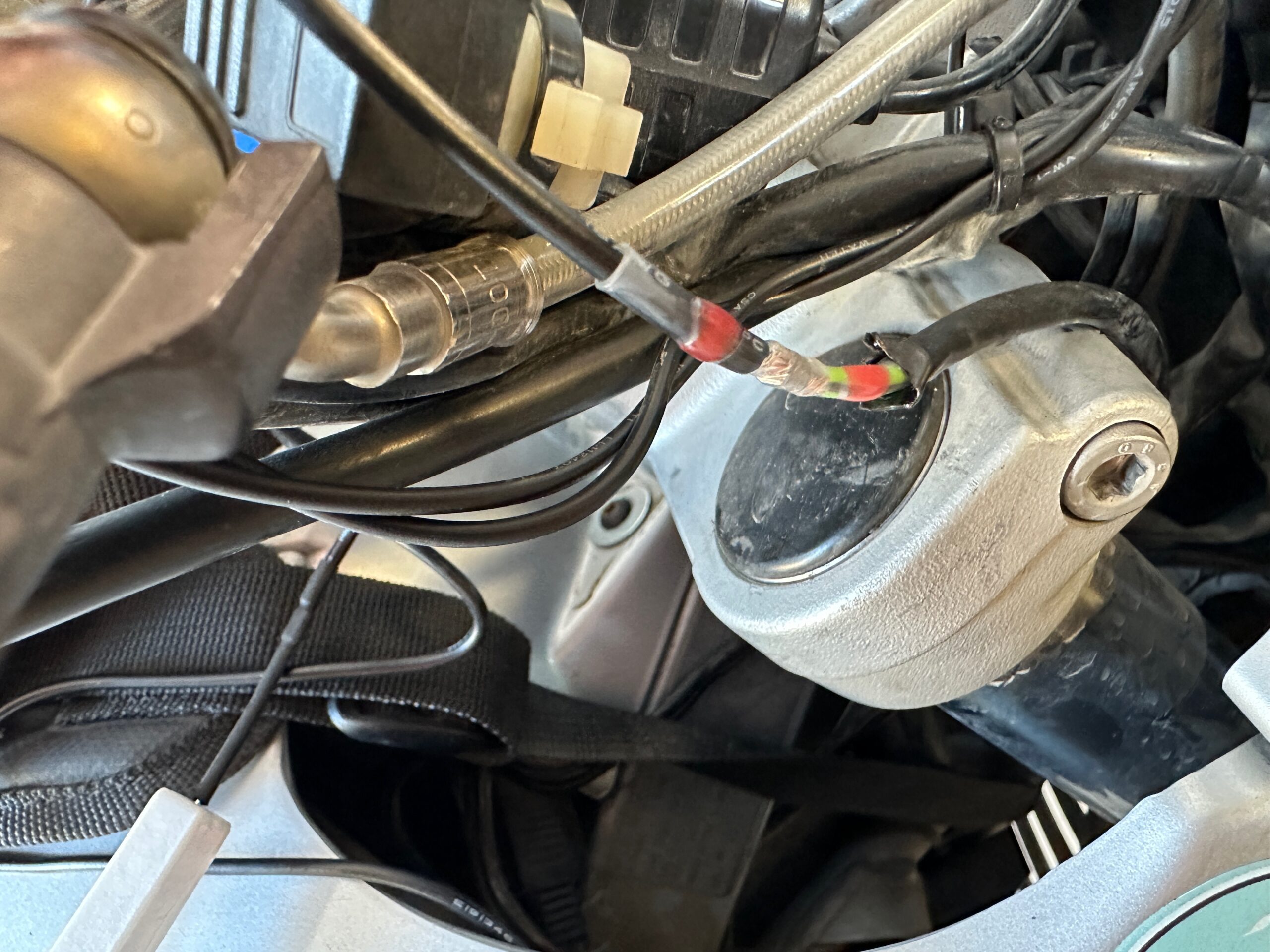

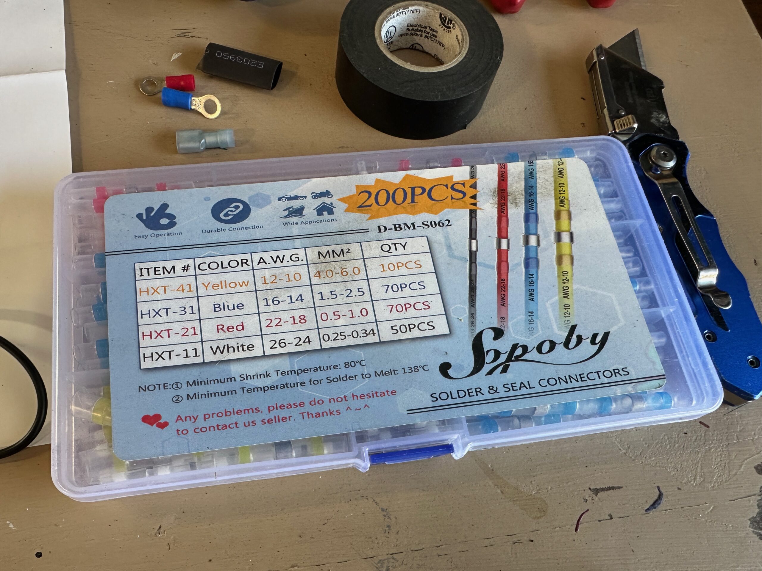

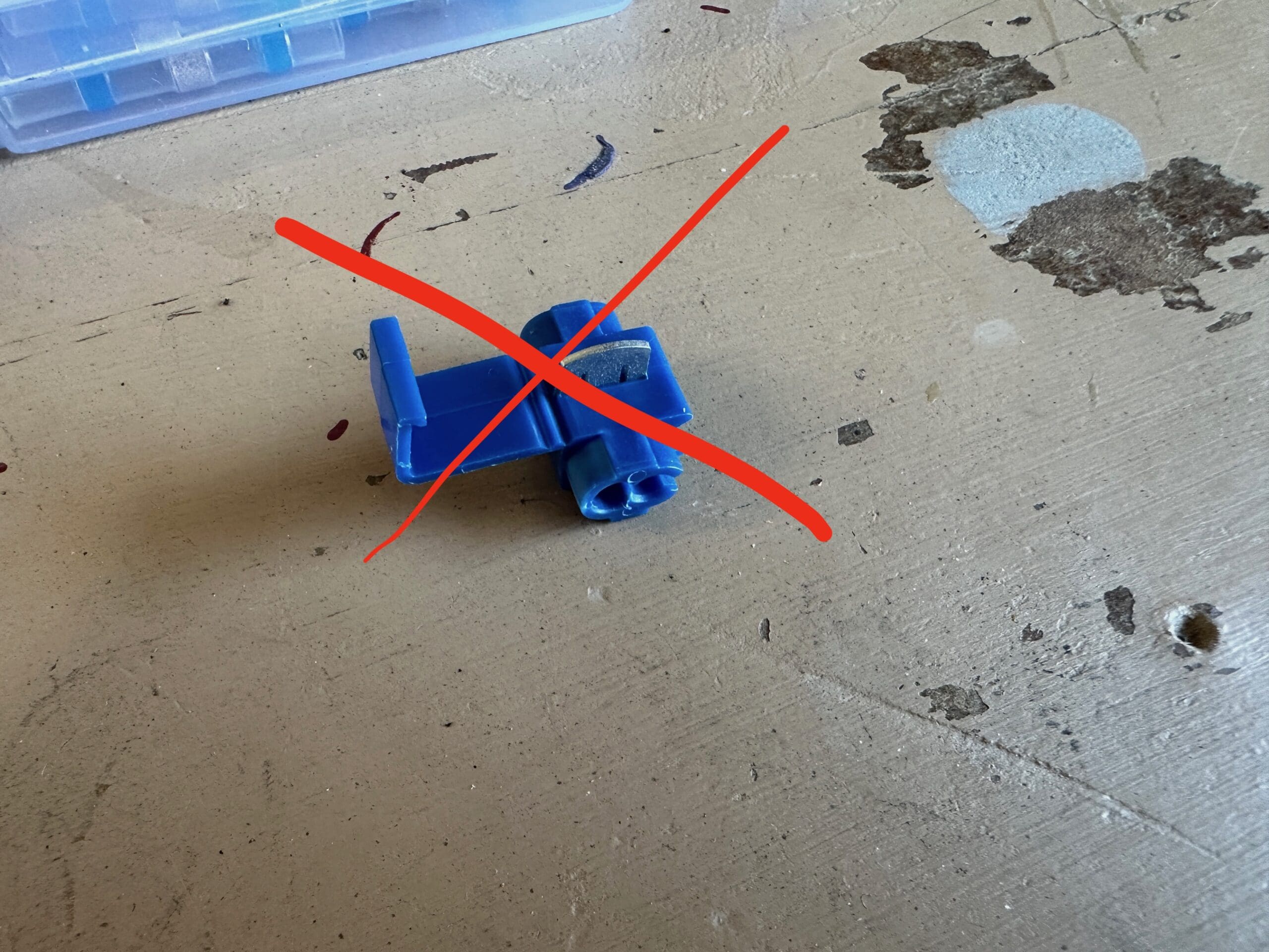

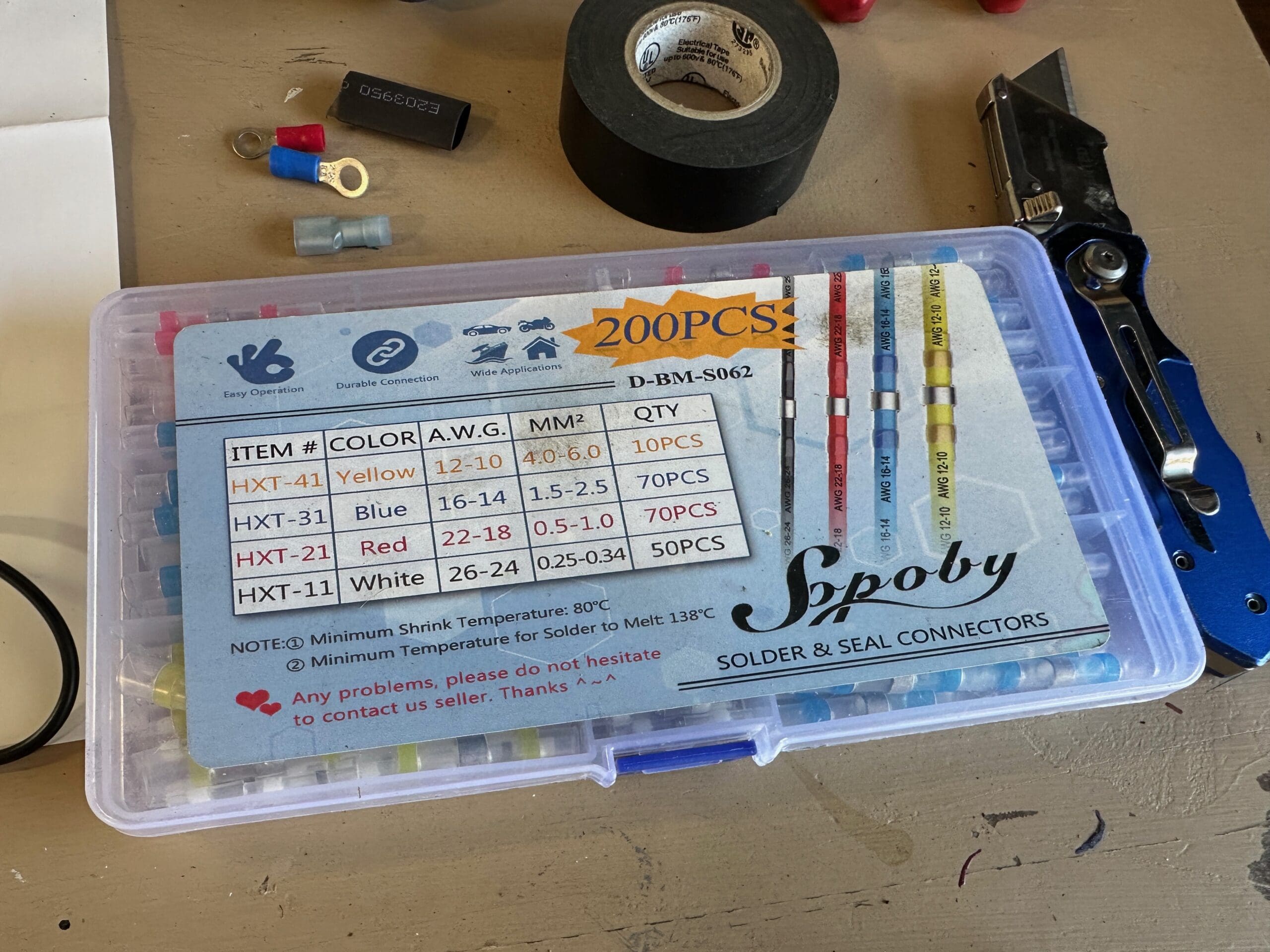

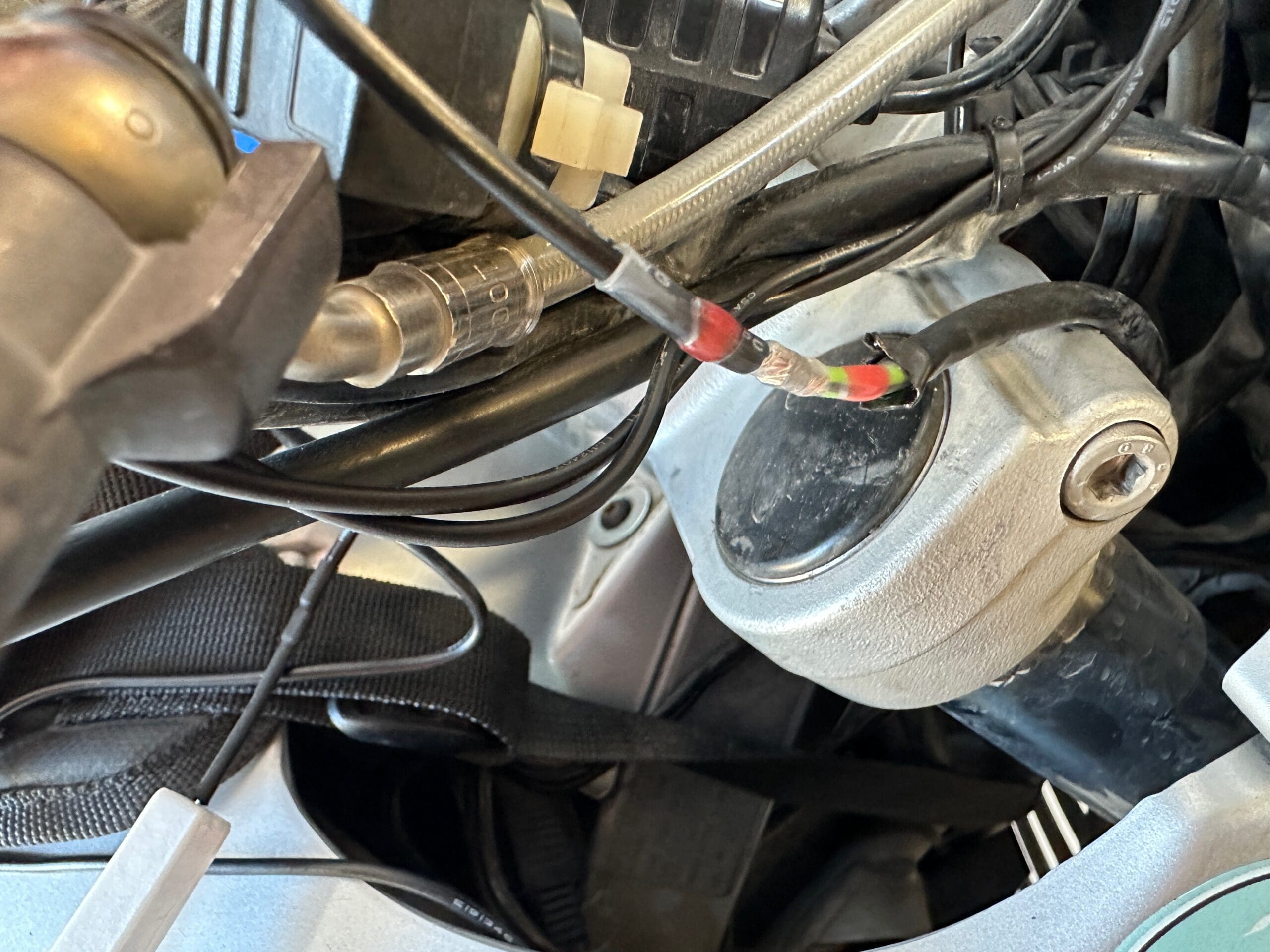

7.) With the wiring in place and the switch location locked in, you can now start connecting the electricity. The Tusk kit comes with a “quick splice”-style connector for tapping into the power wire. The only place this connector belongs is in the bin. They’re not water-resistant and tend to have weak continuity. Use high-quality crimp connectors and heat shrink instead, or my favorite, heat-shrink-style solder butt connectors that ensure a water-tight connection. Remember to disconnect your battery for this splicing step to prevent shocks and shorts.
Connect the power, the ground wire, and all the wires to the heating elements and the switch according to the included wiring diagram. Mount the switch in its hole, route all the wiring cleanly and away from areas where it might snag or be too exposed to the elements, and secure with cable ties.
8.) Reconnect the battery and test the system both on the high and low settings before reinstalling any bodywork you may have removed.
