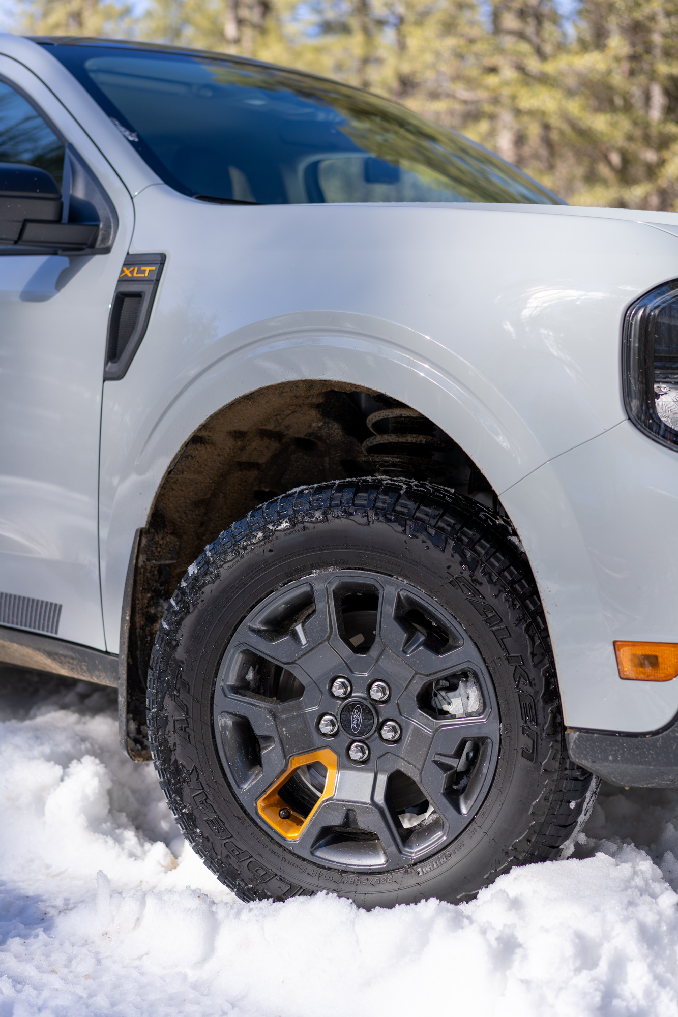

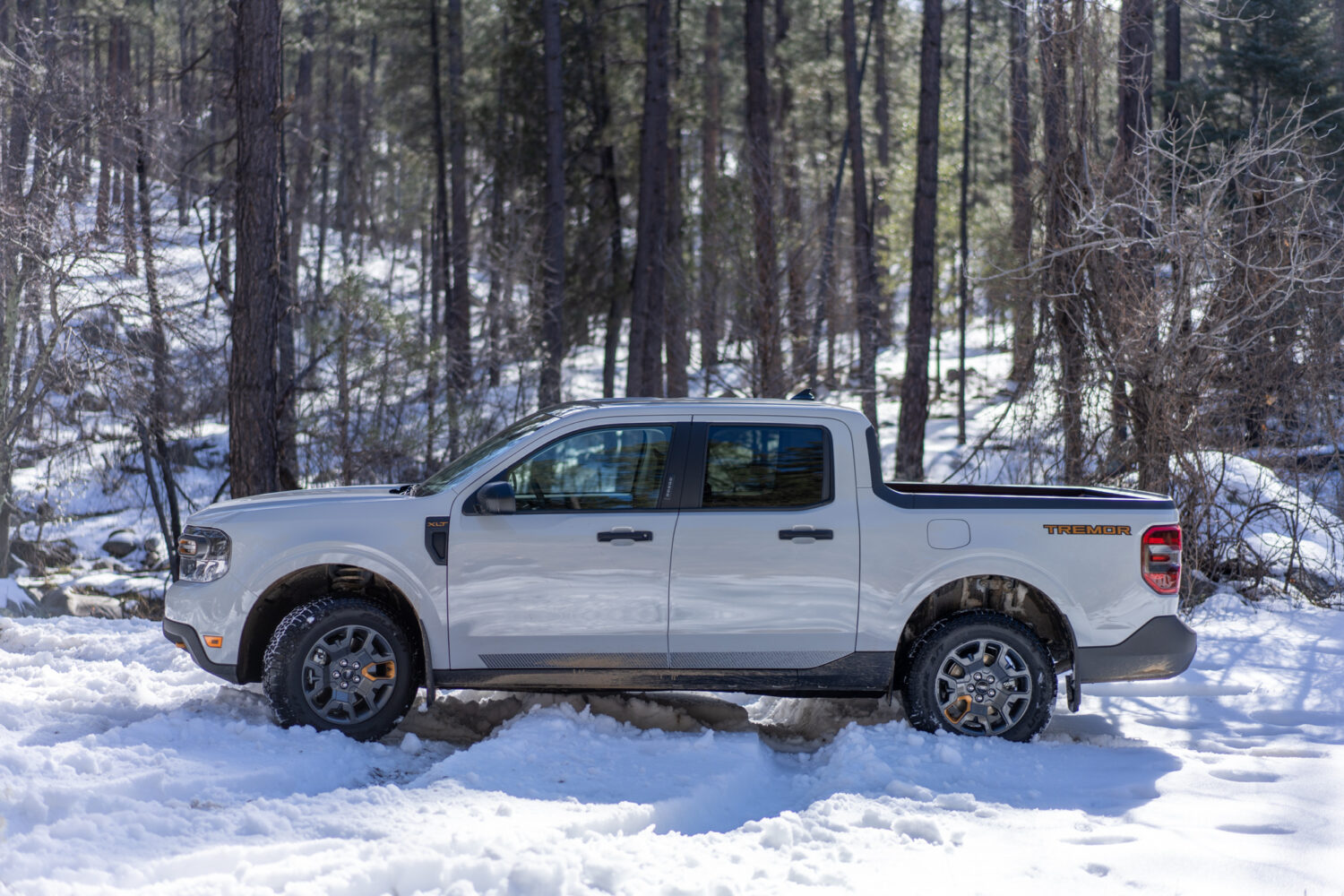

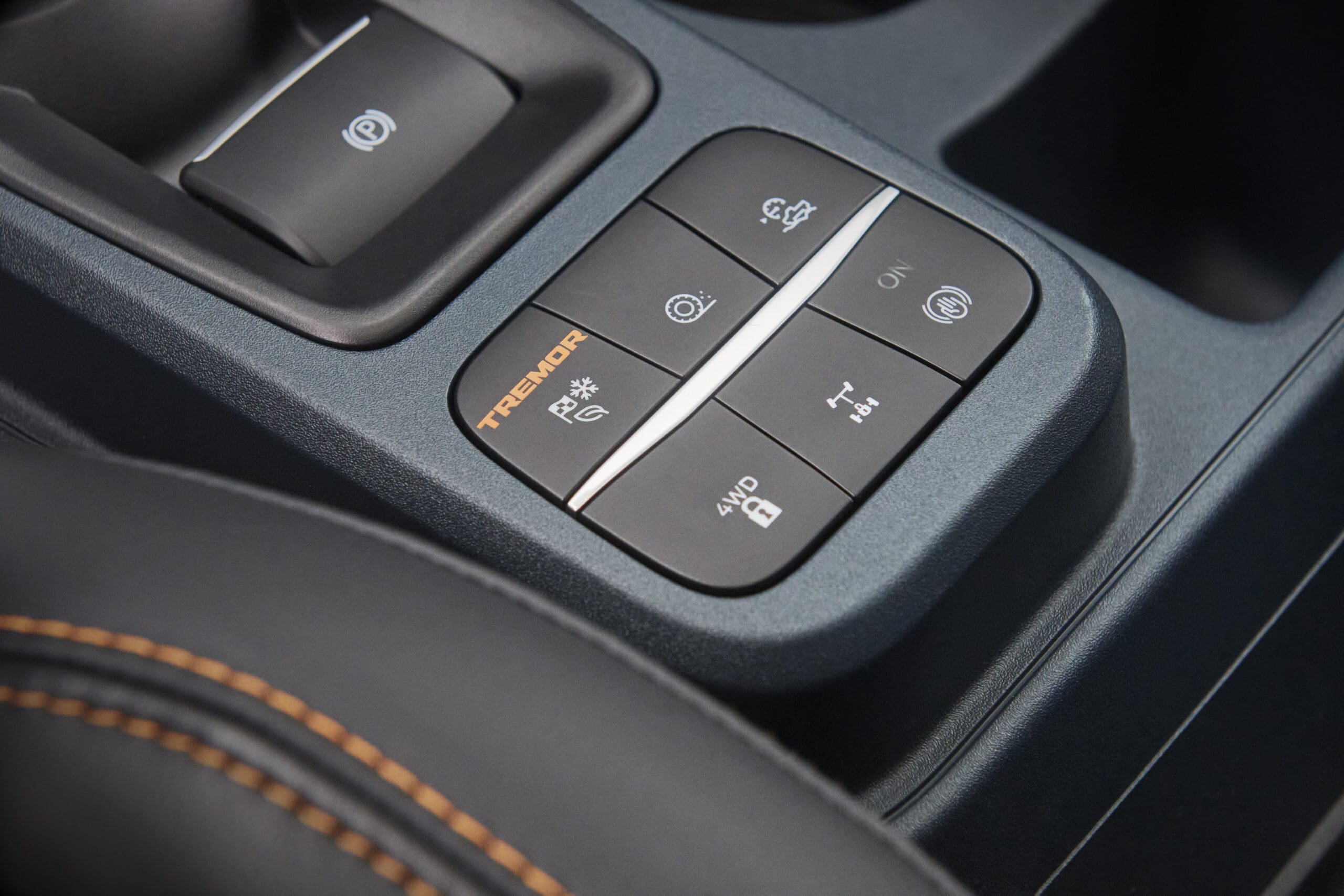

The Maverick XLT we tested at our home offices in Arizona arrived with the off-road-oriented Tremor package, which, aside from the FX4 trim, is the version adventure-travel enthusiasts should set their sights on. Available only on the mid-grade XLT and top-dog Lariat AWD models, the Tremor spec comes with an impressive and affordable ($2,995) range of upgrades that, with the exception of a sprinkling of gold decals and paint accents, are fully useful and functional with no filler. These include:

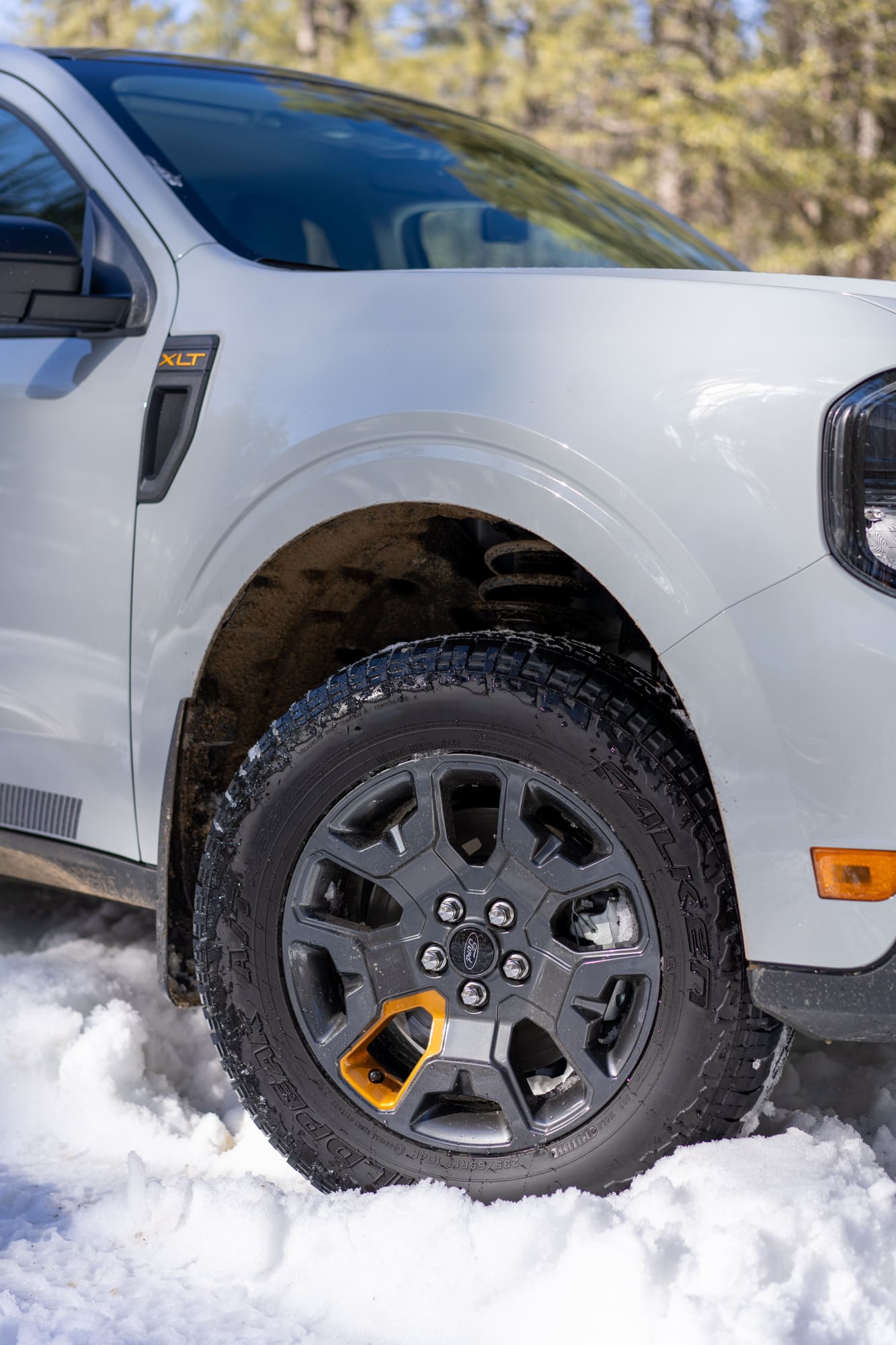

  • Taller springs (1 inch) for additional ground clearance
  • Revised shock damping and suspension rates

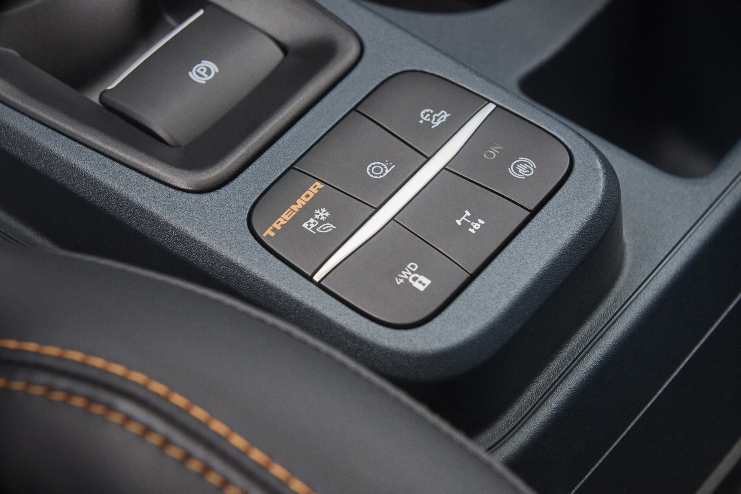

  • Trail Control drive mode (a version of off-road cruise control)

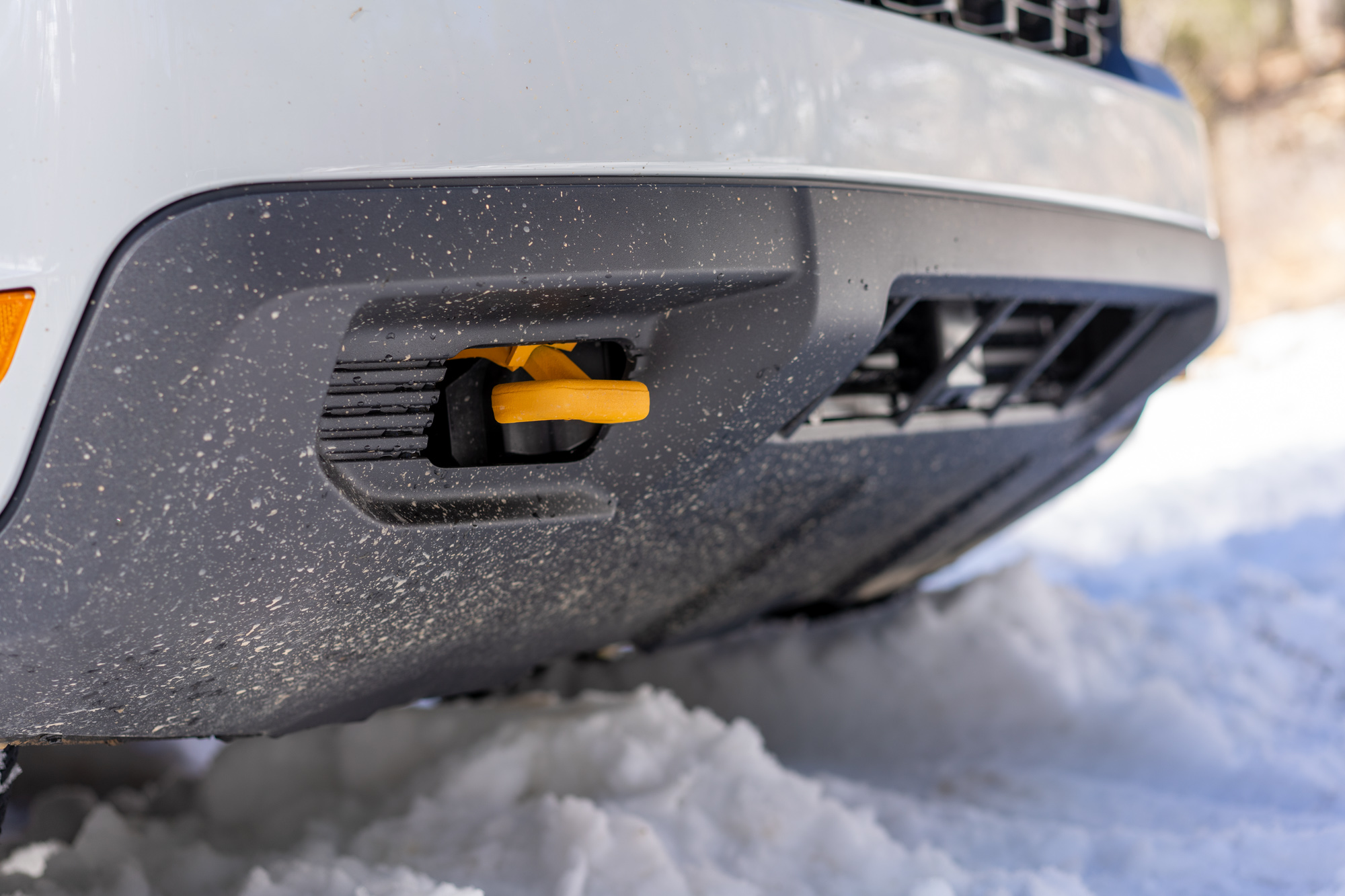

  • Improved approach angle with Tremor-specific front bumper, which includes two GVW-rated recovery points
  • Twin-clutch rear-drive unit with torque-vectoring and a clutch-activated “locking” feature
  • Upgraded CV axles and prop shaft
  • Upgraded transmission cooler
  • Steel skid plates
  • Larger 29.5-inch diameter Falken Wildpeak AT3W all-terrain tires on 17-inch wheels
The Tremor shares its core mechanical specifications with other AWD Mavericks, including the 2.0-liter EcoBoost turbo-charged, four-cylinder engine that produces 250 horsepower at 5,500 rpm and a meaty 277 pound-feet of torque at 3,000 rpm. The 8-speed automatic does not have a manual mode, so accessing the relatively high and narrow powerband of the EcoBoost can feel like a challenge. More on this later.

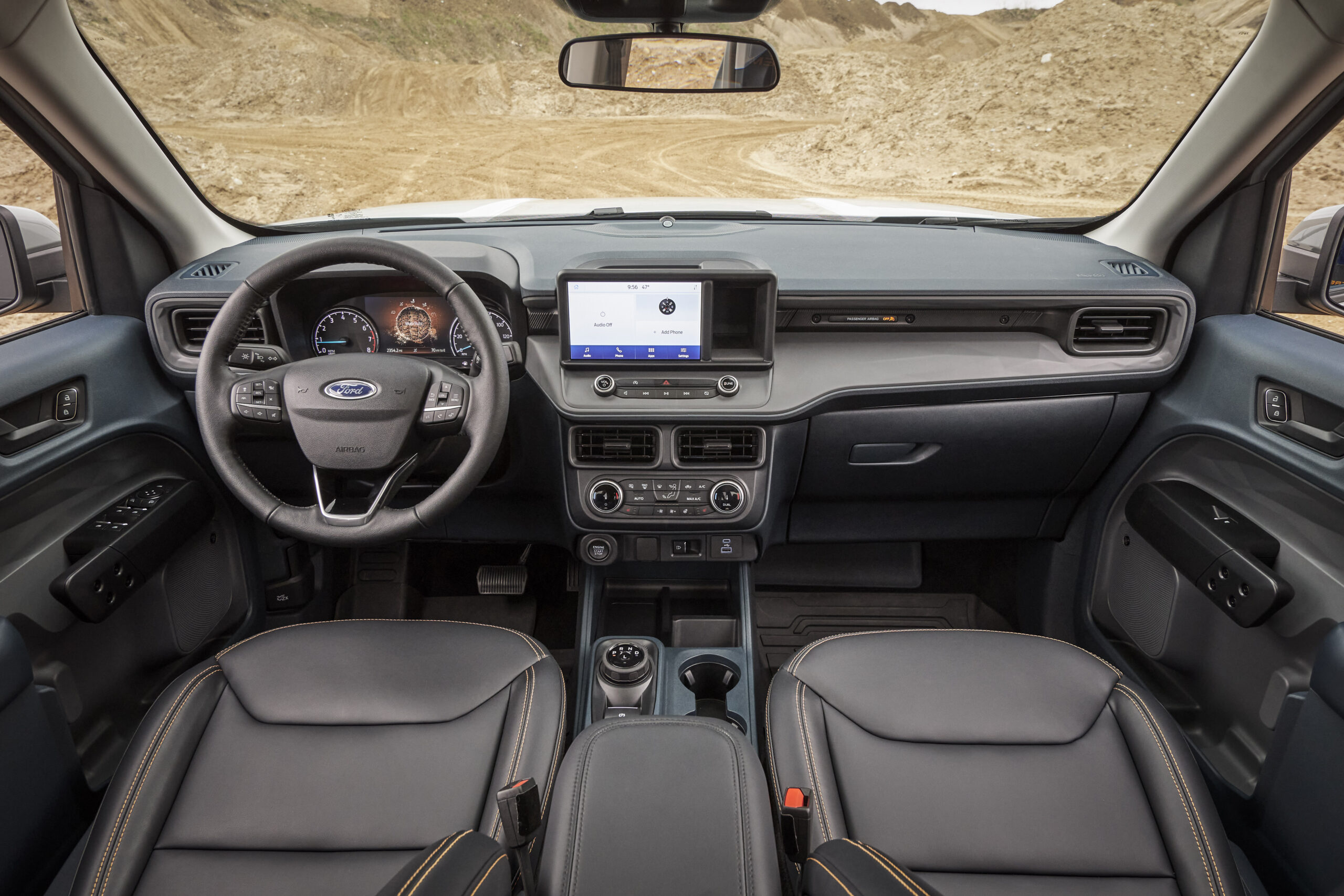

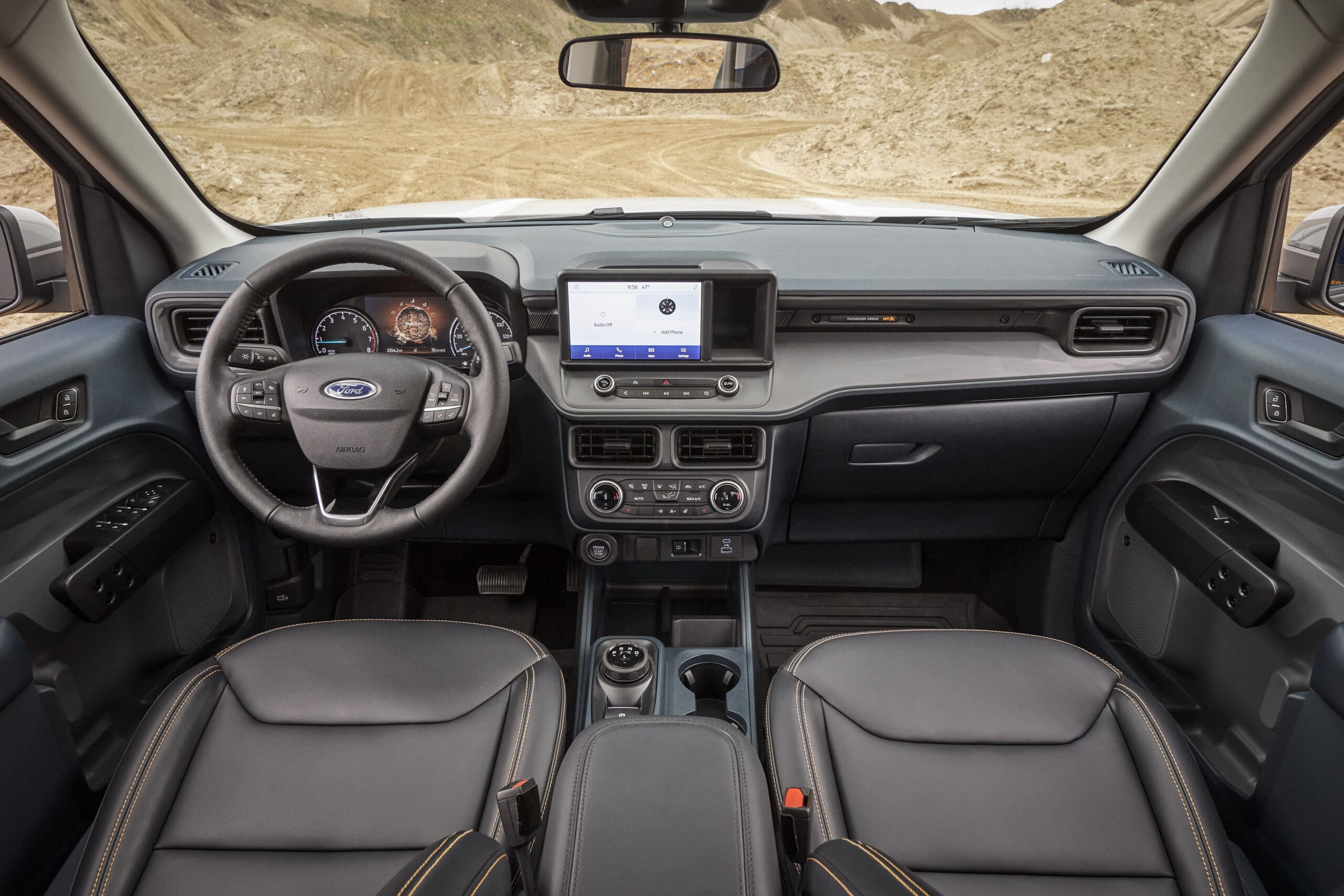

Besides a handful of Tremor badges, Ford carries over most of the interior appointments familiar to the rest of the Maverick lineup, which is to say, bordering on spartan. However, with the exception of some hard plastics and tactile telltales (like the prominent molding cut-line on the steering wheel), most of the interior feels durable and high quality, especially the seat and door card fabrics (Lariat models get leather trim). Happily, controls for nearly all the truck’s functions are either buttons or knobs—only two small screens confront the driver, and they are crisp and easily legible in direct sunlight, only conveying essential information.
Apple CarPlay and Android Auto are available for the entertainment system, and wireless charging and dual-zone climate control are about the extent of the Maverick’s tech suite. This refreshing modesty in the gadget department helps keep both complexity and the price low, as well as reinforcing the feeling that this is a car for drivers.

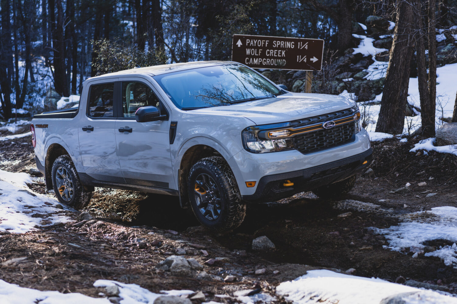

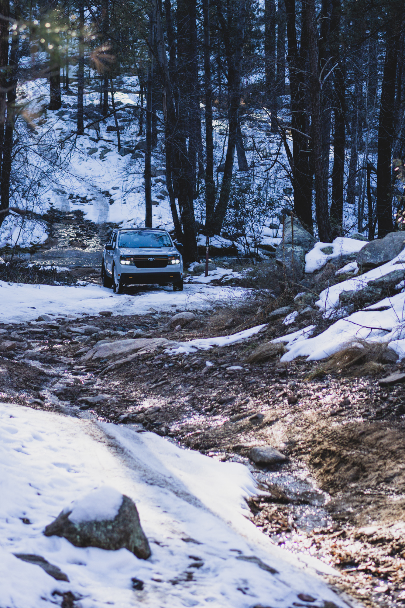

On our off-road testing loop in the mountains of central Arizona, we encountered typical mixed conditions for late winter, including sheet ice, snow, wet stones, running water, and mud. The Tremor displayed an exuberance on this terrain beyond what the chassis might suggest. The seating position is excellent, as is outward visibility, especially over the front fenders, where the wheels are pushed far to the corners. Coupled with the relatively thin A-pillars, this makes placing a tire exactly where you want it on rough ground easy.
2023 Ford Maverick Tremor

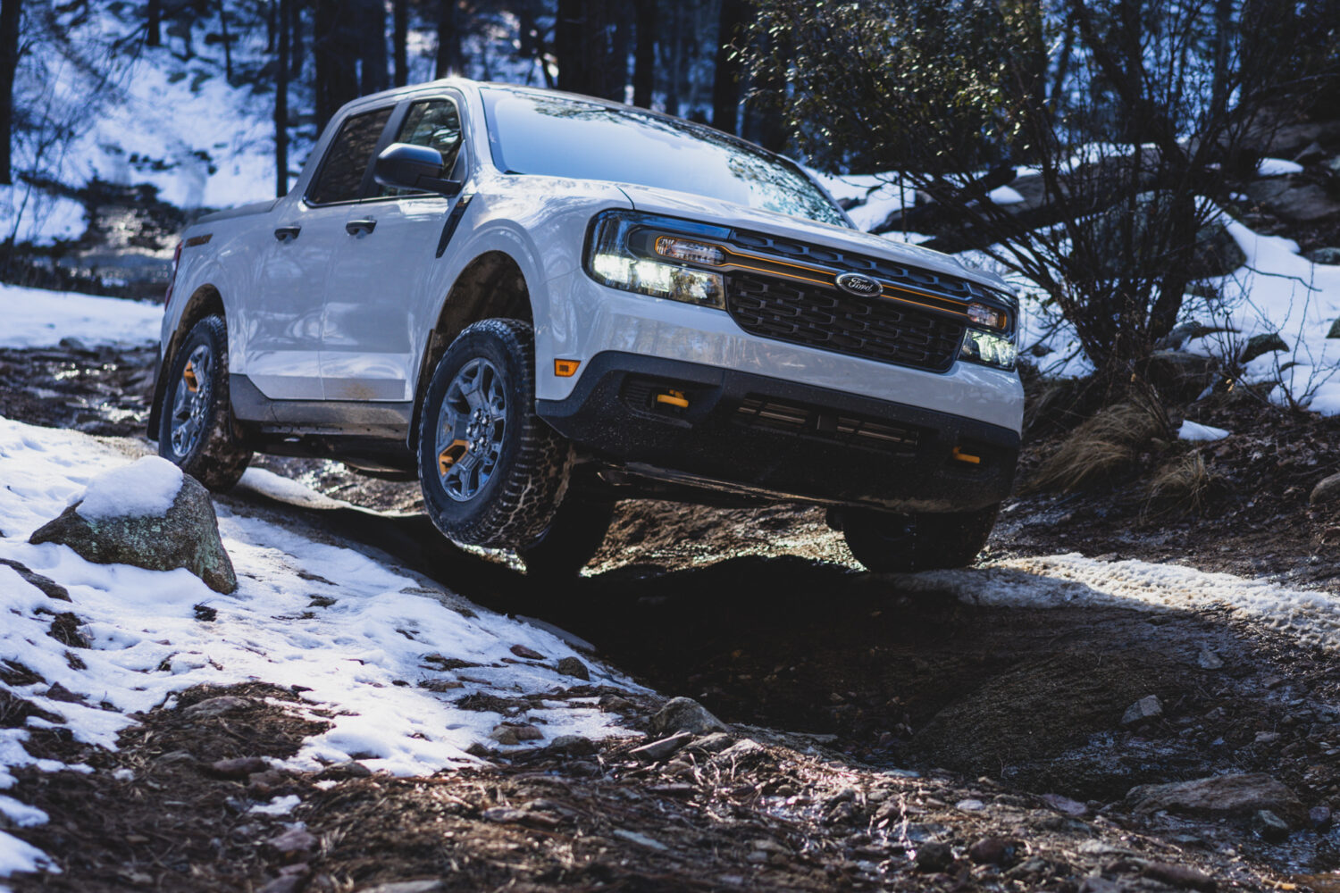

The Tremor’s 30.7 degrees of approach angle (thanks to its unique front bumper), 22.2 degrees of breakover, and a 19.9-degree departure angle, along with the steel skid plate, also contribute to confidence on the trail. This is tempered somewhat by a traction control system that cannot fully be defeated and a lack of articulation. Nevertheless, the torque-vectoring “Intelligent All-Wheel Drive,” in concert with the virtual “locking” center and rear differentials, was effective at keeping the Falkens biting. The driver can feel the system at work through the seat of their pants, which is excellent feedback for tackling more demanding obstacles, like cross-axle terrain.

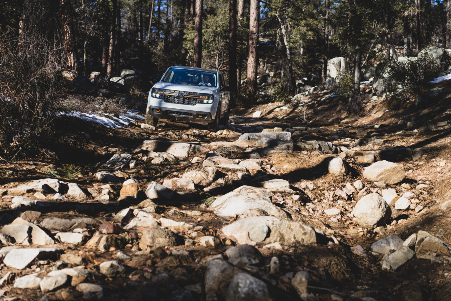

A Gladiator Rubicon, the Maverick is not, and despite an admirably low 4.69:1 first gear ratio, it’s no substitute for a true low-range transfer case, and it goes without saying that 37s will never fit under the wheel wells. The peaky horsepower (max power at 5,500 rpm) and torque curves mean the Tremor needs to carry momentum to dispatch some trail features, which is a liability given its adequate, but not spectacular, 9.4 inches of ground clearance and potential shock to the CV-axle drivelines. Time will tell if those components will have the durability to hold up to repeated hard use.
The Rift Zone—AWD vs 4WD
Rock crawling is not the Maverick Tremor’s mission, and we enjoyed the challenge of getting the little pickup up and down parts of the national forest trails on our loop that make heavier-duty but overbuilt 4x4s barely blink. Getting out of the truck, walking the line, and discussing traction points and vehicle placement all boost skills and reinforce good habits for off-road travel. The Tremor doesn’t necessarily signal continental drift-level improvements for AWD off-roaders, but its capabilities are impressive and more than usable for the vast majority of overlanders.

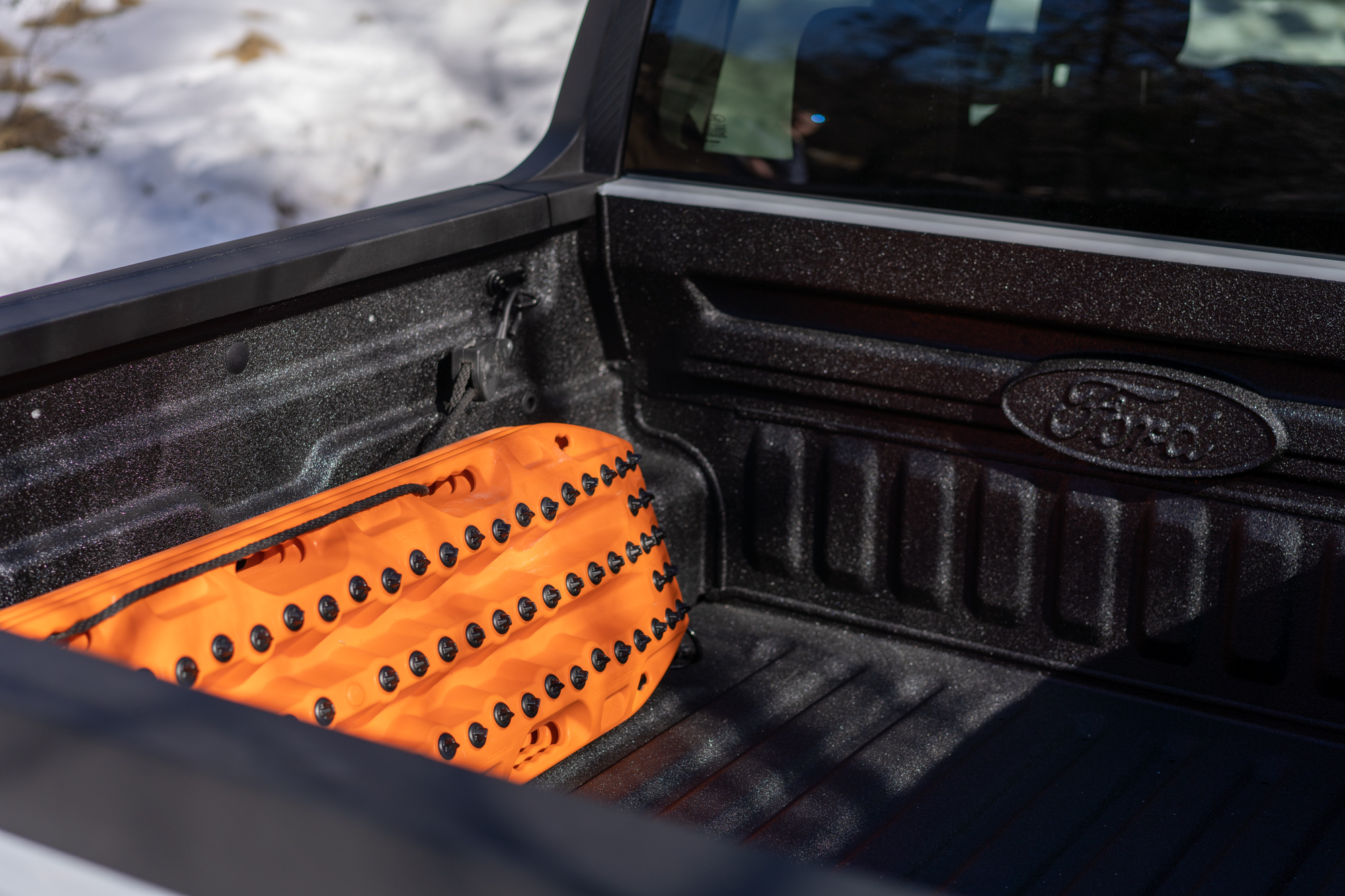

The Maverick shows great potential as an entry-level overlander. We like its efficiency, practicality, and comfort as a day-to-day vehicle, and its low pricepoint gets the buyer an excellent range of functional equipment and upgrades with the Tremor package. It’s a simple vehicle that’s not overwhelmed with technology. Storage abounds in the thoughtfully laid-out interior, and while the bed is relatively small, it does feature handy options like a 110-volt outlet. Plan your build like a backpacker: add a lightweight shell, like a Go Fast Campers Ford Maverick Camper, an auxiliary power station, and a partner to share in your adventures, and the world is at your doorstep.
Where the Maverick Tremor can come up short for long-term travel is in payload and towing. At 1,200 pounds, the Tremor’s payload is 300 pounds less than other Mavericks, and it is restricted to 2,000 pounds of towing, ruling out many off-road trailers. Ford offers an uprated Maverick tow package that boosts towing capacity to 4,000 pounds, but it’s curiously not available on Tremor models. Those metrics are important for many truck buyers and may have some cross-shopping traditional body-on-frame pickups, like the Maverick’s stablemate, the Ranger.
