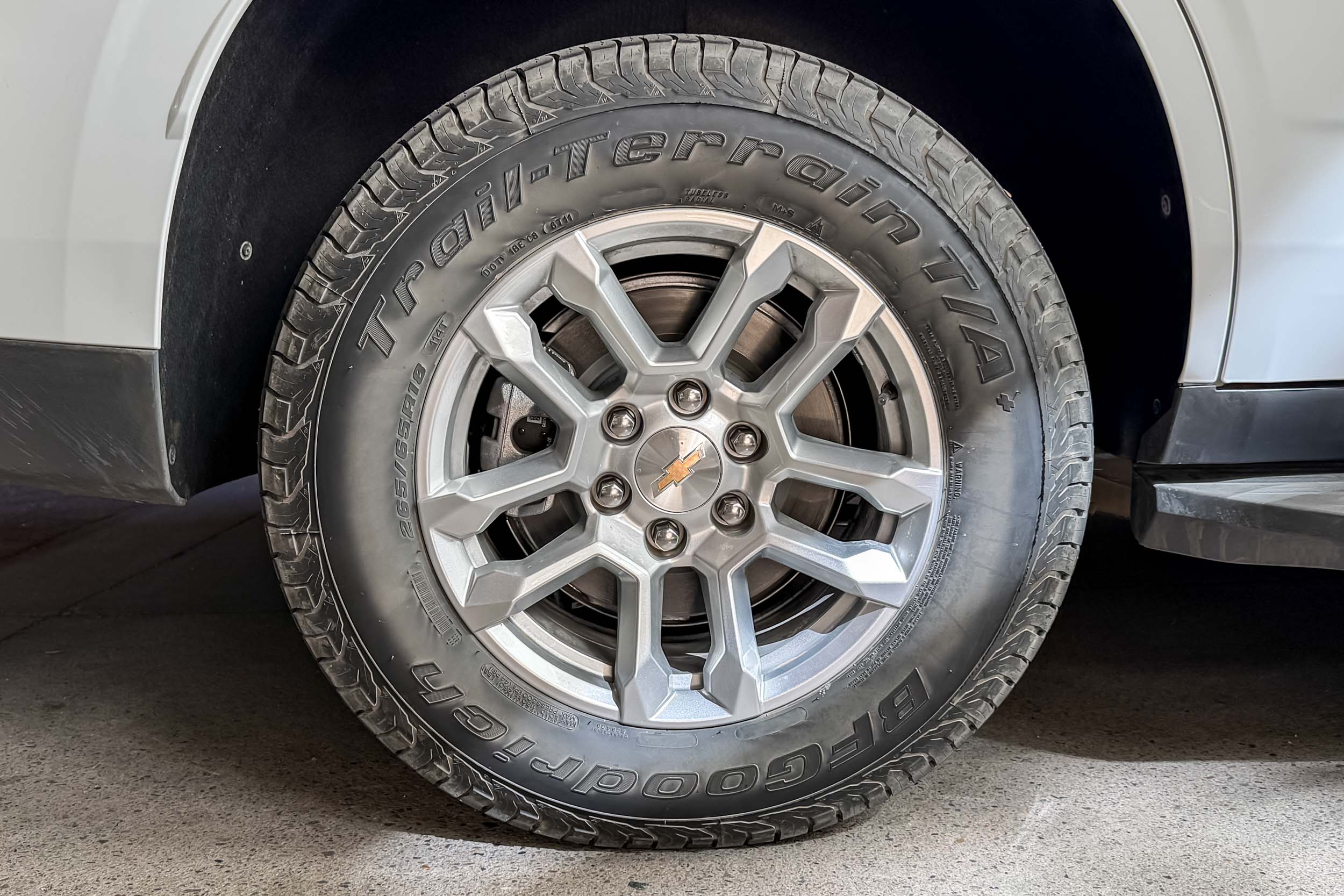

While the BFGoodrich Trail-Terrain+ all-terrain tire is a great original equipment (OE) tire replacement for many vehicles used for overland travel, it’s not a replacement for a KO3, KM3, or other more aggressive, and most importantly, more cut-resistant sidewall, off-road focused tire. With that said, a majority of overland travel happens on pavement, dirt roads, and gravel roads, and those are the environments this latest BFG A/T excels in.
The “+” isn’t a ground-up redesign. It’s a compound update, and the tread pattern you know from the 2021-launched original carries over unchanged. The only physical tell on the new tire is a “+” molded into the sidewall. Everything else that’s different lives in the tread’s rubber.

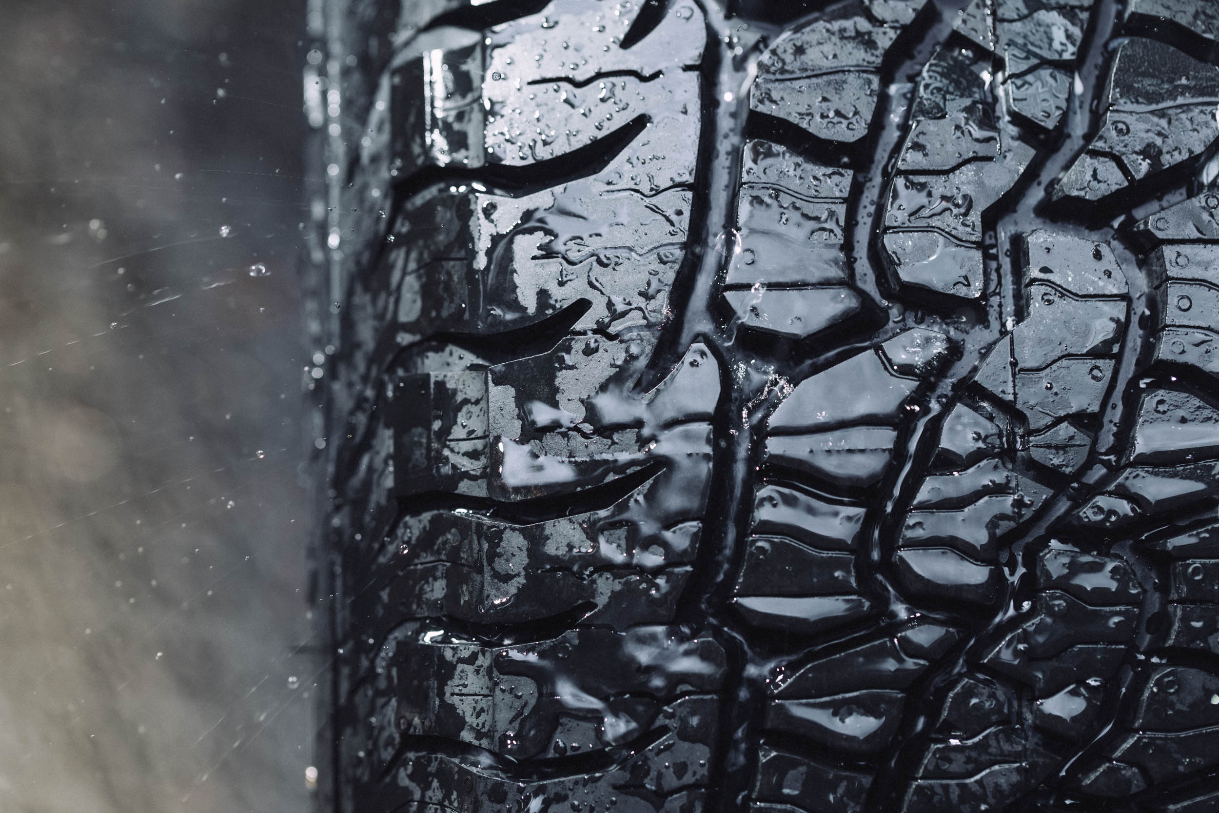

The main reason the “+” exists is to improve wet traction. BFG developed a new tread compound with a higher silica content. The payoff is a claimed 10% improvement in wet grip over the original. Sadly, for testing purposes, my time with the tire was a beautiful bluebird day in the Rockies, so I can’t give you an opinion on this claim.
Beyond wet grip, the new compound provides two benefits that will save you money. Likely most importantly, up to 25% better wear performance and a new 65,000-mile treadwear warranty, up from 60,000. And, a 5% improvement in rolling resistance, which should help with fuel economy.

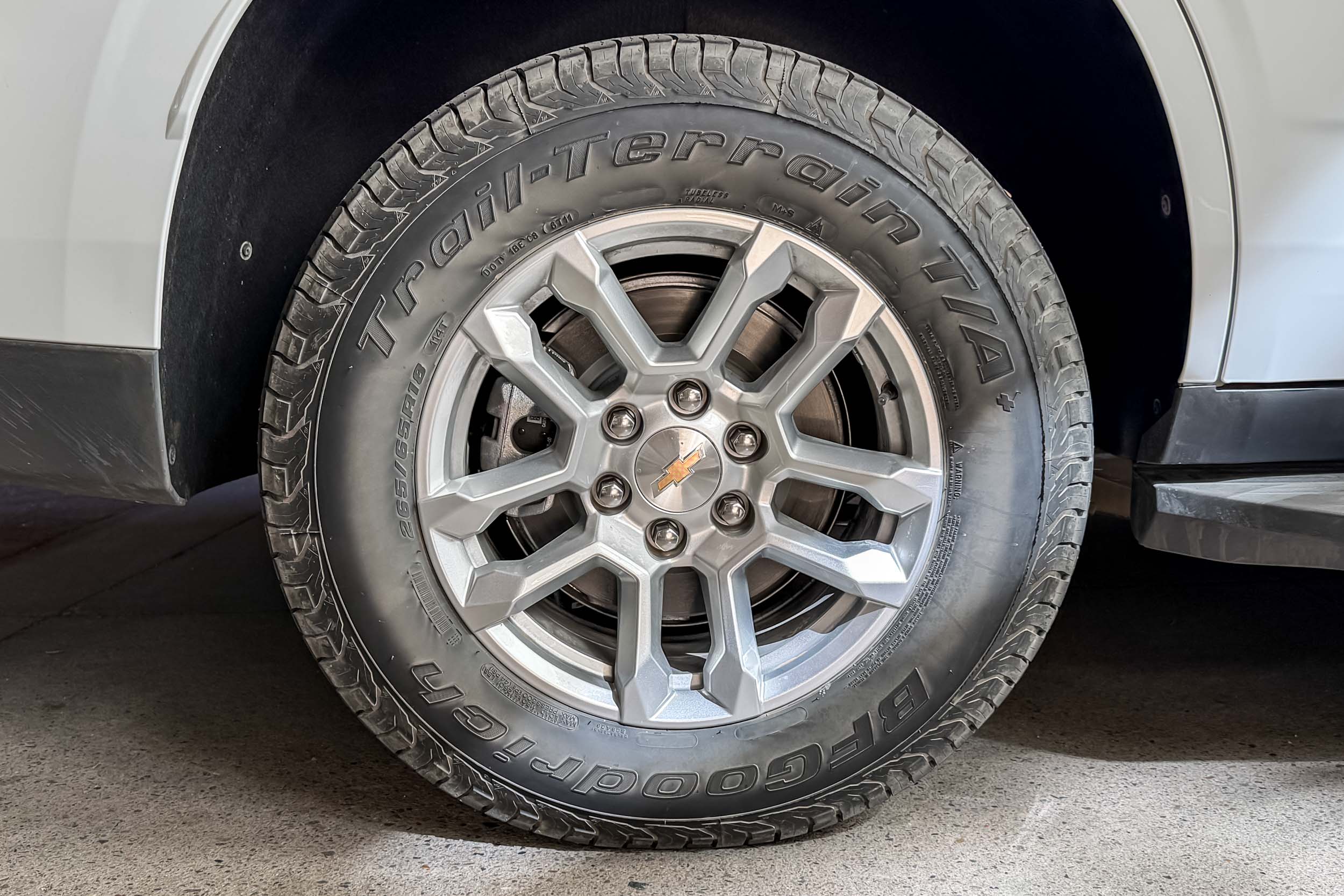

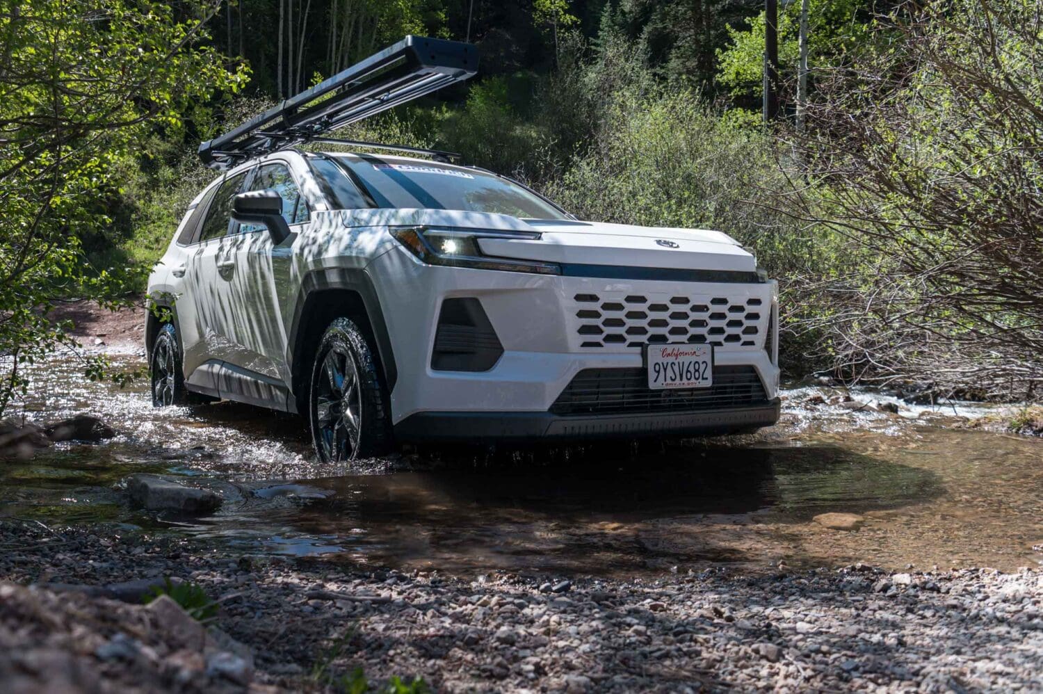

I got to be driver and passenger in the new Chevy Tahoe and Subaru Outback Wilderness fitted with the new Trail-Terrain+ tires. I experienced both on the interstate highway, on two-lane mountain roads, on dirt roads, and on gravel roads.
Bottom line, the tires were quiet for an A/T, confidence-inspiring on curvy back roads, and handled dirt and gravel with ease. And, they looked better/more aggressive than the original equipment (OE) tires.
If you manage your expectations, you’ll likely be very happy with these new tires for a wide range of applications. BFG is clear about positioning: this is for SUVs, CUVs, and light trucks, “primarily for on-road use and light off-pavement driving.”

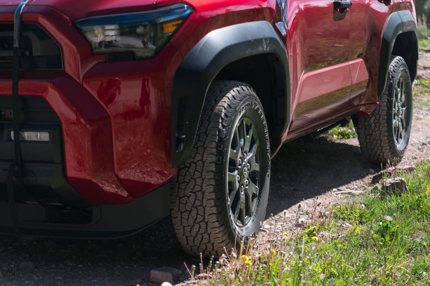

Where the engineers put real effort for the off-pavement crowd was regarding gravel-road durability. They tested for it, and the impressive cut-and-chip resistance comes mostly from the compound but also benefits from the tread design. If your unpaved miles consist of dirt forest service roads and gravel, this tire is a great option.
What this tire isn’t built for is rock-crawling abuse. Atop BFG executive said: “We did not focus on sidewall puncture resistance, like we did on KO3.” The Trail-Terrain+ has only a 2-ply sidewall, although it does use the same sidewall rubber compound as the KO3.
