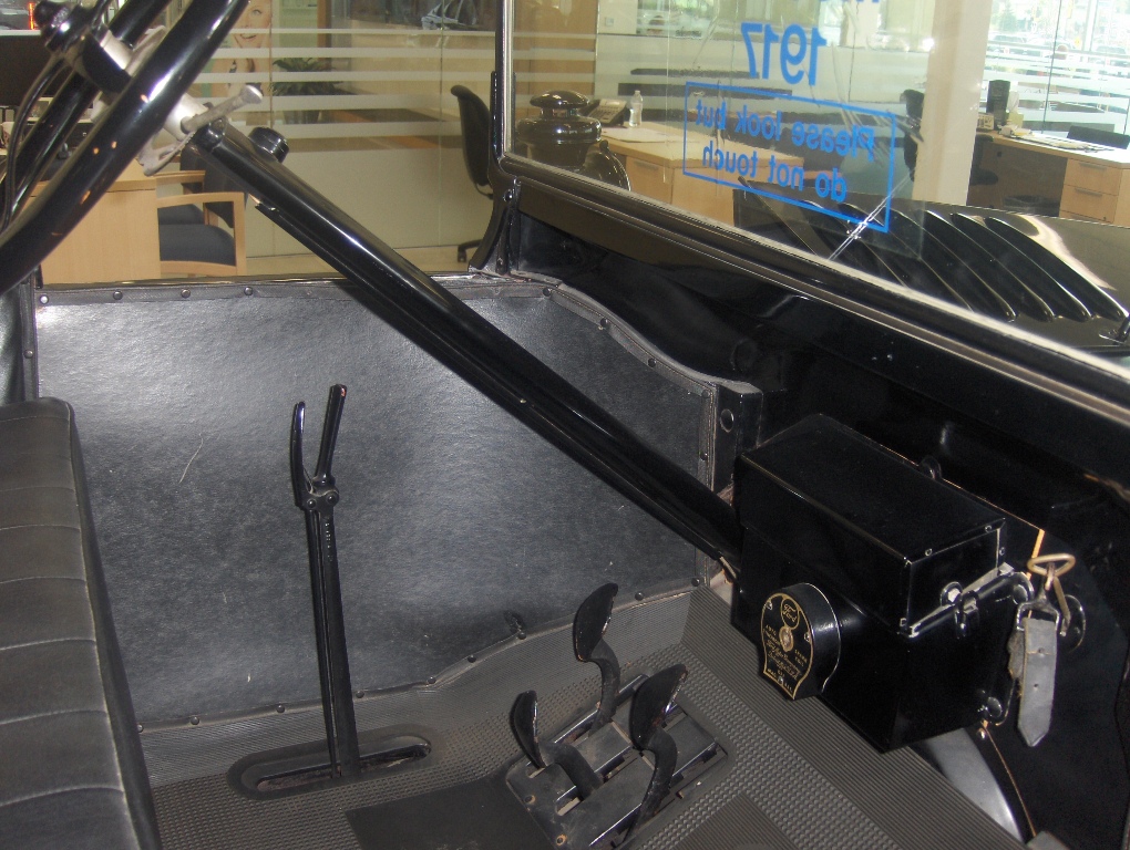

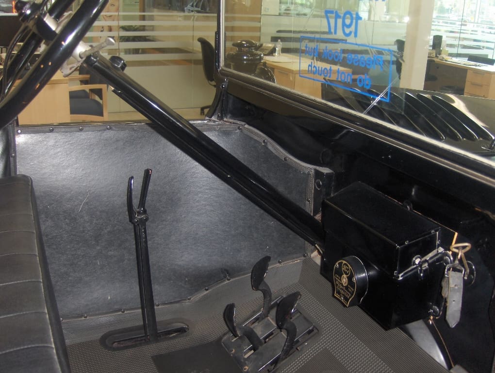

As manufacturers experimented with vehicle design in the earliest days of motoring, basic vehicle controls were not standardized. Take the Ford Model T, for instance. Launched in 1908, it was the first mass-produced automobile within reach of the everyman, and one could argue that it was also the first overland vehicle. Considering the very primitive American highway system near the turn of the century, Model T owners had very little choice but to take the road less traveled. The Model T featured a dedicated foot pedal for reverse gear, and, interestingly, hand controls for on-the-fly carburetor settings, ignition timing, and the throttle.
Model T drivers would adjust the throttle position and advance and retard engine spark to suit the driving conditions. These controls were cable and hard linkage-operated, and this design prevailed for the next eight decades—though the throttle moved from the steering column to the floor as vehicles adopted modern layouts. In the late 1980s, BMW introduced the first electronic throttle, where physical changes in pedal position were relayed to the throttle body through the engine’s computer, rather than a steel wire. By the 2010s, the throttle cable was dead, and electronic control for the loud pedal was universal.
