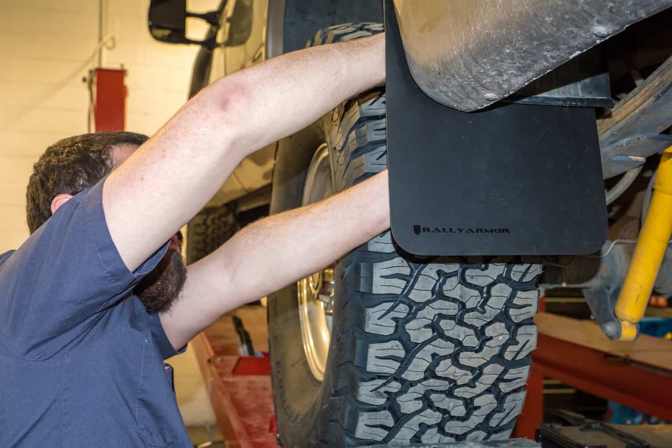

Since these mud flaps are universal, they are a little more difficult to install but not terrible. It will only require basic hand tools, a drill, and the hardware of your choice. Hardware is not included with the purchase because every vehicle has different factory mounts. We recommend a good set of rust-resistant nuts, bolts, washers, and backing plates. The following was our basic install process.
  • Align one flap to a factory mounting hole, and mark your drill target accordingly.
  • Drill it, and bolt it into place.
  • Use the factory mount as a pivot, and rotate the flap to the desired angle, then mark the remaining holes.
  • Check the alignment and drill.
  • Once you’re done, lay that guard against the one for the opposite side, and copy the holes to that flap with a marker. This ensures your guards are even with each other and presents a clean uniform look. Repeat the process for the front or back set depending on where you started.
