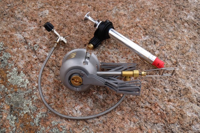

The heavy-duty nylon case contains the stove, multi-fuel pump, windscreen, and servicing tool. For maximum convenience, I have been using Primus fuel cartridges which contain 25% propane, 25% isobutane, and 50% butane. I have also used the stove with similar cartridges from MSR and Jetboil with equal success despite slight variances in the fuel blends. The advantage to cartridge fuel is the ability to quickly ignite the stove with no priming, pumping or other additional steps. Simply thread the cartridge onto the stove and light the burner. It’s that easy.
To burn liquid fuels, the user only needs to implement the fuel bottle and included liquid fuel pump. I tend to avoid burning kerosene or diesel as they‘re relatively dirty fuels and require more frequent stove cleaning and maintenance. Gasoline has the disadvantage of being rather volatile making priming tricky at best. White gas is my standard go-to and not only burns well, it burns cleaner than other fuels.

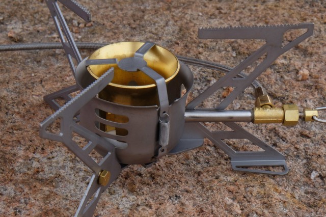

Aside from the multi-fuel benefits, the two additional elements that make the OmniFuel such an ideal cooking solution are the larger than normal pot supports and the variability of the flame for proper temperature control. Simmering rice is the cooking challenge I put before all of the stoves I test and the OmniFuel’s precise flame control allowed me to not scorch my rice, nor did it require constant attention. The stove shoulders a 2-liter pot without feeling overwhelmed or tippy and once the cooking duties were over, it folded up quickly and slipped into its oversized stuff sack.

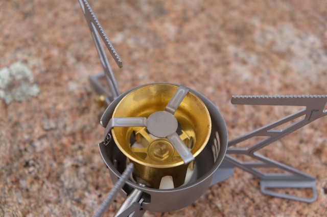

Having tested many Primus stoves over the last year, I’ve come to expect an elevated attention to detail. The OmniFuel is no different and features unique design details that I never would have thought of. For example the critical burner components are held captive to the stove via a small spring retainer as to eliminate the possibility of losing those parts during servicing. The entire stove can be disassembled with the removal of one hex-headed retainer, and the fuel line is covered in braided stainless steel.
