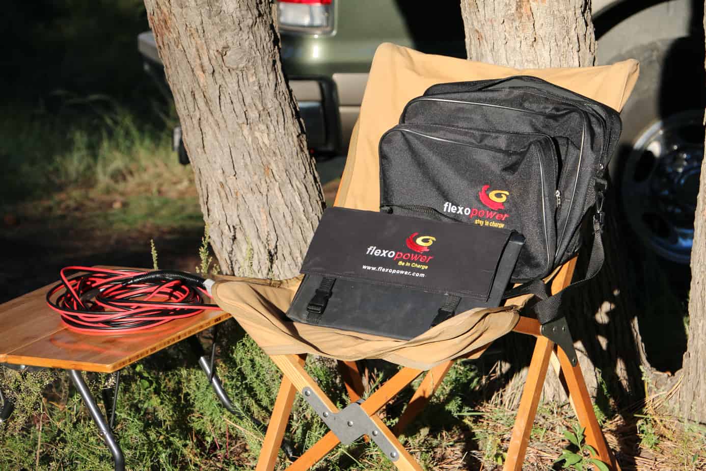

In order to ensure the most accurate test results and eliminate differences caused by aftermarket components and wiring, we opted for Flexopower’s ready to go complete camping kit, which includes the 79 Watt foldable panel, a solar regulator with LCD display, a carry bag, Anderson connectors, 33 feet of cable to run the panel away from the vehicle, and of course all the necessary connectors and hardware for installation. All of this will set you back $772.00 U.S., but you won’t have to purchase a thing after the fact. Tests were conducted in a variety of conditions including full sun, cloud cover, and partial shading, and in all situations the panel lay flat on the ground. The load placed on the vehicle was a National Luna 50L fridge/freezer which we opened multiple times a day, and stocked with a warm six pack of soda, cold meats and cheeses, and a gallon of warm sweet tea. To test the claim that this solar panel could replace a dual battery system, we used it on our stock Excursion which at this time is running on a factory spec battery system.

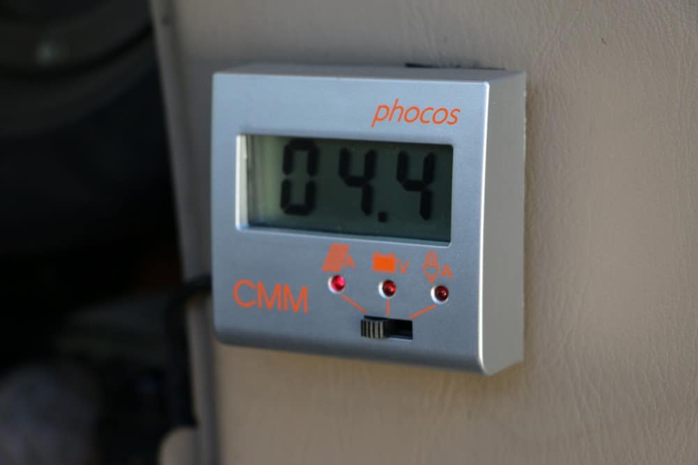

Upon removing the equipment from the bag the first thing I noticed was how robust the panel felt, despite weighing just 6.8 lbs. Unlike some of its competitors that use a light weight fabric on the seams, Flexopower uses an almost rubbery material which after being thrown in the dirt, slung over granite, and dropped in a puddle has shown no signs of wear. The heavier weight also eliminated the need to tie it down in most cases, so while the other panels in our test continually folded up on themselves, the Atacama kept pumping power to the battery. At 15.4″ x 10.4″ x 1.4″ folded, the panel packs easily into pretty much anywhere in the vehicle, and with a deployed footprint of 60.6″ x 30.6″ it fits windshields perfectly. All the supplied connectors and wiring felt sturdy as well, and I loved the regulator’s ability to display the panel’s output, your battery’s status, and the current load on the system at any time. Despite being perfectly functional, I did feel that the LCD screen felt and looked a little cheaper than I would have liked. Yes it’s a superficial complaint, but I’m not thrilled about a silver box being slapped onto the interior of my vehicle.

The second day of the test brought better weather with blue skies and scattered clouds. To my great satisfaction it also brought the battery back up to 12.7 volts by 0930, and the panel was pulling in around 4 amps consistently. By mid day the incoming amps were jumping between 4.4 and 5.0, and the battery had actually come up to a full 13 Volts, which is higher than when we had started. By the third morning the battery was back at 12.9 and rising, meaning that the panel had done more than just meet its claim of running a fridge for two days, but showed it could run one indefinitely with fair weather.

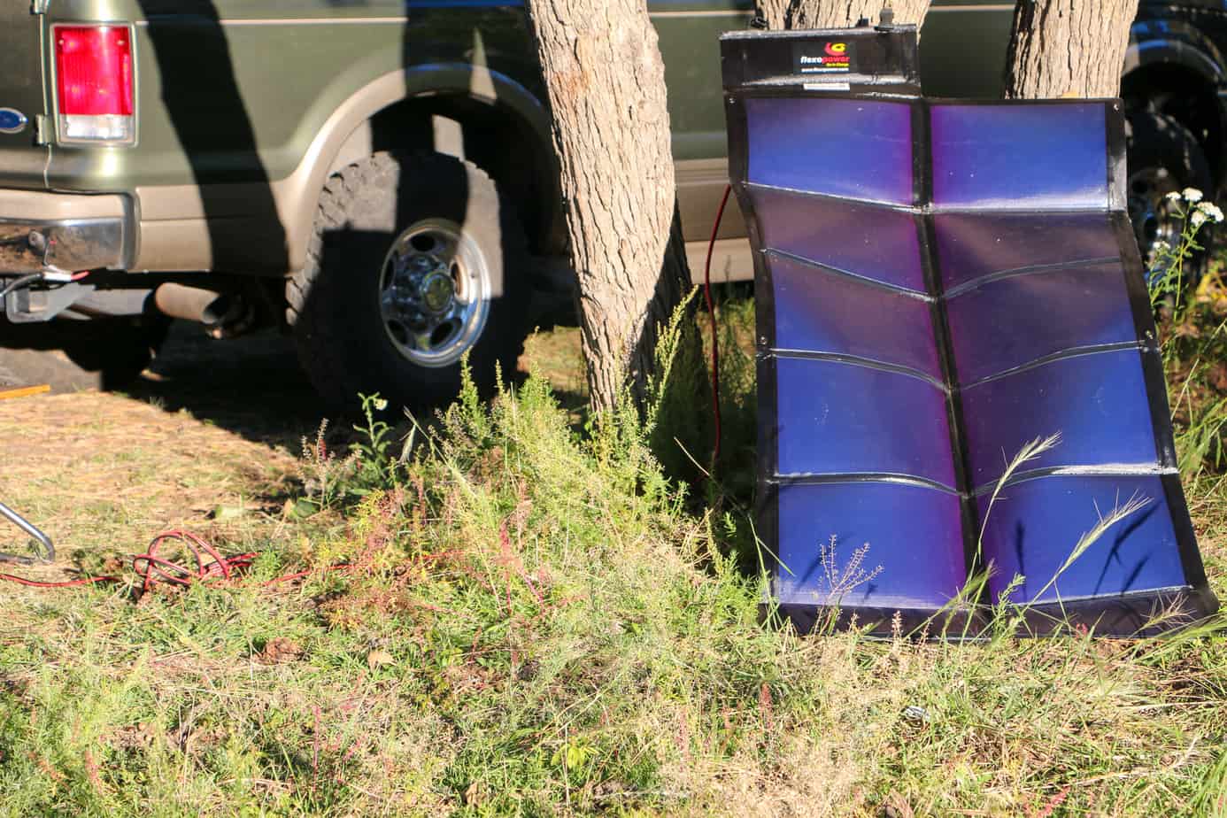

The core principle that Flexopower claims sets their panels apart in shade is their series rather than parallel wiring between soar cells. Think of them like Christmas lights, if you shade or damage one cell at the top of a row, all the cells after it fail to work or are significantly hindered. We decided to test this using a piece of cardboard to block out various sections. While it wont be as realistic as shade from a tree, it’s more controllable. Regardless of where we placed the square on the Atacama there was a consistent drop of .2 -.3 amps, a good representation of the square footage we blocked off. On the second folding panel you see above, the drop was between .3 and 1.0 amps depending on placement., meaning it was still good but less adept at handling partial shading. Finally we threw the cardboard onto the glass panels, and the results were devastating, up to an 80% loss of power. Now we should mention that none of these panels were the same size of wattage, but that just makes the Atacama’s performance even more impressive. It had the least surface area of the group meaning the cardboard covered a larger percentage of its total space, and it was rated 16 to 40 watts lower than its competitors, yet delivered equal or more power.
