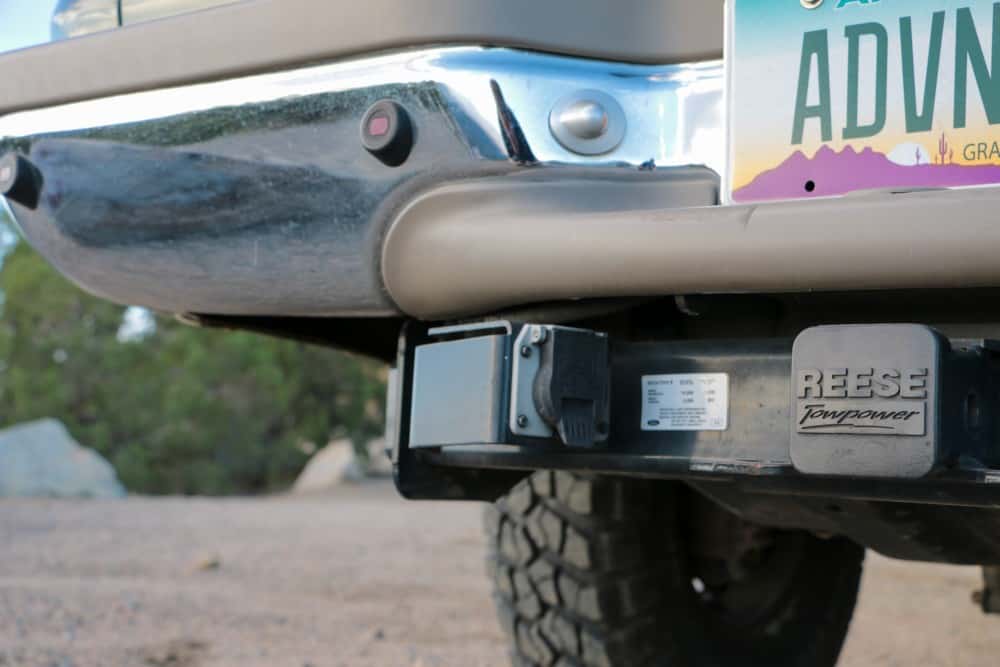

The final product was well polished and looked as ready for soccer practice as any SUV, but its lineage gave it a few options that are relatively special in North America, and downright coveted by overlanders. For starters, the Excursion utilized solid axles unlike nearly all SUVs produced at the time. Models like ours feature a Dana 50 up front, a Sterling 10.5 in the rear, and even an optional 3.73 gear set with a limited slip differential. This not only makes it great for towing, but improves off-road performance and allows for the fitting of larger tires. Front and rear recovery points came standard, as did a 7-pin towing system.

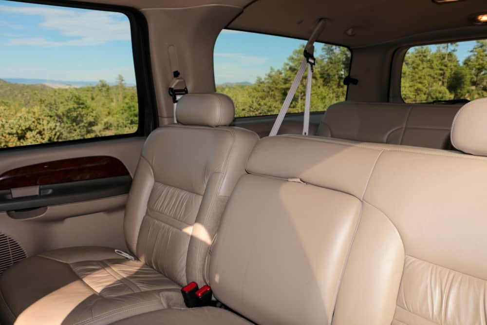

The interior in truth is nothing special, and shares many of the same features you would find in any 2000’s SUV. Large tan leather seats, plastic console and dashboard components, wood trim panels, a trendy rear A/C, and the finest audio system money can buy, a ford tape deck. Okay it has a CD player too. What is rather unique though is just how cavernous it all is. With the rear seats folded flat, I’m able to lay down comfortably, stretch out, and still have room for bags, a cooler, and our lantern past my feet. For most people a Tahoe would be more than enough for this, but at 6′ 4″ having any room leftover after I lay down is a miracle.

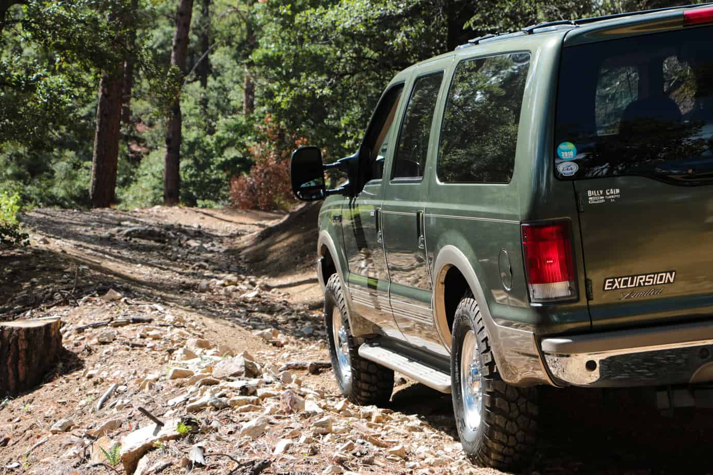

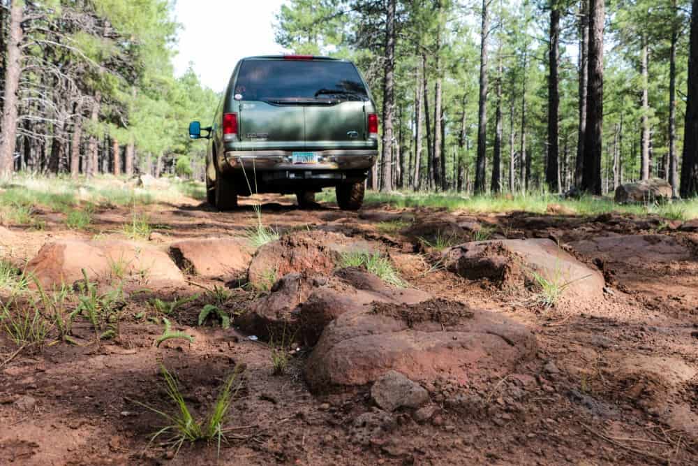

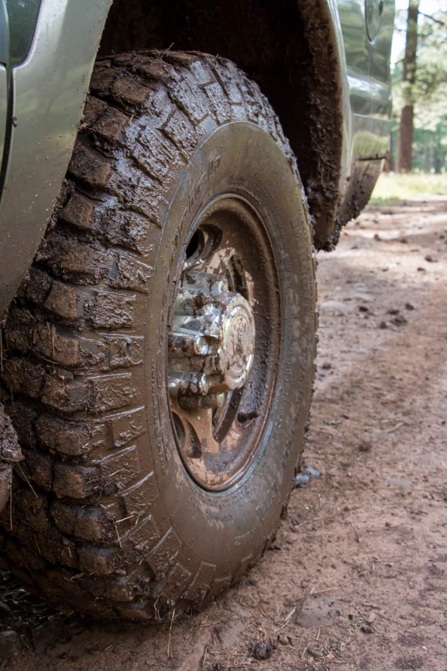

With the limited slip rear end and a set of 255/85 BFG KM2s, we found that the Excursion was able to conquer our cross-axle test course even at a full 65 PSI. The obstacles covered in decomposed granite posed a challenge for the narrow tires though, and they tended to spin more often than we would have liked. Reducing air pressure helped, but larger tires will certainly be in this trucks future. Clearance is obviously a concern for any full-size, and the sagging springs and worn out shocks on our truck did nothing to help that. Nor did they do a great job preventing the road from jarring the vehicle with every rock and bump along the way. Between handling, ride comfort, and trail performance, a change in suspension will be one of the most important upgrades on our list.

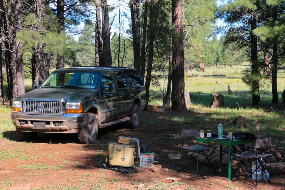

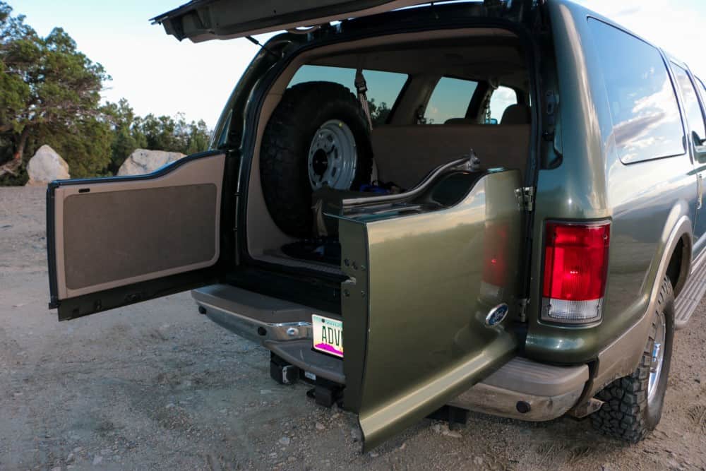

In terms of a camping setup, we felt the Excursion was ready to go from the factory. With seats that fold flat quickly, and enough room to lay down with your gear below your feet, the interior is perfect for sleeping two people comfortably. While it may not look as impressive as a roof top tent silhouetted in the sunset, this method of camping requires little to no investment, isolates you from bad weather and animals, and in many cases reduces setup and breakdown time to nearly nothing. Over the years we’ve come to adore this style of build, and the Excursion has some of the best bones to start with. We will simply be improving the already functional setup with a solid cargo deck, new tie-down points, and of course some additional storage.
