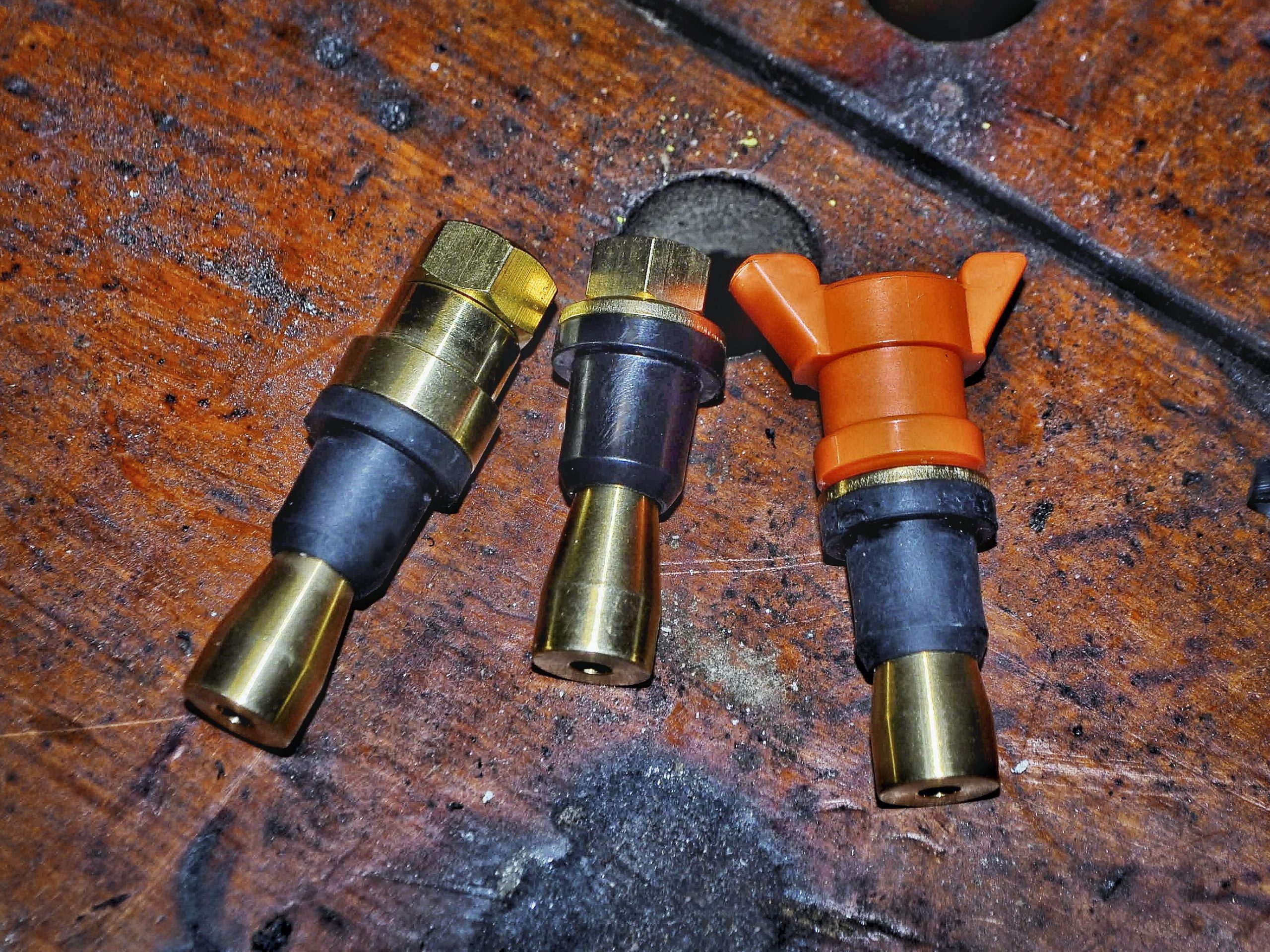

Arkansas-based Colby Valve offers a variety of premium valve stems to replace standard rubber units. Gone are the days of cheap rubber tubing; in are heavy-duty, low-profile quality brass fittings. I recently reviewed their patented US-made Ultimate Valve System permanent valve stems.
Colby Valve Ultimate Replacement Valve Stems
Colby Valve Ultimate valve stems boast an extra short length which lessens the opportunity of trail-side mishaps. Made of quality brass components, Colby Valve replacement stems install from the outside of the wheel and are ready to go in approximately one minute per valve stem. The Ultimate series fits standard .453 wheel openings (which fits trucks, SUVs, and even most bikes). Colby Valve states their products are 20 times stronger than standard valves so we decided to see for ourselves. Colby Valve retails the same standard valve core as stock or OE stems.

Colby Valve Ultimate replacement valve stems are quick to install, low profile, are made from durable components, and can withstand trail hazards better than traditional stock valve stems. During the last few months of travel, our replacement valve stems have held air perfectly and were easy to deflate. Our testers worked adequately with our Pajero’s Fifteen52 analog HD wheels. However, due to their flat design and lip location, the Ultimates protrude farther than anticipated with their metal bases gently resting against the inside wheel lip. Once tightened, we knew it wouldn’t budge. Ben Allread, who also runs Colby Valve Ultimates on his Toyota 4Runner, says they fit perfectly. They’re nestled deeply into his wheel’s valve stem hole with plenty of allowance.
