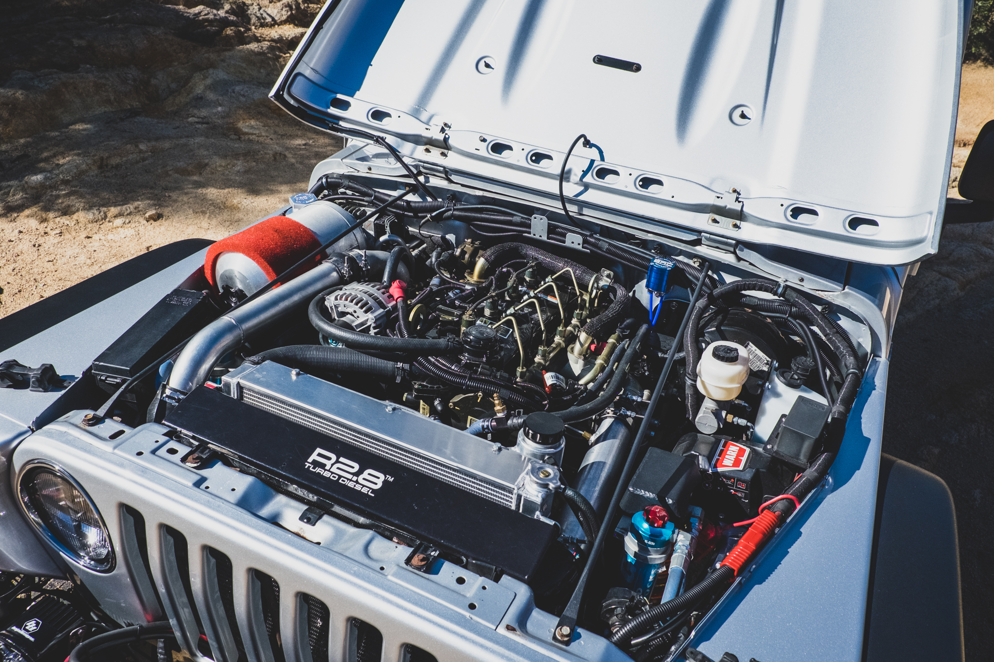

Pete purchased the base Brute from an authorized AEV dealer in spring of 2017. It was based on a salvaged (water damage) 2005 Rubicon that was restored and converted to the Brute in 2014.  Pete had been following the Cummins repower development program since the release of the R2.8 and knew that the AEV truck was the perfect platform for him to use with the diesel motor.  The original Jeep motor died shortly after ordering the Cummins, so the timing was perfect for supporting the repower with the new engine.
At Expedition Portal, our experience with the new Cummins is stellar, including testing the powertrain in numerous donor vehicles like a Land Rover Discovery and a Land Cruiser 80 Series. You can read Bryon Bass’ report here: “Old Dogs, New Tricks.”

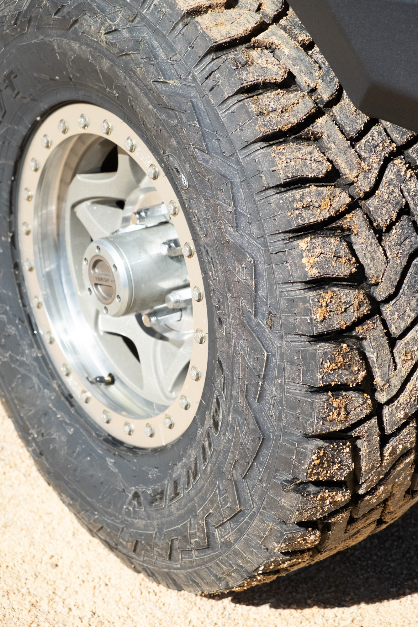

For suspension and axles, Pete wanted the Brute to survive the apocalypse and nearly any trail in Moab, which resulted in a call to Currie Enterprises for their 9-inch Ford axles. His choice was based on the goals of strength, interchangeability (front and rear), and the extensive range of gearing options. Currie will construct custom housings, so a 2-inch wider track width was specified, along with Dana 60 outers, and a full-floating rear. The third members house 35 spline air lockers and 4.11 gears.  Axis designed the long-arm suspension system with a 4-link in the rear and a 3-link in the front supported by monster 2-inch diameter billet aluminum arms. The coilovers are King, and the springs are from Pac Racing, who spent days dynoing and revalving the shocks to match the spring rate. To handle the additional weight of the camper, larger diameter front and rear anti-sway bars were installed.  Particular attention was paid to the overall weight of the Jeep, and the final scale reading showed 5,700 pounds with 24 gallons of fuel on board.

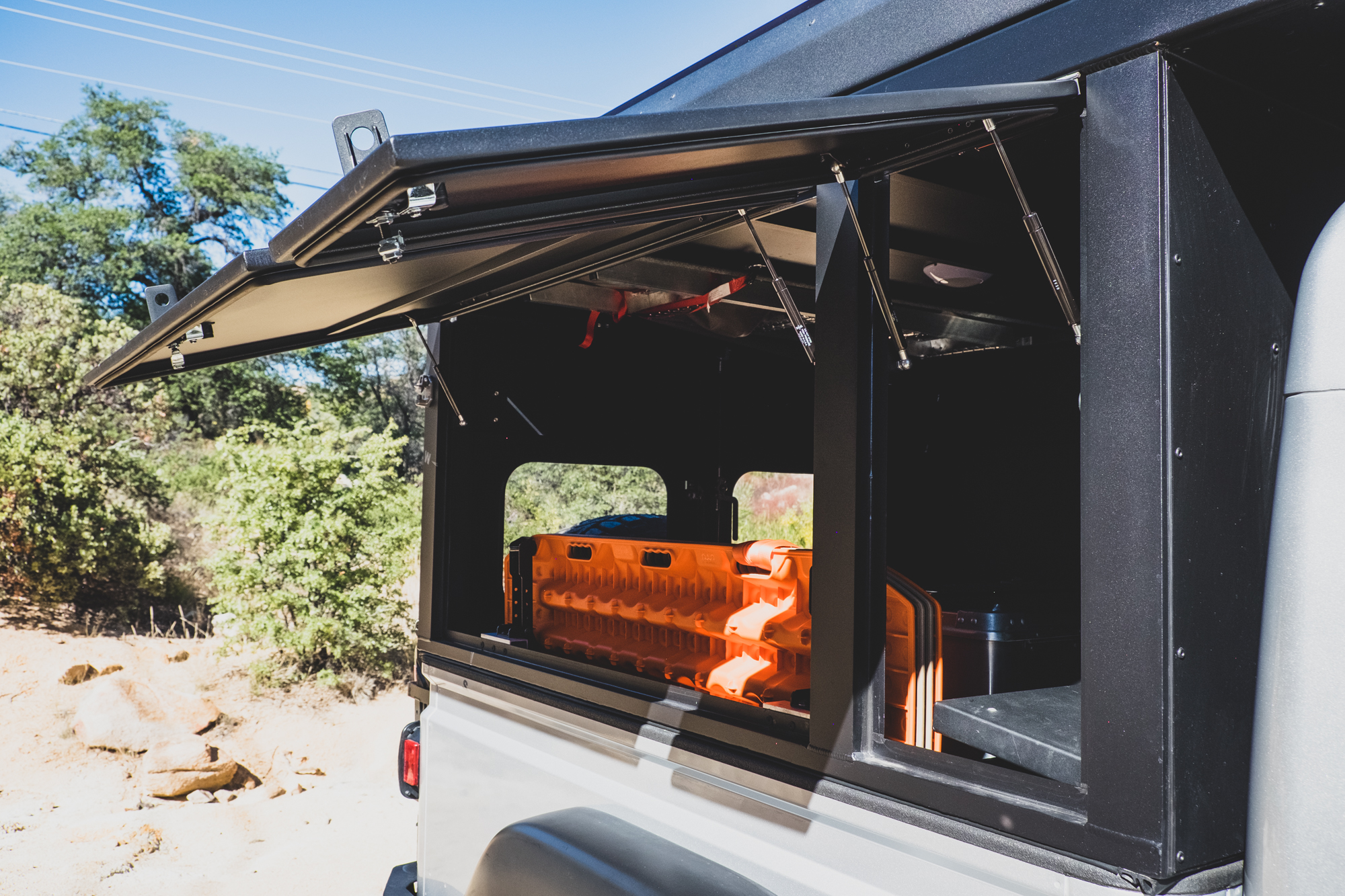

Pete wanted to use his Brute for remote camping adventures, so he began researching pop-top campers that could be custom fit to the Brute bed. He finally settled on the Snap Outfitters Treehouse shell and wedge camper, as they agreed to size it to the Brute at no additional cost. Pete and I deployed the tent on one of our local trails, and I was impressed with how quickly it set up, and the overall quality of the unit.

Cummins R2.8 diesel
Axis diesel conversion adapters and install

Toyo 35-inch X12.50X17 tires

Snap Outfitters wedge-top camper
