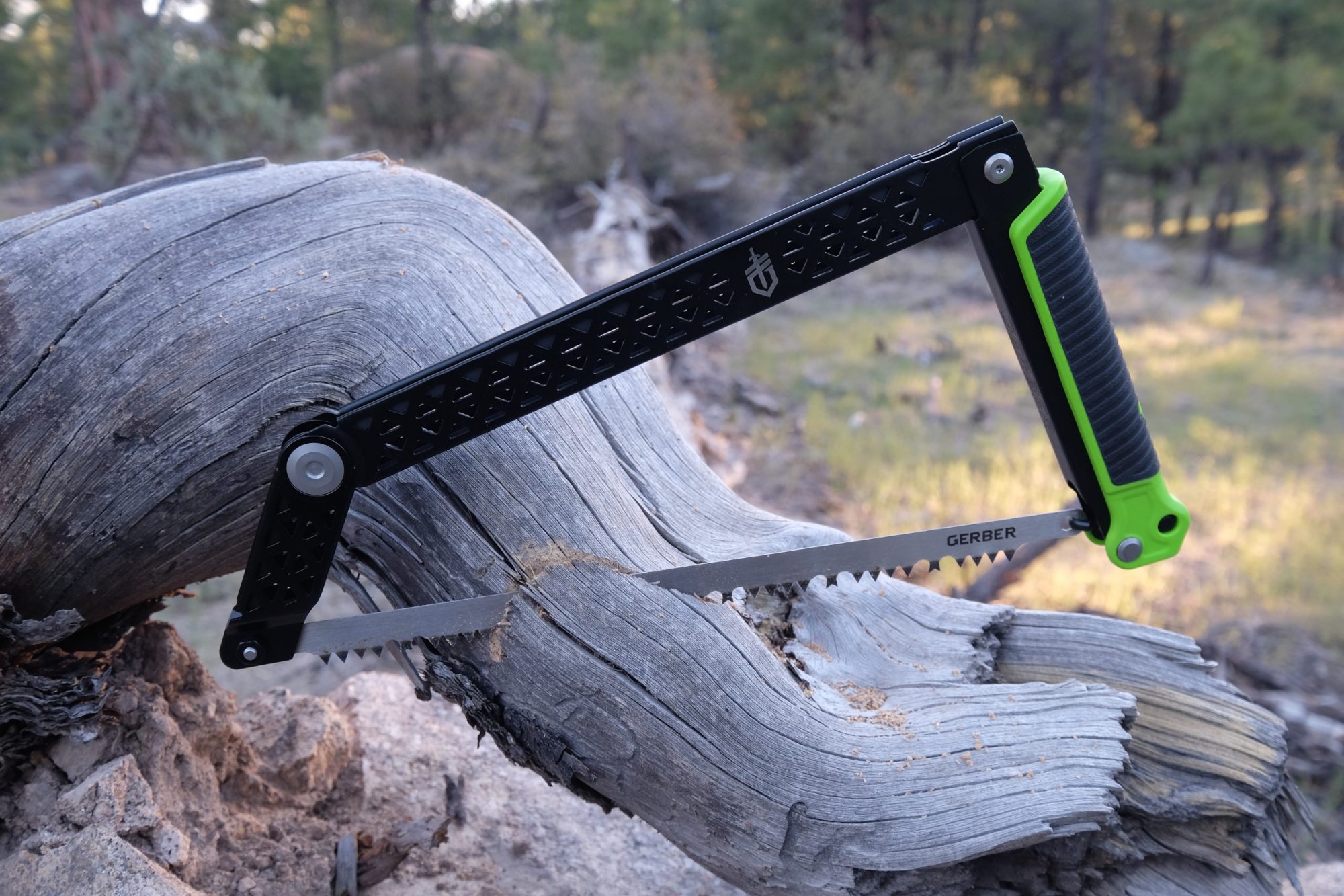

Gerber Freescape Camp Saw, $60 (Editor’s Choice)
A black and green folding saw with a serrated blade, perfect for overlanding, is partially unfolded and resting on a thick, weathered tree branch in an outdoor, wooded setting.
If you noticed, we have a tie for my top pick. The Freescape was the last saw I tested in this shootout and prior to unboxing it, I had already tapped the BIGBOY as my favorite. File that under poor journalism. After a few days with the Freescape, I knew it was equally good as the Silky, but for different reasons.
Unlike the Trailblazer which requires the assembly of multiple loose components, the Freescape employs a smart design built around four robust pivots which keep all of the pieces connected. There’s nothing to misplace or drop in the weeds and setting up the saw is a two-step process completed in under five seconds. Simply unfold the handle and frame, connect the 12-inch blade, and snap the rubberized handle forward to lock everything in place.
A folding saw with a black blade and green handle rests on a weathered, curved log in an outdoor forest setting, ready for any overlanding adventure.
The shape of the frame assembly allows for optimal cutting potential and can easily tackle logs with a 6-inch diameter. You do have to mind your knuckles when working on those larger chunks of wood, but this is a very small and compact saw with big cutting chops. At $60 it’s a great value and perfectly sized to slide into a backpack or under a truck seat.
