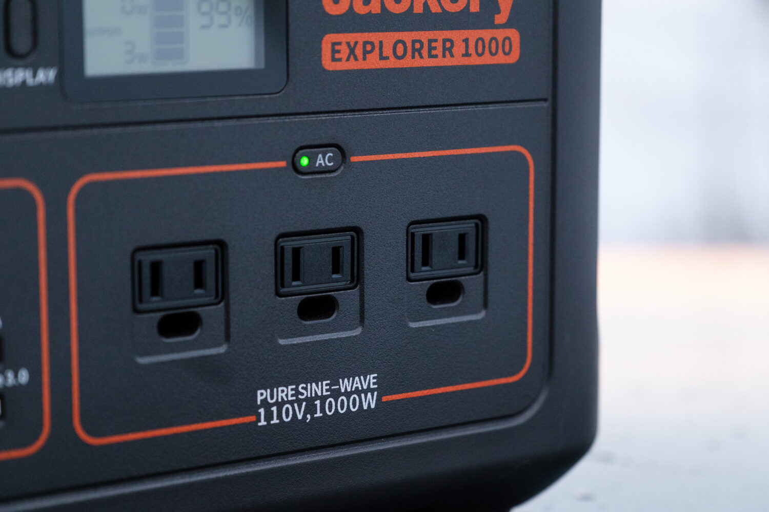

Ironically, the power pack’s greatest strength is also its greatest weakness. Because the entire idea behind the product is to avoid the complexities and risk of wiring things yourself, manufacturers didn’t spend much time addressing the needs of the DIYer. Instead, they tailored their products specifically to charging individual devices through standard 12-volt and 110-volt outlets and set the amp ratings just high enough for each port’s intended use. That way, even if you took the time to cut apart their cables and splice in a fuse block, a fridge would occupy 90 percent of the outlet’s amp-rating, preventing it from running lights or a water pump at the same time. This severely limited their use as dual-battery systems in campers. But recently Anderson connections have appeared on the scene, allowing customers to build outside of their manufacturer’s limited ecosystem and greatly improve performance.
portable power jackery outlets 2
Jackery’s 1000, for example, now features a 12- to 30-volt (163 watts max) Anderson input, which allows customers to charge from a wide array of sources. We’ve seen someone wire this connection to a switch so that whenever their vehicle is driving, the Jackery charges from the alternator, but when the motor is off, it charges from hard-mounted solar panels on the roof. This keeps their Jackery topped up in almost all scenarios. Sadly, the Jackery is still limited to a max output of 10 amps from a 12-volt outlet, though, which means running a camper system isn’t really viable. Goal Zero, on the other hand, may have finally cracked the code.
Their Yeti 1500x offers a 50-amp (600-watt max) Anderson input AND a 12-volt Anderson output offering up to 30 amps of beautiful all-purpose power. That means it’s finally possible to connect an Anderson cable from this power pack to a fuse block in order to run a fridge, water pump, and lights inside your overland rig or van. Simplicity, meet versatility.
