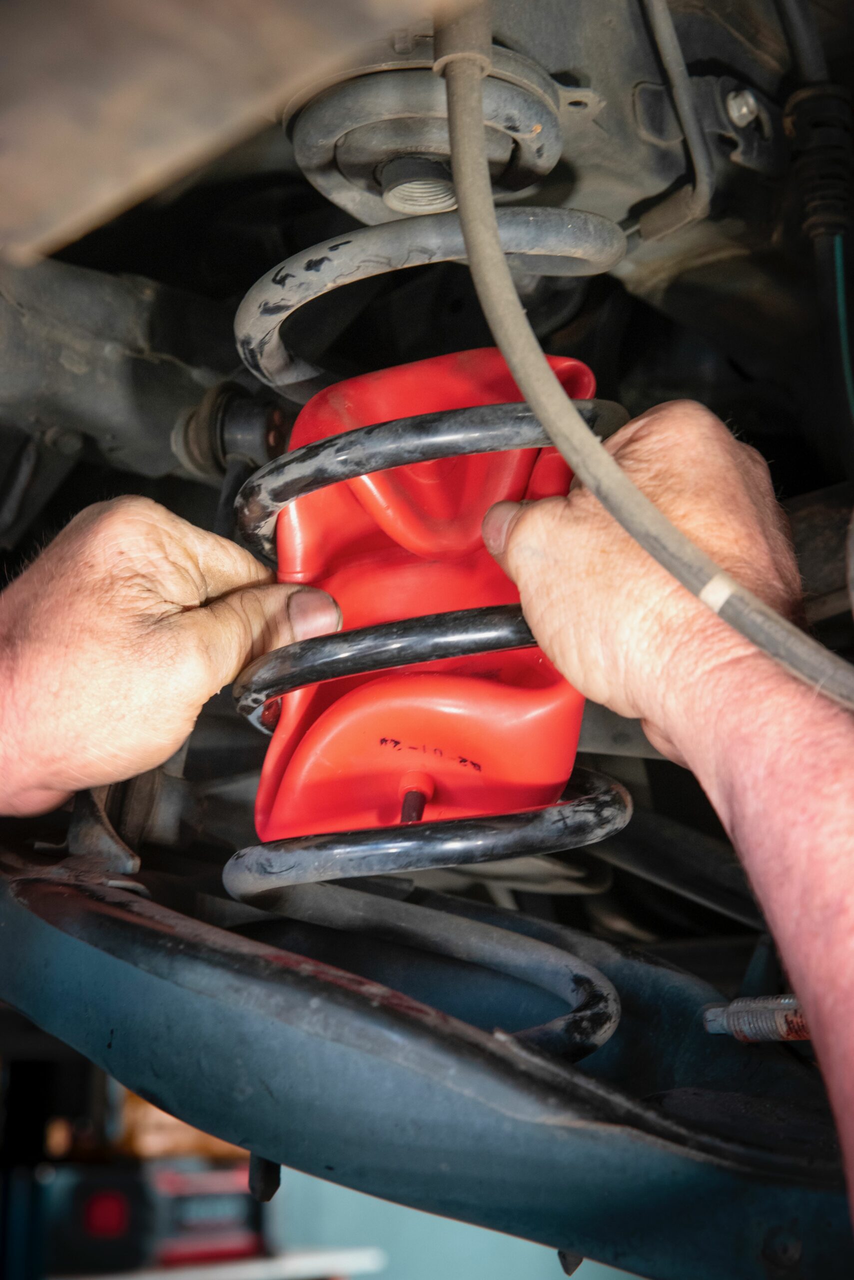

Installing air-helper springs inside the rear coil springs of today’s CUVs and SUVs is a relatively simple process most DIYers can handle at home when using a hoist or an appropriate floor jack and properly placed jack stands. The rear coil springs are extended as far as possible, and the air bladders are stuffed inside the coils.
The remainder of the install entails routing the plastic air lines from the bladders in the coil springs to a single inflation valve mounted close to the trailer hitch or on the bumper. The whole job can be done in less than two hours using the most basic hand tools.

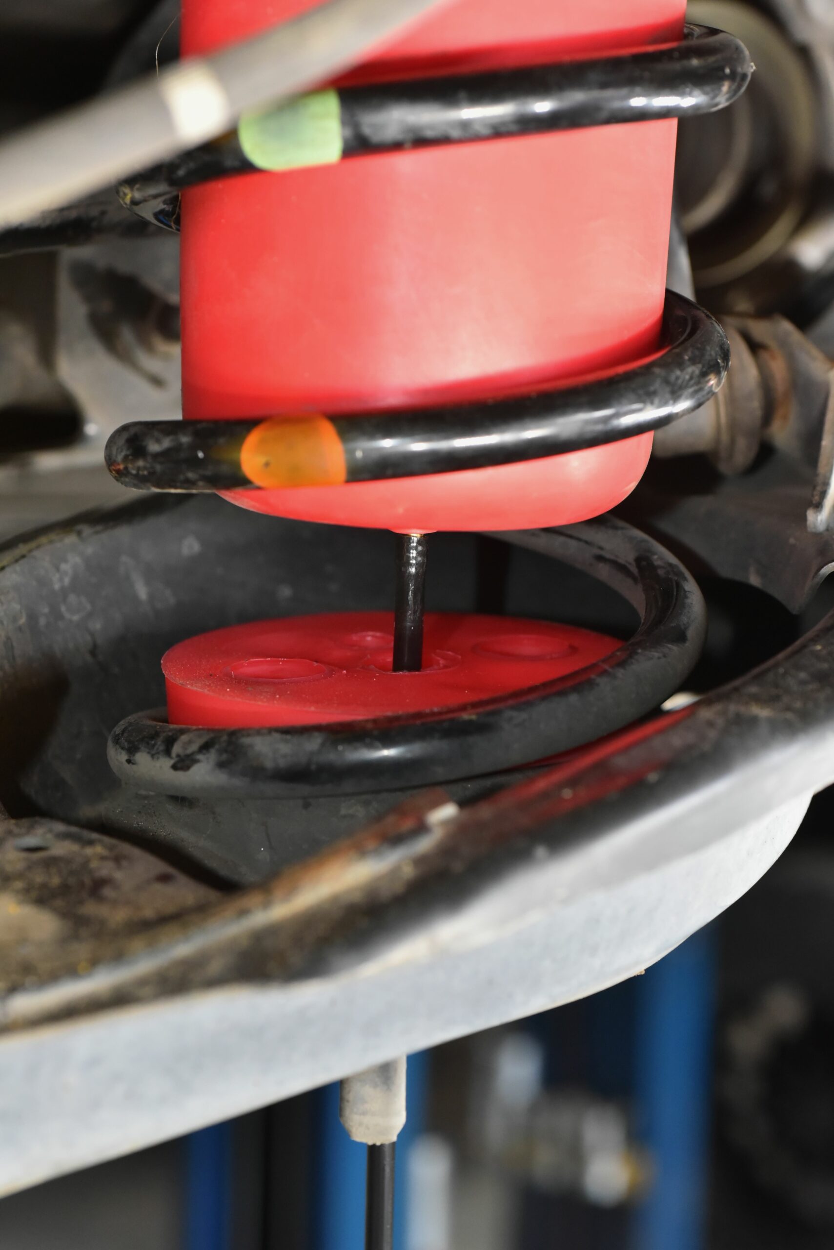

- The best way to install the air bags is to suck the air out of the polyurethane bladders and fold them up like hot dog buns before inserting them into the coil springs. Tying a heavy twine around the end opposite the air inlet helps pull the bags upward into the coil springs.
- These particular bags can be installed with the air inlet up or down, whichever position provides the best way to run the air lines out of the coils so they aren’t snaking around sharp edges or making sharp bends. We mounted the Mazda CX-5 air-helper springs with the air line exiting the bottom of the CX-5’s lower control arm.
