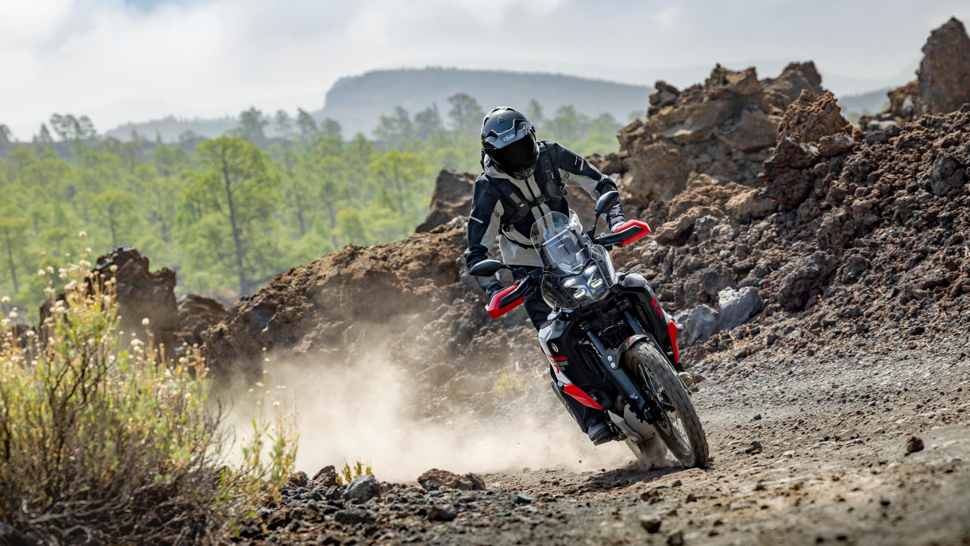

T7 aficionados rejoice! Yamaha has announced that the World Raid edition of their popular Ténéré 700 adventure bike will, be coming to the US. This longer-range, electronically tricked out Ténéré should be on your dealer’s floor in May, 2026. The base model T7 will also be available, but the 700 Rally version appears to be a Euro-only bike–for now, anyway.

This is an area where the US 2025 T7 has caught up with its Euro counterparts. Of course, the World Raid still goes beyond. The centerpiece is a full-color, 6.3-inch TFT display with three “themes” entitled Street, Explorer, and Raid. Each gives a different view of the bike’s status.
