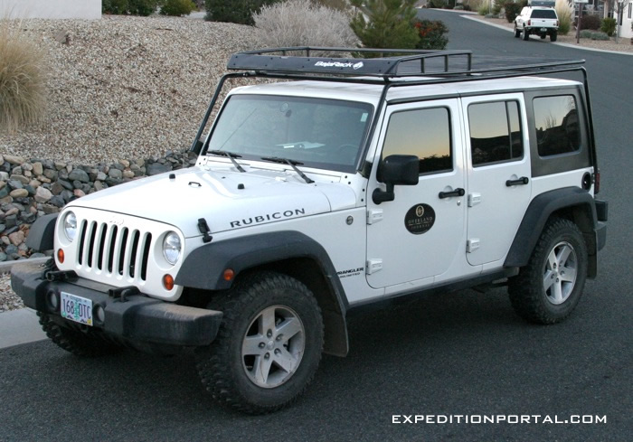

Expedition Portal had the opportunity to install the very first prototype JK Wrangler rack from BajaRack. We fitted the rack to a 2009 Jeep Wrangler Unlimited Rubicon, which immediately after the rack was installed, the Jeep crossed the border into Mexico for Guatemala. This wrangler is part of our team for the Ends of the Earth Expedition.

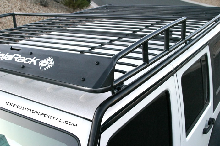

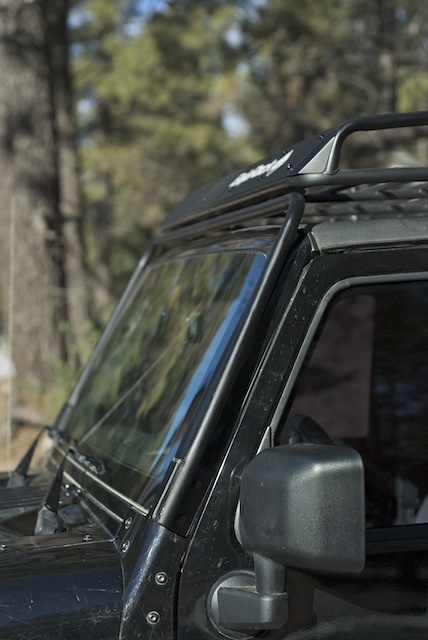

The Rack is comprised of two parts. The JK mounting system, which secures at the A pillar, using factory bolts in the windscreen hinge. The attachment is 1/4″ steel plate, to which the 1 3/4″ steel tube is welded. This tube is then bent at the top of the windscreen, where it then runs along to top (hard or soft), before again bending and turning downward to the rear mount, just next to the rear turn indicator assembly. Both the driver and passenger side main support units are constructed the same. To ensure pitch rigidity and to strengthen the overall assembly, there are four crossmembers. Each crossmember mates to a plate on the main hoops and secures with two 5/16″ bolts per side. These crossmembers serve as the mounting point for the next part of the package, the expedition rack.
baja rack front mount

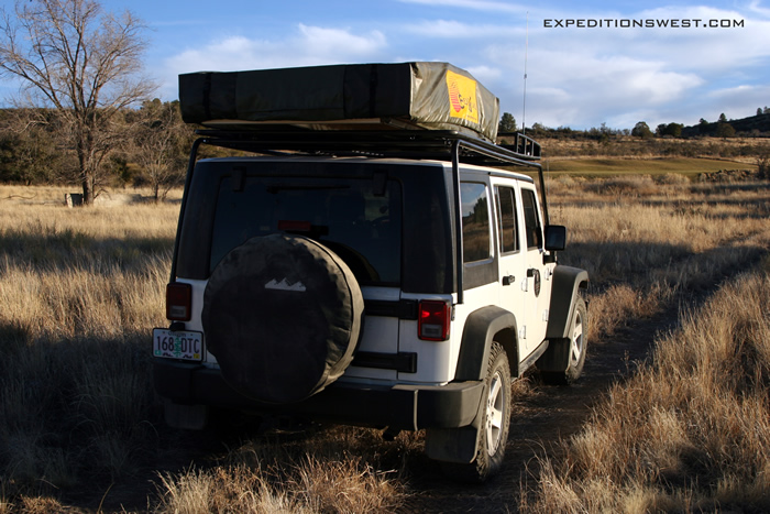

The JK Baja Rack kit is available with either a full-length rack, complete with 4″ side rails, or with a slick expedition rack, which is designed to mount an Eezi-Awn tent or similar. The 94″ roof line of the Unlimited Wrangler allows for a small basket in the front for storing a few Pelican cases, etc. and still mount up to a 1600mm tent. We actually mounted an 1800 tent, though it does stick out past the rear roofline by a few inches.
A white Wrangler JK with a roof tent and Expedition Rack is parked on a grassy trail. The rear tire is covered, and the dry landscape features scattered trees and hills in the background.
This unit is a prototype, so a bit early to comment on overall quality, fitment and durability, but I can attest to the clever design and ease of installation. I expect several refinements will be present in the production models. This unit is very light weight, and will most likely be a great value too.

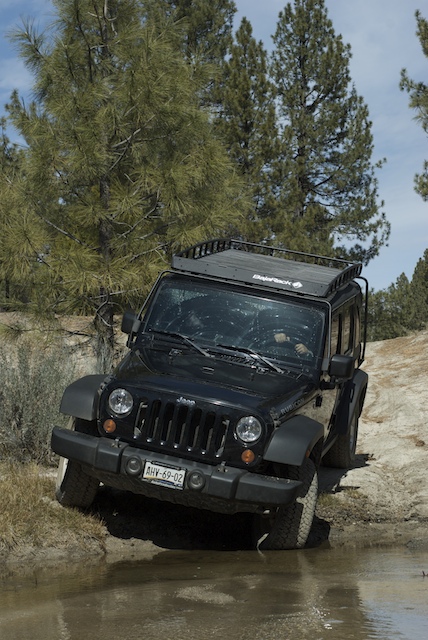

The prototype rack lasted throughout Central America, including some serious trails and jungle tracks.
A black Wrangler JK with a BajaRack Expedition Rack is off-roading, tilted to one side as it drives down a rocky slope toward a muddy puddle, surrounded by pine trees and brush.

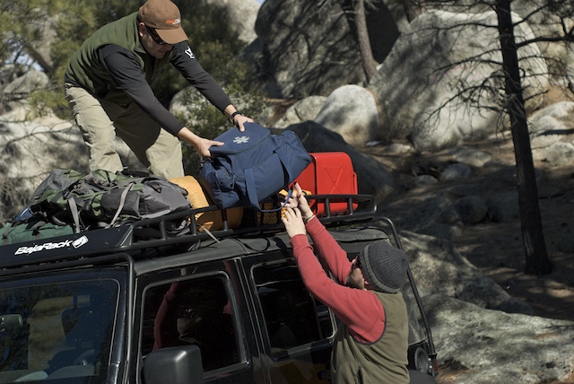

Two people load a blue backpack onto the BajaRack Expedition Rack of a black Wrangler JK in a rocky, forested outdoor setting. One stands on the vehicle while the other hands up the bag.
Close-up of the driver’s side of a black Wrangler JK with a BajaRack Expedition Rack, parked outdoors near trees. The image focuses on the side mirror, windshield, and rugged roof accessories.

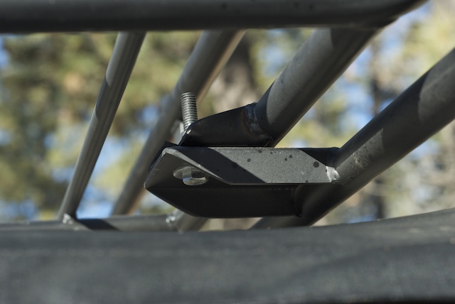

Close-up of a metal bracket with a bolt and screw, attaching two metal bars on a BajaRack Expedition Rack for a Wrangler JK, with a blurred background of trees.
