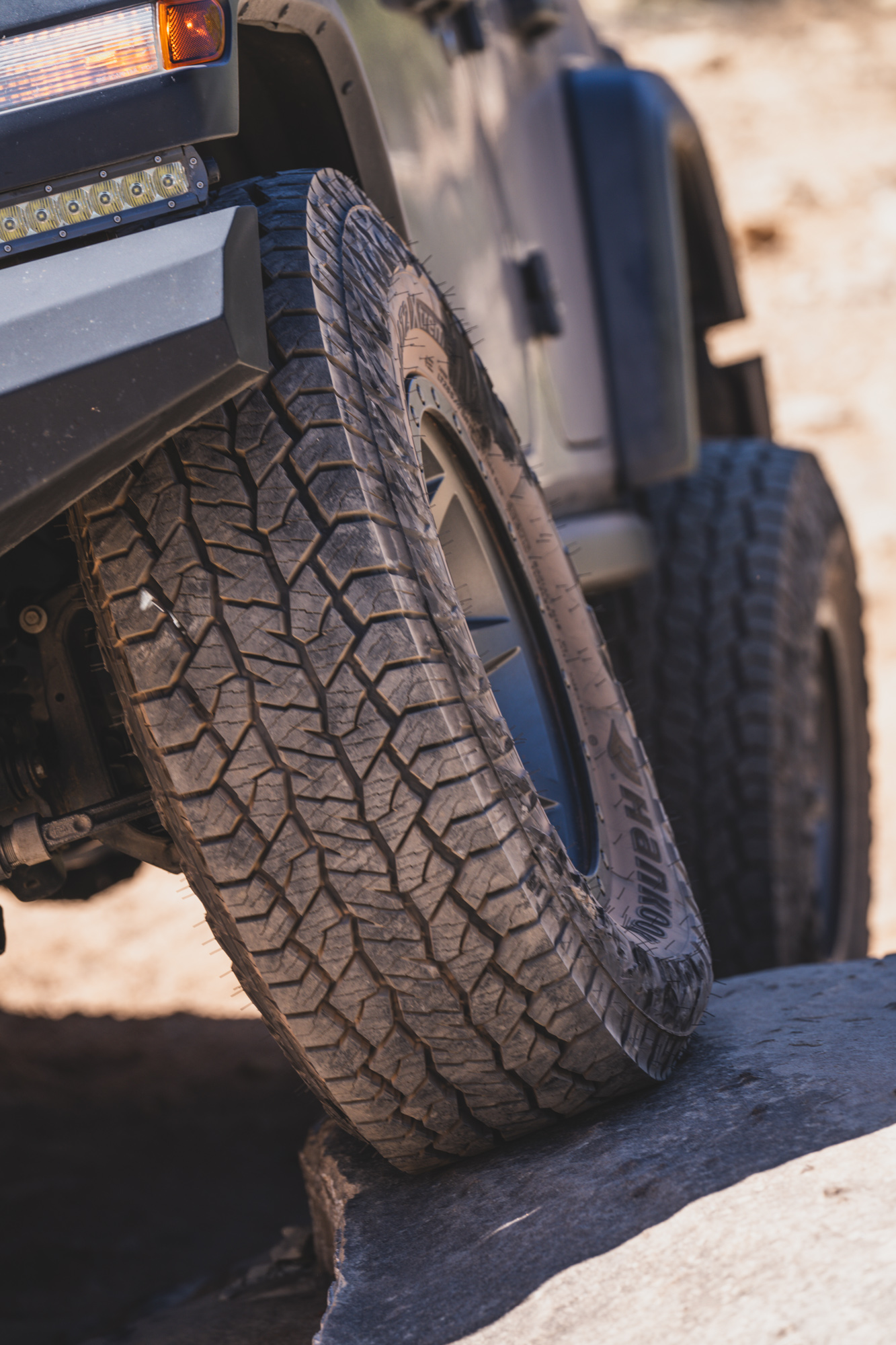

  1. Select a tire that favors being taller than wider. This means choosing a tire with a 70-80% aspect ratio for a 17 inch rim (75-85% for a 16″ wheel). A narrower tire reduces rolling and wind resistance and the taller aspect ratio improves ground clearance.
  2. Select a slightly more open lug pattern to improve mud evacuation and stone ejection.
  3. A chamfered profile will improve lug integrity and also reduce stone/mud retention.
  4. Select an all-terrain with a light truck rating (LT) and two or three sidewall plies for durability. Ensure the load rating matches your GVWR.
  5. Find an all-terrain with a three-peak mountain-snowflake rating for winter conditions. This will also improve wet pavement-stopping performance.
  6. Avoid focusing only on tread life, as the longest-lived ATs will have a much harder rubber compound and less adhesion on pavement and dry rock.
  7. Staged and sound-tuned lug profiles significantly reduce noise and fatigue for long trips.
  8. Look for all-terrains with shoulder lugs to help improve side lug integrity and increase traction in mud and ruts.
  9. All-terrain tires are more likely to pack with mud and clay.

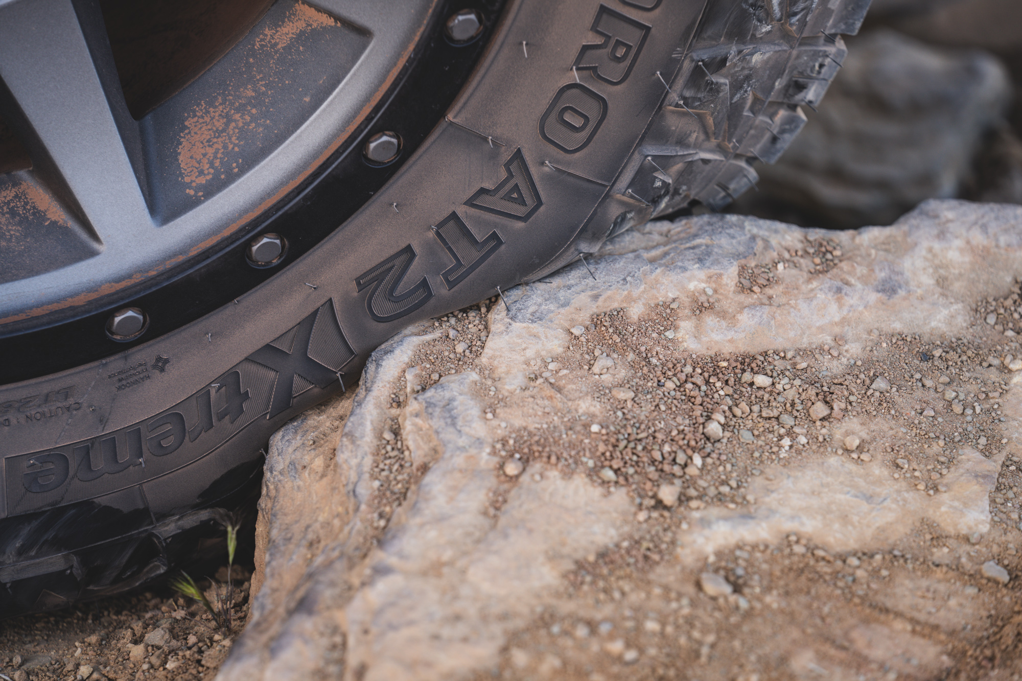

All-terrain tires have reduced mechanical keying on rocks when compared with a mud tire.
Airing down is even more important for all-terrains on the rocks, as they have reduced mechanical lug keying than a mud tire. Airing down allows the carcass to deform around the rock significantly improving leverage and adhesion.
A strong sidewall makes all the difference in technical terrain, reducing the likelihood of punctures.

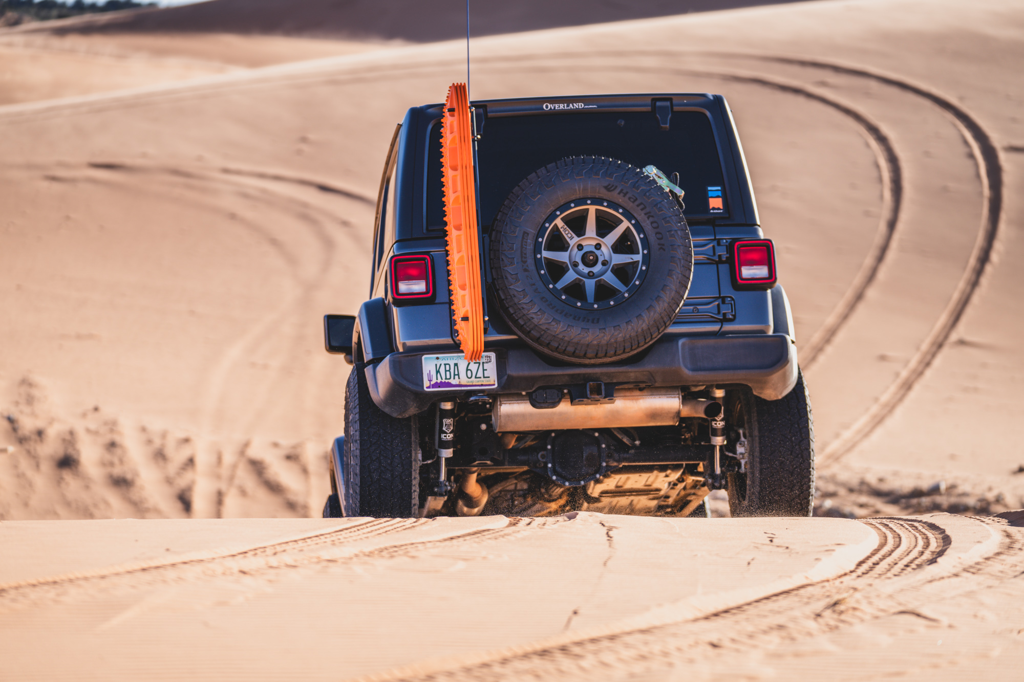

In the dunes, an all-terrain makes for an excellent choice, maximizing flotation and reducing the likelihood that the tire will dig into the silica. Start by airing down to a PSI equal to the rim diameter or half of the manufacturers recommended tire pressure (whichever is greater). Use that as a baseline and reduce pressures more until flotation and performance match the conditions. Use extreme caution once pressure are half of the rim diameter, as losing a tire bead is likely during heavy steering inputs.
