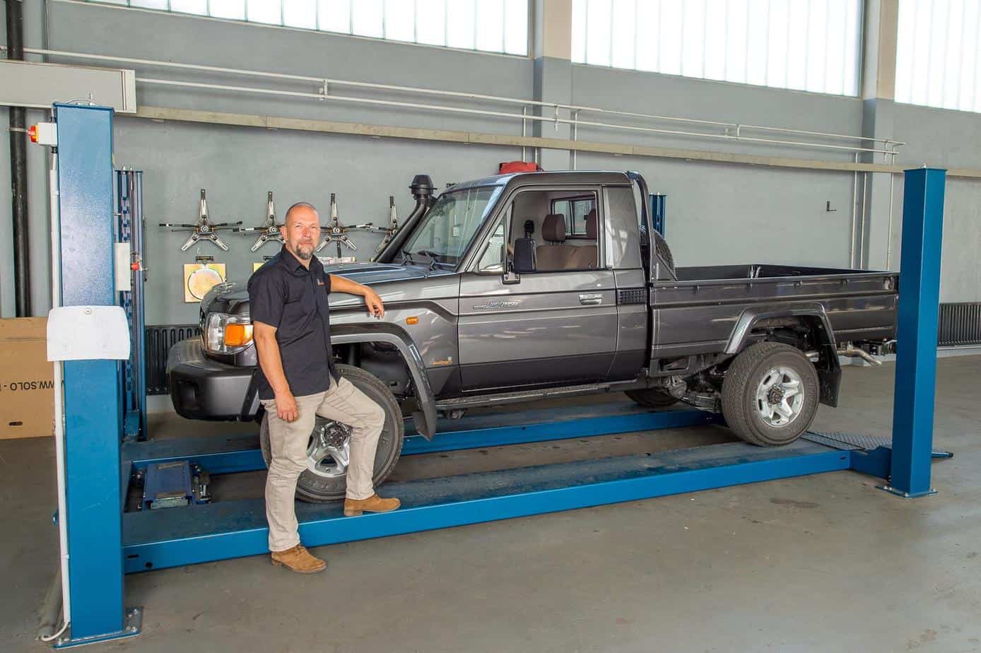

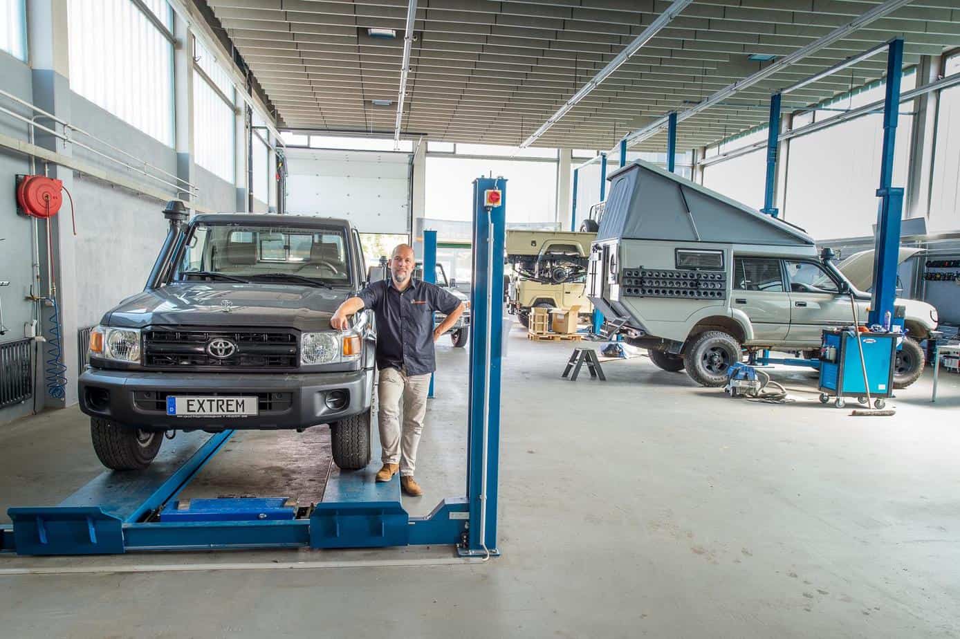

Thomas Lermer, the owner of EXTREM Fahrzeuge GmbH, welcomes us with a wide grin to his workshop and the introduction of a very special Land Cruiser. Known mostly for his EURO4 and EURO5 conversions for the Land Cruiser which he´s developed in house, he´s now taken a leap into the future. “Everybody talks about clean energy and e-mobility, and as we were looking into developing a EURO6 conversion for the Land Cruiser”, Thomas Lermer explains, “we also looked further and wondered if it would be possible to convert a Land Cruiser to full electric drive”. “This was about the same time when we were approached by a customer with the request for an all-electric off-road vehicle for a game farm in southern Africa. His requirements were 40-60bhp and a range of 60-100km on a full charge.”

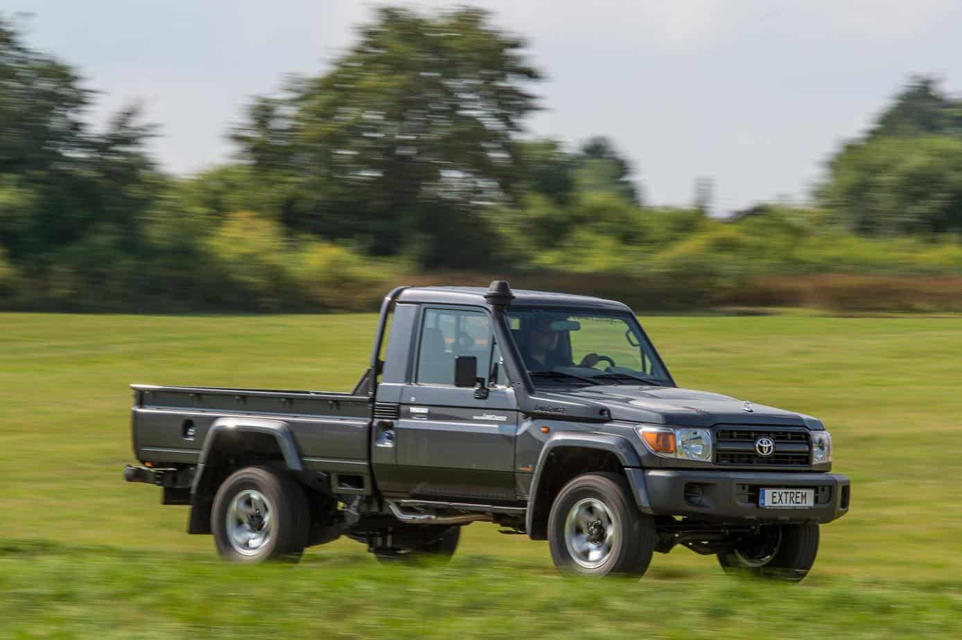

And this is just what we are looking at as Thomas Lermer leads us into the workshop: The Toyota EJ79.
20150622_RK_01503_edit5000 (Copy)
From the outside it´s a standard Bushtaxi and the only clue visible is the electric plug where usually the fuel tank cover would have been.

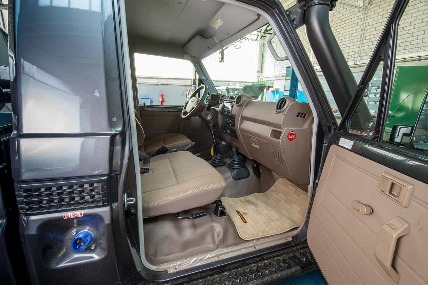

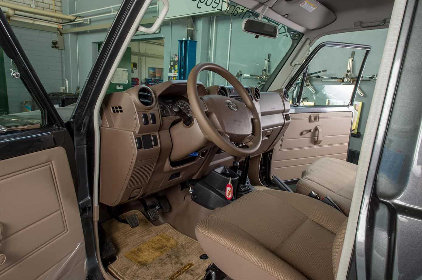

On the inside there are no surprises either, just pure Land Cruiser simplicity.

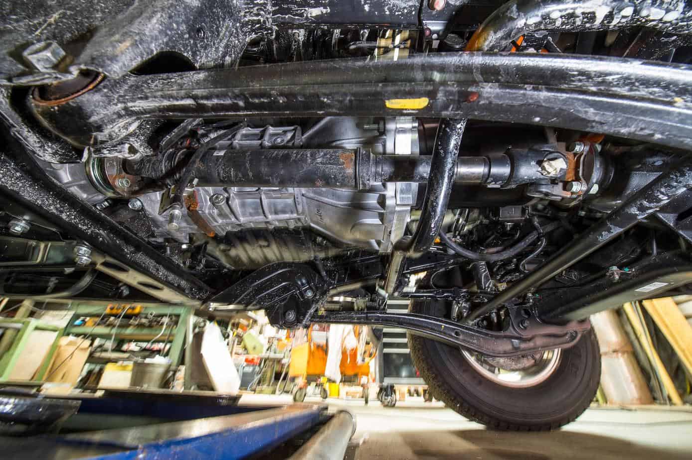

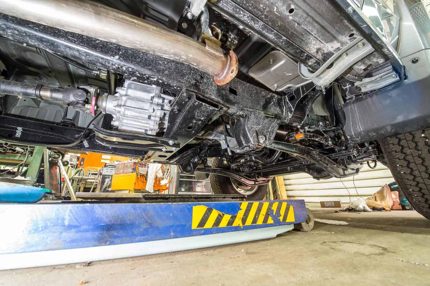

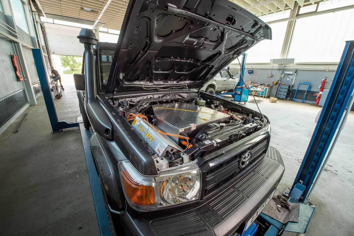

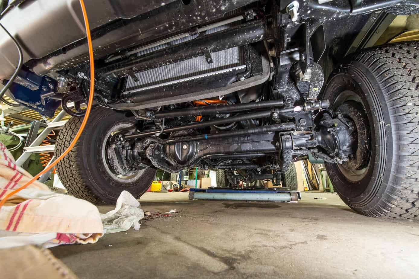

As the electric motor is directly connected to the manual gearbox by an adapter flange you engage and shift using the clutch and drive it just like any other combustion powered car. 45bhp move the Land Cruiser forward and acceleration is nothing to be expected from this power output as it feels more like driving an old Land Rover Series 1. The top speed of this very first prototype is somewhere between 90 and 100km/h depending on the wind´s direction 😉 After a few miles through the villages surrounding the workshop we take the EJ79 offroad and are surprised by the agility of the electric drive.

Okay, it could do with a few more ponies and it takes a little while for me to get used to the moment the electric motor kicks in when parked uphill, but Thomas explains that “there are two further vehicles being built with stronger engines and a bigger range of operation as these vehicles will receive 2 battery packs, thus giving them a top speed of 120-140km/h and a range of approx. 200km with about 80bhp from the motor.”

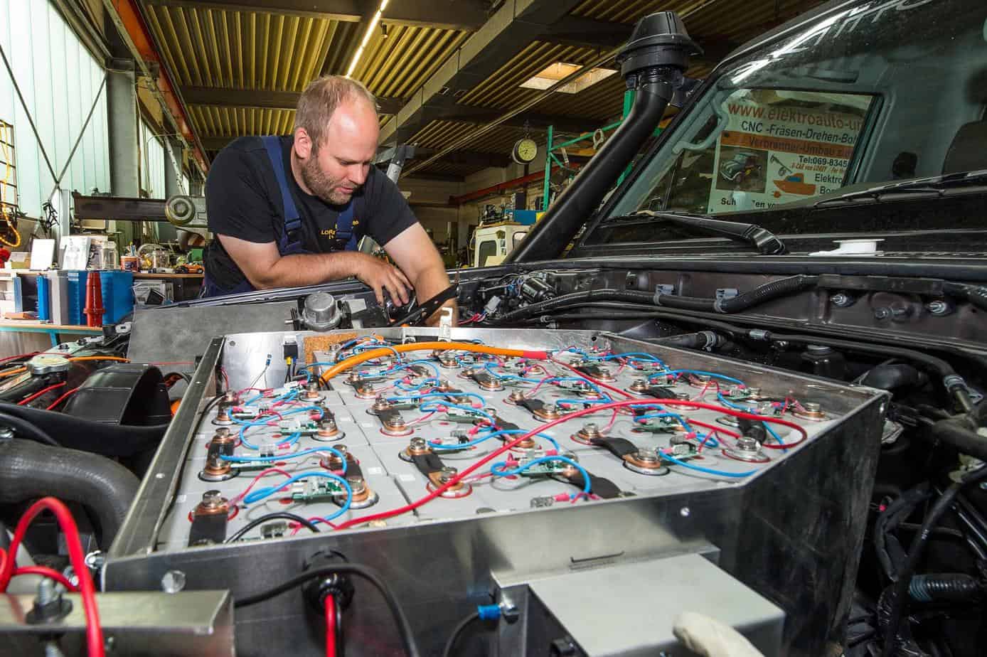

“It doesn’t really, as the customer defines the grade of sealing for all electric components depending on his requirements” explains Thomas Lermer “this prototype, being built for a rather dry environment in Africa doesn’t offer great wading capabilities, but the electric motor and the battery pack(s) can be sealed to IP76 which leaves the question to how long can the passengers breath in the cabin when fully submerged!”

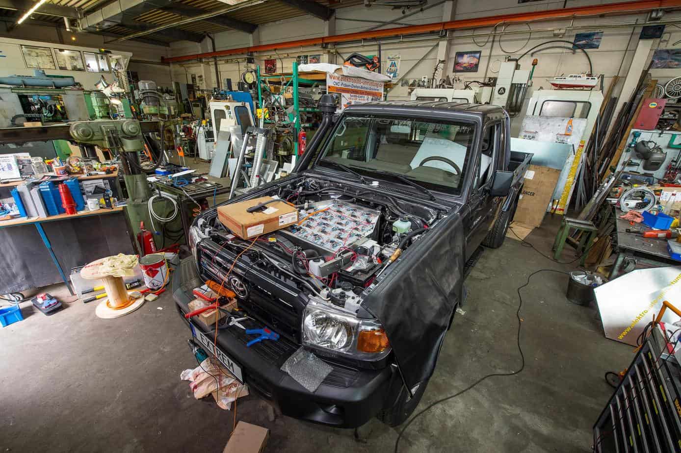

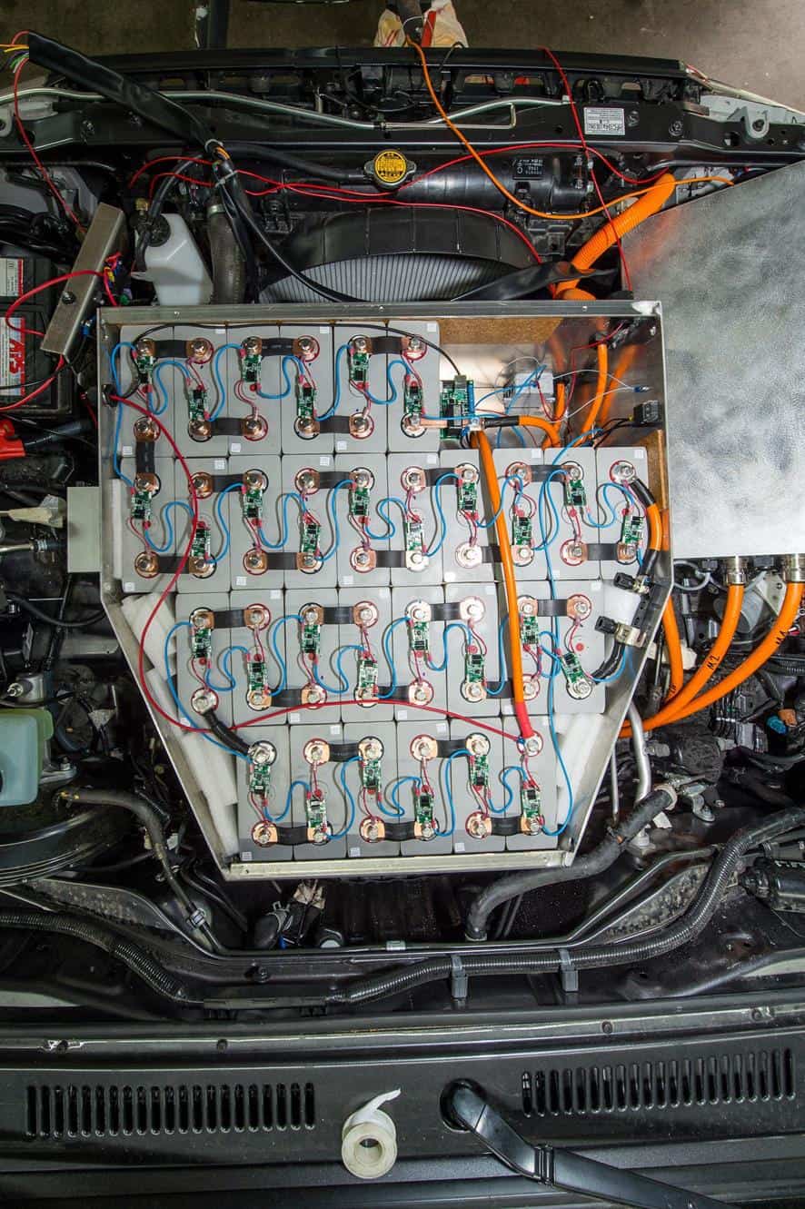

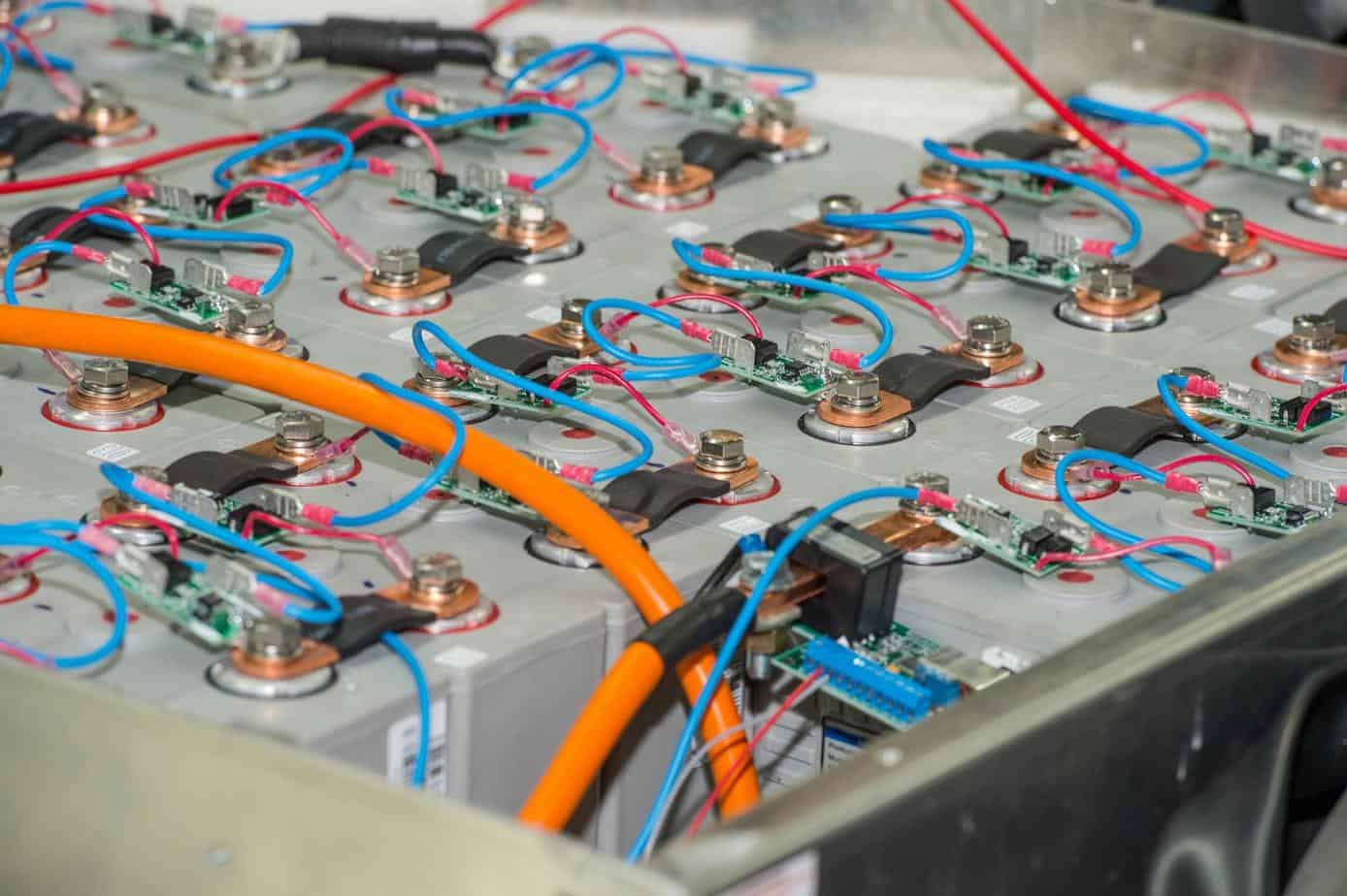

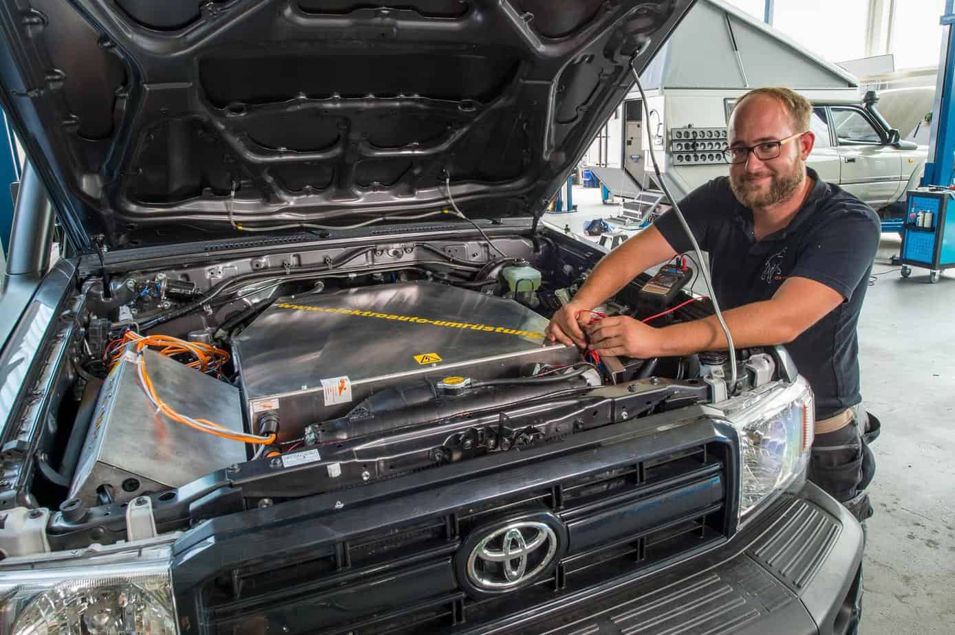

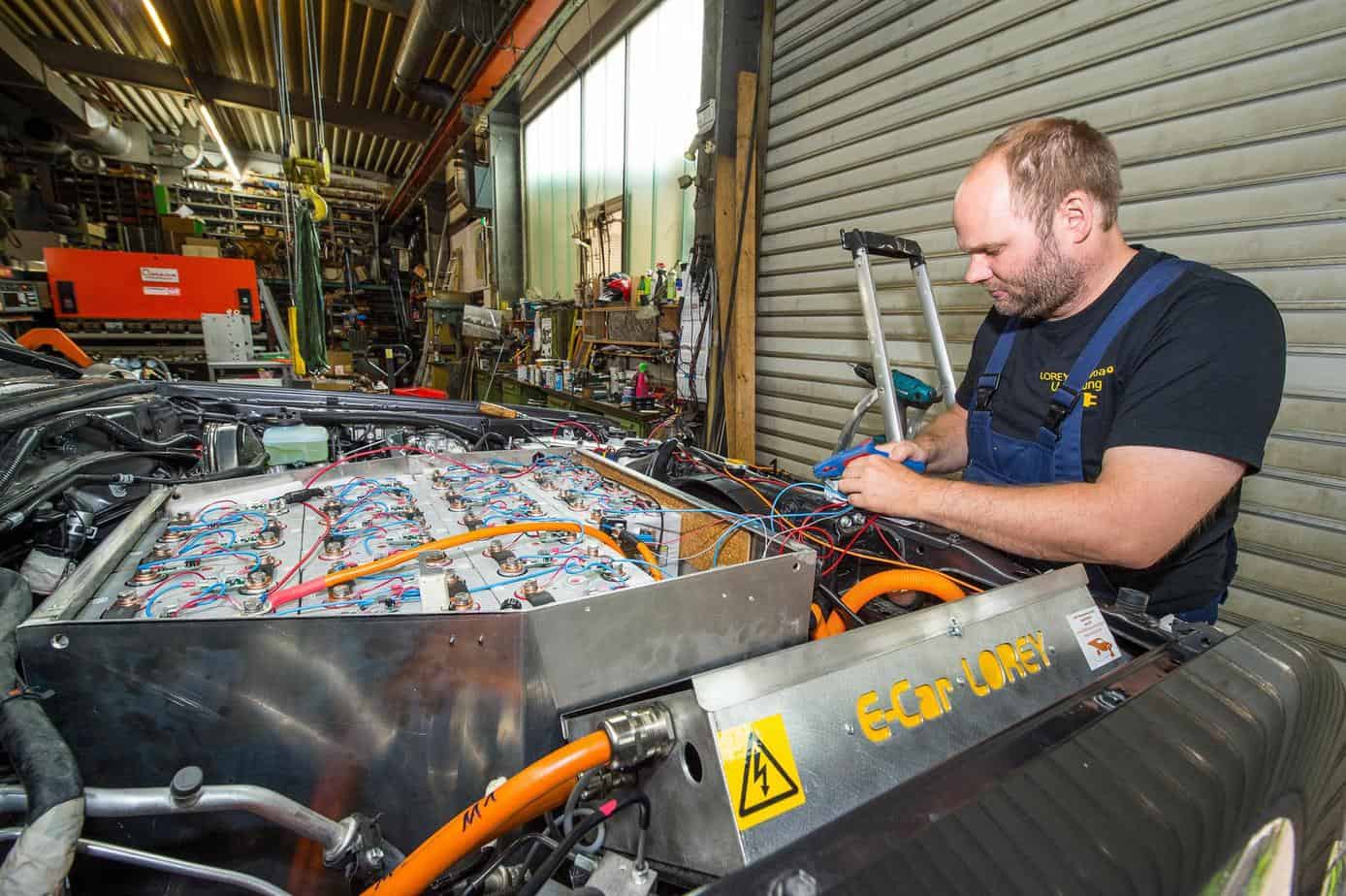

Back at the workshop and a very comfortable drive through the northen parts of the Black Forrest the EJ79 is plugged back into wall socket and recharged. A full regular charge takes about 8hrs per battery pack and 2-2.5hrs on fast charge. For the next two vehicles being built for the mining operation there will be 2 chargers fitted, thus allowing the personnel to charge both battery packs fitted in these trucks simultaneously.

With all this said, does this electric conversion make sense for overlanding? “It actually does,” replies Thomas Lermer, as we can easily fit 3 battery packs into the Pickup and depending on the batteries used we can thus store enough electric power for a range of 350-500km. Charging can be done while driving through Solar Panels or when stationed.”

“Another option would be fitting a range-extender” notes Robert “and here one can either use a multi-fuel combustion engine to power a generator or even hydrogen. Unfortunately hydrogen units are still to big for cars, as they still weigh above 120kg and are pretty bulky. So the former, a multi-fuel engine combined with a generator, could extend the range of the EJ79 considerably, e.g. 30 liters of diesel would produce enough electricity for approx. 800-1000km of electric drive”
