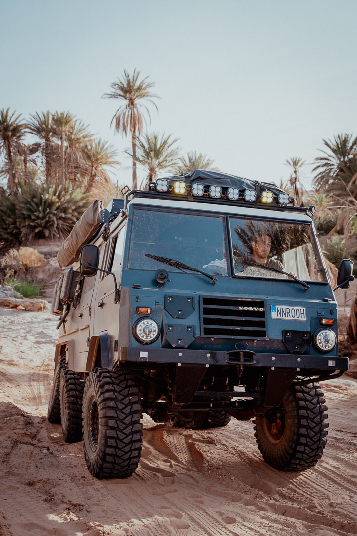

There’s nothing subtle about the Volvo C304 6×6. Boxy, with clearance for days, and big, square front windows, the vehicle champions Volvo’s design philosophy of clean lines and minimalist aesthetics. Produced between 1974 and 1984, the ex-military truck sports a classic ladder frame, portal axles with leaf springs, a 3-liter, 6-cylinder petrol engine, and a 5-speed manual transmission. What Chris Beight saw in the C304, however, was a platform built for the roughest terrain imaginable, with the ability to transport troops safely out of war. “I feel like that makes it the perfect vehicle to get me and my family to the ends of the Earth and back again. There’s something about

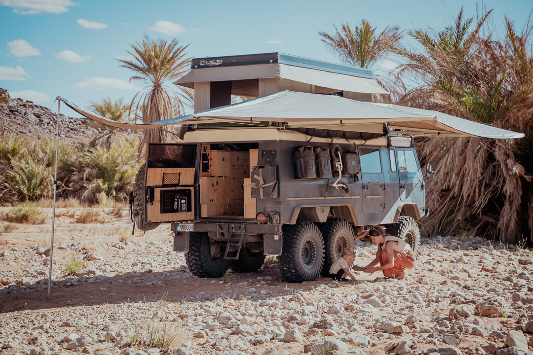

Measuring 1.9 meters wide by 2.55 meters high, the Volvo was the perfect size for a family of three. There was room for a large kitchen, and a pop-top conversion would create ample standing space and fit a spacious bed. The C304 is also known for its off-road capability. “We’re really big on not only overlanding, but finding amazing wild camping spots,” Chris says. “That’s what makes us tick. We really want to go where most overlanders wouldn’t risk their vehicle.” In addition, they hoped a fresh set of 37-inch Maxxis Trepador tires, along with new shocks and springs, would enhance the truck’s ability to crawl up and down nearly anything.

Most vintage Volvo C304 trucks were constructed from steel, making them prone to rust. Fortunately, Björn tracked down the rarer version of the C304 for Chris and Ange, which features a zinc-coated steel body, meaning less work for the couple in the long run. But once they arrived in Sweden, Chris realized the truck was in much worse condition than he had anticipated. Discharged by the army between 10 and 15 years ago, it sat in a barn, left to rot. “I was like, how hard could it be? It turned out I needed to rebuild the entire braking system, and with all the axles, there was just so much more work than I anticipated.”

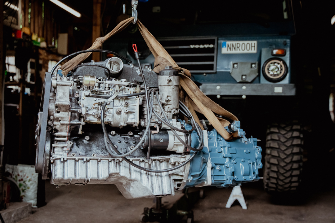

Then there was the state of the engine. The tired, 3-liter, straight-six petrol engine just wasn’t up to the task of a fully loaded 4.1-ton truck. “At the end of the day, that engine was designed for a very small Volvo [passenger car],” he says. “To get the military contract, I think Volvo was like, look, we’ve got a ton of these motors. We’re cranking them out. Let’s put that motor in this truck, and we’ll make it work.” A turbo-diesel engine swap would extend their range, nearly halve their fuel consumption, and at least triple the power and torque, transforming the driving experience completely.

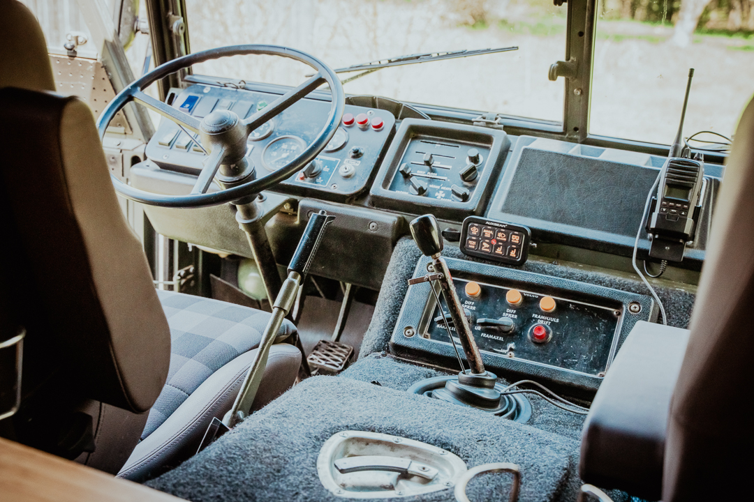

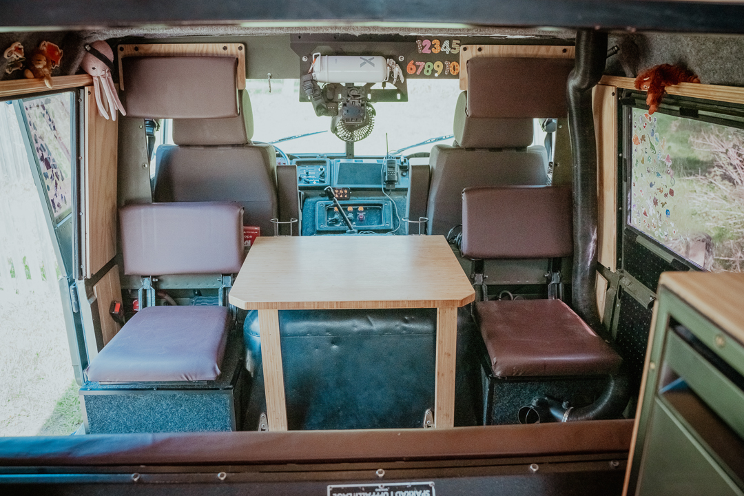

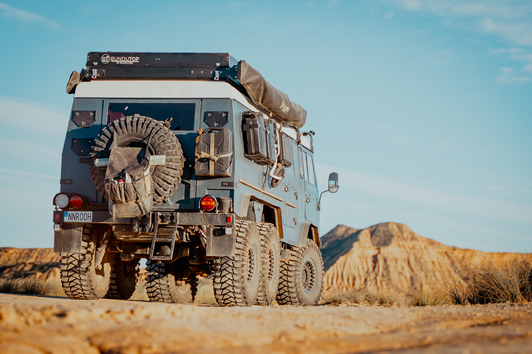

But first things first. The vintage truck required sound deadening and heat insulation to start, followed by the installation of Scheel-Mann Traveler LR seats for maximum comfort on long driving days. Perhaps the most impressive transformation, however, was a fresh coat of paint. Blue, akin to frigid Arctic Ocean water, replaced the army-issued camouflage, and the Volvo was officially christened “Skaði,” after the Norse goddess known for bowhunting, skiing, winter, and the mountains.

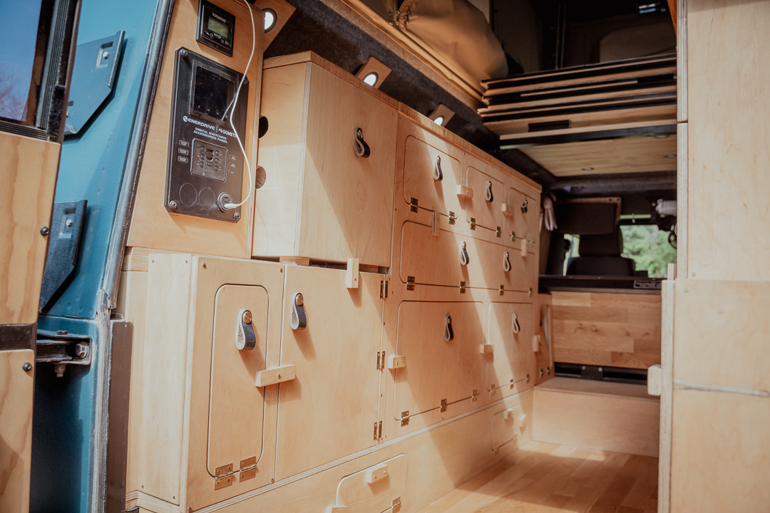

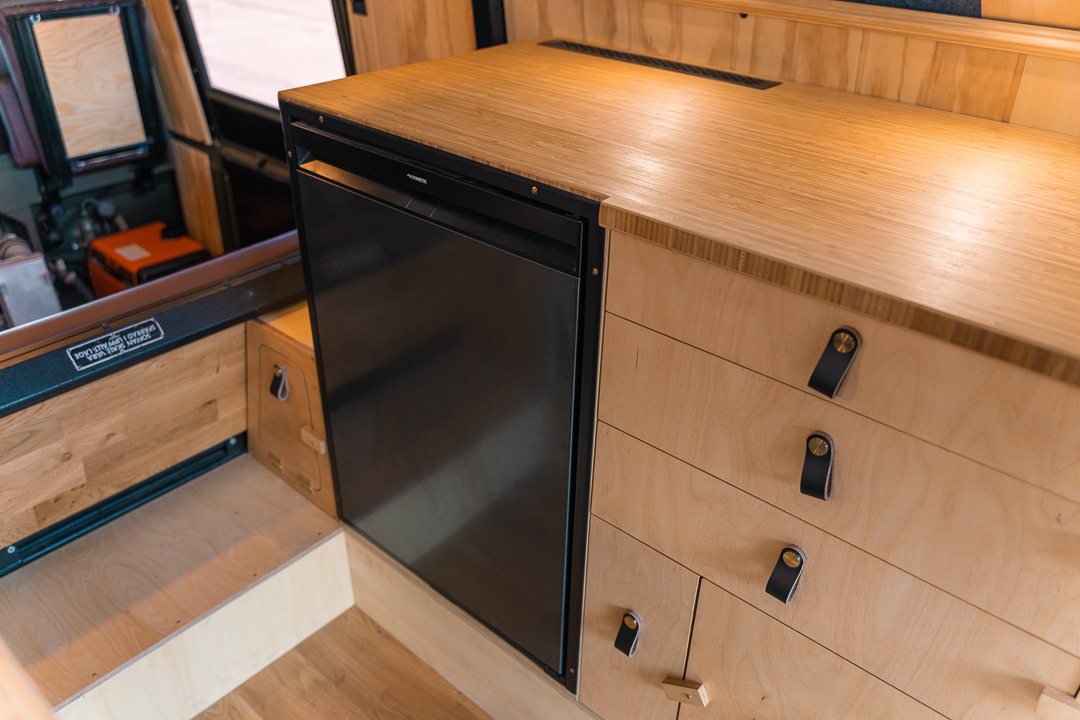

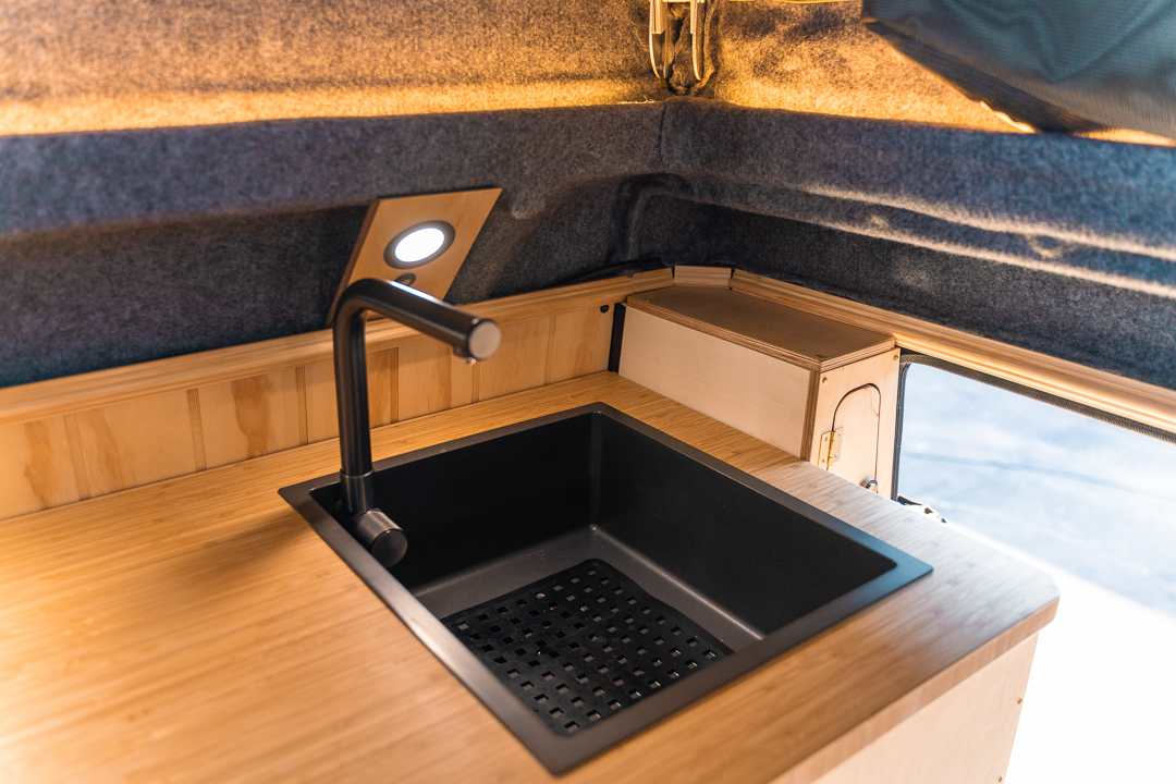

Chris cut the roof of the truck and installed a custom Bundutec BunduTop conversion to create standing room in the camper interior. The system is electric, raising and lowering the pop-top at the push of a button. This feature transforms the truck body into a spacious kitchen, complete with cabinetry, an induction cooktop, a Womo water filtration system, and a Dometic NRX 115C fridge. The couple also installed a wine rack, which, they admit, houses more almond milk than cheap bottles of Spanish wine. The whole shebang is powered by two 200-amp-hour lithium batteries, five 100-watt flexible solar panels, and a 2,600-watt Dometic Enerdrive inverter.

The B30 engine chugged along at 29 liters per 100 kilometers (or 8 mpg), requiring lead additive on every fill up, and about 3 liters of oil per driving day (150 to 200 kilometers)—on pavement. Reaching Morocco, the Volvo’s 80-liter fuel tank limited range during long distances between gas stations. “[Going to] Morocco was a big risk with the motor, because we knew it was really playing up,” Chris says, and admits the driving experience had become truly horrible. “I was doing the percentage game, like, what are the chances we’ll be able to do everything we want to in Morocco and get back to Europe? Worst-case scenario, it would have to be put on a truck and shipped somewhere. But we managed to do it and had a fantastic time.”
Back in Europe, staged up in Germany, Chris began the Mercedes OM605 2.5-liter turbo-diesel engine swap. Popular in the performance market due to its reliability and mechanical simplicity, the OM605 suited the Volvo build particularly due to its low-range torque, better fuel economy, and compact size to fit Skaði’s cramped engine bay. But as Chris dug into the Mercedes engine, with the help of his friend and fellow Volvo owner, Jan, they discovered it required a complete overhaul.
Taking the delay in stride, Chris and Jan got to work on the engine rebuild. Finally, the Mercedes whirred to life, and the swap could begin. Weeks later, they started Skaði’s new engine for the first time. “In a nutshell, it is freaking amazing,” Chris says. “This truck has gone from being a slug to a heck of a lot of fun.” The ultimate test for Skaði involved eight weeks in Iceland, where Chris, Ange, and Oakley explored stunning F-roads in the highlands and created a documentary for the 4×4 Adventure Film Invitational competition. They admit that although the engine is by no means perfect, it’s nearly there. Next, the family of three will head to Germany to tweak the OM605 before heading east through the Balkans to Turkey and Georgia.
