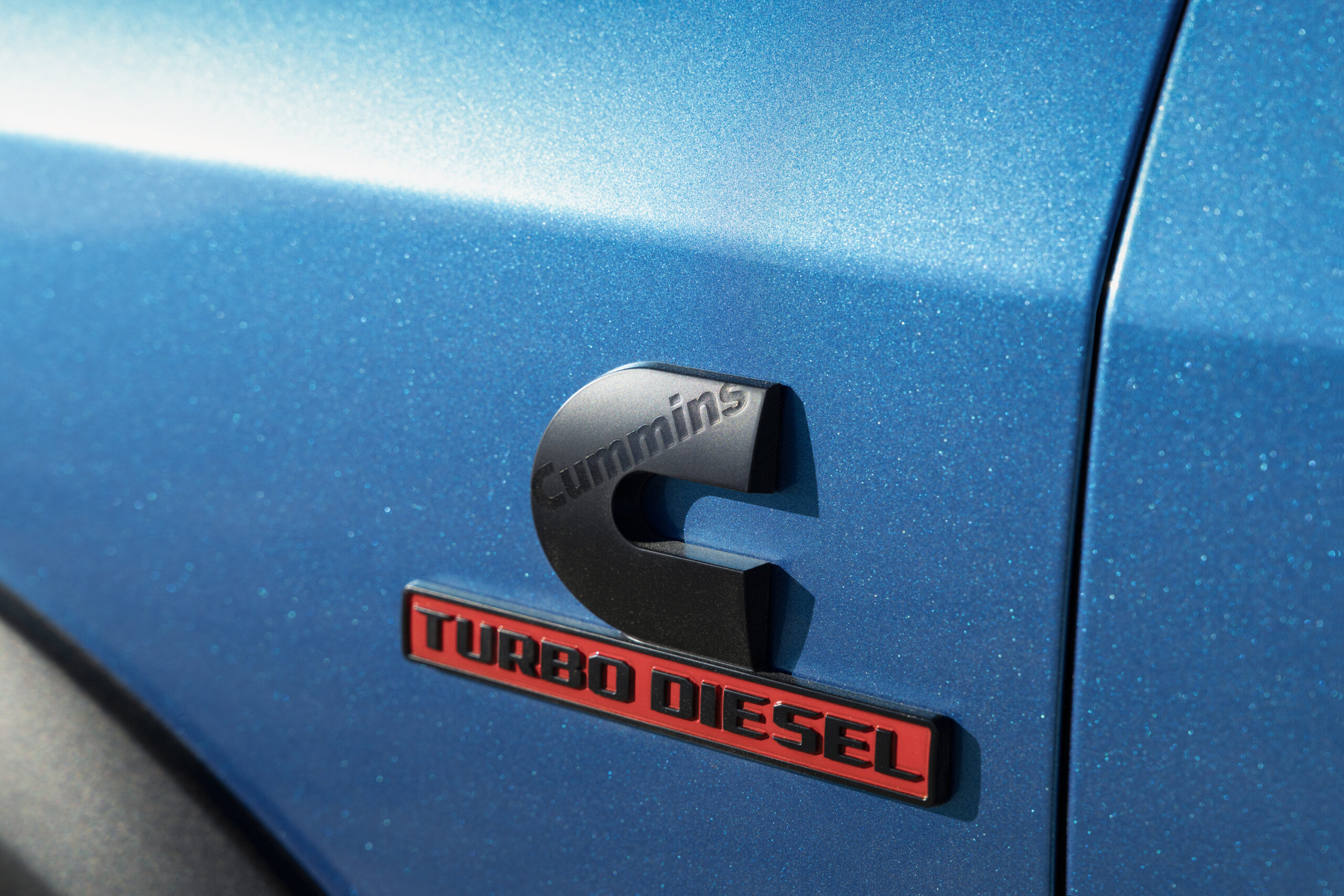

Christmas came early for me, opening up the embargoed press packet from Ram and reading an unexpected and thrilling piece of news. The Power Wagon, the most capable full-size truck produced, will now be available with a diesel drivetrain. Seriously! A Cummins-powered 3/4-ton truck with front and rear lockers, a swaybar disconnect, 1,075 pound-feet of torque, auto-leveling rear five-link air suspension, a 31-gallon fuel tank, rock rails, 34-inch tires, and available dual 220-amp alternators. If it had been April 1, I would certainly have been suspicious that we were all getting punked.

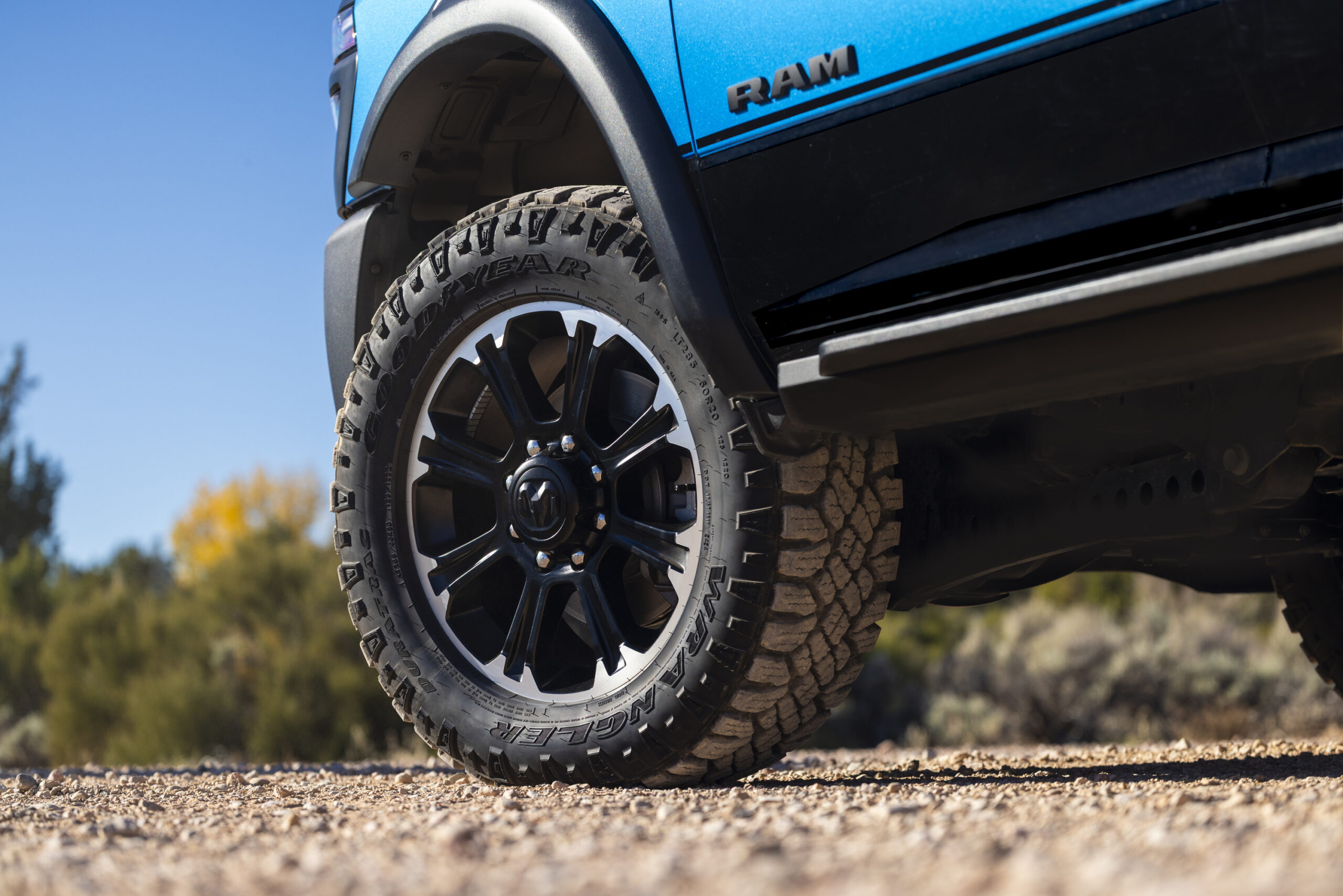

All of this new capability includes additional features specifically for the overlander, like a 600-mile range (achieving the pinnacle standard of a 1,000 km range), a 6.5-foot bed for a slide-in camper, and even available dual 220-amp alternators to quickly charge lithium house batteries while driving or idling. One area where the stock specification falls short is the standard 20-inch wheel, which is a mismatch to the rest of the specification. This truck should come with a 17- or 18-inch wheel, full-stop, end of discussion. Fortunately, the brake diameter specs should translate into at least an 18-inch replacement wheel fitting over the calipers.
