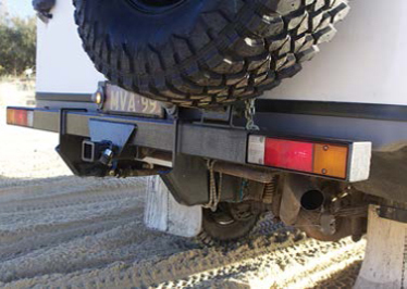

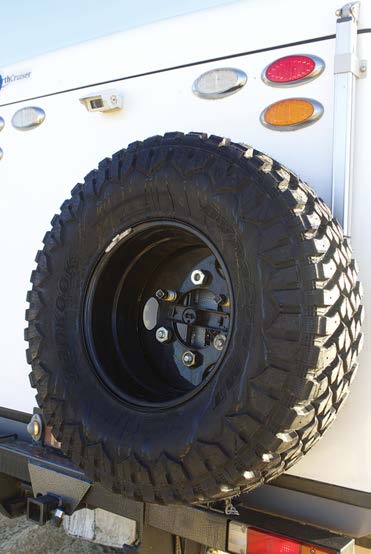

A stock Fuso is suitable for light exploration and little more. It is delivered from the factory with dual rear wheels (DRW), 7.50R16 tires, and limited clearance under the unprotected transfer case. Fortunately, the team at EarthCruiser identified and addressed these limitations, turning the Fuso from limited to legitimate. The most critical modification is the conversion from DRW to single rear wheel (SRW). This is essential in soft terrain, as a DRW is forced to travel outside of the compacted track of the front tires, greatly increasing resistance and the chance of getting stuck. However, this modification does put some serious stress on the rear tire load capacity; care must be given to specifying the correct tire and keeping it properly inflated and cool. In addition to the SRW conversion, new leaf springs are fitted to provide additional ground clearance and room for larger tires—much larger. The model I tested came equipped with brand new Hankook MT 37×12.50R17 tires, nearly 150 millimeters taller than the factory rubber. The increased clearance moves the vulnerable transfer case higher and improves approach and departure angles. Fortunately, I have also driven stock Fusos, so I was able to compare overall stability on cambered obstacles. I found that the taller EarthCruiser was still predictable and balanced when things start to tilt. The dynamic side slope limitations of this vehicle are likely to be in the 25- to 28-degree range, but this is far more than most drivers’ nerves will allow.

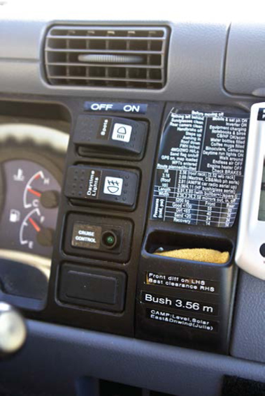

For tractive performance, the factory rear limited-slip differential can be augmented with a driver-selectable front locking differential, keeping at least three of the four tires turning in extreme terrain. On Fraser Island, the EarthCruiser had an easy time in the sand; particularly once the tires had been deflated to 20 psi, the lower limits for a 4,500-kilogram vehicle without bead lock rims. Where the vehicle struggled was on steep sand slopes; the overall power-to-weight ratio resulted in several failed climbs. Compounding the issue was the limited suspension travel and effective damping, causing the chassis to bounce in the sand ruts, losing momentum and inducing wheel hop. Lest we forget, I’m comparing the performance of a camper with a built-in hot water shower to that of a Land Cruiser of half its weight.

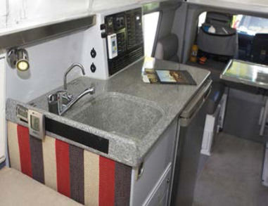

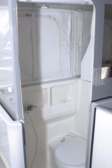

The reason why an adventurer would buy an EarthCruiser is the ability to transport camping comfort and all-weather accommodation to the Outback. For this requirement, it delivers in spades, yet forgoes the pretentious impression some other campers impart. Simple and clean in design, its sheer practicality reduces the clinical feel of the white and gray gel coat finish. Access to the camper is possible through a side door and cabin pass-through, an important safety consideration where exiting the vehicle to drive away could be hazardous. Configured as an aisle, the port side features the galley while the starboard houses the wet head. At the back of the camper is a double bed with ample cushioning, reading lights, and good ventilation. Just aft of the pass-through is the dinette, perfectly sized for two, allowing comfortable dining and a suitable workspace.

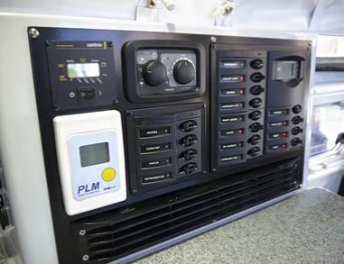

The galley is spacious and efficient, with a diesel cooktop and a deep sink. Hot water comes quickly, as does filtered drinking water, and storage is more than adequate for two people. The fridge is an upright unit, which makes access convenient; however, it will never match the capacity and low power consumption of a chest-style unit. Above the countertop is the electronics command center, complete with solar charge controller, battery monitor system, Webasto water/air heater controller and complete fuse panel.
