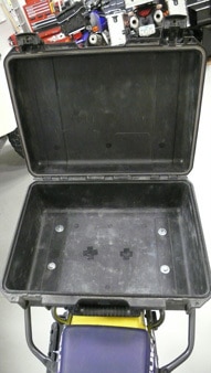

I scrounged up some scrap metal to fab the straps, and rounded up some hardware from our bolt bin. After making the aluminum straps, I drilled 4 new holes into the box (and put tape over the previous holes to prevent ingress of dust):
An empty, open black plastic storage box—one of the essential motorcycle accessories—is attached to the back of an orange Suzuki DR200. The box’s interior is scuffed and has crosses molded into its bottom surface.

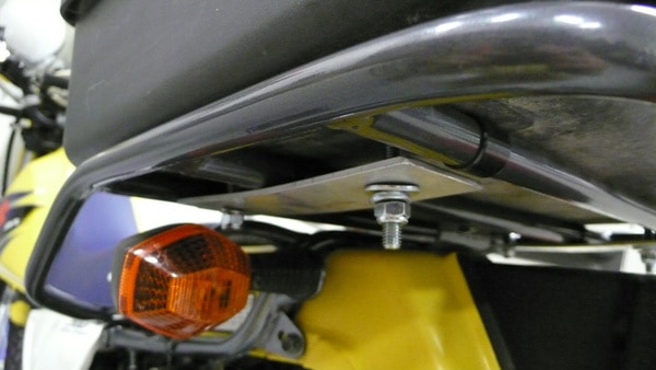

Since this motorcycle “buzzes” quite a bit, I decided to use both lock-nuts and lock-washers in hopes that the hardware will not come loose:
Close-up view of a Suzuki DR200 rear rack, showing a metal plate secured with a bolt and nut—perfect for installing a top-box. An orange rear turn signal and part of the yellow motorcycle body are also visible, highlighting essential motorcycle accessories.

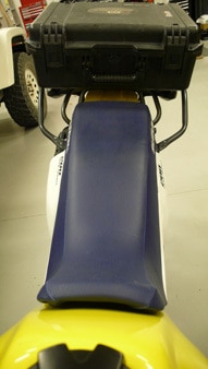

After a few hundred miles with the case on, it hasn’t come loose at all. It provides a good storage area (dust & water-proof), with the ability to place two locks on it for added security. If you already own a Pelican case (or similar), and don’t mind drilling a few holes in it, with about 45 minutes of work this is a very inexpensive way to add hard-luggage to a dualsport motorcycle. It should serve me well on my upcoming adventure to Baja!
An open, empty black hard plastic storage case is mounted on a Suzuki DR200, with the lid raised and the interior visible—perfect for top-box installation and essential motorcycle accessories.
A close-up, top-down view of a Suzuki DR200 motorcycle with a blue seat and a large black top-box installation on the rear. Part of a white vehicle tire is visible in the background, highlighting practical motorcycle accessories.
