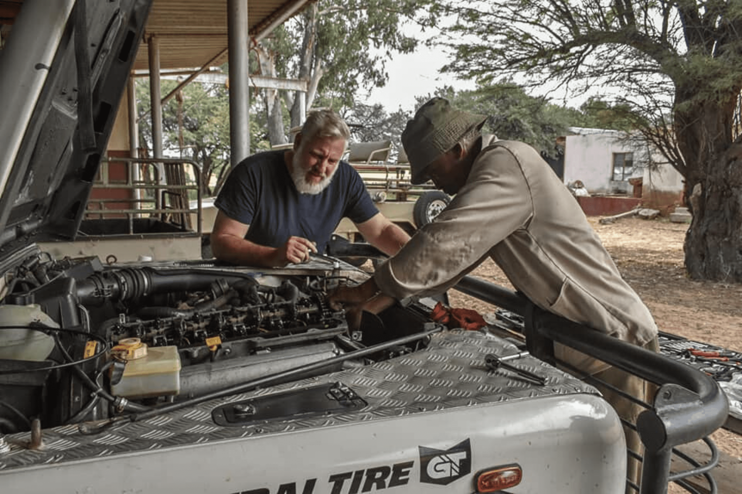

Getting to Know Your Specific Vehicle
Every vehicle has its own quirks. Our 2003 Defender has more than its fair share, but they are similar to other TD5s. I know that the TD5 injector loom has a habit of leaking oil into the engine control unit (ECU) located under the driver’s seat. I also know that there is a sensor behind the gearbox that is exposed and can shut down the vehicle, and that the crank position sensor can and will do its best to leave us stranded. Upon purchasing the vehicle, I bought an owner’s manual and scoured the internet for information about my type of vehicle and the problems to expect. I then planned accordingly, either through preventative maintenance or carrying relevant spare parts. I found a few good apples online who have guided me through diagnostics and repairs as I travel (thanks, Malcolm and Jakes), and I am also sure to repay the debt.

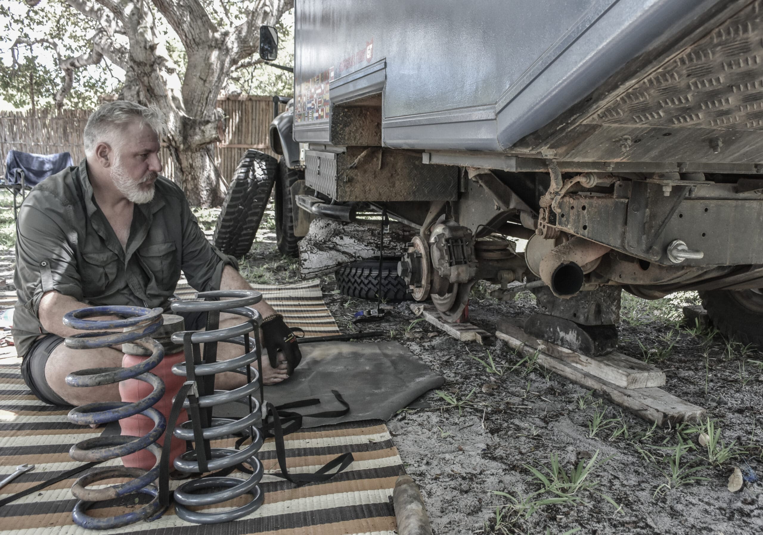

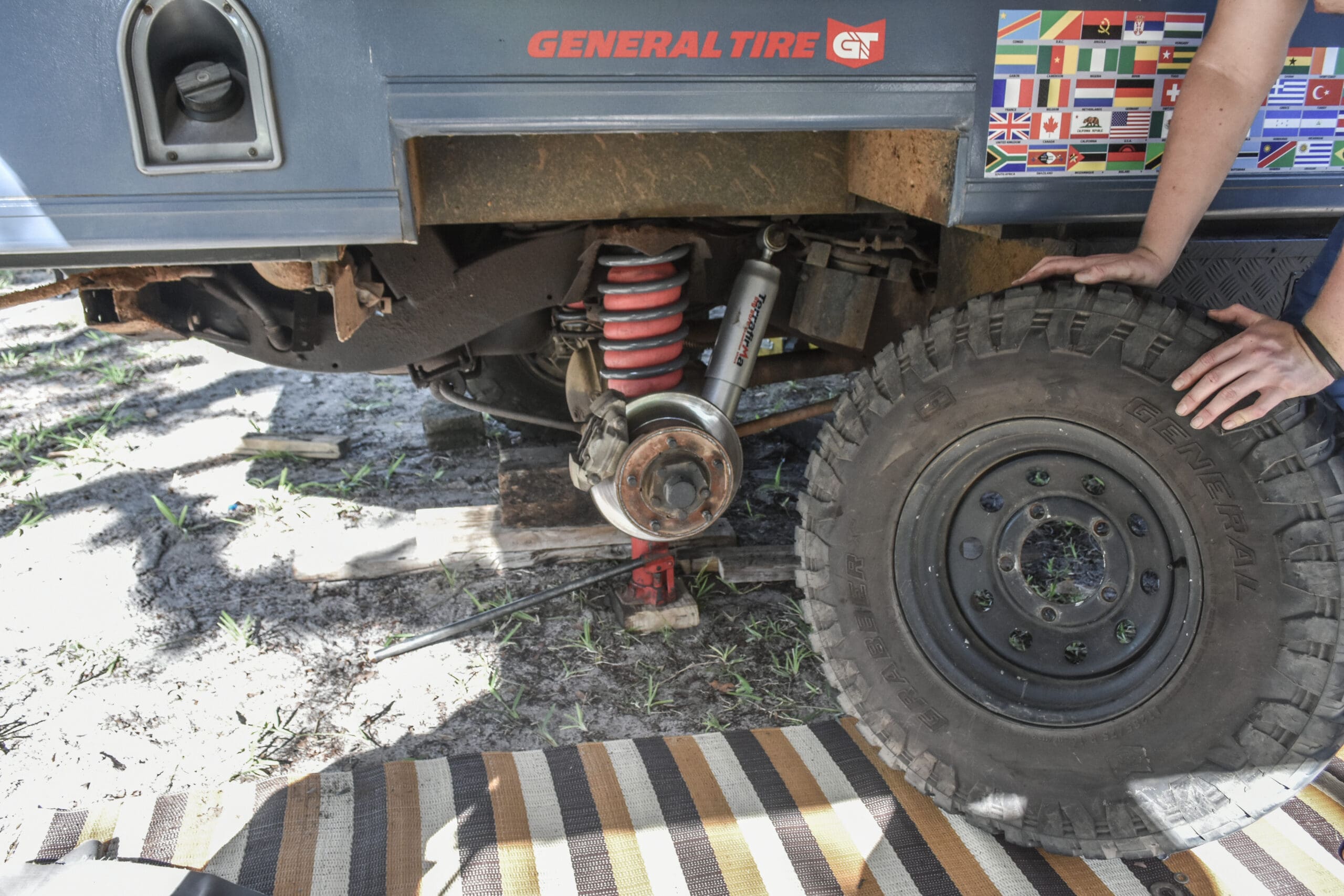

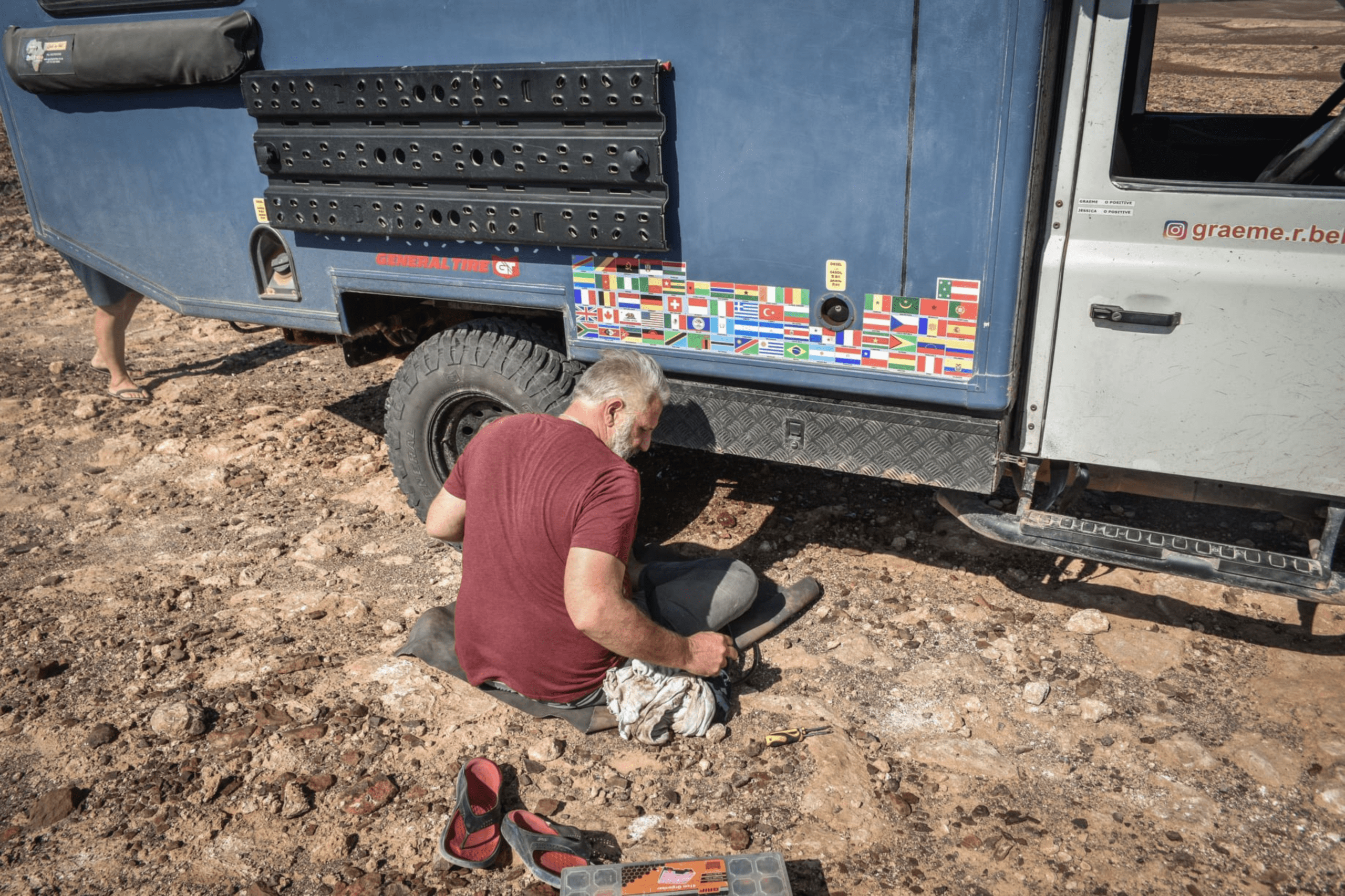

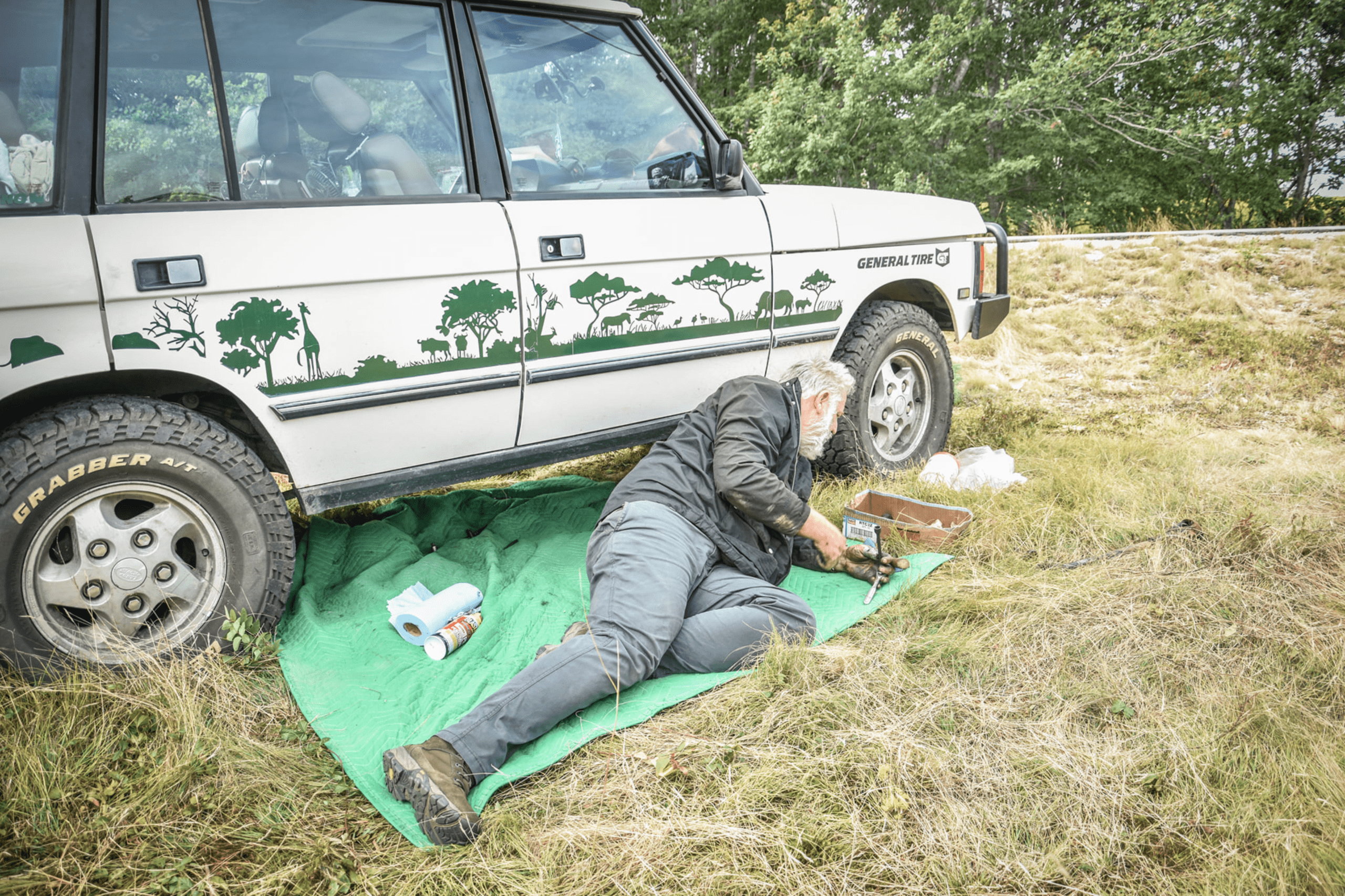

If, like me, you were not raised with wrenching culture, it may be difficult to motivate yourself to get stuck into a bush repair. Motivation is key. If I have to replace injector seals, remove a gearbox, or replace the alternator, I will always start the workday with small, easy, and rewarding tasks that help boost my confidence and reactivate my mechanical skills. Not putting off repairs and not ignoring new sounds and rattles helps to avoid side-of-the-road breakdowns, the worst kind. Do the repairs and maintenance in camp with a meal and a shower nearby, rather than in a pit beside the road with fire ants in your pants and no shade.
Tip: Always pack a work tarp in an accessible space.

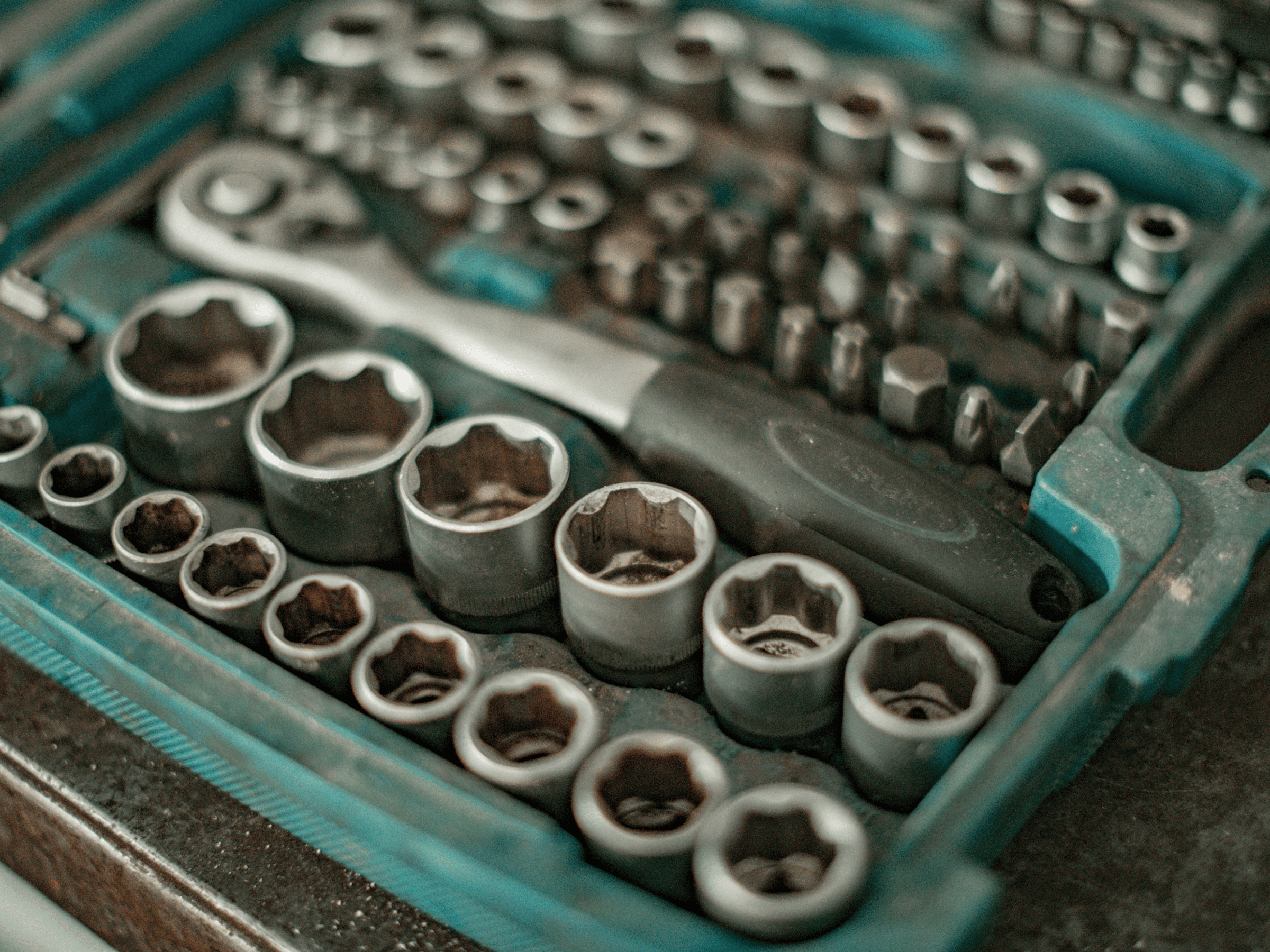

Invest in a Set of Tools
Remember, the more mechanically and geographically independent you intend to be, the more tools you must carry. A basic tool kit consisting of common spanners, screwdrivers, Allen keys, sockets, and a pliers set is the foundation of your tool arsenal. Carry a few special tools, such as fan spanners and a hub nut tool; by getting to know your vehicle, you will learn which ones you will need. Miscellaneous tools, such as a crowbar, mallet, hammer, cordless impact drill, compact axle stand, and circlip pliers, can be essential when the dwang hits the fan. Try to avoid carrying tools you have never found the occasion to use, which can be found at mechanical stores along your route, if necessary.
Tip: Two blocks of wood can be incredibly useful around camp when not used for jacking up a vehicle or knocking out wheel-bearing races.

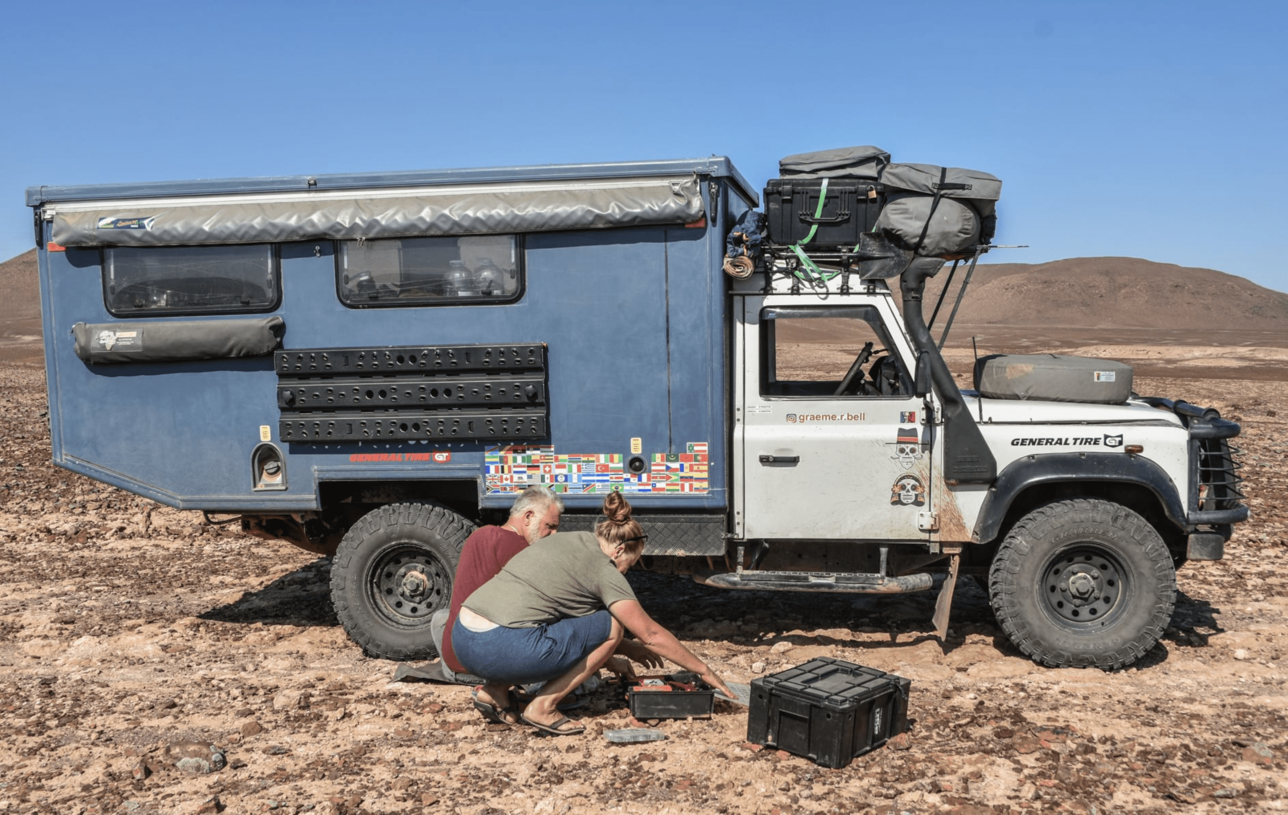

Dealing with a Breakdown
Stop, drop, and roll. Assess the situation, find safety, and connect to the internet. If you are sitting on the side of the road 100 miles from anywhere in either direction, you will need to do what you can to either get moving again or find a place to do the necessary repairs. Stressing or rushing a repair will often make the situation worse. Stay in control and accept the inconvenience. Our experience has been that, except for in highly remote areas, someone will eventually come along. Usually, they will offer a helping hand, a tow, or at least offer to send a tow truck when they get back to civilization. We have made some great friends during our breakdowns.

How to Diagnose a Problem
Having done your research beforehand, you should have a good idea of what the problem might be. Having access to the internet will significantly increase your chances of confirming or disproving that initial diagnosis. Some breakdowns are obvious, but we have had many that were mysterious and difficult to diagnose—mostly related to fuel and electrics. Portable diagnostic tools are available for many vehicle brands; our Defender TD5 uses an expensive but essential Nanocom diagnostic tool that can read and clear faults and reprogram the ECU. Naturally, reprogramming an ECU requires a specialist skill set, and we have learned through trial and error how to use our Nanocom for diagnosis and tasks such as deactivating the immobilizer when it decides to go rogue. Depending on the type of breakdown, you will need to go through the process of diagnosis, research, and repair.

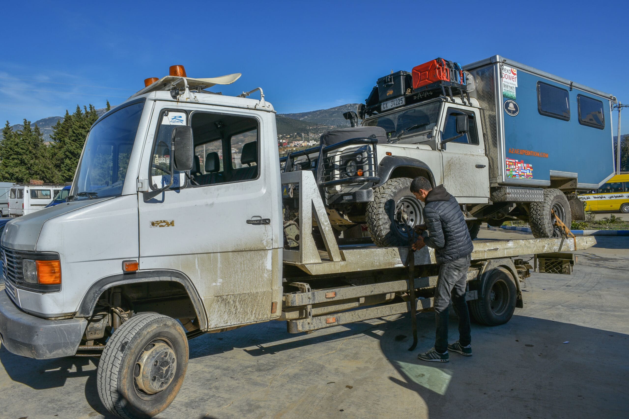

When Not to Fix It Yourself

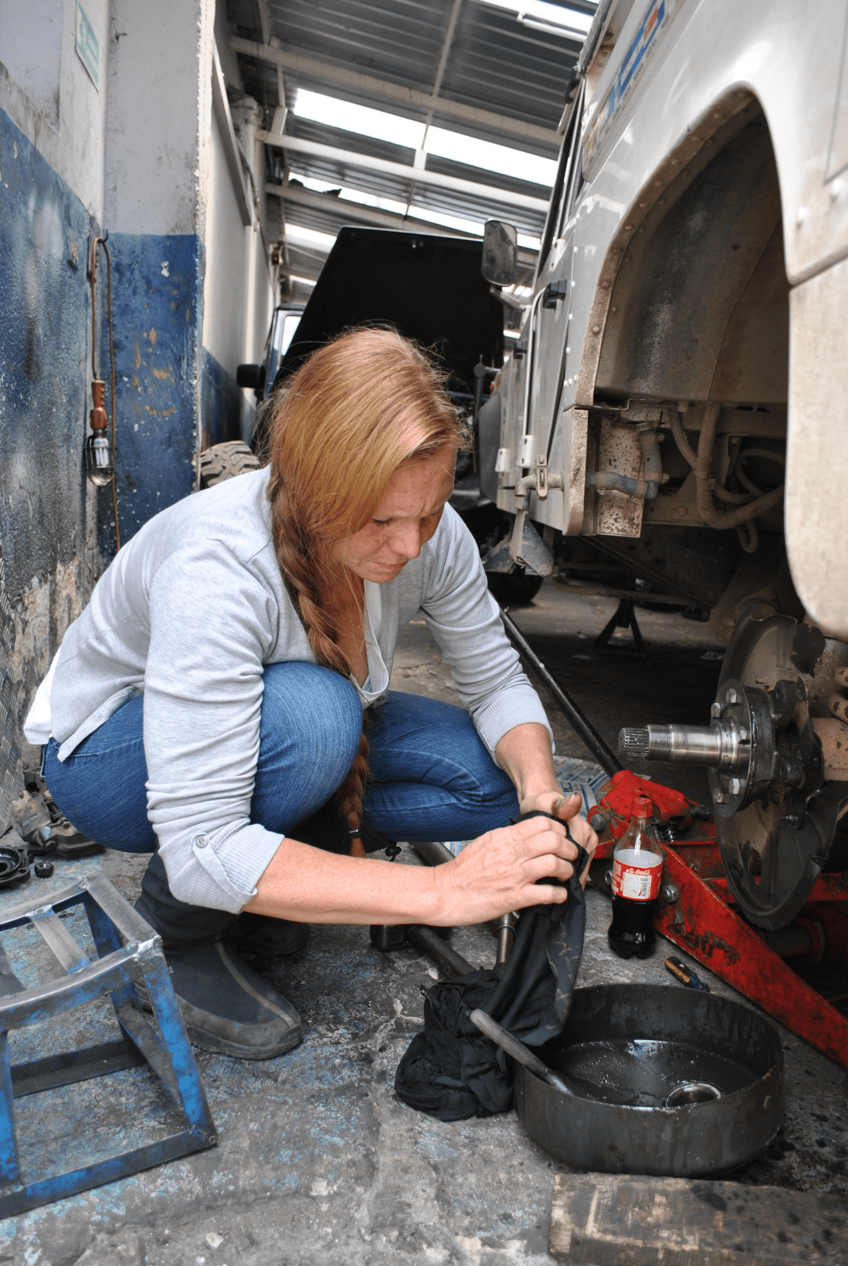

Sometimes, despite our best efforts, we cannot fix the Landy on the side of the trail. Complex repairs, such as clutch replacement or transmission repair, are best left to the professionals, with the caveat being that you first have to locate that professional. Affordable, reliable, local labor is not always available. However, thanks to apps like iOverlander, it is much easier to find a good mechanic or sparky (auto electrician) than it was back in the good old days. In all our years of travel, the Landy has only been on a tow truck once, and that was after the aforementioned breakdown in the Rif mountains of Morocco and after being towed out of the mountains by that unsympathetic tractor driver. As previously explained, we were delivered to a campsite where we paid a local mechanical crew $120 to remove the engine and replace the clutch. They did not do a great job (the pressure plate was installed incorrectly, and the motor had to be removed again), but the alternative, removing the transmission in camp, was far from desirable. When using local labor, it is best to observe their work and not be afraid to step in and intervene when it is clear they are not performing the repairs correctly.
Tip: Film the repairs if possible. Doing so proved our point when the Moroccan mechanic refused to accept blame (he was clearly at fault and was filmed telling his mechanic to put the pressure plate backward, despite protestation).
