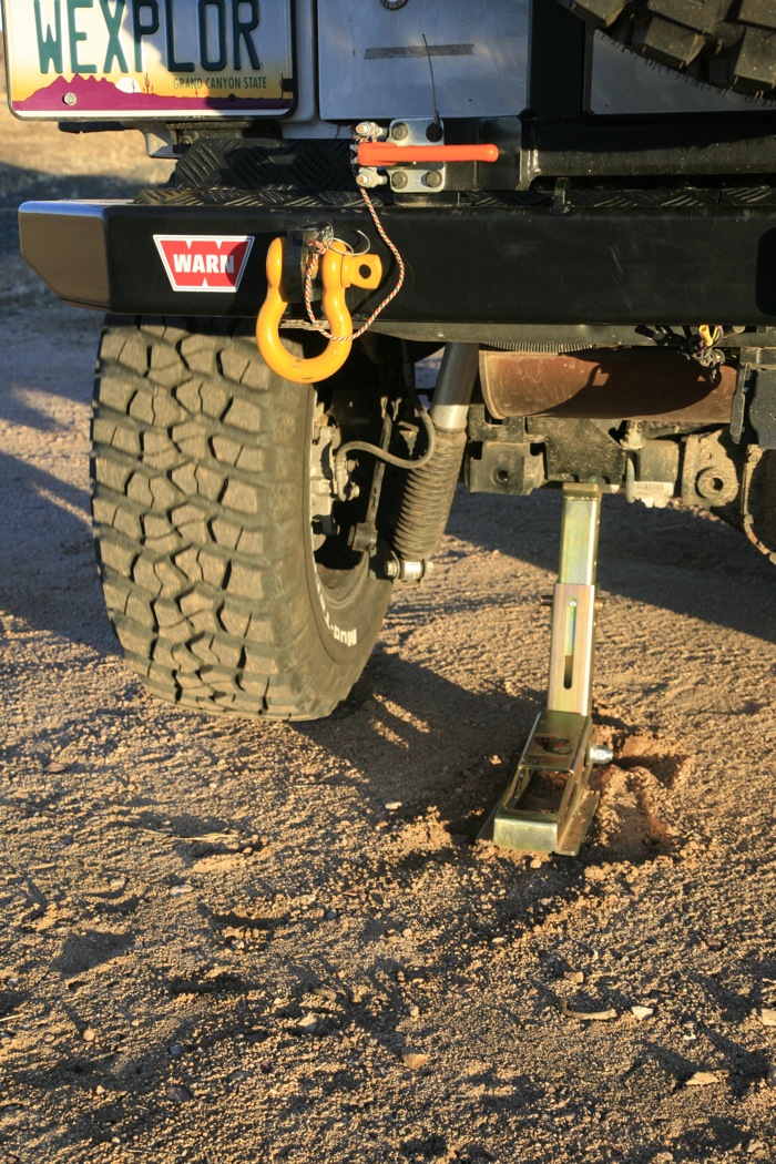

6. I would want to use a spotter, but if you are solo, engage 4wd (i.e., ensure the center differential is locked if equipped) and low-range if possible (we tried in high and low range), then select reverse gear and back up slowly, the leverage of the arm will lift the axle and suspend the tire off the ground.
A close-up of a vehicle’s rear tire being lifted by a Jemmy Jack on sandy ground. A yellow hook and the WEXPLOR license plate are visible, highlighting the Rasta 4x4 gear in action.

This is a specialty jack, and would typically be carried in addition to a bottle jack or Hi-Lift jack. Its greatest strength is speed, and it is actually quite safe and stable if placed properly. Certainly safer than a Hi-Lift that needs to overcome suspension droop or have the axle tethered. In rocky terrain, or if the vehicle is completely immobilized, the jack would not be useful. For changing a tire on the trail or on the road, it is fantastic. The unit is also somewhat limited on tire height, with a 35″ tire being the maximum, though I do not see this as much of a disadvantage, as most overland vehicles use tires smaller than a 35. The unit should be handled with gloves (as should all jacks), as several edges are sharp, and it is somewhat heavy at 15lbs., though it packs compact, and is easy to store.
