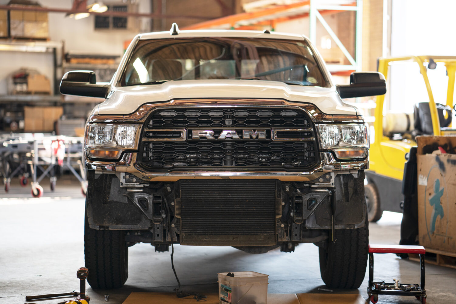

Ram 2500 aftermarket bumper installation
OEM bumper removed.

I had initially planned to perform the bumper installation myself, but at the suggestion of Expedition One, I ended up bringing the truck into their shop, and I’m glad that I did.
While I had thought that it would pretty much be a plug-and-play affair, it turns out that the 5th-generation Ram 2500 had some small design differences that required modification of the front and rear bumper mounts for proper fitment. Additionally, there was some trickery required to relocate the vehicle’s rear-facing camera along with its wiring.
Installing aftermarket steel bumpers Istalling aftermarket steel bumpers
Using an angle grinder and cut-off wheel to remove some steel from the factory bumper mounts for proper fit.
