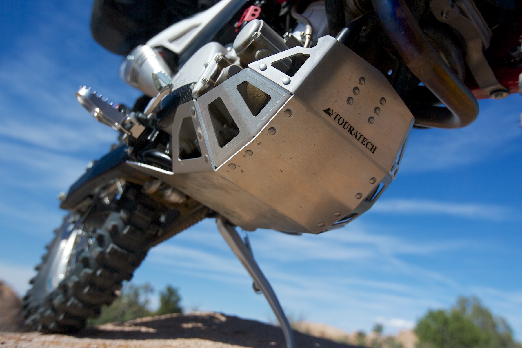

Next comes engine protection, and Touratech builds the perfect adventure travel skid plate for this motorcycle, balancing strength and light weight. The guard is made from 3mm aluminum, reinforced by 3mm stainless steel. All brackets are stainless steel as well. Touratech Aluminum Skid Plate

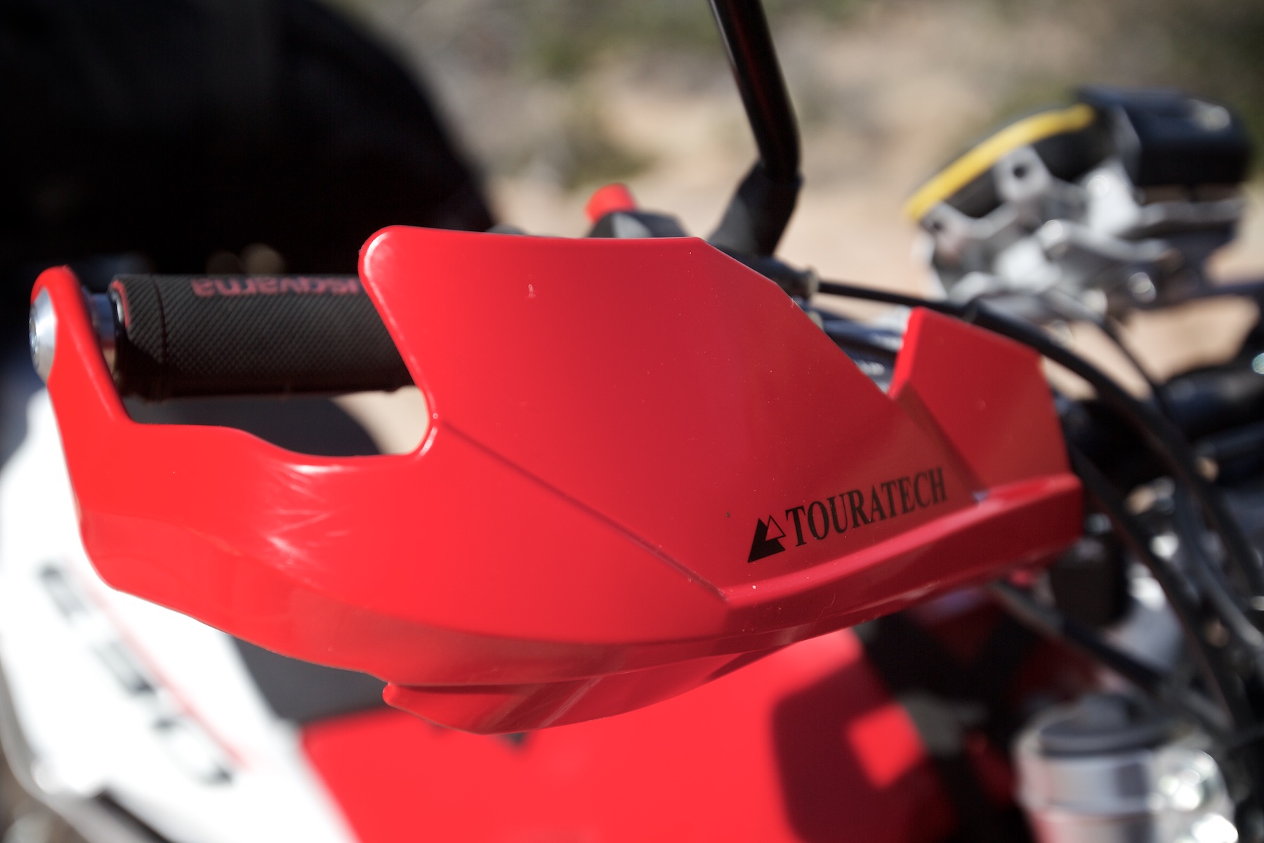

Within the cockpit, we addressed hand guards with Touratech units and also installed the excellent ASV levers, which both fold out of the way on impact and are fully adjustable. I purchased the ASV shorty units, which I find work better with my two finger riding style.
