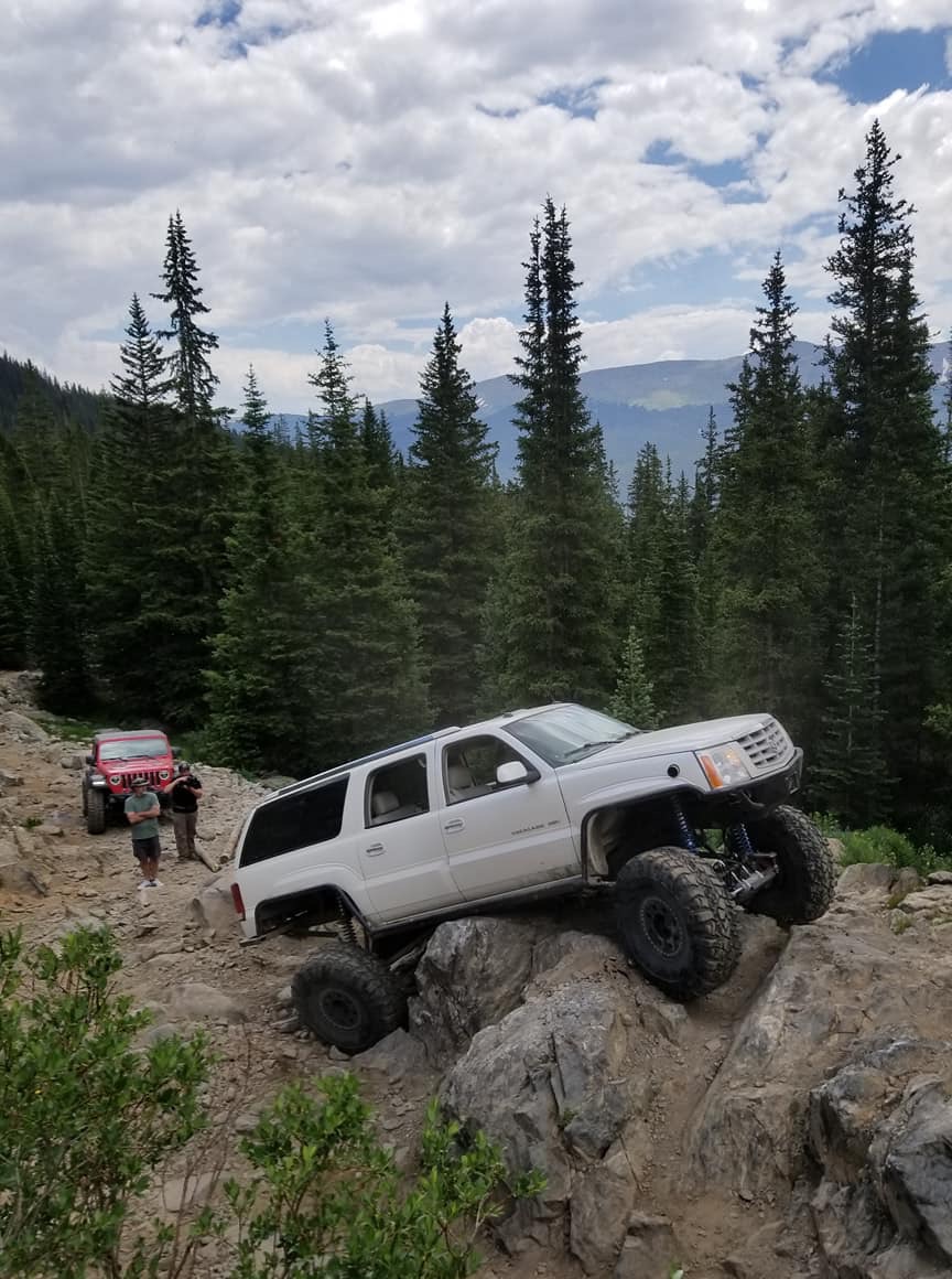

The monster Cadillac you see before you was built by enthusiast Dan Dietz off a sarcastic joke from his father. After buying the wrecked Escalade for parts, his father jousted why not put your Blazer axles under it. Dan, however, thought it was a pretty good idea, and so began the build. It started with super cheap leaf springs and Chevy 1-tons, but when he found a set of brand new used King coilovers still in the box, it quickly “got out of hand.”
Of course, I had to ask for a little clarification on just how out of hand things got, and I wasn’t disappointed.
“It has a 79 Ford front axle with Artec truss and ram mount, Yukon chromoly axle shafts, PSC ram, Yukon grizzly locker and 5.13 gears. The rear is a Dana 70 super with a Detroit locker,  5.13’s and a homemade truss. It is 4 linked front and rear with 52″ long links made of 2.25″ 3/8 wall tubing and 1.25 heims. Almost all of the suspension mounts I made myself, which was more work than needed really.”
“It still has the stock 6.0 and 4l65e backed by a 241 transfer case, and I have a 4l80, Ecobox, and Ford 205 I will be putting in with air shifters hopefully soon. The rear half of the frame was cut off and narrowed with new square tubing to make room for the coilovers, and it has a 3/8 flatbelly skidplate under it also. A/C works good, and it still has all the interior including two TVs!”
