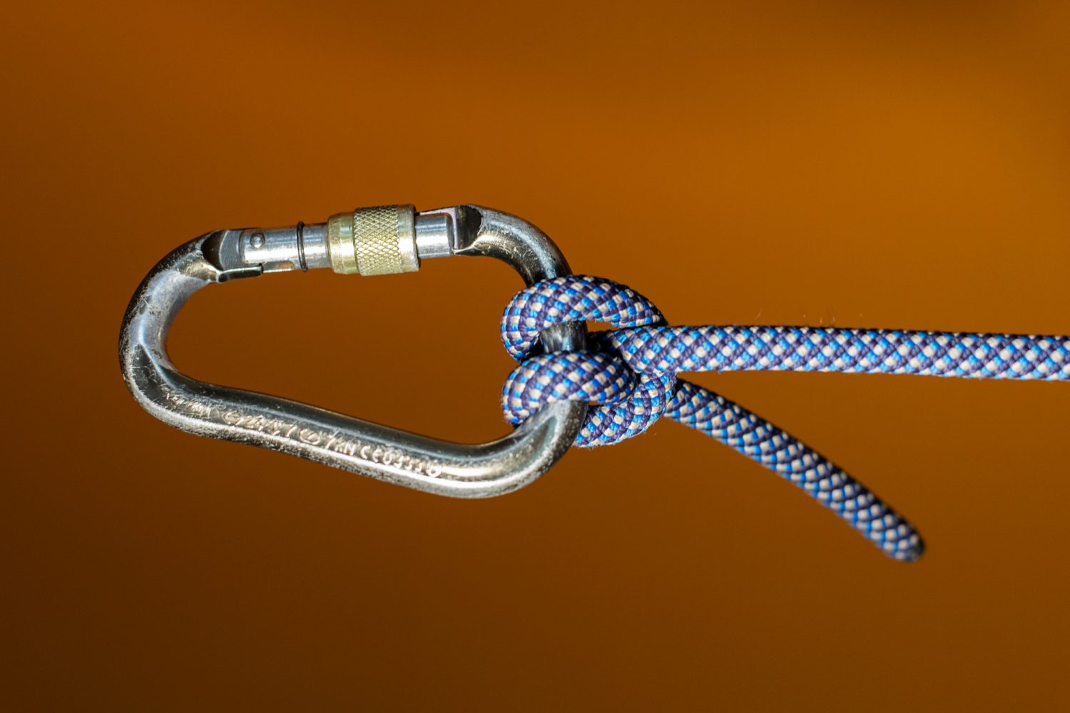

Bowline
Photo: Matt Swartz
USES: Anchoring a rope to a fixed object (i.e., a tree, recovery point, or fixed anchor). The bowline has also historically been used for tying a safety rope to oneself or climbing harness to prevent a fall.
The bowline has been around for quite some time, and as you might have imagined, it’s original documented use was in the sailing world where it would secure the edges of square sails against the wind, toward the bow of a ship. Captain John Smith mentioned the knot’s robust holding power all the way back in 1691 in A Sea Grammar. There are also rumors that the knot was discovered in the rigging of ancient Egyptian ships during a 1954 archeological excavation.
The bowline has stuck around and is still widely used today. It’s a strong knot that doesn’t slip (especially with a backup knot), and one of it’s most respected qualities is that it doesn’t cinch down when weight is applied to it; that means it’s easy to untie after being loaded all day. The bowline can be easily tied through fixed anchors like eye bolts or D-rings as well as around objects such as rocks and trees.
