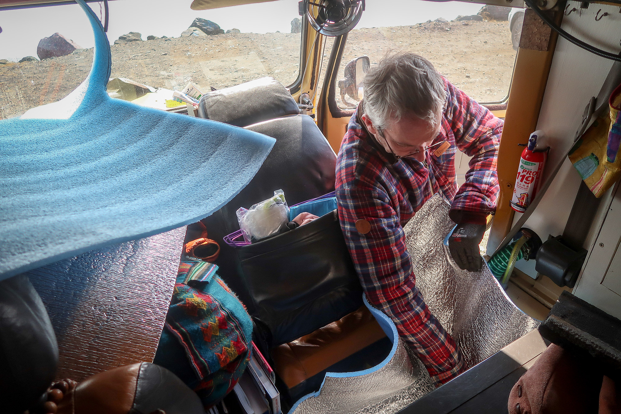

2. Insulation
The sides and ceiling of the Land Cruiser are permanently insulated, but for the winter season, we bought additional insulation. We used large pieces to cover the floor, the lower section behind the front seats, and the rear door. Smaller pieces were fitted under the car seats and even under the floor mats. In Japan, we bought foam, while in Mongolia, we bought felt (that people use for their yurts) that worked great as well.
When parked for the night, the second the sun sets, we put foam insulation in front of the windshield and side windows. It makes a huge difference in keeping the cold out.
